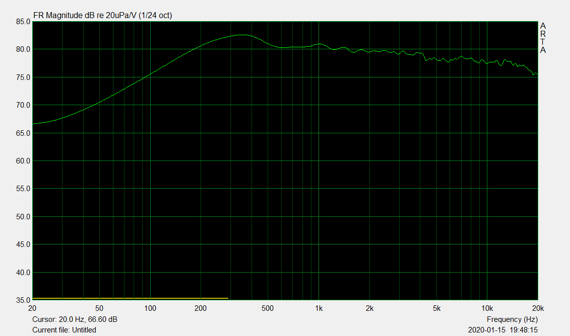

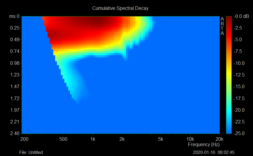

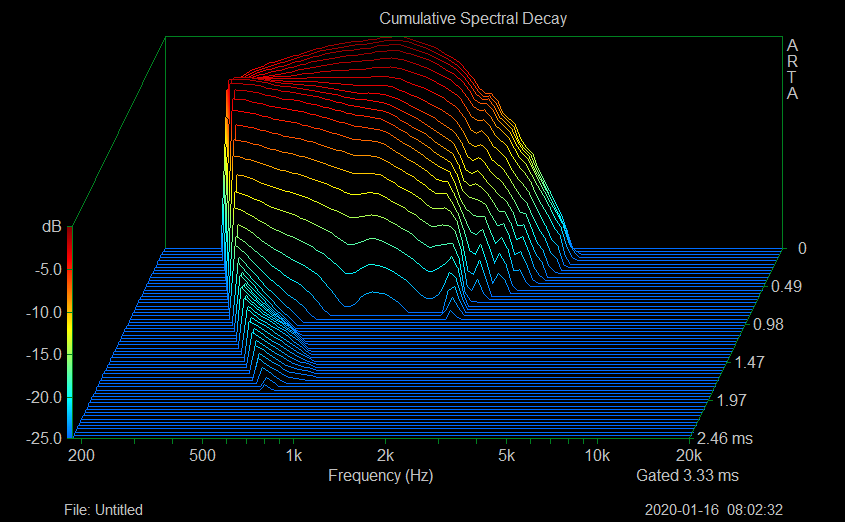

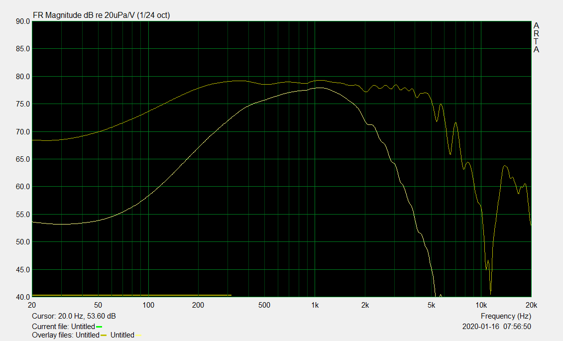

The filtering is complicated. The midrange response is flattened (with DSP) so that even the breakup is not present as peaks in the frequency response. So the on-axis frequency response follows almost textbook LR4 up to 5 kHz (after that point the response steepens as seen in the datasheet) in this case.
Otherwise if I disconnect the midrange, the high pitched unpleasantness still present in the same way. So I am 90% sure it's not the midrange driver the problem. The high frequencies are too sharp sometimes if I want to describe simply.
It might have to be like that anyway, but I don't like it.

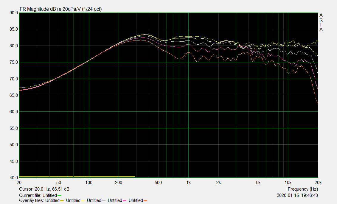

It may be worth noting that this nulls off-axis contributions and so ignores those variations. Sometimes treble quality is best judged when it has a well tempered midrange behind it.The filtering is complicated. The midrange response is flattened (with DSP) so that even the breakup is not present as peaks in the frequency response.
In this case we can most probably rule out off-axis response anomalies.

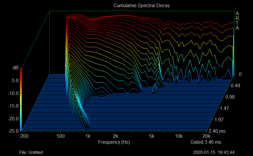

Did you ever generate a waterfall plot ?

When I look at the waterfall plots and step response plots on "hificompass" for a variety of tweeters, it looks to me that the ScanSpeak D3004 has a clean decay in the time domain. Whatever breakup modes are present, they must be very well damped, because they don't really show up in these plots. The CSD looks pretty good even when comparing to the ceramic and beryllium drivers (not quite as clean, but close). The 2nd and 3rd harmonic distortion are good also (above 3kHz) and compares well with the best.
I have always preferred metal dome tweeters, but this scanspeak D3004 looks quite nice to me.

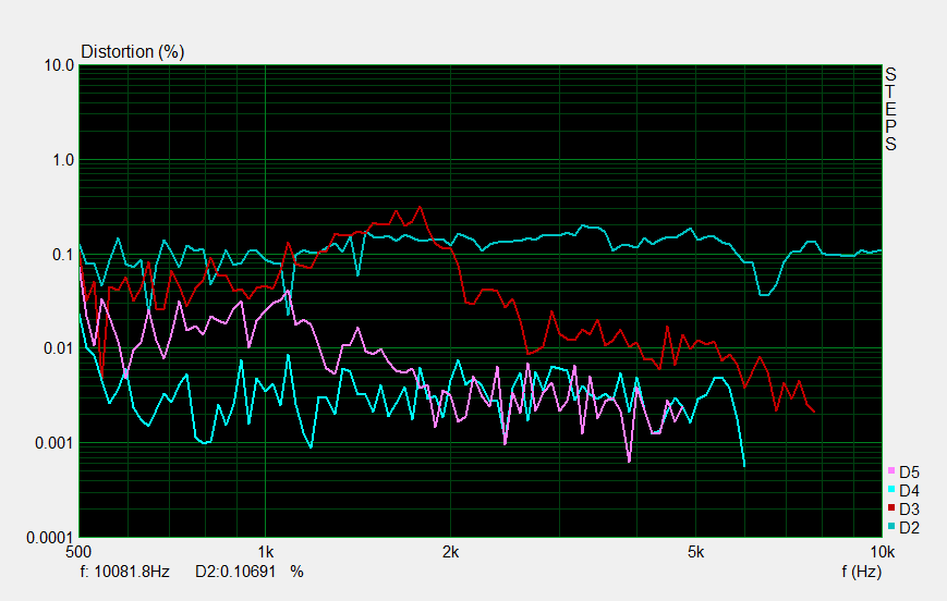

My hunch is that this is actually a midrange issue. For example, if your mid is making 3rd harmonic distortion in the 1-2 kHz range, that will show up as noise in the 4-8 kHz region. 3rd HD is very noticeable, much more than 2nd HD... If this be the case, it does not matter that you filter the input to the mid driver to remove 4k to 8k input... the fact that you are sending it 1k-2k signal means it will very definitely produce noise in the 4k-8k range... again, assuming that your mid driver has a 3rd HD problem.

Troels' CSD is much the same, so it looks like not a fault:
SS-domes

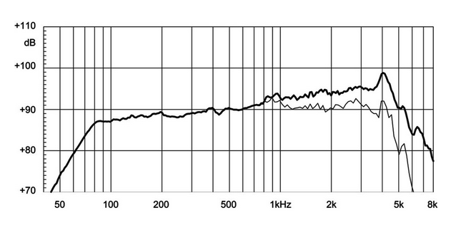

The mid seems to have a nasty peak at 4kHz:
Eighteen Sound - Professional loudspeakers
I think you'd notch that with an LCR in a passive crossover.

I have looked at your plots 3 times now, and I just don't see any possible source for a treble "hardness" or sibilance. The measurements look outstanding to me.
Perhaps you should just "voice" the speakers down a bit in the treble region? with DSP it is easy enough to shelve down the range from 4k-up by a 1/2 db and go from there... I know my personal preference with a wide dispersion speaker is that the response slopes down from 1k to 10k, such that with 1/2 or 1/3 octave smoothing the 10k level is down by 2 or 3 db. Oddly enough, with horn speakers I like a flat response... which is opposite of what I would expect.

The measurements leave only one possible question, as to distortion from the mid driver. The resonant peak is still visible in the CSD, and is quite apparently contributing to the actual output. In a passive crossover I'd use a resonance trap across the low-pass inductor to kill that peak, but you don't have that option.
That apart, it is probably personal preference that might be the issue. I see nothing to complain about from the measurement either.
Please leave alone that mid breakup 🙂, it's not visible in any way, the mid's frequency response is completely flat on-axis about to 4.5 kHz then shelves down, the small ridge around 3 kHz is a diffraction effect from the tweeter-baffle interaction, the same source as for the slight 4 kHz on-axis bump.

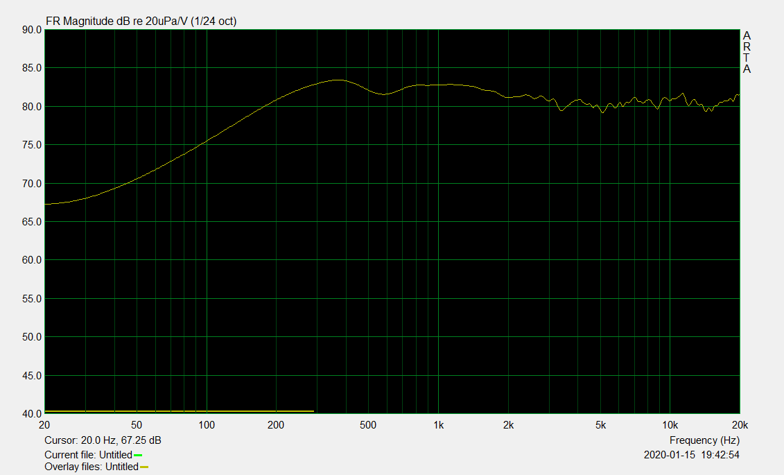

These measurements are new with a slightly dialed down tweeter, it's definitely better to my ears than before. Maybe that's all what the speakers needed.

Those measurements look nice.
