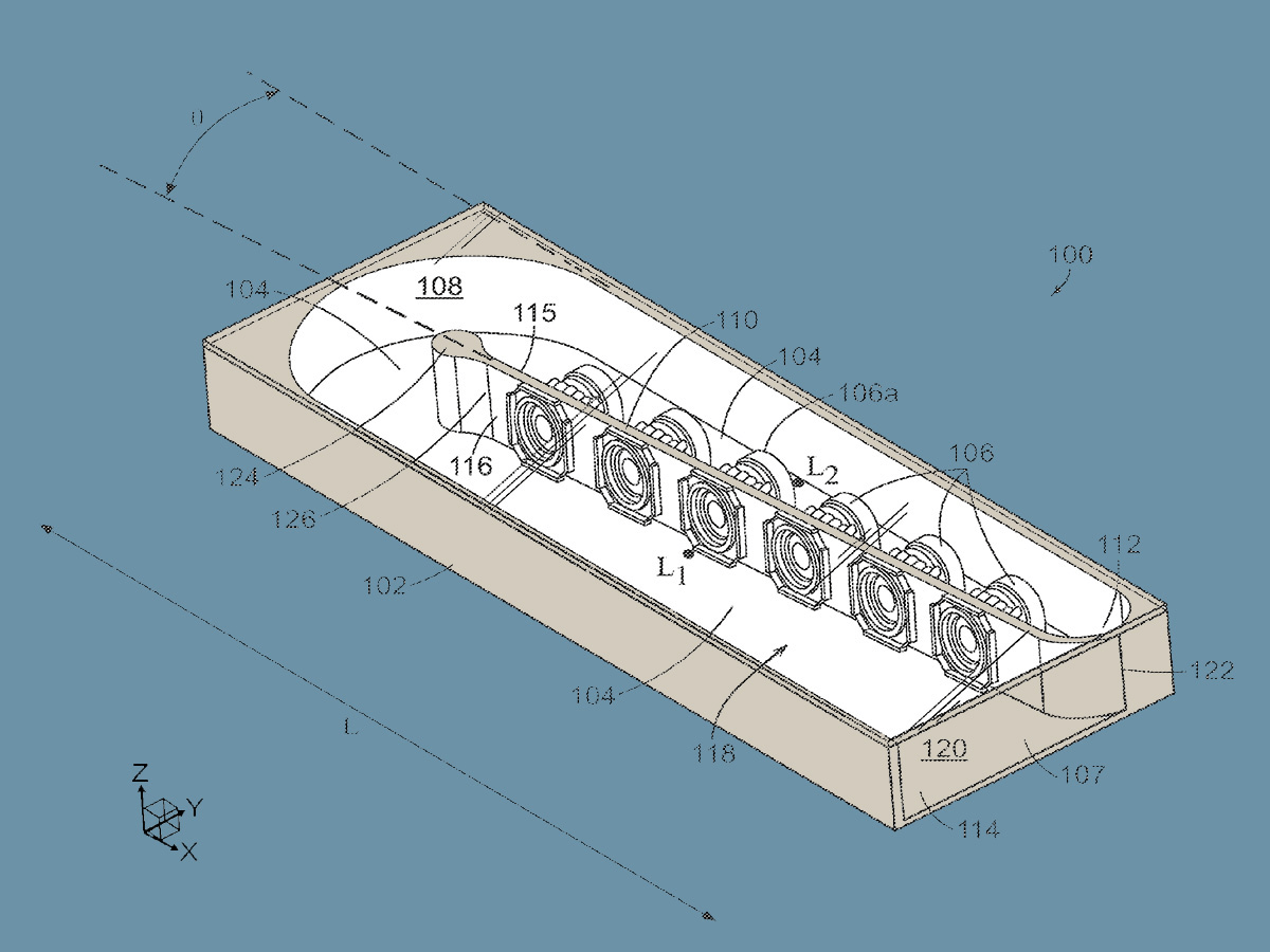

Sim individual driver positions and contemplate the response shape that would result from somehow combining them or ?That Bose (supposedly) TL is nothin more than a TH or BP6S.
I thought TL are nothing more than flared port BR's.
This...
is the same thing as this...
The Bose enclosure just has more drivers.
This...

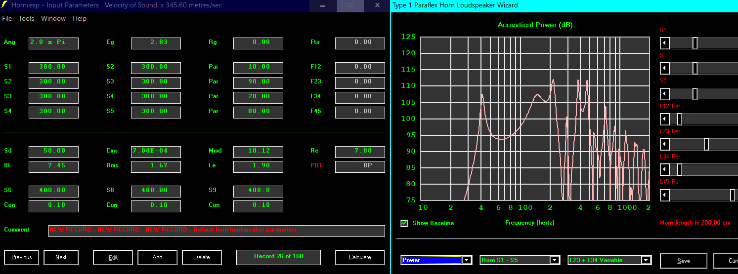

i always found this interesting, and then wondered what the combined result(not the individual variety of simmed positions) would acually be ?
Probably not the right terminology on my part, just basic conceptA 0.5 alignment may yet be the way I go.

The question was how to fit 4x drivers in a TL
The approach is 2x drivers in the line. dedicated to a certain bandwidth.
like any other design which makes up for loses to full space in the bass region.
2 way design in other words, crossover for bass

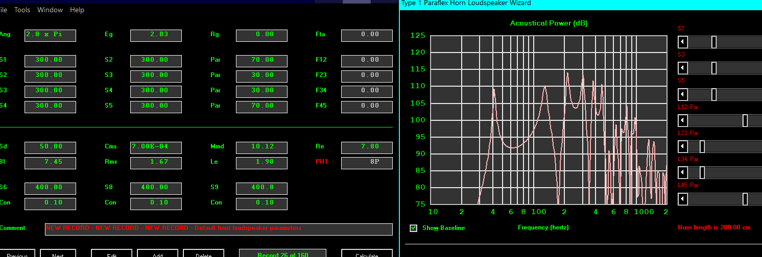

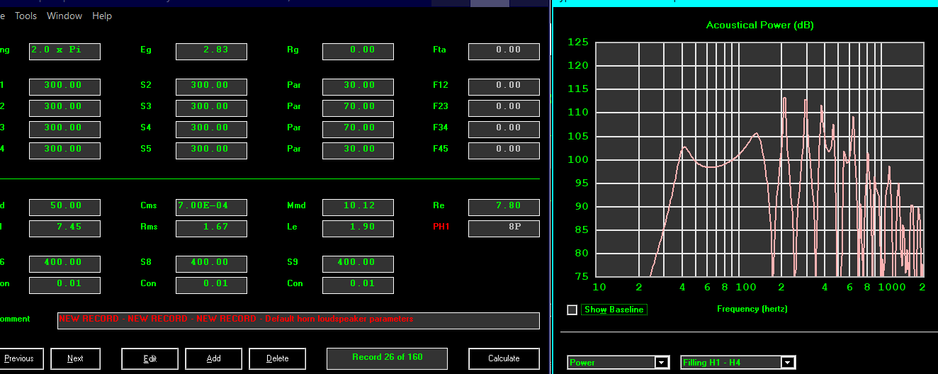

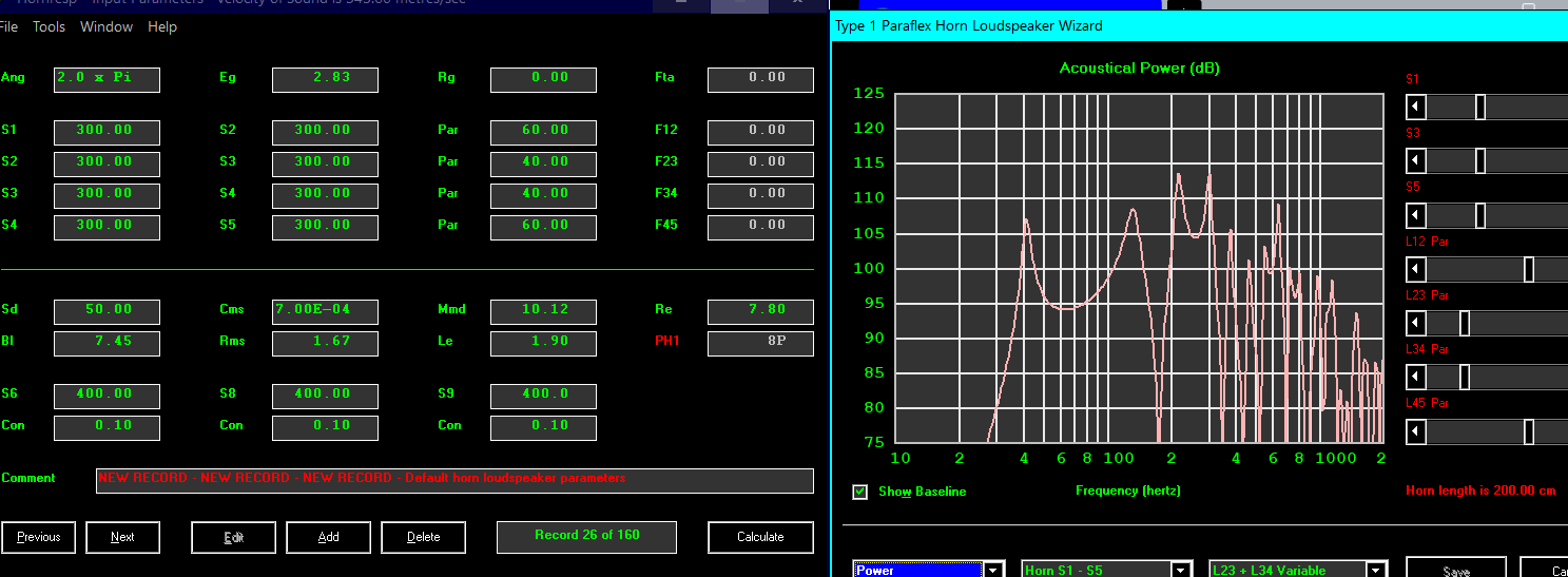

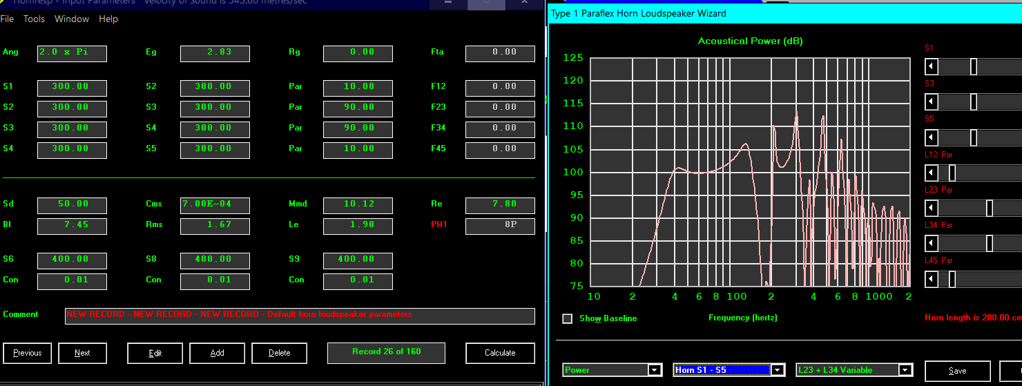

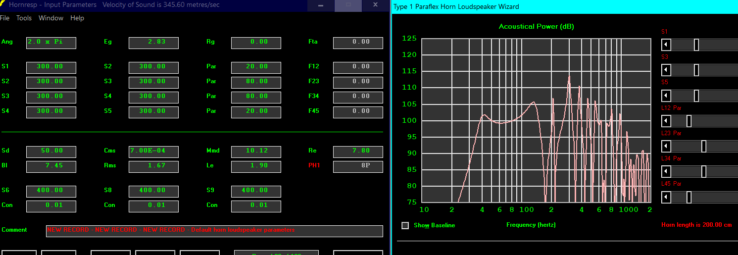

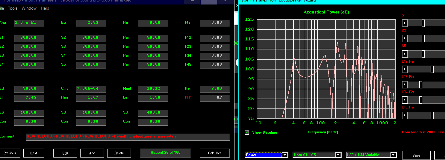

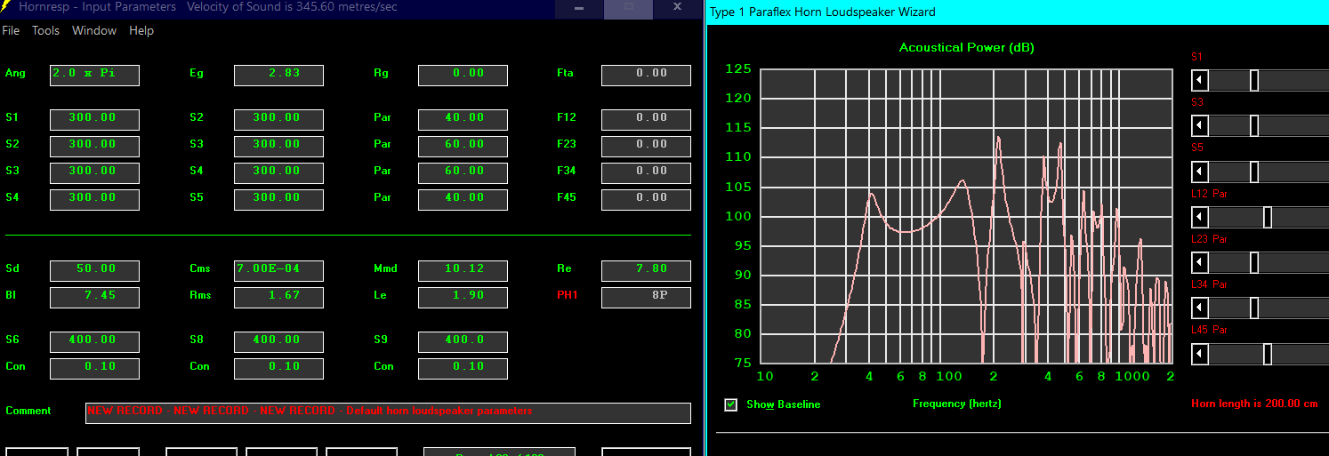

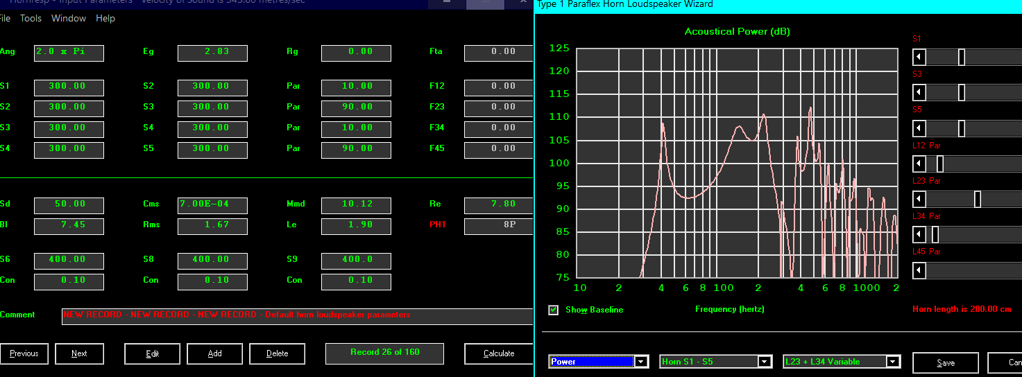

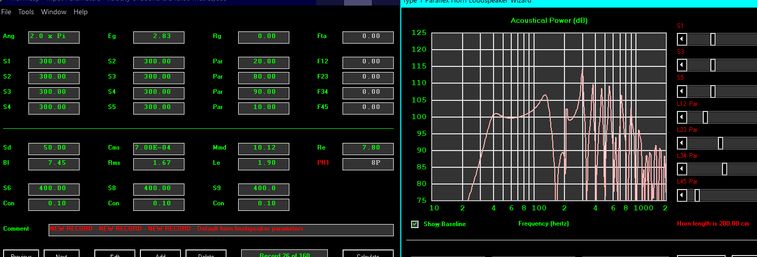

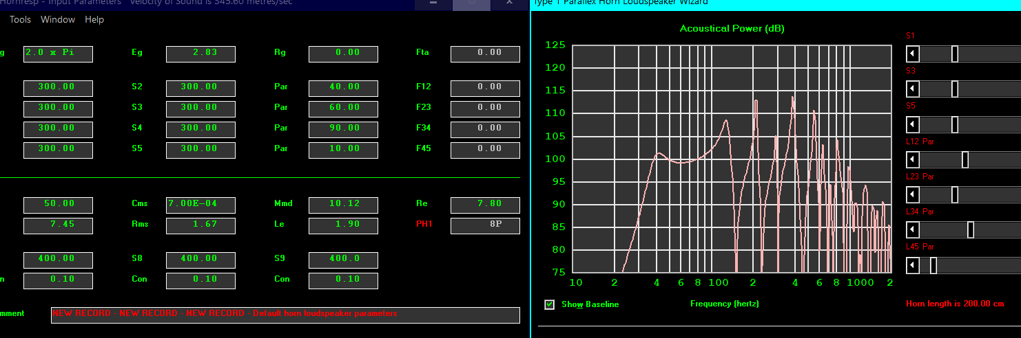

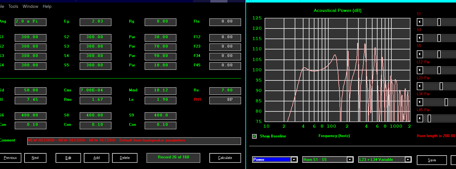

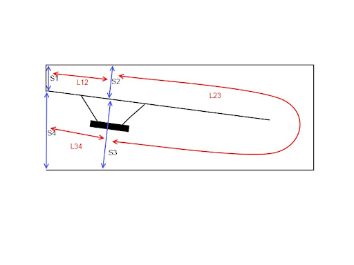

You didn't mix the variations...LOL!Sim individual driver positions and contemplate the response shape that would result from somehow combining them or ?
L12 = 10cm.
L23 = 90cm.
L34 = 80cm.
L45 = 20cm.

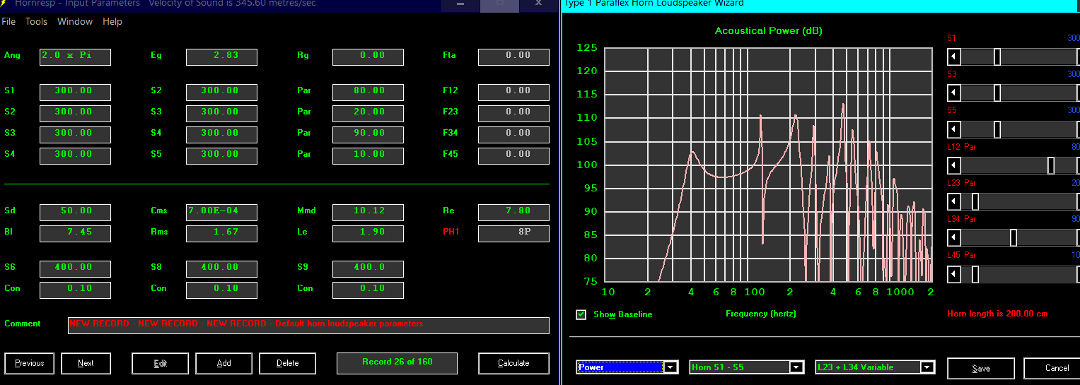

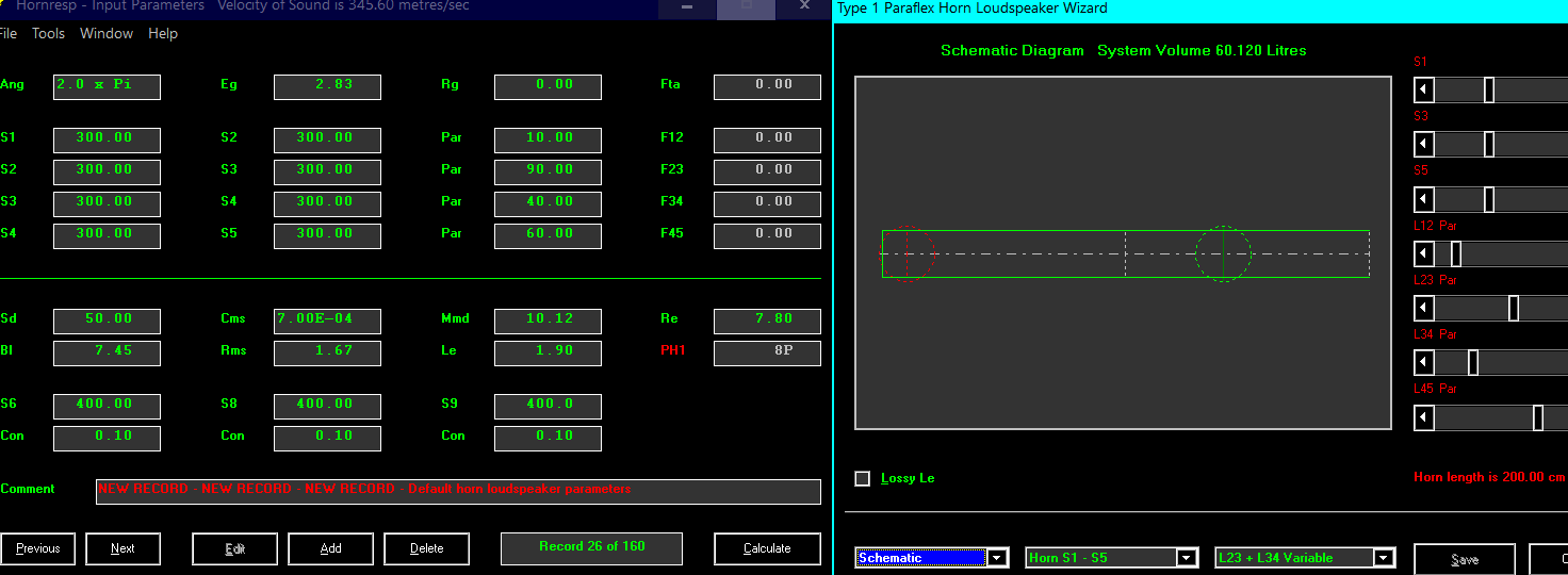

Or
L12 = 60cm.
L23 = 40cm.
L34 = 70cm.
L45 = 30cm.
Either way good reminder,
How glorious and fascinating transmission lines are to design.
The intriguing rabbit hole.
Then again good visual reminder of the roller coaster
frequency response and roller coaster impedance curve.
When you start to model live audio drivers.
4x10 in 200 liters
2x15 in 200 liters
1x18 in 200 liters
= same thing.

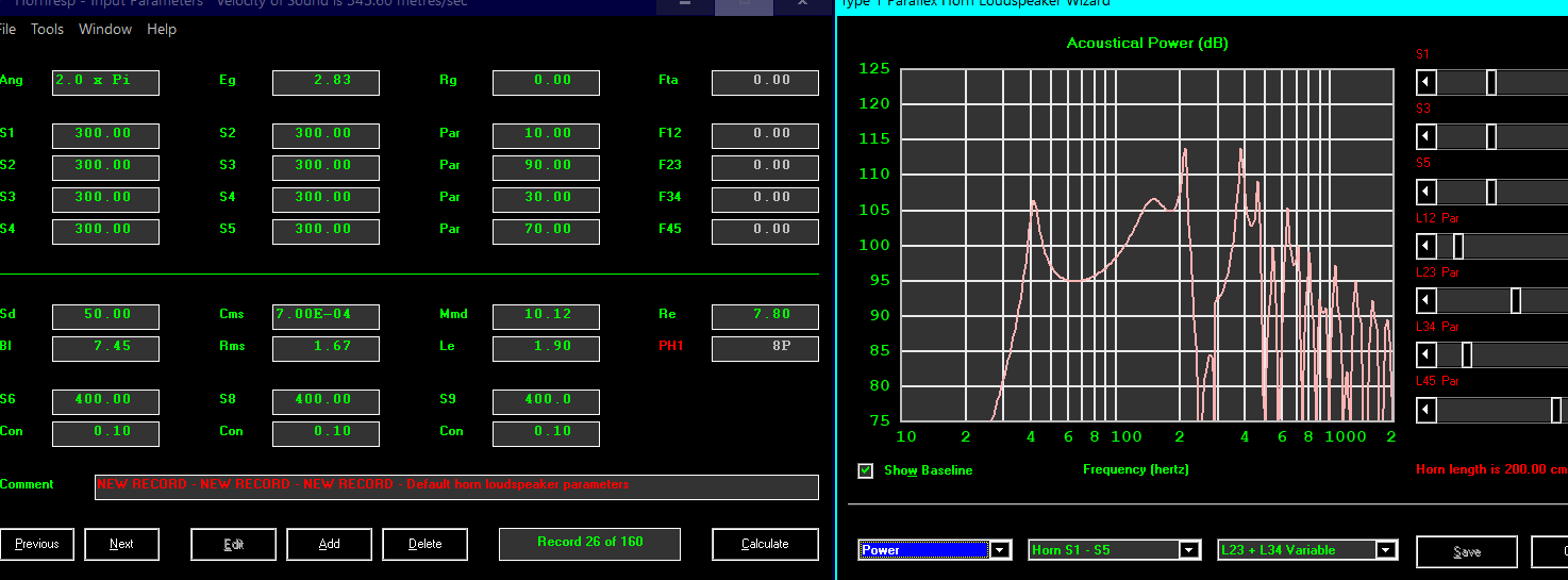

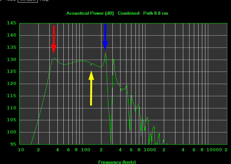

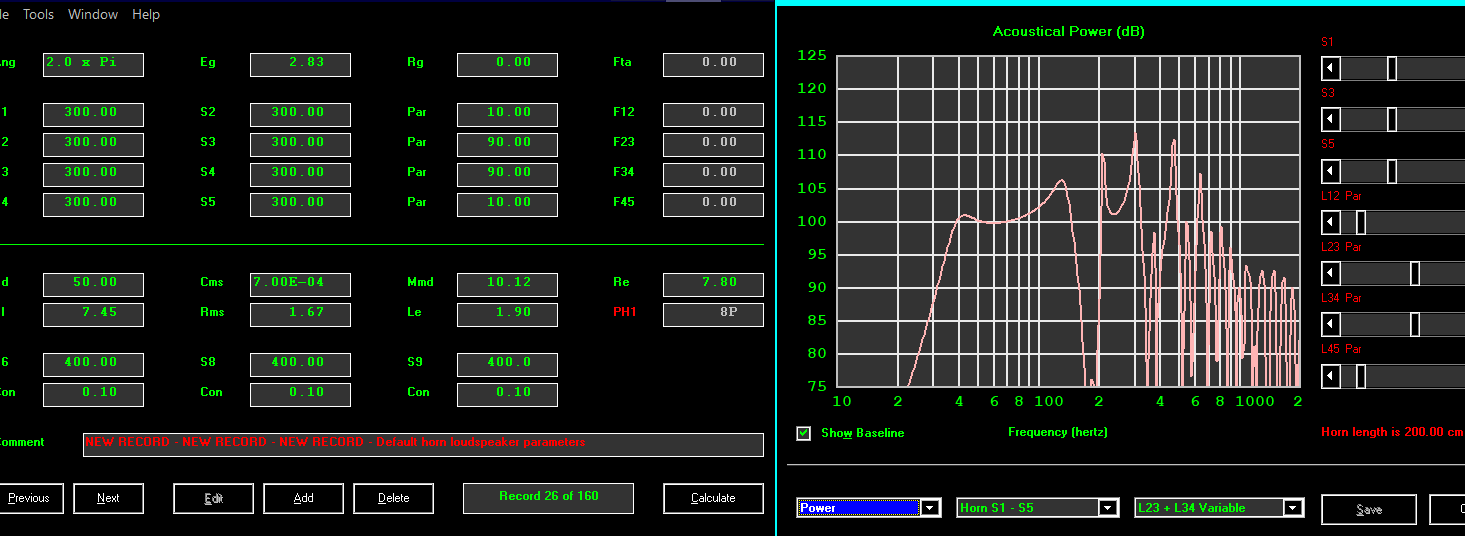

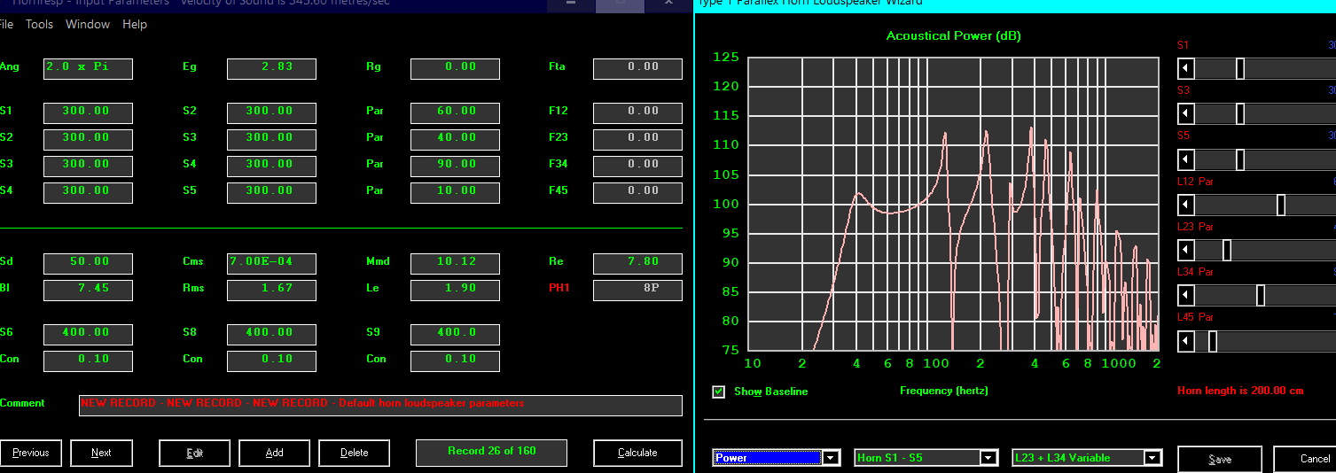

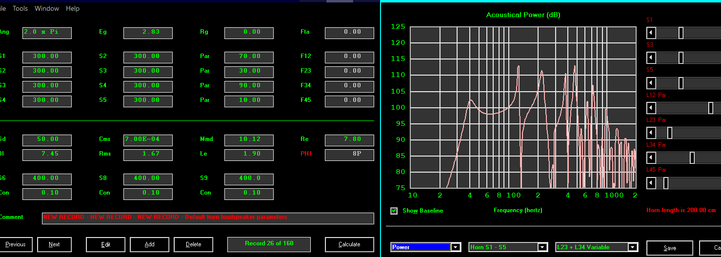

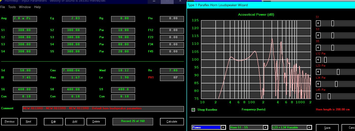

So what causes the saggy middle in the above sims ? tHe lack of a resonance in the system, except at the ends of the BW…. but the closer drivers together then the ‘more’ the cancel that sound increasingly (if that makes sense?) ?
I dunno how to explain it 🙈

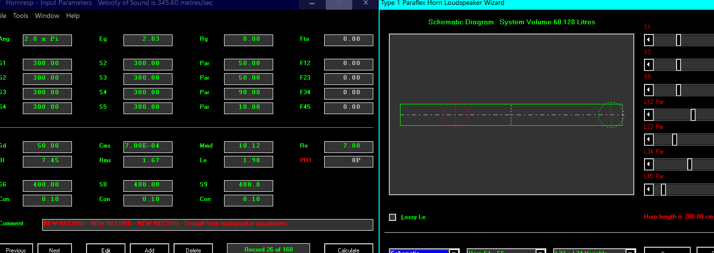

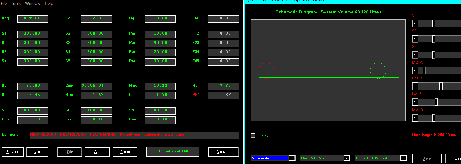

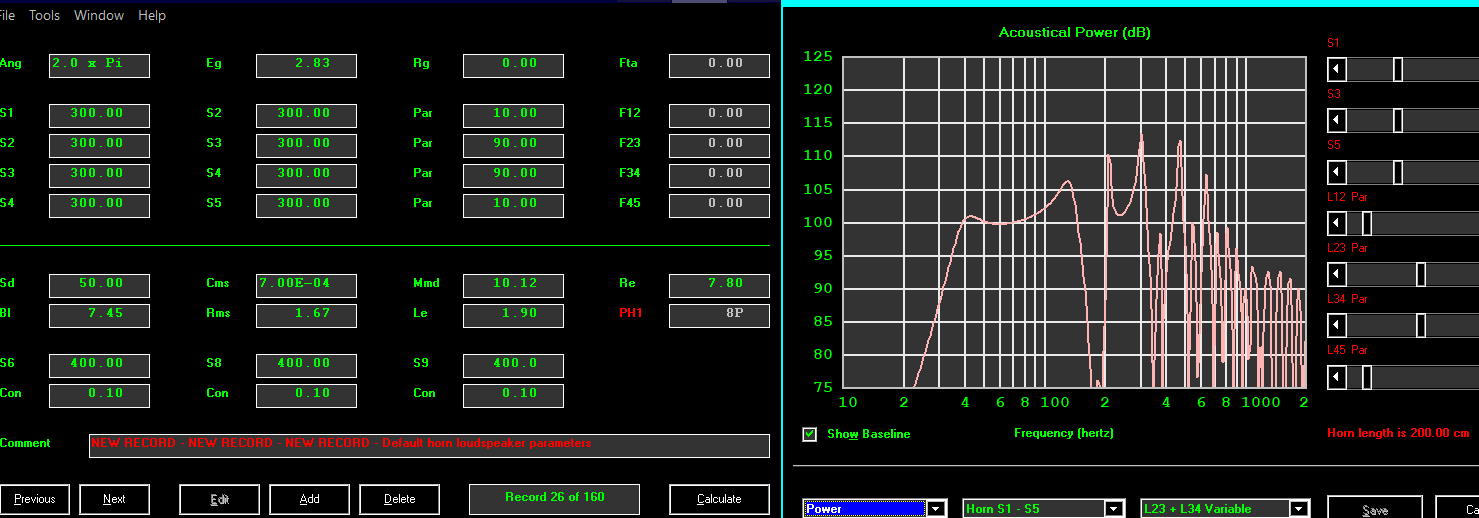

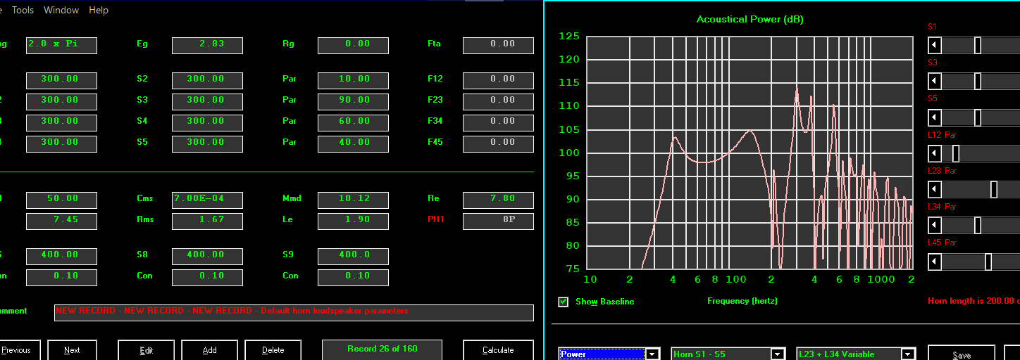

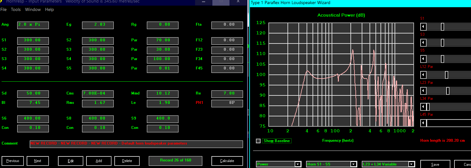

Moving the driver entry point in 'throat end' only all the way up to ’fixing’ the 3/4 harmonic in the last pic @ about 1/3-2/3.
What exactly does that offset driver entry do?
What exactly does that offset driver entry do? Is it a quarter Wave length of the freq it’s stopping from resonating ? Or is it creating an upstream helmholtz resonator?
stretching the distance from exit instead of entry and exit

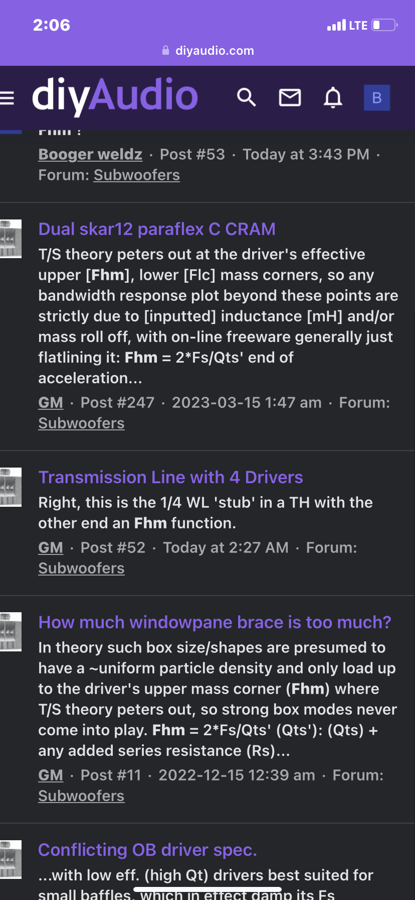

Right, this is the 1/4 WL 'stub' in a TH with the other end an Fhm function.

No:
upper: Fhm = 2*Fs/Qts'
lower: Flc = Fs*Qts'/2 (AFAIK only used for reactance annulled BLHs)
Qts': 2*Fs/Fhm
