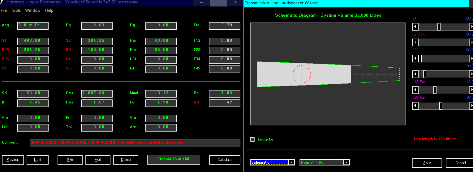

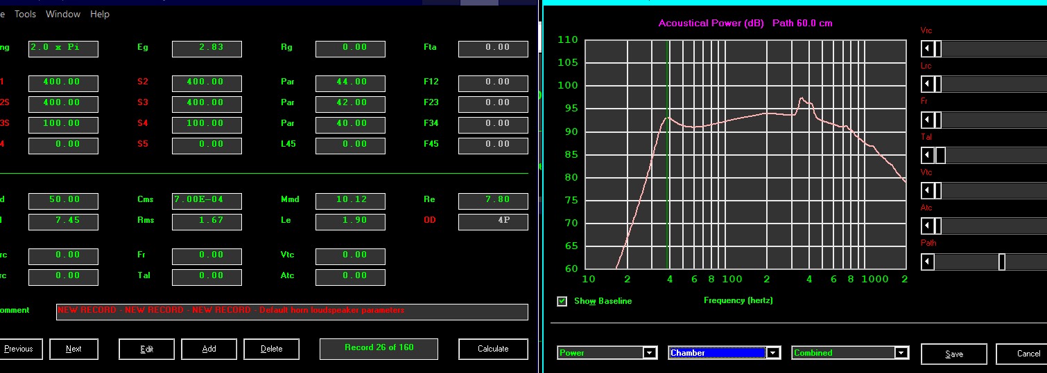

Transmission Line with 4 Drivers
I'd like to avoid that, if at all possible, Dave. Two side by side will give me most of the inherent problems that come with a traditional 4x10 bass cab, which despite being somewhat of a staple bass guitar cabinet, have a few flaws I'd like to deal without, hence the desire to stack all speakers vertically.

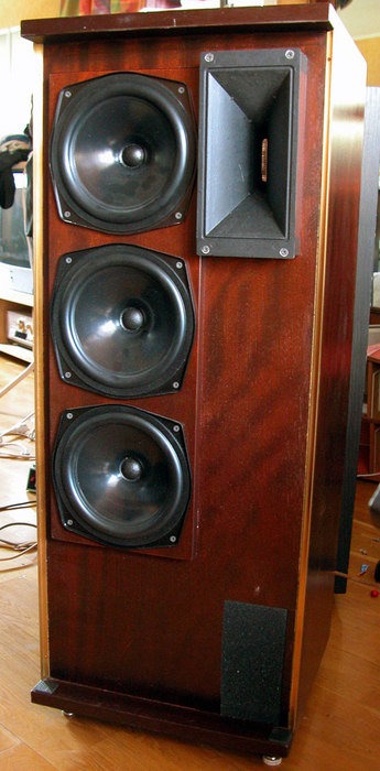

Audiotronic CM3 Pro with three KEF B200 in a Baily foldet TLS and Gamma VLD13 Ribbon horn

Typically a 0.5 aligned box doesn't have speakers in separate chambers. To do so, as you are describing would sacrifice a substantial amount of low end for little gain vs a simple first or second order low pass on speakers on one side.
A 0.5 alignment may yet be the way I go.
To me the biggest disadvantage of the traditional 4x10 is that they're cumbersome to move. Too small to wheel around like an 8x10, too bulky for one person to carry around easily. Hence my desire for a vertical 4x10.

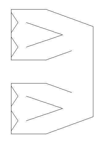

You can make the Bosɜ Waveguide, the serpentine, and divide into two Trunks, all the drivers are hidden. Problem number One being the acoustic isolation of the cabinet in accordance to its moveability.
Problem #2 Is the joint of the two parts
Thanks for sharing! That certainly seems like a nice design, which should work quite well with bass guitar. I believe that the fundamental frequencies of a 6-string bass guitar cover the frequency range from 31Hz–523Hz, while the harmonics can extend all the way out to approximately 4kHz–5kHz.
I wonder how those 3x B200 woofers were connected? Were they 16-ohm units?

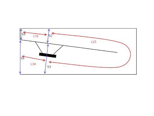

I like TL lines like anyone else, but they tend to require a larger box.
also agree 4x10 squares are hard to carry.
Vertical with dolly style castors is way to go.
lease lift more rolling.
I remember rolling my 8x10 past the 1x15 guys lol.
actually easier to roll than carry a small cab.
301 bin even lighter
Reactions: GM
Put two drivers on each of a front and rear baffle.
Wasn’t Martin, it was Chris & I initially promoting bipoles.
I would have suggested this, but the rear firing woofers are not going to work in a MI situation i think.
For bass, would not sealed with EQ make the most sense for small compact light with no limit on how low you can go. A TL will unload below tuning.

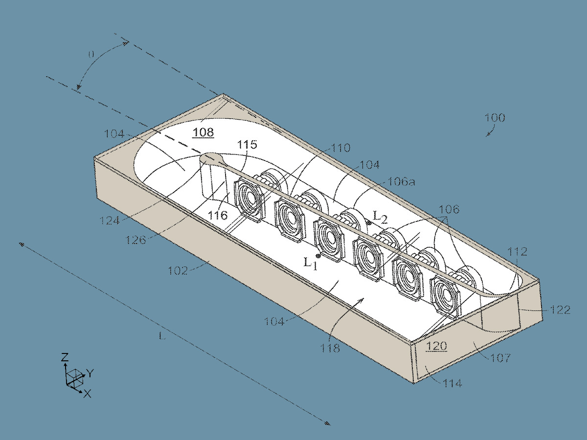

Hey so Danley filled his patent on 2006, after 20 years the patent expires so in 2026 what going to happen? The actual TH118 plans will be declassified or just means that only the theory for his tapped horn will be available and you need to design your own with his patent notes.
That Bose (supposedly) TL is nothin more than a TH or BP6S.
I thought TL are nothing more than flared port BR's.
This...
is the same thing as this...
The Bose enclosure just has more drivers.
