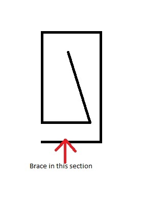

Hi Schmeet,
Actually I am moddeling a brace in the last section of the TL down it's lenght. The last section has a constant CSA, sort of a long port at the end of the tapered section of the TL.
Added a crude paint drawing to show the idea.

Hi Schmeet,
Yes, that is what I am trying to say, English is not my native langue so bear with me 😉
There is a small difference in the response, the first peak from the TL is a little bit smaller with the double port (~1dB), and I think it will make for a more rigid box.

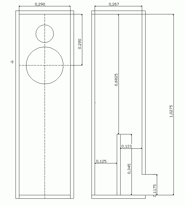

Hi, this is the enclosure that I reach to model using the program 1st version
internal measures are in meters
This is a modification of the Toby enclosure, object of another thread in this site.
It is intended to accomodate a 6 X 9 , highish Qts, fullrange driver.
Now I don't have a clue on how to reproduce the same design, with this new program release.
Can anyone show, with a practical example, how to simulate a very simple enclosure , like the one posted, in order to understand the new functionalities?
Many thanks in advance
J.

Mosquito,
Looking at your design, this is how I would model it in the latest version:
First of all, at the moment the driver is always at the 'beginning' of the enclosure as the model sees it. So from the driver there is a branch straight away:
There is the part above the driver and the part below the driver, so the first thing you would do is click on the first element '0' and clikc the 'Add Branch' button.
the new element '0.0' is then the bit above the driver so this has the following properties:
Length: 0.290
Areas: 0.267x0.290 = 0.07743m²
The element '0' is then the bit below the driver. Your design shows another split part of the way down the enclosure, so element '0' will be the bit from the driver to the split:
Length: 0.6825 - 0.290 = 0.3925
Areas = 0.290 x 0.267 = 0.07743m²
ok, so we have another split as you have a piece splitting the bottom of the enclosure into two halves (or branches). One is open and one is closed.
So click 'Add' to add another element (element '1').
Then click on element '1' and click add branch to create element '1.0'
Lets make element '1.0' the closed ended bit:
Length: 0.345
Areas: 0.125 x 0.290 = 0.03625m²
Boundary: Closed
So then, element '1' is the port, or open ended branch:
Length: 0.345
Areas: 0.123 x 0.290 = 0.03567m²
Boundary: Open
There is then also the bit of the port which is the thickness of your wood, which you could add on for extra detail, but its probably not needed here.
The images below show the geometry of the design...
I have a feeling this is not what you intended when you did this design. You probably wanted one large element 1.02m long and then a smaller port element?

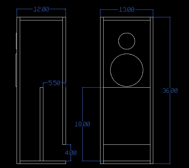

Hi Schmeet, by first, many thanks
No, what I wanted is a big element 0.68xx meters lenght, a sort of pre-chamber, and then a long narrower element, (folded) that is 0.345X2 meters lenght and then, an output port, that is 0.1175 X 0.290 meters in surface, and 19mm (0.019 meters) long.
(probably there is some "end correction" to take in account, air viscosity, etc, the port acting like a bit longer one, than the actual 19mm fisical measure.)
I think You nailed it, in post 146 picture.
Attachment included is the original design that inspired me to do this..
Thanks again
J.
