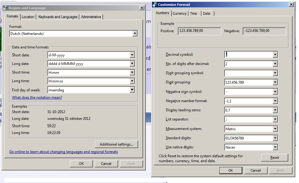

I found 1 small quirk. If you split a section and don't change the ratio (when you want it to be 0.5) the program just shows the split point window again if you press O.K. Then when you type 0.5 yourself it accepts it.

That's strange. It doesn't happen to me...
Do you use "0.5" or "0,5" ?

When the window firsts pops up there is already 0.5 filled in. When I just press O.K. the window pups up again. When I type 0,5 it accepts it.
Maybe something to do with my keyboard / language settings (Dutch format)? I am running win7 64bit on an Asus N76V core I7 notebook.

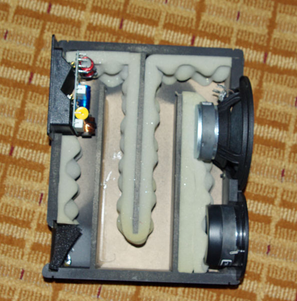

I'm new to TL models and I'm trying to model the attached design. It's a small enclosure (30cm x 23cm x 15cm approx.). I'm using a Peerless 5.25" HDS 830860, parameters I've entered into the the app. However, I'm having a hard time getting my head around the splits and branches, maybe because of the way I visualize them on the graphic page.
Any quick pointers on the process flow for this? It's basically a no-tapper line with 4 elements/branches.

Hi Zeinna, the enclosure that you attached is a TL with no taper and no branches. It is just one long element. You don't really need to model bends so just imagine the line straightened out.
It is only a branch when the air/sound litterally has two ways it could go.
P.S. for accuracy you can model bends by having slight expansions in the cross sectional area, but don't get bogged down in hat for now...
Yeah I think it is something to do with language settings. It doesn't recognise 0.5 as a number.
I have made a small change. Could you see if that works.

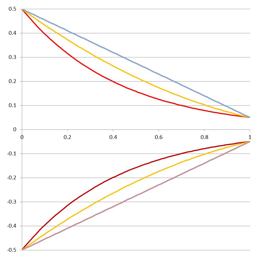

Latest update has given you the option of Parabolic, Exponential or Conical Taper for each element.

Okay, it seems 'parabolic' is equivalent to tapering 1 (or 2) sides of the cabinet, and 'conical' is like tapering all 4 (sort of a truncated pyramid), but what is 'exponential' equivalent to?
Look up the three terms on wikipedia to understand what they are. But essentially, I have always been doing Parabolic as a standard. A parabolic taper has a linear reduction in area thus when 'width' remains constant the other reduces linearly (Constant width TL).
Conical means that the radius (or diameter) reduces linearly. If your enclosure was spherical then it would taper at a linear rate.
Exponential means that it reduces exponentially 😉 This is what gives you that horn effect..
The graph below shows the shape each enclosure would have if the (other) width remains constant.
Yellow is conical, red is exponential.

Well, I doubt many will be curving the sides of their cabinets. 😉
I suspect changing the flare rate by slanting varying numbers of straight sides, however, will be commonplace if we can predict the results.
I have now updated it so that the geometry viewer shows the correct flare type.
If you have straight sides then your flare type will always be parabolic as the area will increase linearly.
