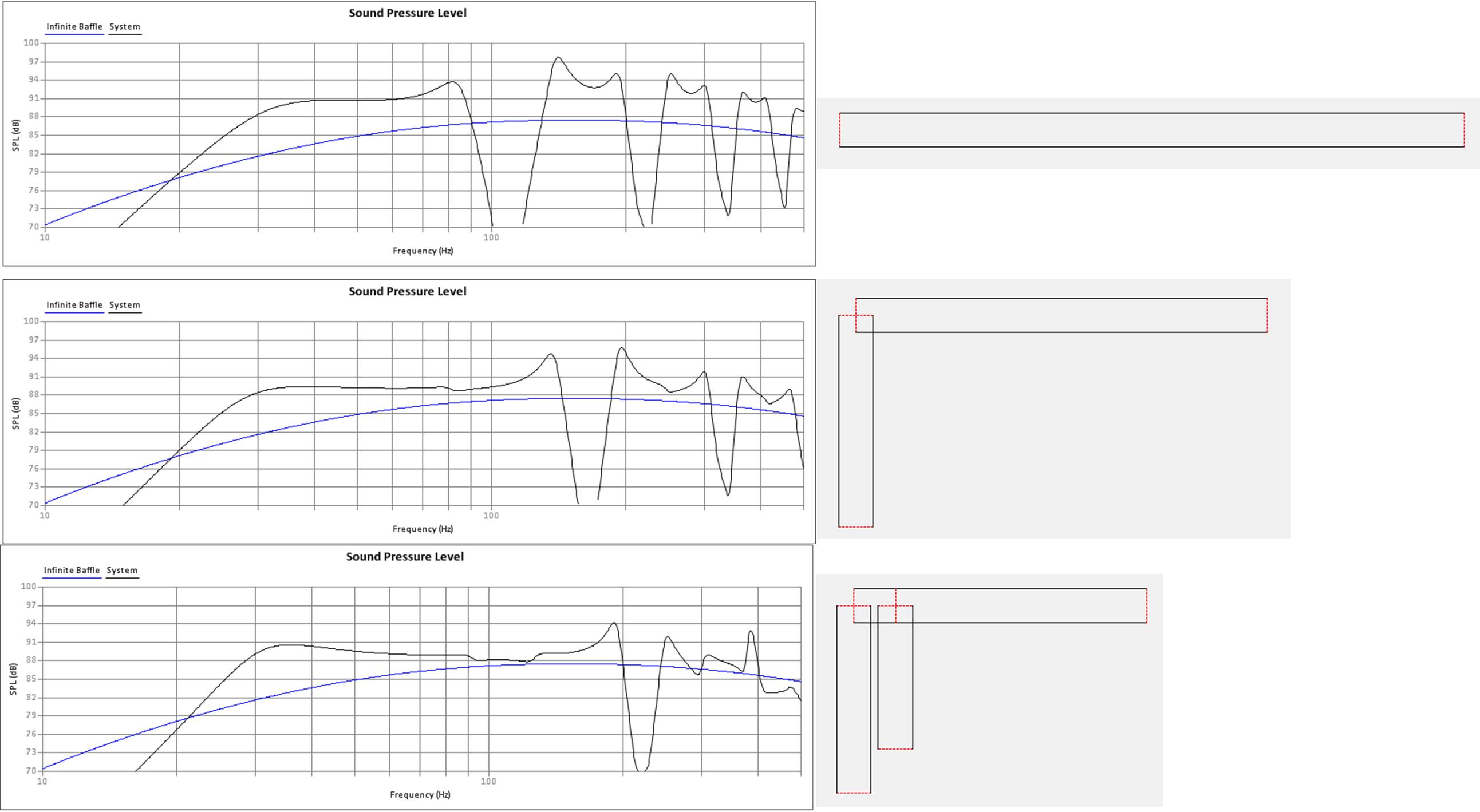

The attached image shows some simple geometries to give an example of what I think is possible by using multiple side branches.
You can see that there is less ripple from the upper harmonics using two side branches over one.
I haven't quite figured out how to determine what size these side branches need to be yet as it doesn't quite react how I thought it would. I'll keep playing though and see what i come up with...

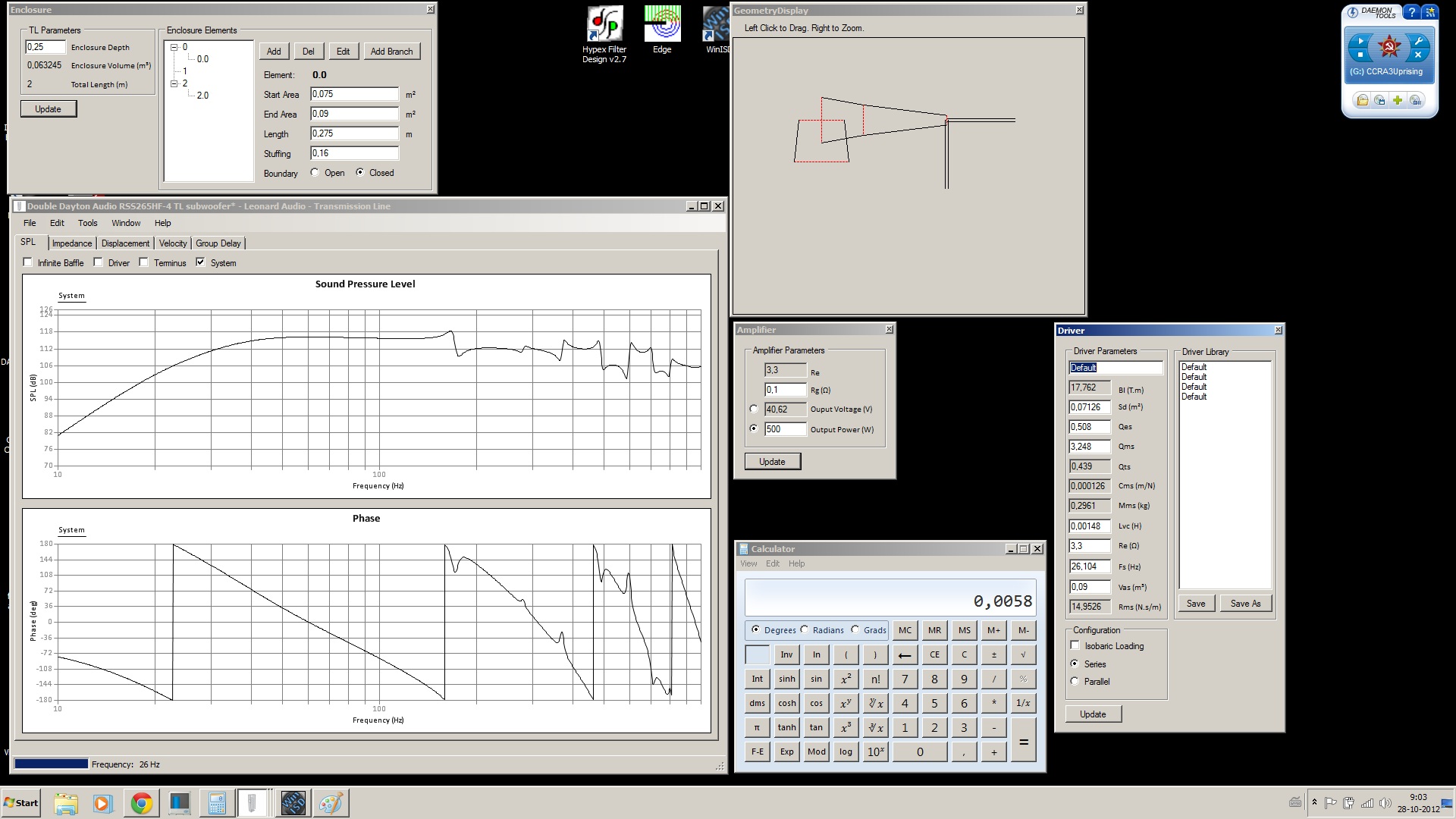

Hi Schmeet & Keriwena
Thanks for the help, it all makes sense to me now. as we say in Dutch "het kwartje is gevallen"!
The sim is a double Dayton Audio RSS256HF-4 each powered by it's own amp (Hypex PSC2.400D at max continues power), squeezed into a 65L enclosure..
