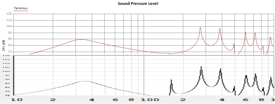

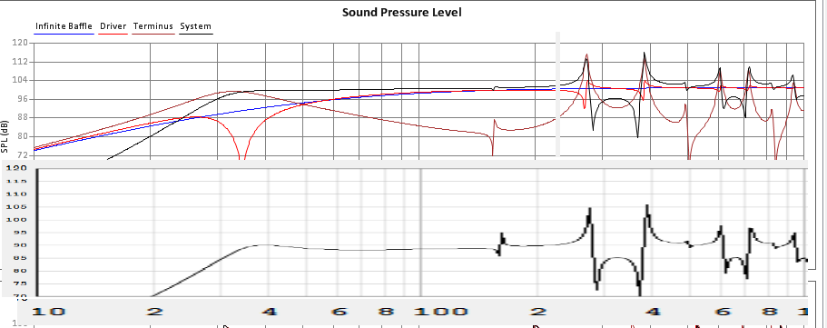

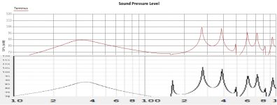

Sorry, in the image the first graph is made with a valor of 16w in amplifier, but with the same input level the graphs are almost identical

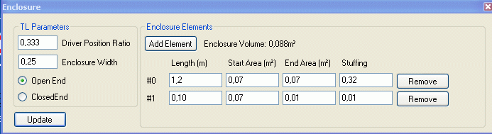

I have no experience with horns. Do you mean a rear chamber as well as a 'front pipe'? I would have to done some research to understand the best way of doing this. I will certainly keep it in mind.
With regards to sealing the terminus. In the enclosure window you can select 'Closed End' and you can indeed model sealed boxes.
I didn't see that. Great!

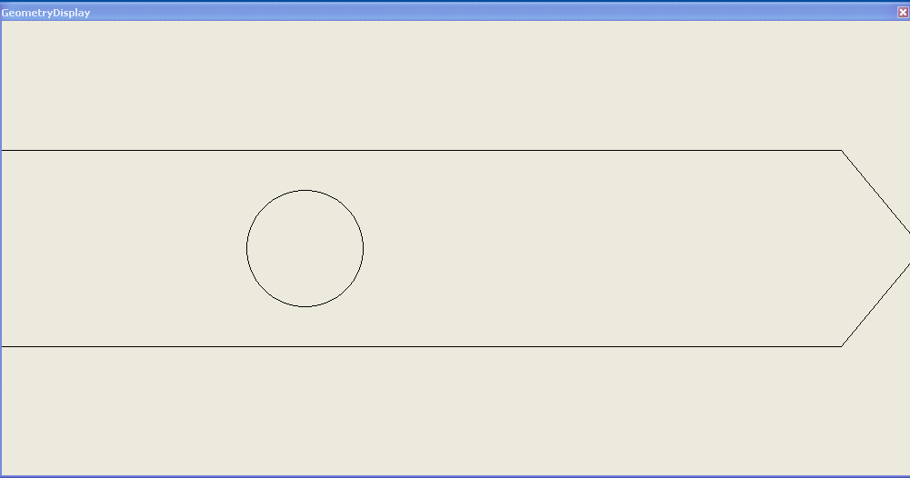

First impression is that input fields could be more userfriendly, liter instead of m3, cm instead of meters, cm2 instead of m3. Stuffing value etc.
I find it hard to actually see what I have entered for the Enclosure using several sections: Which Elements are to the Closed End, which Elements are to the Open End.
It would also be nice if the GeometryDisplay had measurements (cm) to ensure the Enclosure data had been entered correctly.
Sorry, my mistake. I now see what Closed and Open means by reading the latest replies.
