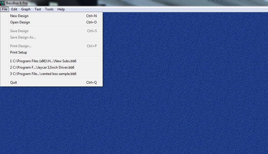

Again. No application ever has Save or Save As greyed out when you open a new project.
Ok well I guess that just leaves me and Harris Technologies... I respect your choice to do it differently.
I also disable it when any value is removed. The reason I prefer to do it that way is to avoid an invalid entry being saved.

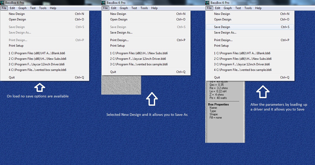

Ha. I haven't used BassBoxPro. (although I imagine when you start a new design the Save button is not greyed out?)
But I have used WinISD, Word, Excel, Publisher, Powerpoint, Bluebeam, AutoCAD, Notepad, Sketchup, Visual Studio, Photoshop. All of which follow the convention that when you start a new document you can click save and it has the same function as save as. 😉
You start with the default project loaded. I don't see an advantage to having nothing loaded, it just means there will be loads of Null errors that need dealing with until the user has entered something into every box.

By loading default values you don't have to worry about how to deal with a null value error. I prefer to control the buttons through enabling and disabling them once each value has been validated and all mandatory fields are filled.
If you validate the entry as it is being entered you don't have to check it at save time, again no right and wrong ways, just personal preferences.

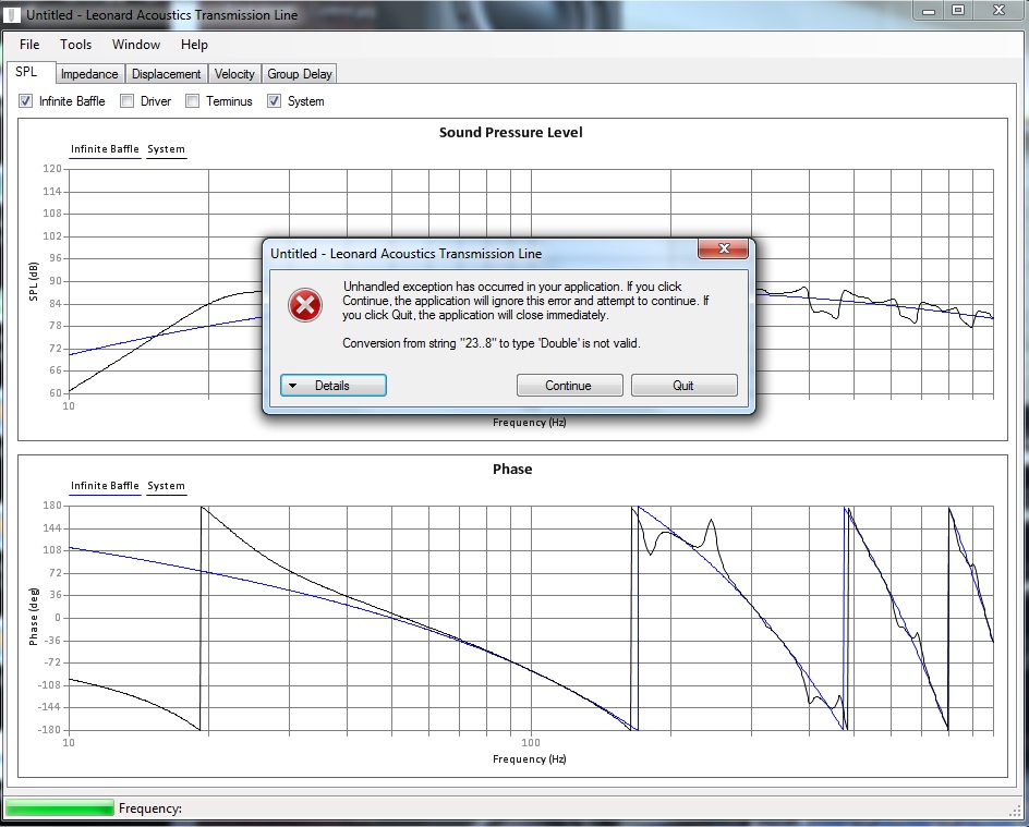

To generate the error… I changed some parameters of the default driver and saved it as a different driver name (At the time I couldn’t see a new project button to guide me through the creation process) I figured that must be how you create a new record.
I didn’t alter all of the values in the window, as I prefer to use WordPad to enter data. Since the driver parameters you want to enter are most likely in a document and not in your head, it is often quicker to just cut and paste the value into a text document.
I don’t think I would be the only one who does this as a quicker way to add data.

Copying the file, renaming it and cut and pasting the data is quicker than finding the right box on the screen and you don’t have to fight with the app that is trying to change your values on you.
But as you can see I deliberately generated the error by adding an extra decimal point to see if you were error checking on load, and to see if it would give me chance to change the value should it not like it. (exception handling)
When I write an app I try to make it absolutely fool proof, but there is no app too secure for a talented fool 🙂
