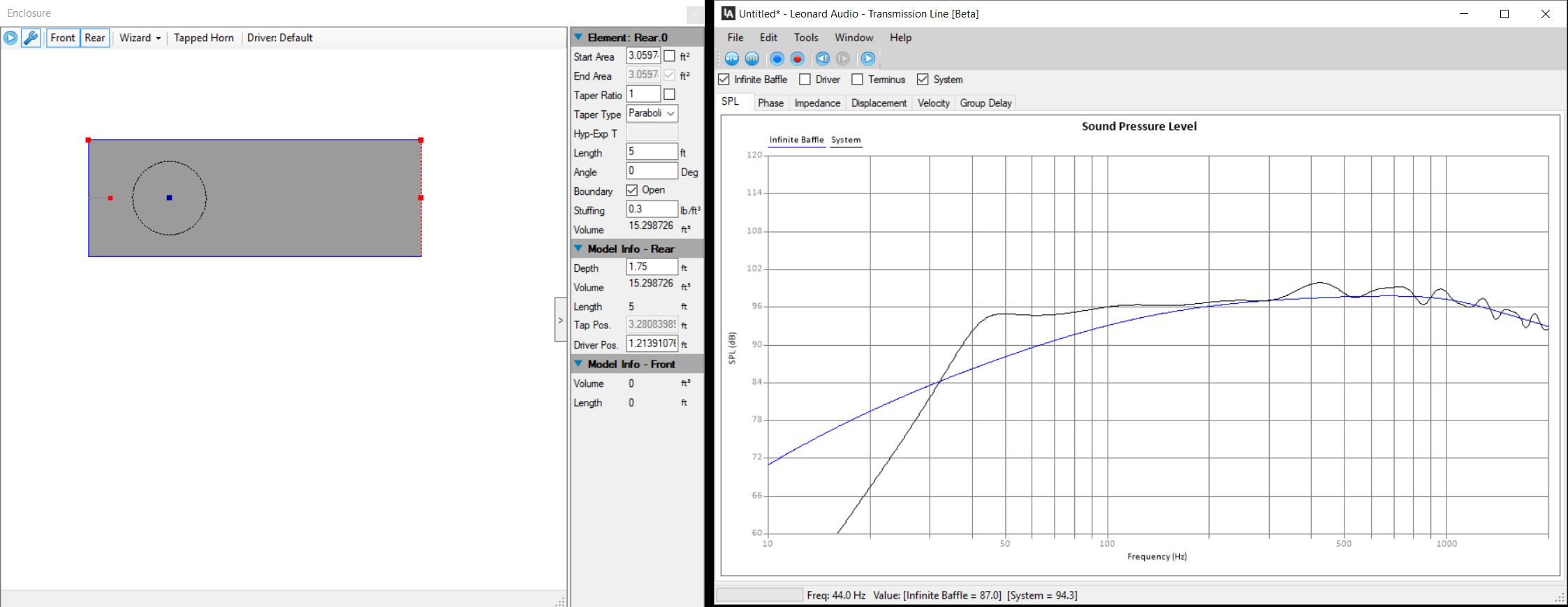

Could someone tell me if I am using this software correctly? I am trying to model a JBL 2225H in a transmission line enclosure. It's hard for me to tell if Leonnard Audio is showing me what would be considered a good response or a poor one.
One thing I did notice was that if I use the wizard for a straght TL and then manually tapered it, I got a different response than if I used the wizard for a tapered TL.
Before I build anything I just want to know that I am modeling this properly.

Hmm, when I convert a straight TL to one that began as a tapered one, i.e. all dims are the same, they come out the same, so assume there's some sort of input error.
GM
edit: Re the sim, yes it looks fine, there will be some HF 'ripple' and to get rid of it and keep the LF gain requires designing with about a 4-6 dB peak at Fb to offset the extra damping required.

Hi GM, Thanks for the help. It was user input error but I figured out.
Is there any chance you could take a look at the sim I did on this link and tell me if that looks good or if I could model a better design? I tried to design in a 4-6db peak and then use dampening to flatten it out. Is that the best process?
