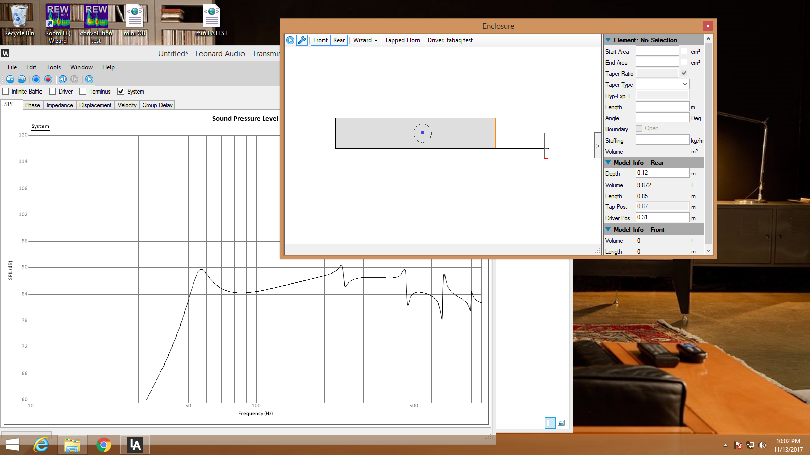

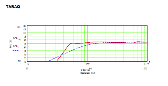

I'm trying to grasp how it works, so I made what I think is a copy of the TABAQ. I've seen the simulation from Bjorn, and built 2 pairs as well.
I split the first element into 2 parts so I could add different stuffing density, dense on top, nothing for the last 1/3 of the line. I then split the 2nd element and added a branch to it, which is I believe how to add a port. I put that on the bottom.
Here's what I get, and I'm not sure what to make of this. It follows the general cutoff frequency as in Bjorn's simulation, but here, I have this big initial first hump.
Anything I should've done differently?

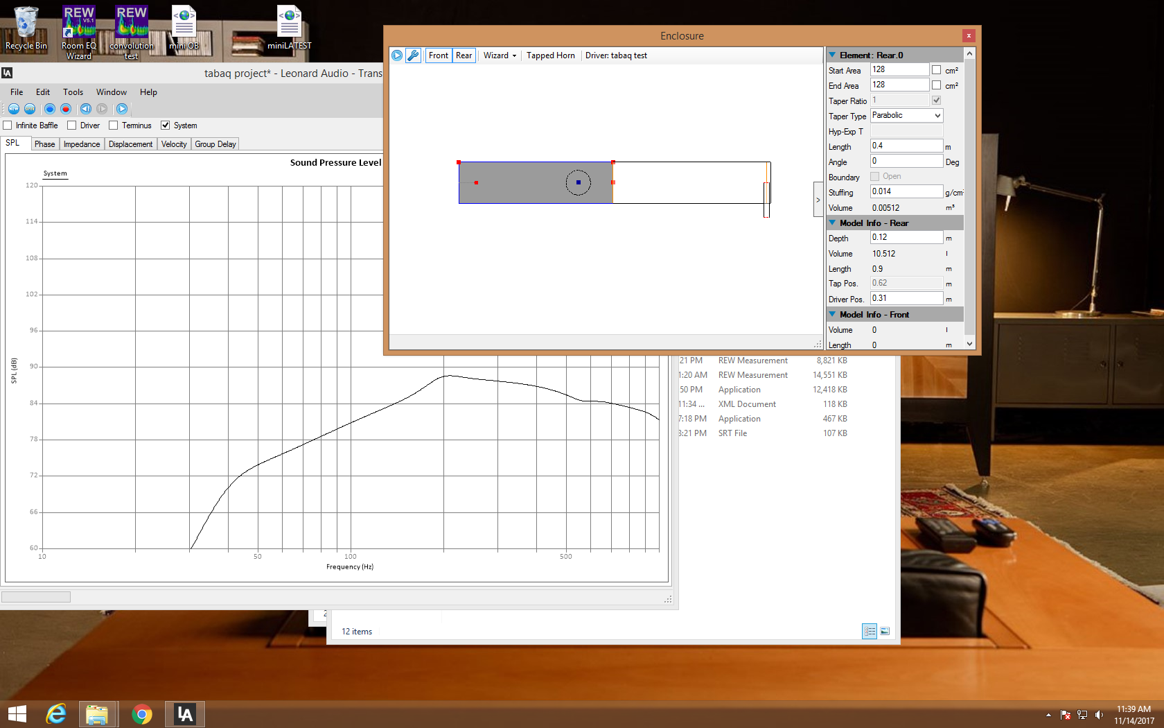

I guess my stuffing was too light.
So, the TABAQs were designed for about 70g of stuffing in the top part to just under the driver.
I figured about 40cm from top to a little under the driver. By 12.8cm deep and 10cm wide, that's 5120cm3.
70g/5120cm3 is about 0.014g/cm3.
If I change the first element's stuffing to 0.014g/cm3, this is what I get:

Thanks all and zman for the test sim.
First, I now realized that even though I keyed in W3-315SC in Google, I got the specs for W3-315E instead. I replaced the specs for the right ones, and changed the stuffing to 0.2lb/ft3.
I got the same looking sim as yours. So, that's cool.
But... Bjorn said the stuffing should be 70 to 100g per TABAQ, so that comes up to 0.154 lb. or a stuffing density of 0.85lb/ft3.
Putting 0.85lb/ft3 makes for a way too much damped response looking like my previous example.
Now, I know the TABAQ works well with 70g stuffing, but according to this TL software, I shouldn't get the response down low I actually have.
So, where and how to overcome this discrepancy?
