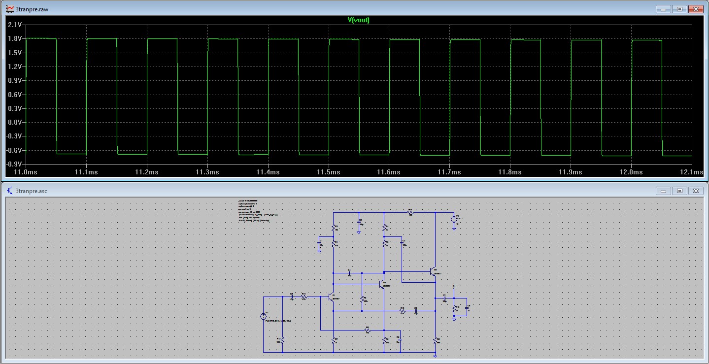

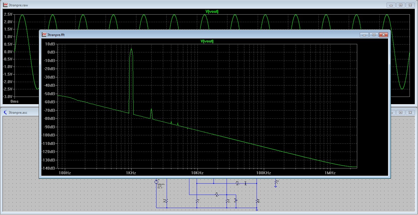

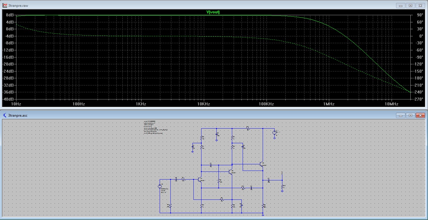

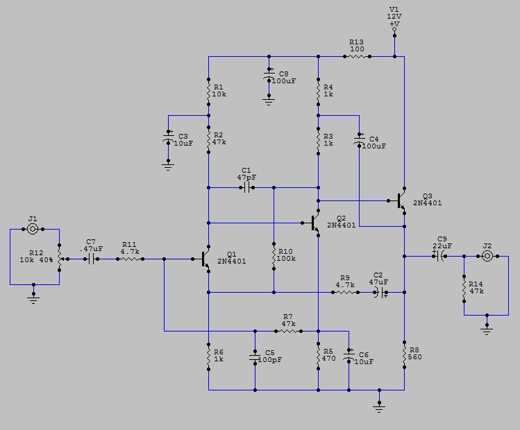

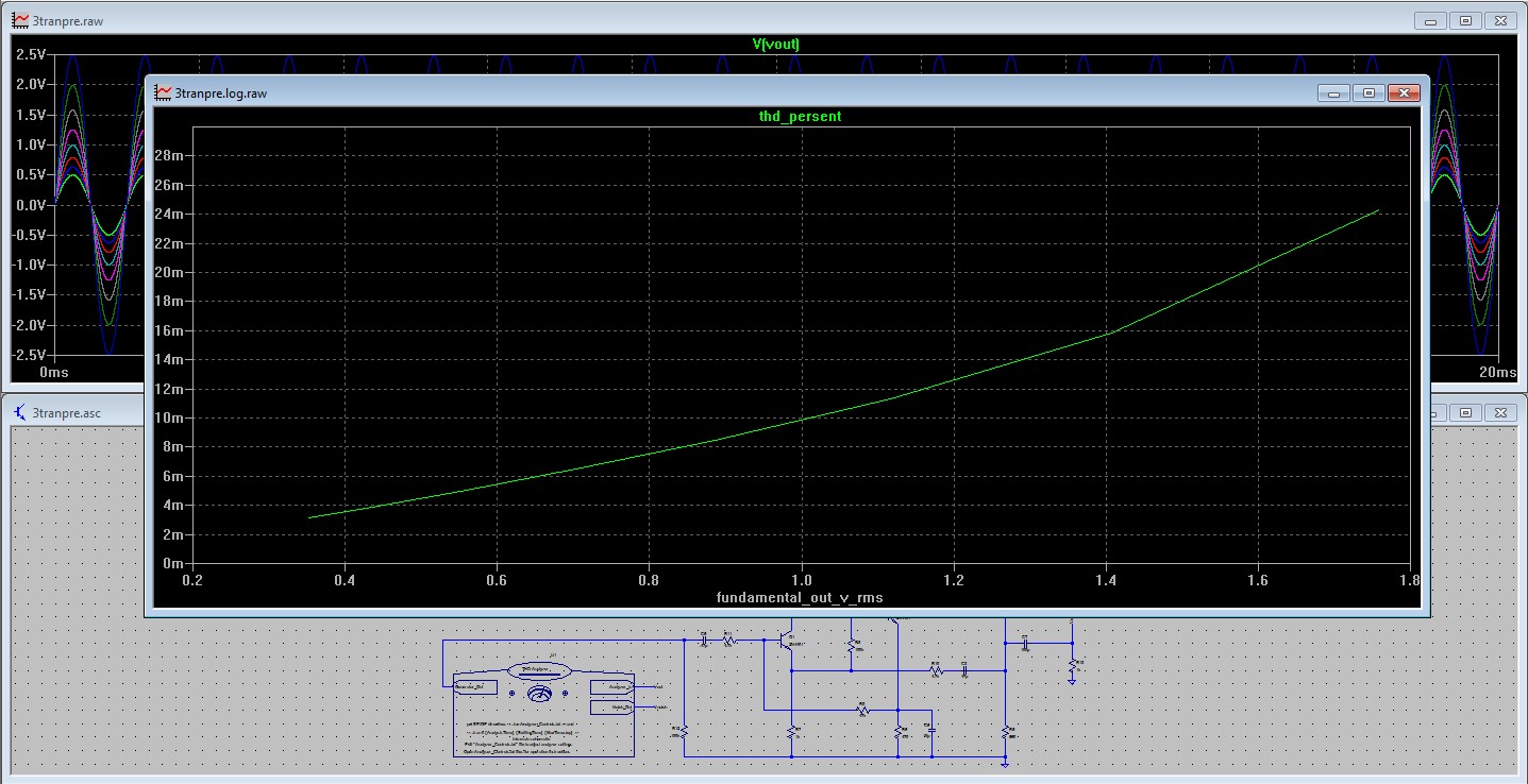

Just for giggles these are the sim results from the circuit I posted earlier. All these are with 1k load (the load I'm driving with it) and the 10k square is with 1nF in parallel.

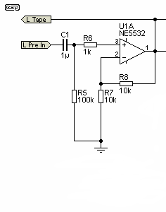

Instead of making accusations that the NE5532 sounds "muffled" and "the sound was very low and distorted, why don't you post the actual circuit you attempted to use the '5532 in?
If you haven't implemented the chip properly, how can you expect it to work??
The '5532 is easy to use and will certainly sound as good or better than most of these 2 and 3 transistor circuits posted in this thread so far.

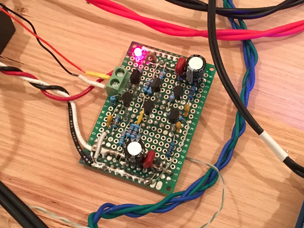

I built one channel of the Apex BJT preamp. 6 transistors and miscellaneous parts make it just as complicated to build as a full blown power amp. 🙂 I am using 100R vs 82R on the output stage resistors and 100pF vs 82pF on the caps. Running 25v rails (same as the M2 amp).
Schematic:
I matched the Hfe's of the transistor pairs of same sex but could not match perfectly NPN and PNP, so this gave me offset of 30mV. It has a lot of drive capability but listening to it, sounded a bit "fuzzy". The gain was nice and put the M2 into the right ballpark for decent volumes from my DAC output.

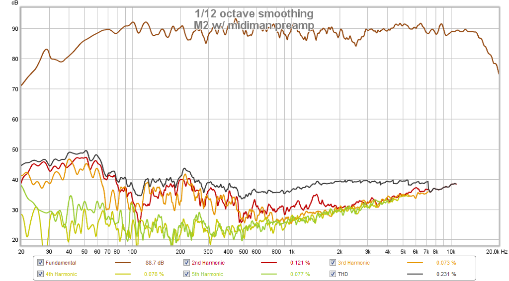

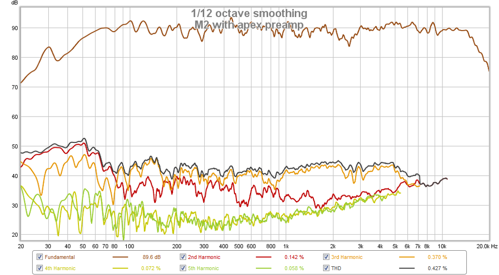

Measurement of the sound from my speakers with my calibrated mic rig showed an increase in distortion vs the 18 channel mixer I was using for a preamp, and most of the distortion was H3. I am not sure why such a simple discrete pre-amp that has similar topology (differential LTP and complementary output) as my Apex power amps would have such high distortion? Maybe veroboard is not as good as PCB?
HD with Apex 3.1 preamp:
HD with midiman 18 channel preamp:
I don't think this is going to work for me, too much distortion.

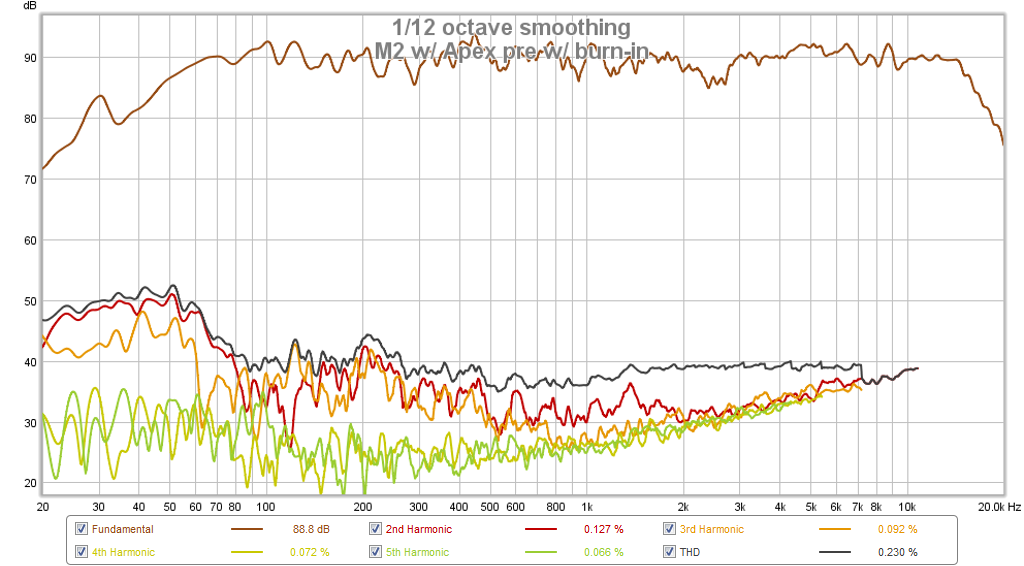

I take back what I said above about the Apex preamp. I just witnessed burn-in before my eyes. After playing for a while, the distortion is just as good as the commercial preamp. I guess I have a good circuit then. Here is measured HD at the speaker with burn in:

I made the same circuit as mentioned ESP website. Used the same values and same layout. I have attached the layout.
I can't see the layout...I made the same circuit as mentioned ESP website. Used the same values and same layout. I have attached the layout.
Attaching it again....
