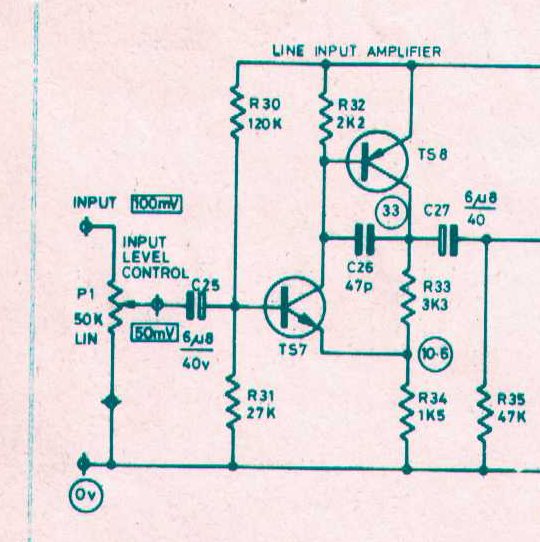

The OP asked for transistor preamp, lets give him what he wants.
I built this one also and the results are very good.
A Simple, HIGH QUALITY Transistor Preamp

Very high gain again, designed for the Mic / Phono stage.
The OP is asking for a line stage with 4-6 db gain.
A number of good options is already presented.
Not Been Build Yet

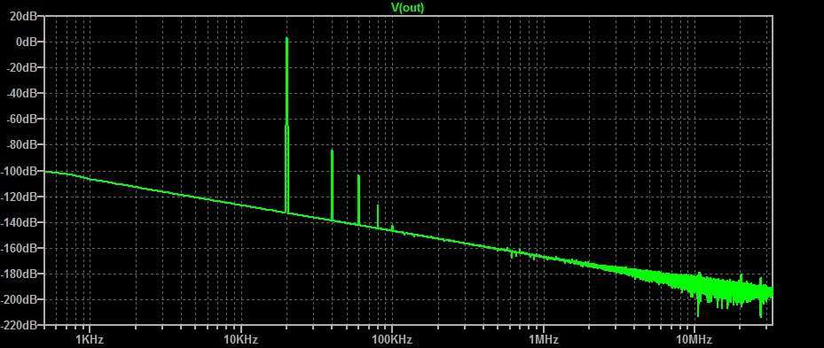

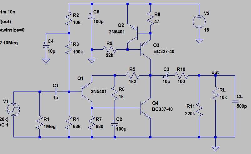

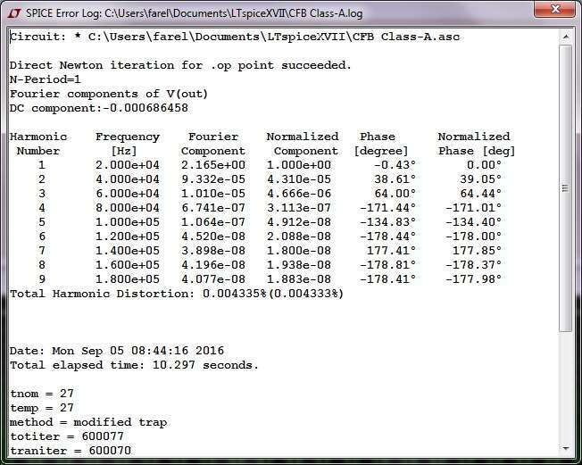

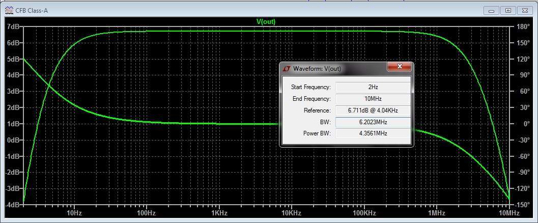

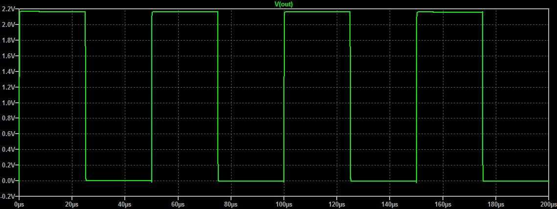

Discrete transistor, Class-A (12mA), Current feedback, gain of 6dB.
Fast & low THD (0.0043% @ 20kHz; 2Vpk; RL 10k; CL 500p)

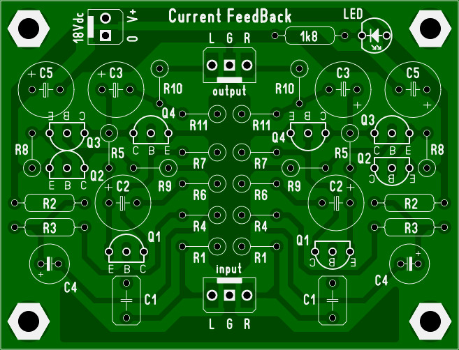

Not been built yet, but should operate well.Any good small, easy, high fidelity transistorised preamplifier circuit that i can build ? Plan to use it with my DIY power amp. The preamp should be able to accept ipod level input.
Any help would be appreciated.
This circuit is simple and suitable !
Part numbers for the transistors and operating voltage??

Thank you.I saw the schematic and it has ceramic pickup and magnetic pickup. How can I modify it to work on ipod level input?

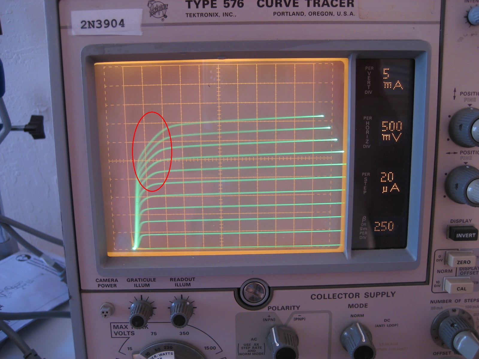

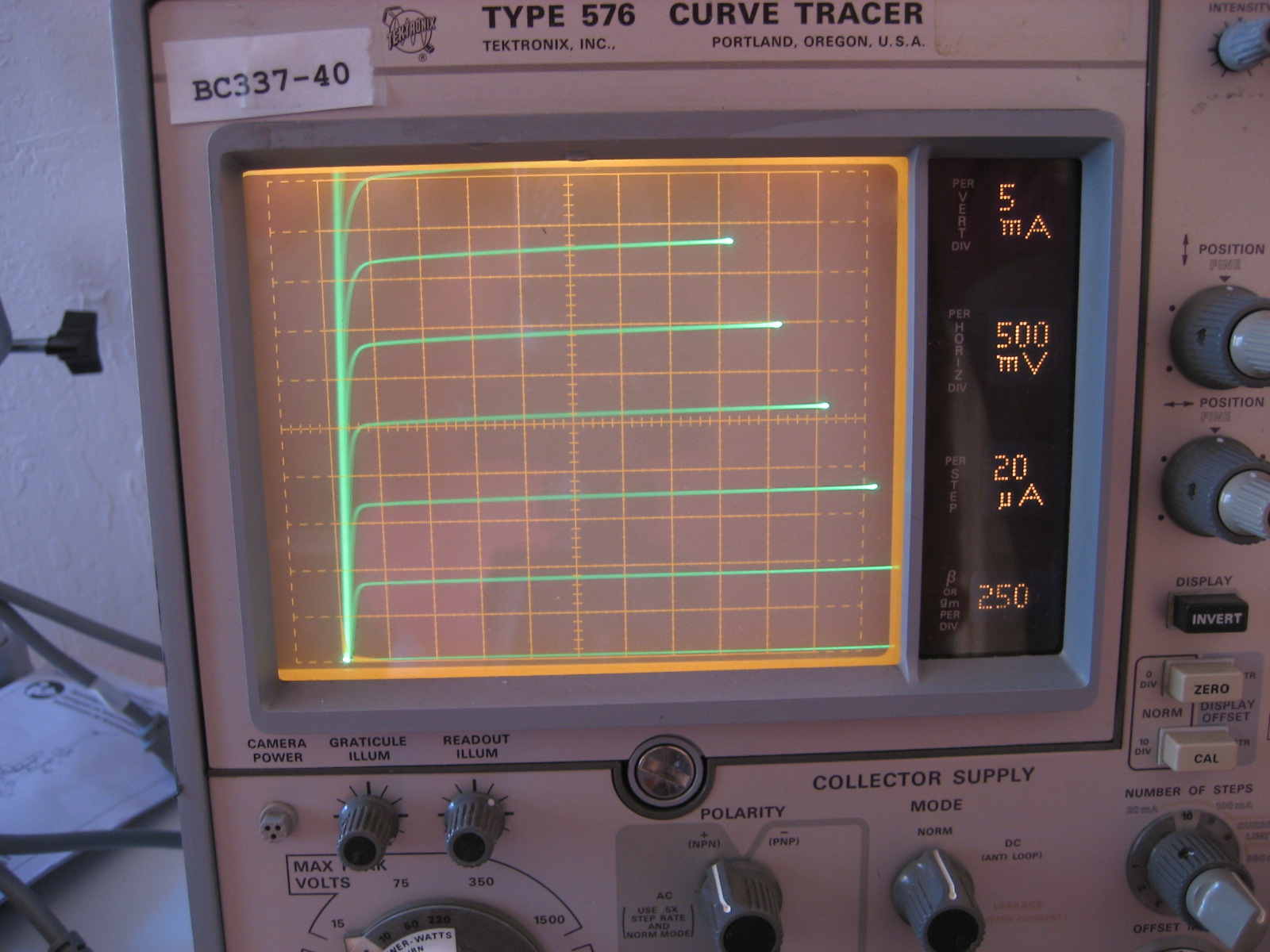

It's a good performing & well behaved transistor, first image below. I bought 200 of them (total cost: $13.50) from Mouser: sales linkAre there any alternatives to the BC337?
