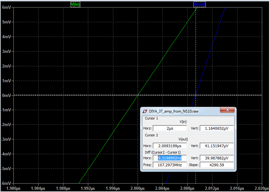

If you turn Bongiorno's preamp upside down, and power it from +30V instead of -43V, you get something similar to the NS-10 preamp that Nelson Pass designed for Threshold in the late 70s.
The Threshold NS-10's product name came from the amazing fact that its signal propagation delay, from preamp input to preamp output, was ten nanoseconds: NS-10. So I thought, why not fire up the simulator and try it on the Bongiorno/NS-10 circuit in post #29? Let's measure its input-to-output prop delay.
The simulator's answer is: 9.32 nanoseconds (blue highlighted text). Well done chaps.
(you can make it faster still by decreasing the compensation capacitor C3; I've set it at 15pF which gives zero dB of gain-peaking. If you're comfortable with, oh let's just say, +2dB of gain peaking, reduce C3 and get higher bandwidth and lower propagation delay.)

Hi,(you can make it faster still by decreasing the compensation capacitor C3; I've set it at 15pF which gives zero dB of gain-peaking. If you're comfortable with, oh let's just say, +2dB of gain peaking, reduce C3 and get higher bandwidth and lower propagation delay.)
I simulated this nice circuit, and LTSpice said it can put 4V pk pk over a 10K load even at 250Khz, with minimum distortion.
Nevertheless, using exactly the same models as You (Cordell), I can t get away with less than 27p for C3, or there is gain peaking (+2dB with 15p).
Yes Mosquito you're right! At the last minute I increased the first stage's bias current to 300uA but forgot to also resize C3. Oops.
C3=15pF is sized for a 200uA first stage. To see that 15pF does indeed give 0dB of gain-peaking in that case, simulate with
I think you'll probably decide you prefer the 300uA design with resized C3.
- R4 = 3K (first stage collector load resistor)
- R6 = 75K (first stage emitter bias resitor)
- R5 = R7 = 680R (feedback gain setting resistors)

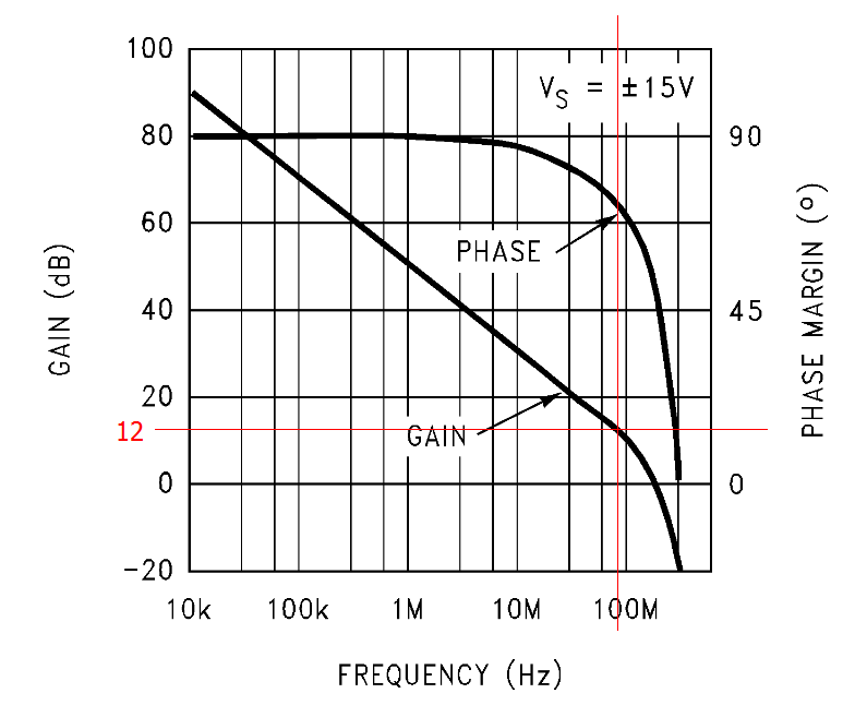

I prefer to pay $2.80 for the LM7171, the chip mentioned in post #47.if you take TI Burr Brown's OPA627 and arrange a 2-resistor divider for a feedback - you get a top quality line stage. It does not sound. Wire with gain ... Expensive (local suppliers are selling then at around $20 per chip), but perfect for the purpose.
If you arrange its 2-resistor feedback network to give a gain of +12dB as mentioned in post #46, the LM7171 delivers 75 MHz bandwidth and gives a phase margin greater than 60 degrees (vertical red line). For the same price as a dozen eggs.
I'm not very attracted to the dematerialized music and I doubt that the source (iPod) to be able to feel an audible difference.....I like raw, warm sound , like how tubes sound...
