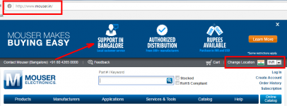

The problem is that I live in India and octopart shipping would be very expensive. That is why.I was considering substitutes.
I am willing to try this design if anyone can help me with suggested 2016 values. I am a complete noob.
Joined 2011
Octopart is not a seller. Octopart is a search engine. It is telling you that the sellers named "Mouser" and "Digi-Key" both have these parts in stock.

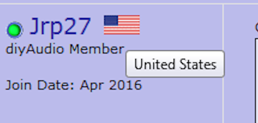

Mouser and Digi-Key have a huge presence in the USA, which is where diyAudio says you live, see figure 1 below.

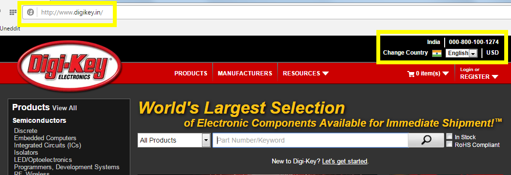

Both Digi-Key and Mouser seem to have an Indian website, see figures 2-3. However I have never asked them to ship to India, so I have no actual data about whether it's fast, slow, cheap, or expensive.

Why do you claim to live in USA while you are actually 10000 miles away?
It certainly does not help us to help you.

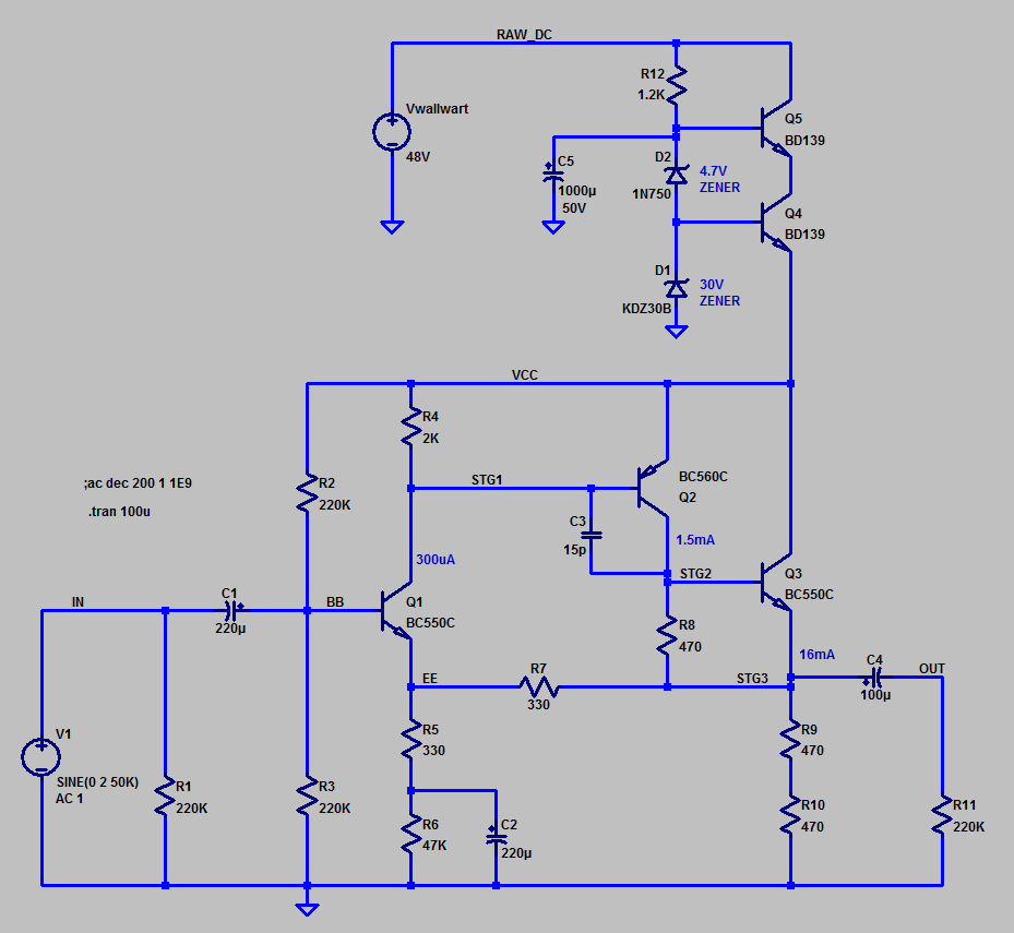

If you turn Bongiorno's preamp upside down, and power it from +30V instead of -43V, you get something similar to the NS-10 preamp that Nelson Pass designed for Threshold in the late 70s.
I've reimagined it using modern BC550/560 transistors, and configured it for a flat frequency response with gain of 2 (6 dB). Gain is (1 + (R7/R5)). I've also updated to a 48VDC wall-wart, followed by a cascoded voltage regulator using modern medium-power BD139 devices.
The 16mA emitter load resistor (dissipation is 15*15/940 = 240mW) is split into two halves, R9+R10, so that each resistor only burns 120mW.

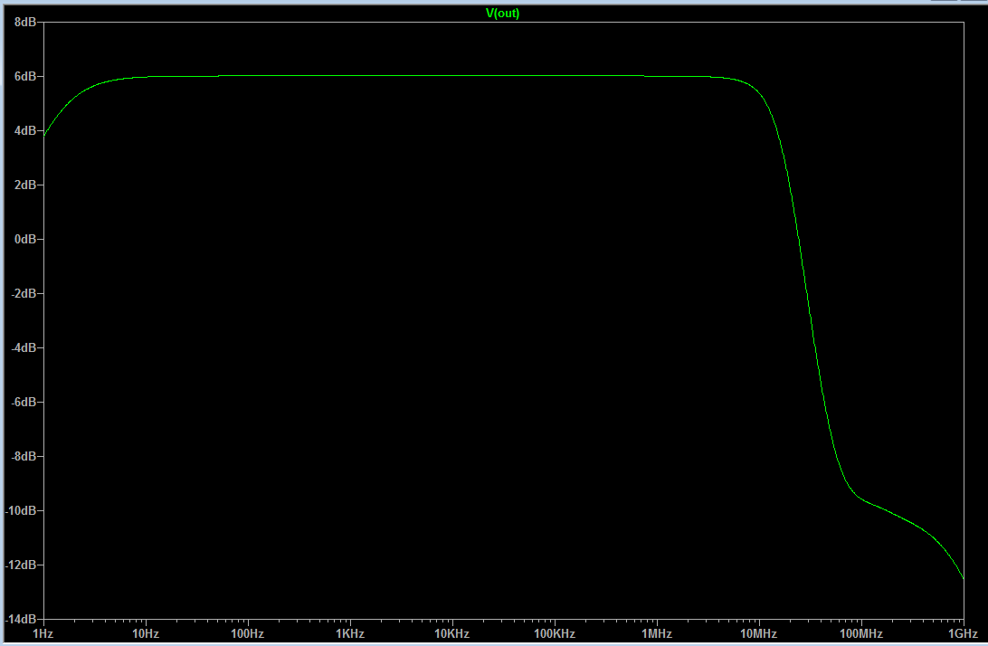

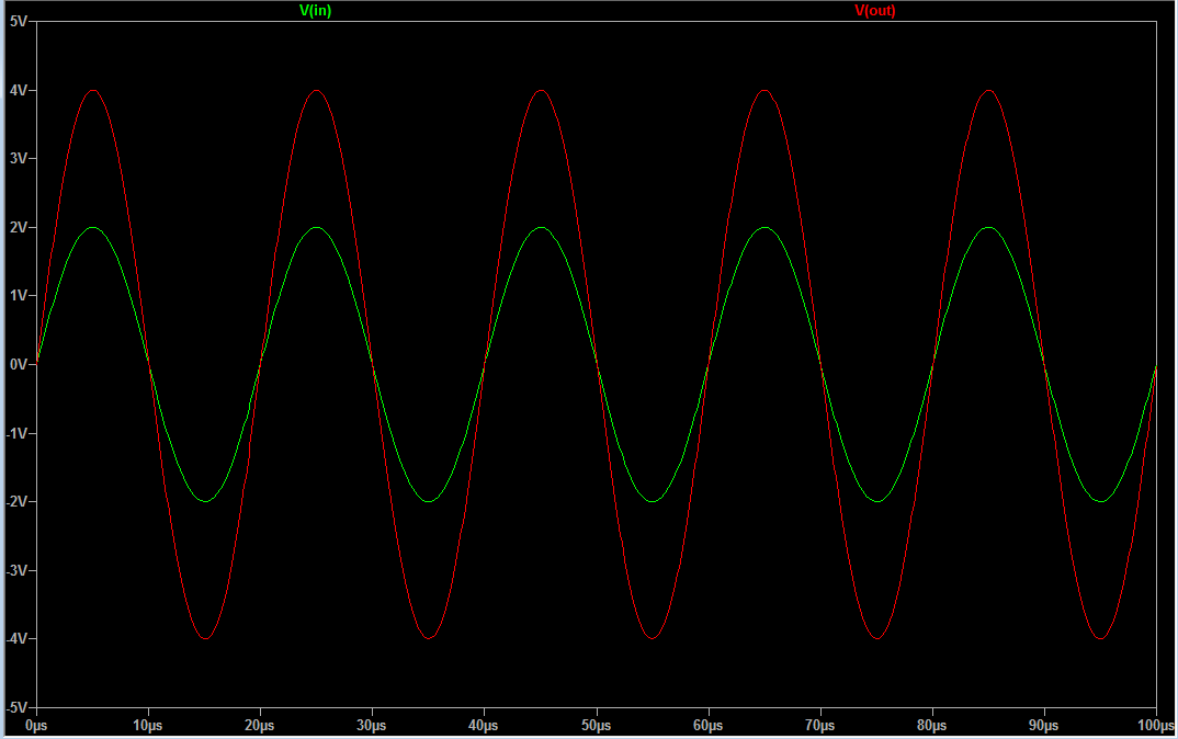

Figure 2 is the frequency response and Figure 3 is the transient response to a 2.0V, 50 kilohertz sine wave.

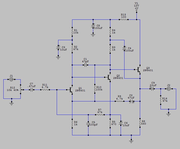

I use something like what Mark is proposing. A 3 transistor circuit also. It has very good psrr, low distortion, and a good clean sound. It generally doesn't require any extra filtering for the power supply. I use a standard rectifier/capacitor supply with no audible noise (although the transformer and caps are considerably larger than is needed).
