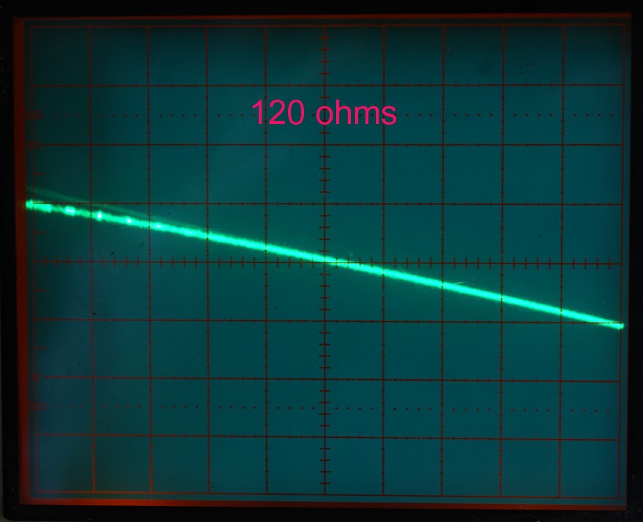

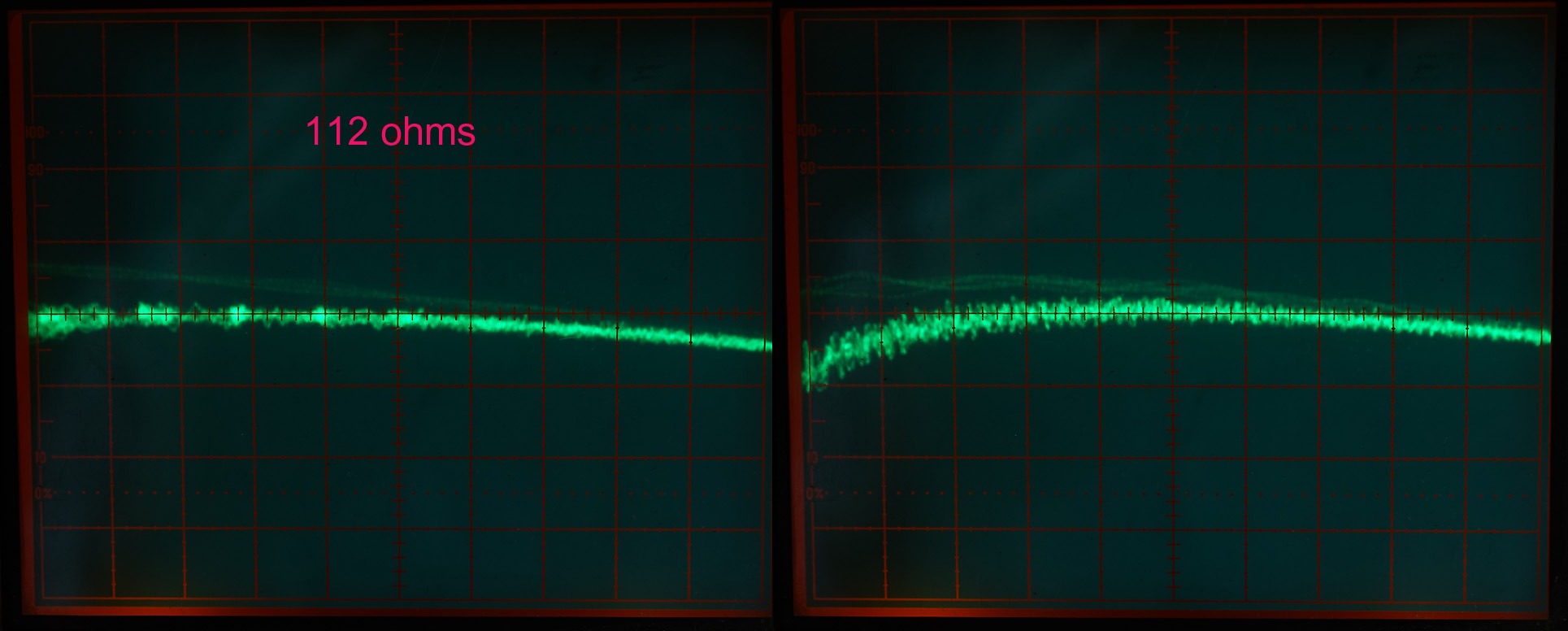

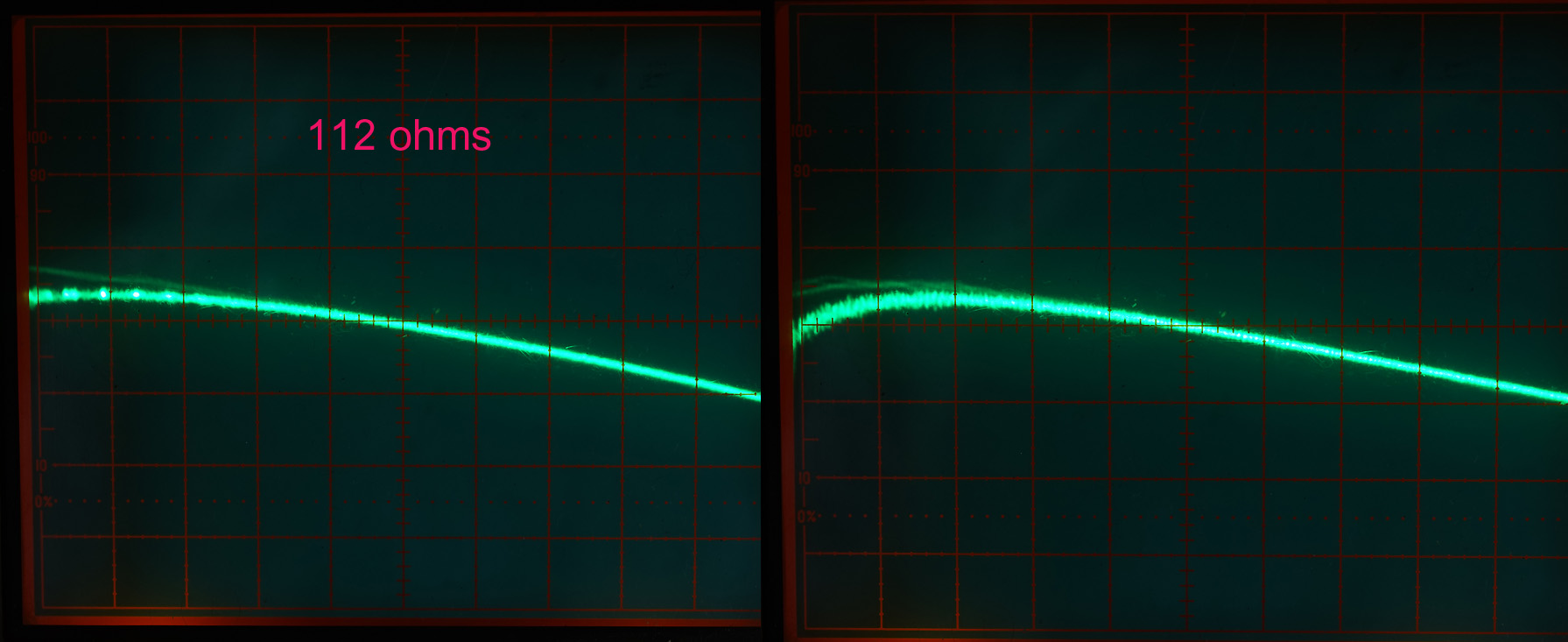

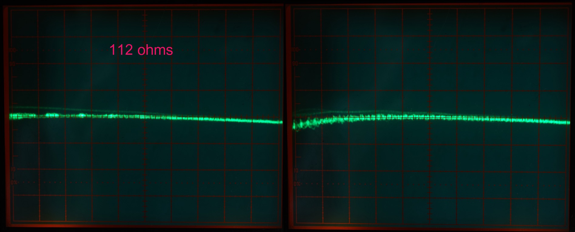

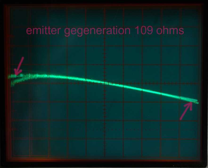

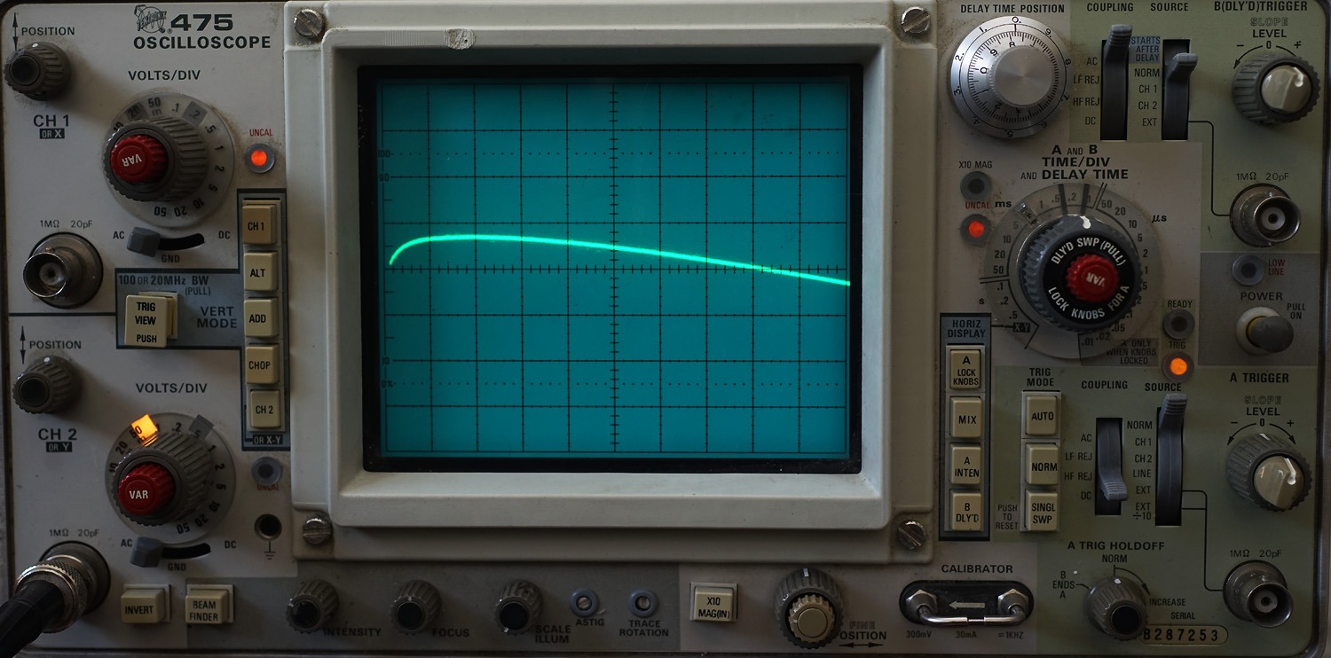

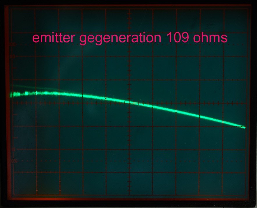

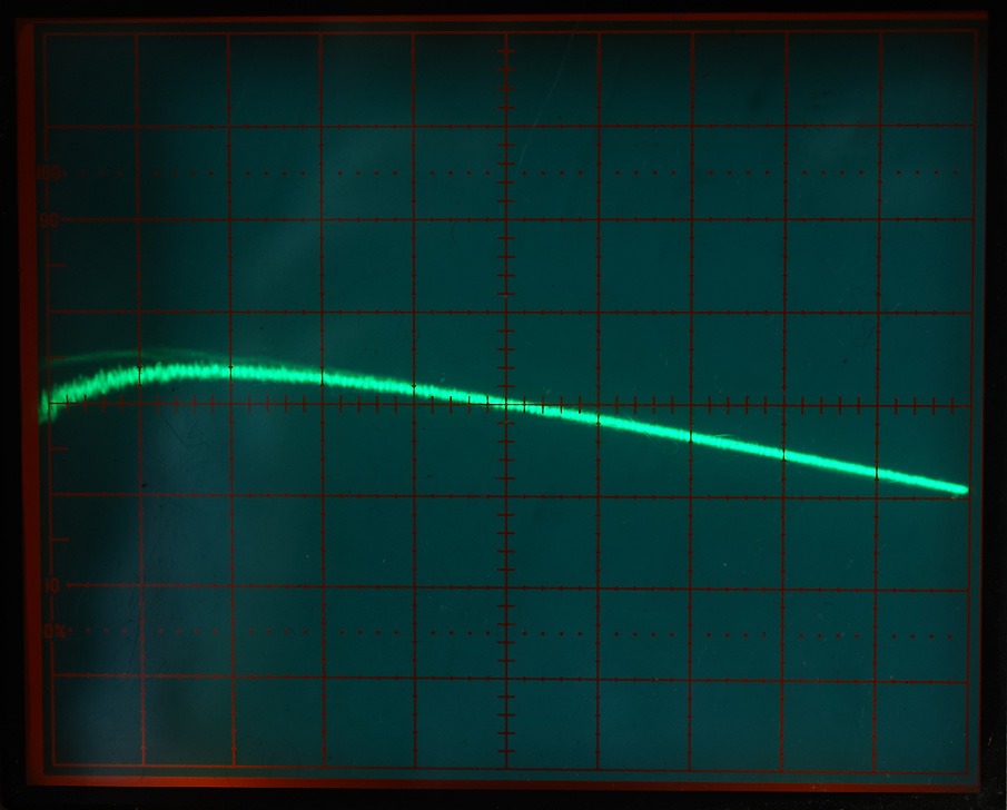

Add a variable emitter degeneration to the circuit ?
The MPS transistor with and without emitter degeneration:
Looks like it linearizes the left side of the mountain top only, the right side even suffers a bit.

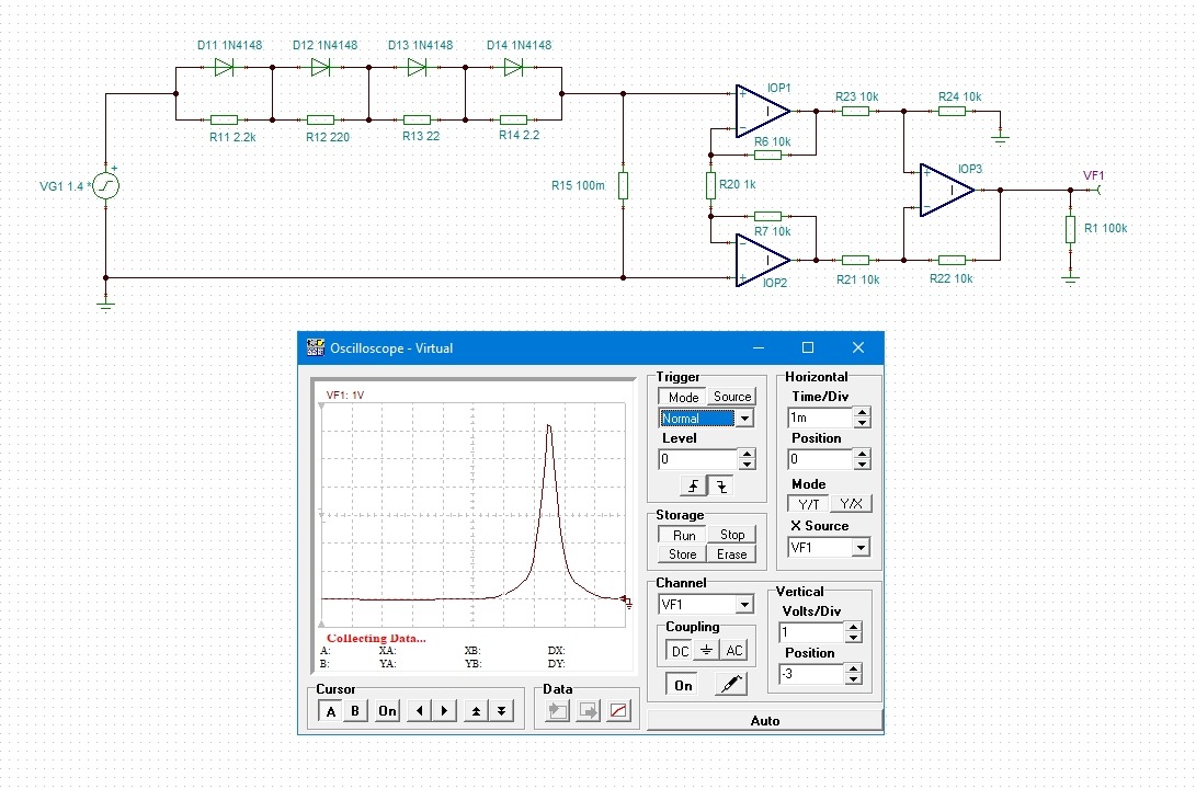

A simple logarithmic generator.

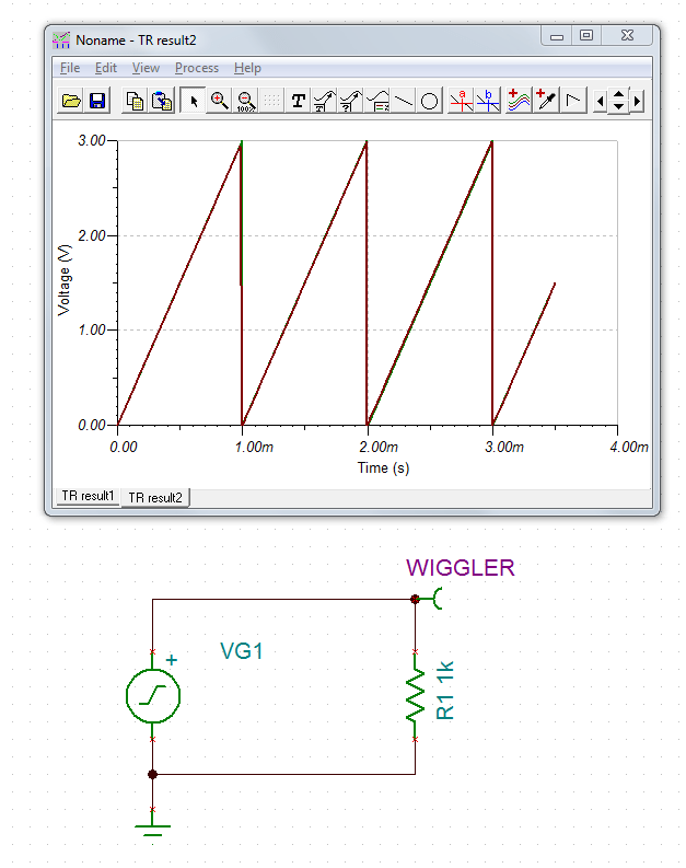

The 'generator for the generator' is a linear triangle generator, 2.8Vpp & +1.4Vdc offset, to drive the four diode-res segments.
I choose the resistor values to suit various currents through the diodes: 0.01mA, 0.1mA, 1.0mA and 10mA.
A generic instrumentation amplifier (or a regular INA of your choice) with little gain gives 6Vpp output.
As the oscillator cannot display log scales, only the last high (current-) voltage peak is visible.
It's symmetrical due to the original triangle waveform - a sawtooth (not available in tina) would yield an assymmetrical log signal.
