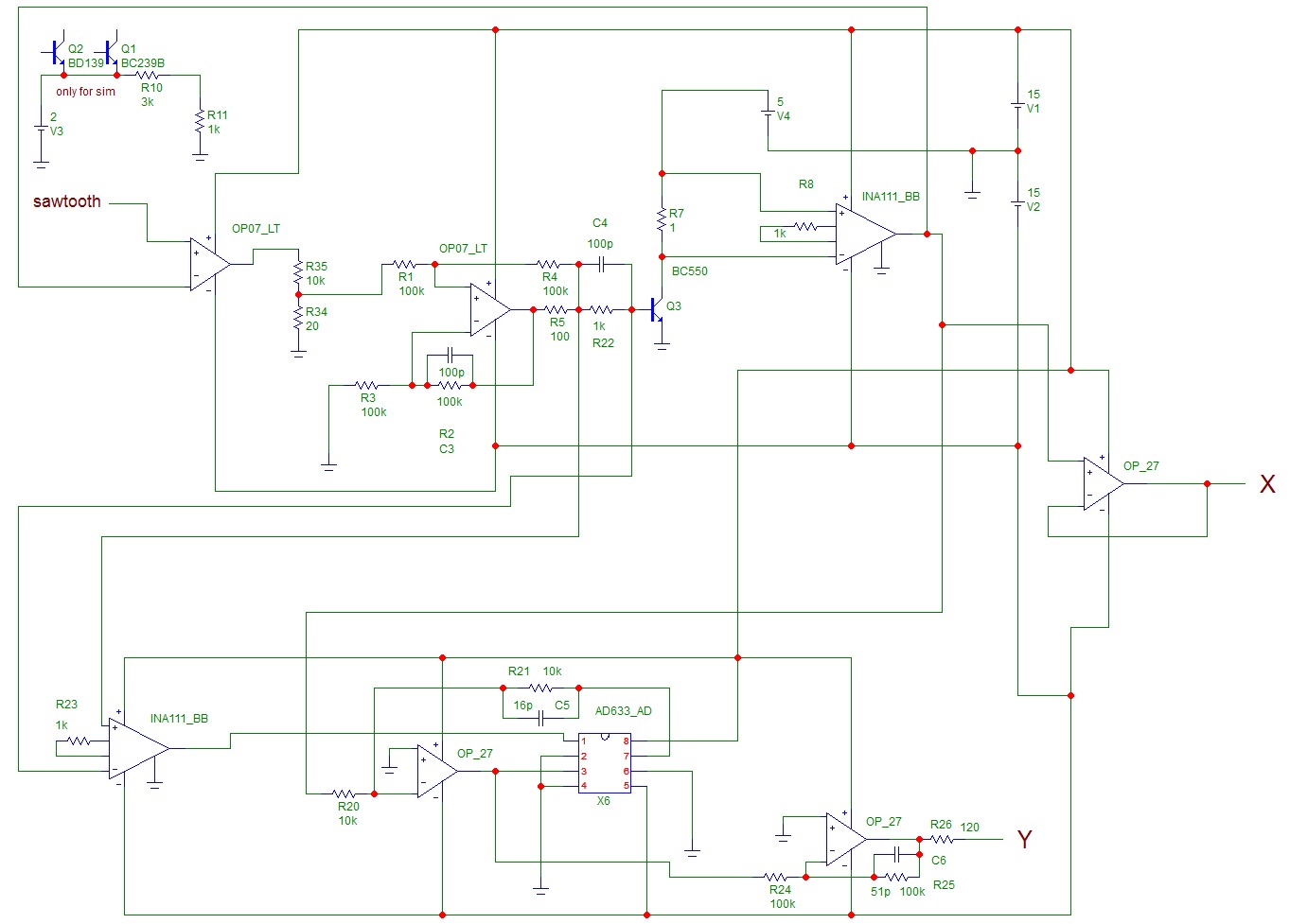

So what is the value of the sense resistors?I reduced the INA gain from 500 to 50 and increased sense resistors x10.
Sense for Ic is 1 ohm, for Ib 1k. Gain resistors for INA111 are 1k.
Maybe later I can switch to INA106, it has fixed gain of 10.
Curious. I choose 1Ω and 100Ω to start with, but not with those high beta types in mind.Sense for Ic is 1 ohm, for Ib 1k.
I don't think which type of INA (or eqv circuit) does matter realy, it suits the measurements anyhow.
Can you post your full circuit sofar?
Some remarks:
The divider R35-R34 (20Ω/10020Ω = 1/501x which is approx the beta of the bjt (Q3) involved (that was my initial 'Bnominal', alike the cosmic constant).
So this sets the expected beta to be measured and should be adjusted in advance to keep the results visible on the scope (or whatever).
V4 is the fixed Vce voltage source (5Vdc in this circuit), to be adjusted also to suit the measurements.
R5 is the current source control resistor, you add another measurement resistor (R22 1k0). Why not use R5? Change R23 for higher amplification.
With your use of the AD633 in this configuration, the output of the OP27 (with R20/R21 on the minus node) is -10 * Vic / Vib (Vic being the 'X'-output, Vib being the INA111 (with R23) output. The original generator sawtooth is zeroed out by the divider. The output of the AD633 is the 'X'-output inverted.
The output inverter (R24/R25) changes the minus to a positive value: Beta = {V-} Ic / {V-} Ib !!!

I chose 20 ohms so that the driving opamp output is around 5V for a 100 beta transistor. 10 ohms would be 10V and low beta would cause the output to hit the V+ rail.The divider R35-R34 (20Ω/10020Ω = 1/501x which is approx the beta of the bjt (Q3) involved (that was my initial 'Bnominal', alike the cosmic constant).
Yes, for simplicity I put a 7805 there.V4 is the fixed Vce voltage source (5Vdc in this circuit), to be adjusted also to suit the measurements.
Because as an example, if you change R5 to 200 ohms, the before mentioned driving voltage goes to 10V. So if you change R4, you must readjust R34. Not very convenient.R5 is the current source control resistor, you add another measurement resistor (R22 1k0). Why not use R5? Change R23 for higher amplification.
CorrectWith your use of the AD633 in this configuration, the output of the OP27 (with R20/R21 on the minus node) is -10 * Vic / Vib (Vic being the 'X'-output, Vib being the INA111 (with R23) output. The original generator sawtooth is zeroed out by the divider. The output of the AD633 is the 'X'-output inverted.

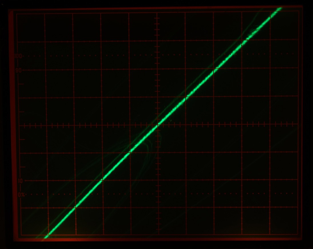

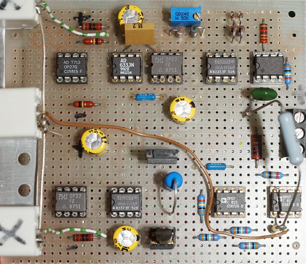

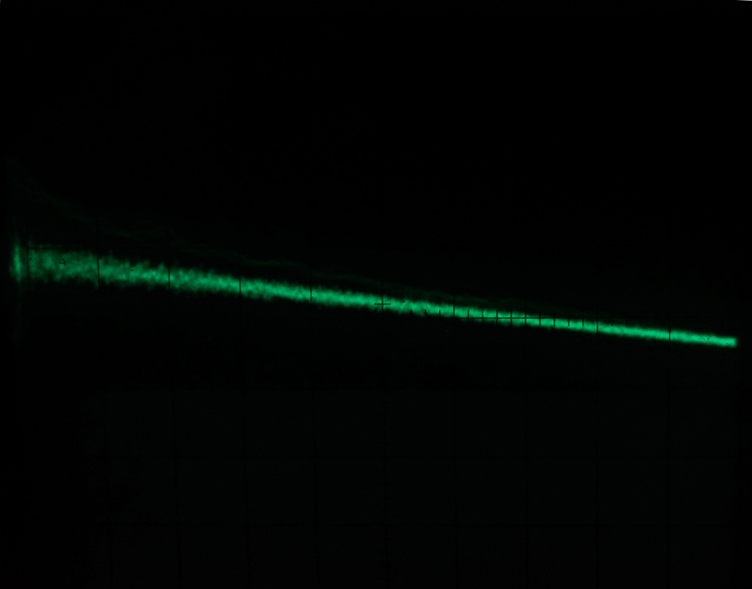

Today I added the onboard sawtooth generator.
Still artefacts around zero mA.
Need adjust hf compensation.
But it looks much better now.
It is becoming an instrument.
For looking at the curve it is best to ac couple Y, so sensitivity can be switched without readjusting the beta trace.
With DC coupling Y and high sensitivity, transistors can be tightly matched because a small difference in beta will shift the curve.

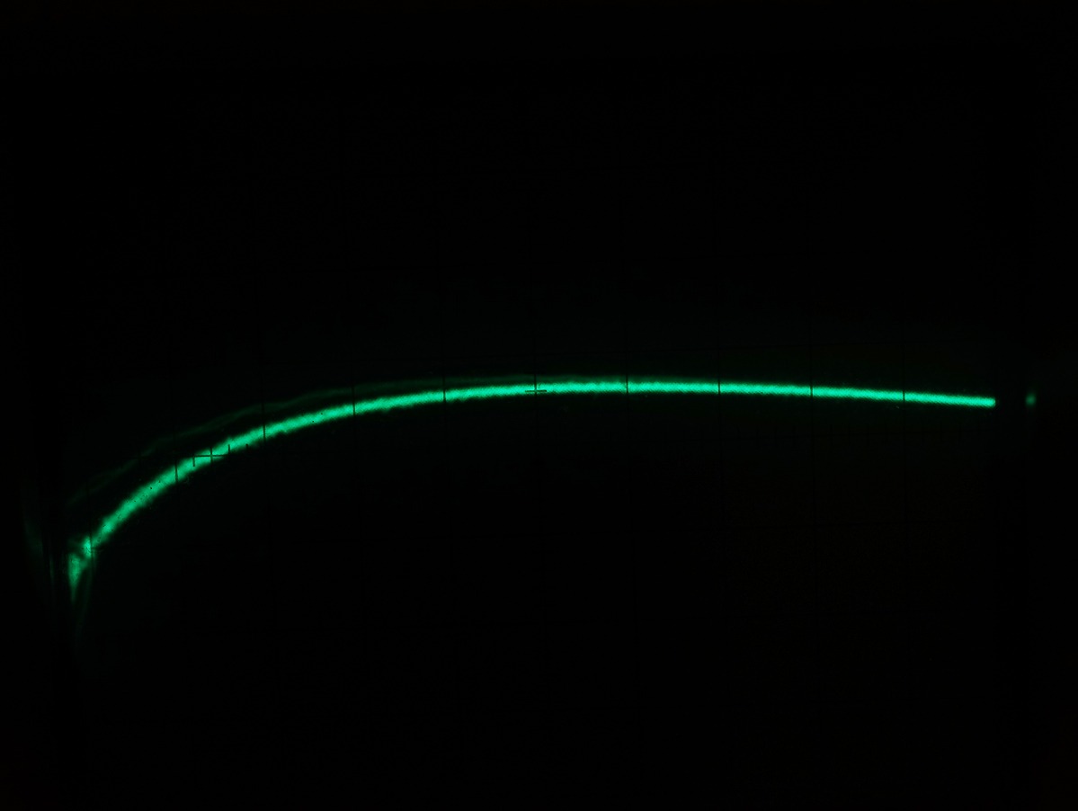

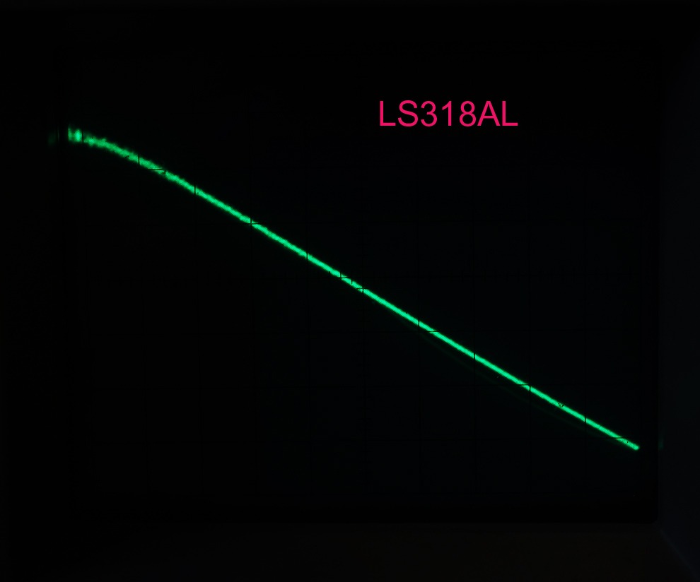

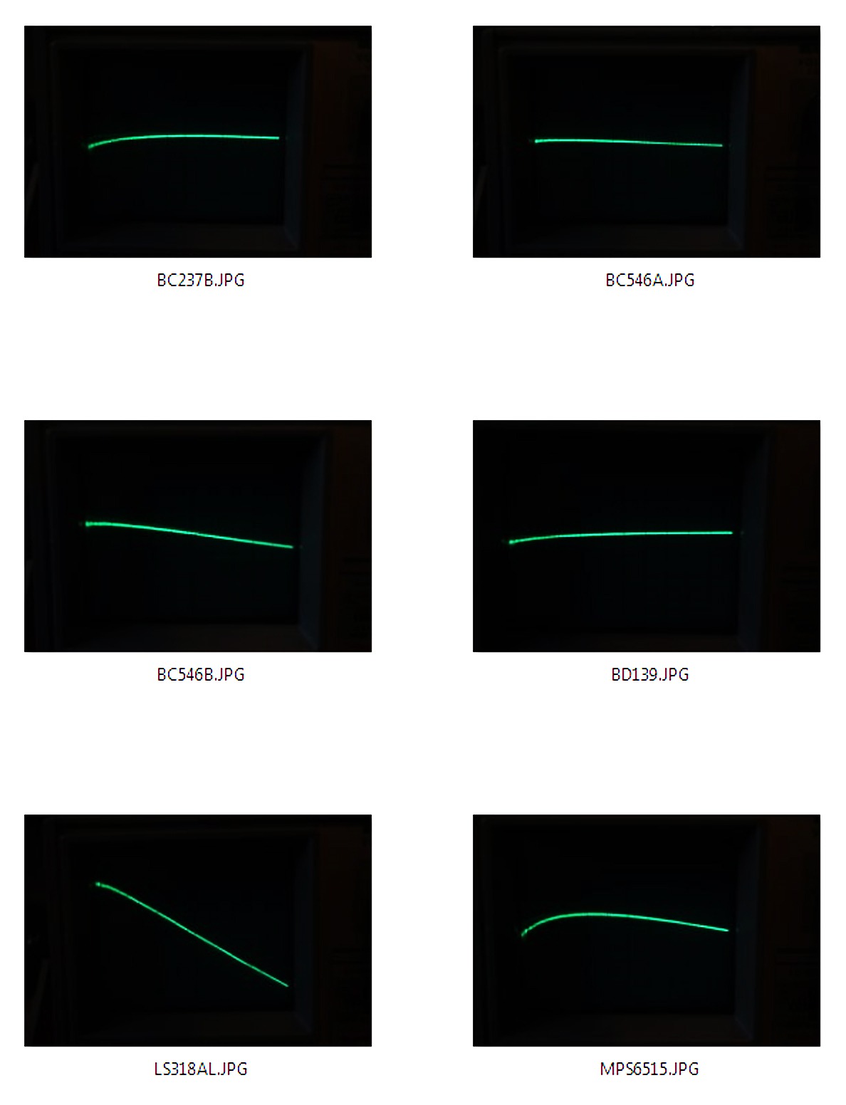

New samples with high sensitivity:
The LS318 is a supermatched dual transistor for very low currents., gain falling after 1mA.
BC237 is wrong, it is BC238.
Span should be 2mA-20mA
The blue pot is for sawtooth DC offset.

All looks great though I would prefer a 'DC-view'. Maybe when a log-saw can be produced. I'll try to draw my simple log-gen (#125).
How accurate should the x-axis be? If it spans more decades it counts for all measurements equally, even if not perfect log scaled.
Is "EX 3 C 37' a BC337?

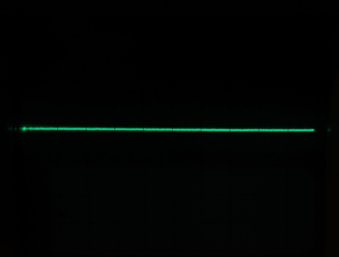

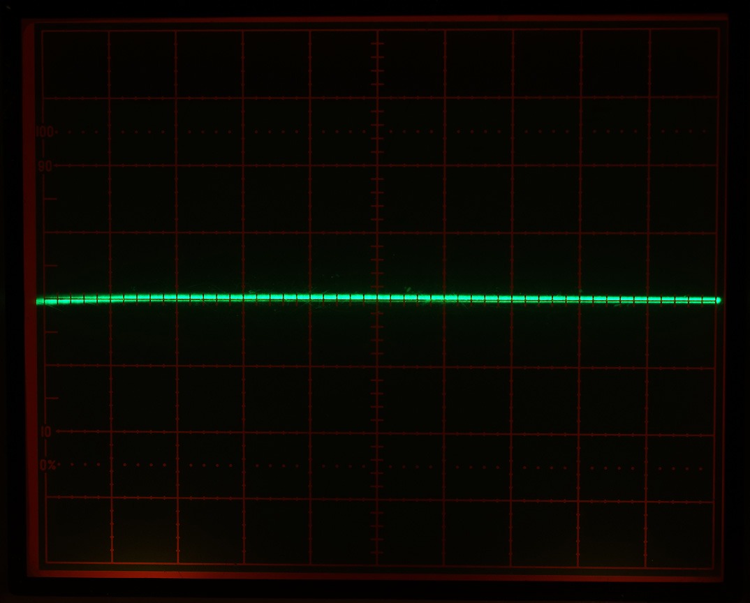

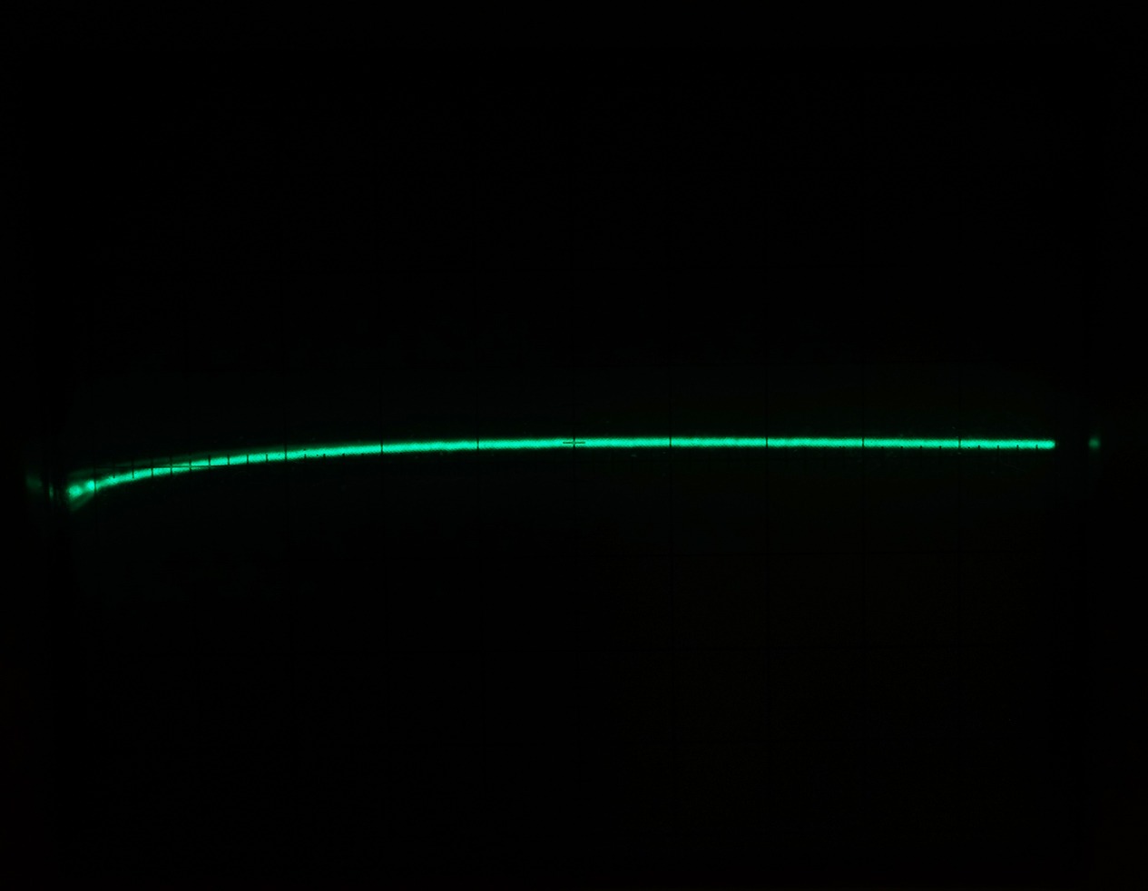

some pictures with old tek scope:

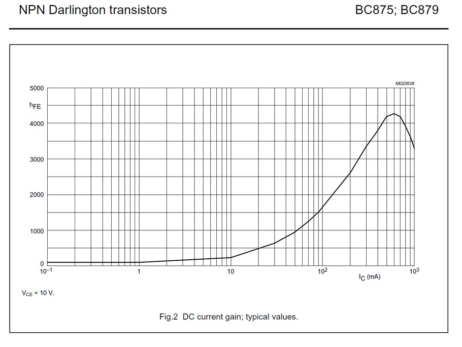

BC238 and below BC879 darlington with same settings ...BC879 is not so much an audio transistor
Good idea to increase the graticule illumination, that will help when you're comparing (Ib, Ic) data from your instrument, against (Ib, Ic) data from other test equipment. Testing the exact same transistor on (a) your instrument, and also (b) other gear. Thus helps validate that your new instrument gives the correct answer, namely the same answer as other, proven and trusted, test gear.
Practical there is no such thing as a DC view. If you use a fixed setting such that both low and high betas are displayed on the screen, the difference between a flat and a non flat curve is hard to see.All looks great though I would prefer a 'DC-view'
You must zoom in, then Y offset needs be adjusted on the scope.
With ac you can just zoom in on the curve until it is clearly shown for example where is the top or when it starts falling.
Look at the datasheet. Another proof that it works. The curve is so steep that it does not fit on the screen vertically. (without changing settings)That last picture seems a diagonal to me... that's the BC879? Wire broken?
