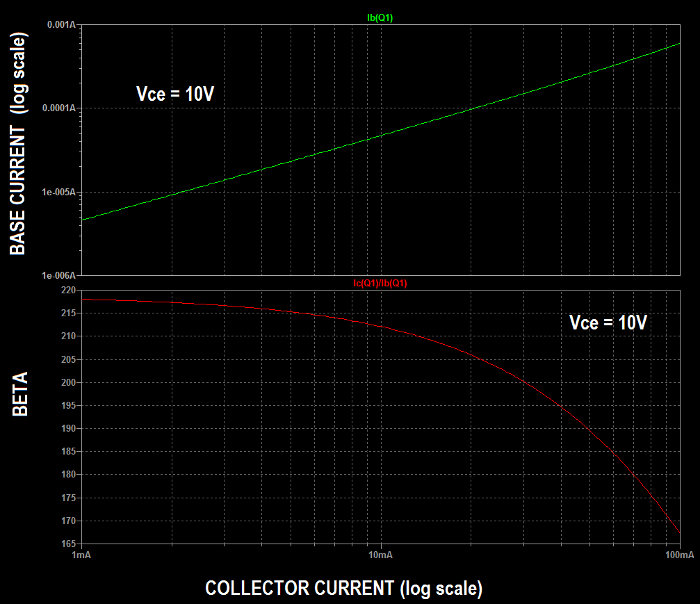

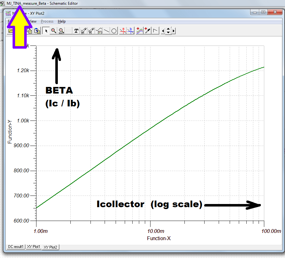

It seems to me that you could verify the circuit concept in simulation. Does it, or does it not, produce the correct Beta-Versus-Ice plot? Simply use a (simulated) transistor whose Beta-versus-Ice is known beforehand, then connect this transistor model to your measurement circuit. Measure how much your circuit's answer deviates from the known correct answer. Aha, validation & certification.
To name one example, the LTSPICE built-in model for the 2N2222 transistor
Code:
.model 2N2222 NPN(IS=1E-14 VAF=100 BF=200 IKF=0.3 XTB=1.5 BR=3
+      CJC=8E-12 CJE=25E-12 TR=100E-9 TF=400E-12 ITF=1 VTF=2
+      XTF=3 RB=10 RC=.3 RE=.2 Vceo=30 Icrating=800m mfg=NXP)
gives a beta-versus-Ic curve that decreases when Ic increases. LTSPICE simulation plot below.
Incidentally, it's a fun little five minute brain teaser, to discover ways to make LTSPICE create a plot like this. How do you get Ice on the horizontal axis? Woo hoo, plenty of enjoyment.
_
"Using_TINA.png" is an image file. The file extension .png signifies that it is of type Portable Network Graphics ... here is Wikipedia's explanation of the details of PNG files, their organization and compression.
This particular image named "Using_TINA.png" happens to be a screen capture of my laptop, when running Texas Instruments' free circuit simulator TINA. It is a plot of a (TINA simulated) NPN transistor's Beta (Ic/Ib), versus collector current (Ic). The image demonstrates that it is, in fact, possible to make the TINA program plot log(Icollector) on the horizontal axis, and (Ic/Ib) on the vertical axis. All that the circuit designer has to supply, is a little ingenuity. Solve a little brain teaser. Figure out how to get it done, rather than merely Googling "How do I get it done?", then whimpering and muttering when you can't find the answer by trivial searches.
Spend some hours and shared the effort... ehmm...

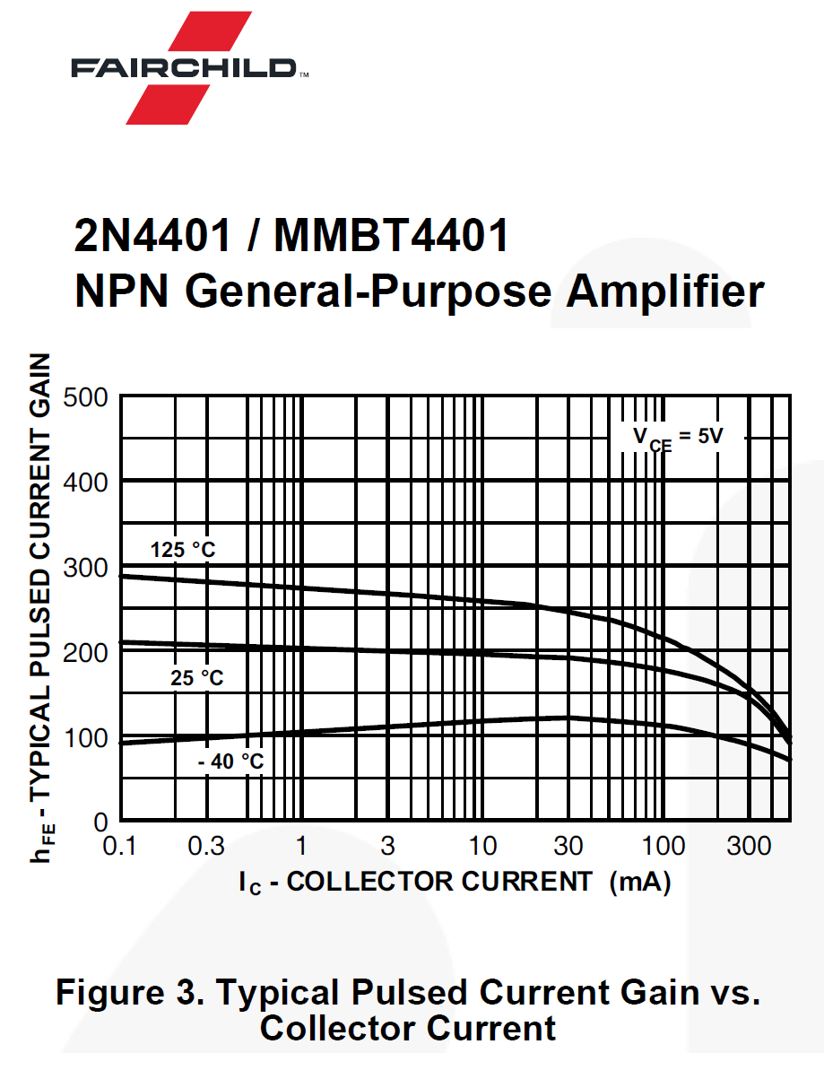

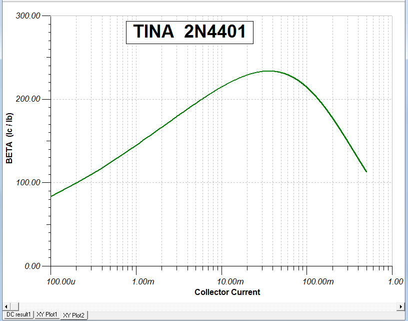

Here's a typical example of the difference between datasheet and circuit simulation (in this case: TINA), using .MODEL parameters.
When you get your tester working and accuracy verified, you can show examples of the difference between datasheet and measurements on actual real-life devices.
_

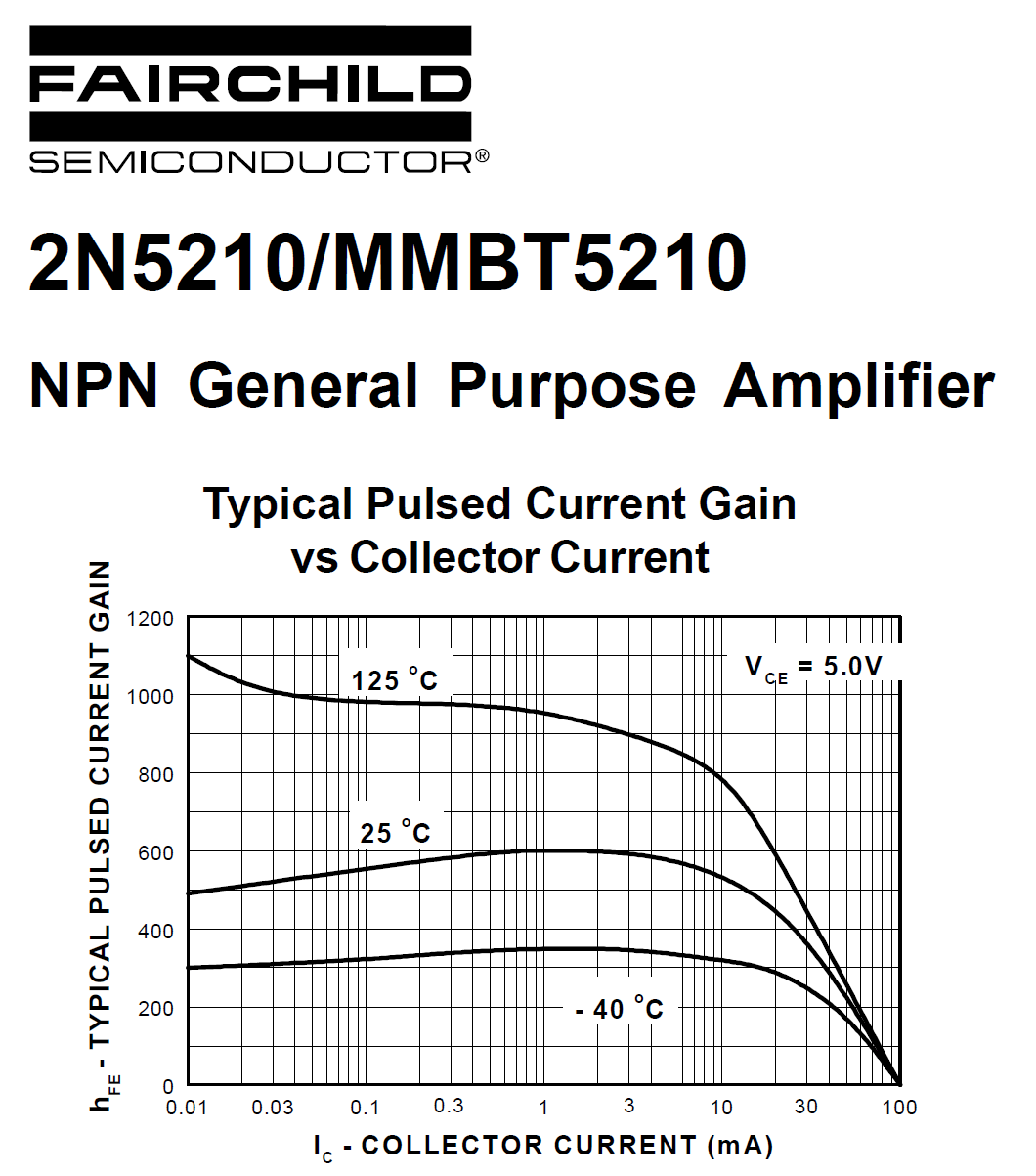

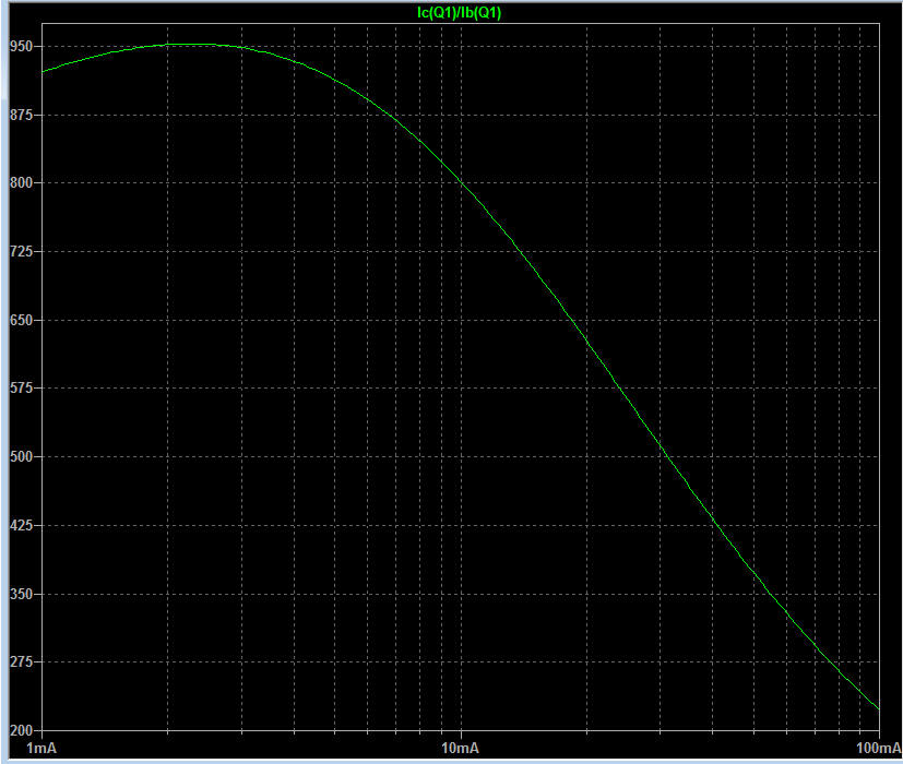

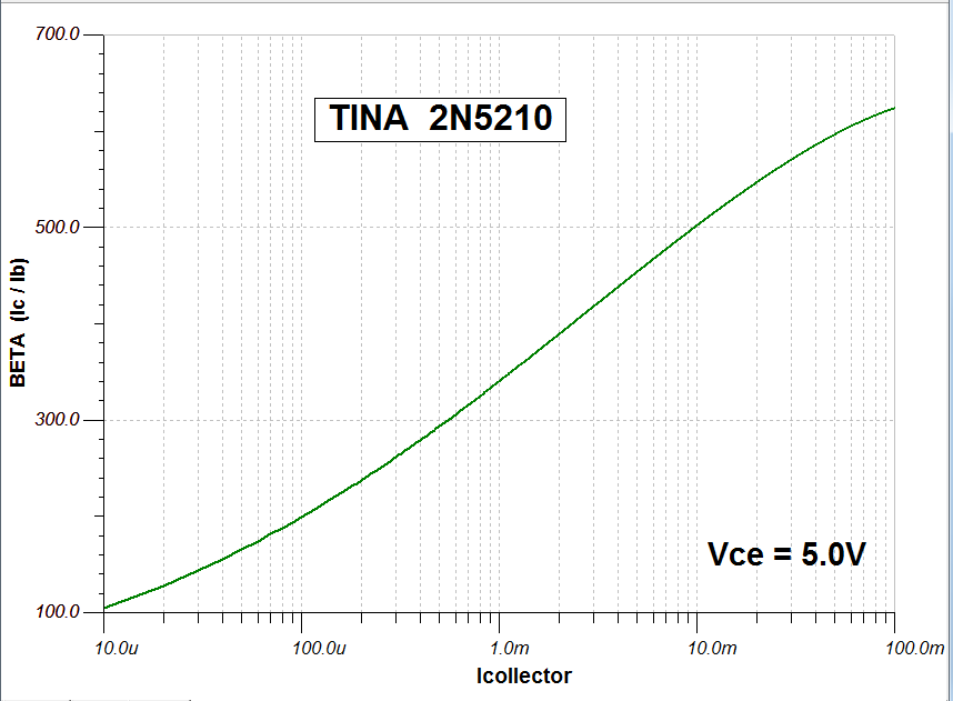

Another example. Again TINA simulation is not a wonderful match to the datasheet.
However, as proposed in post #89 above, you could drop this TINA-simulated 2N5210 transistor into a TINA-simulation of your Beta-versus-Icollector hardware device. As long as your TINA-simulated results from the simulated hardware device, match the raw Beta-versus-Ic from a TINA simulation of the transistor without the hardware device . . . . you know the hardware device got the right answer. It extracted a Beta-versus-Ic curve which approx. matches how the simulator says the raw transistor behaves.
_
