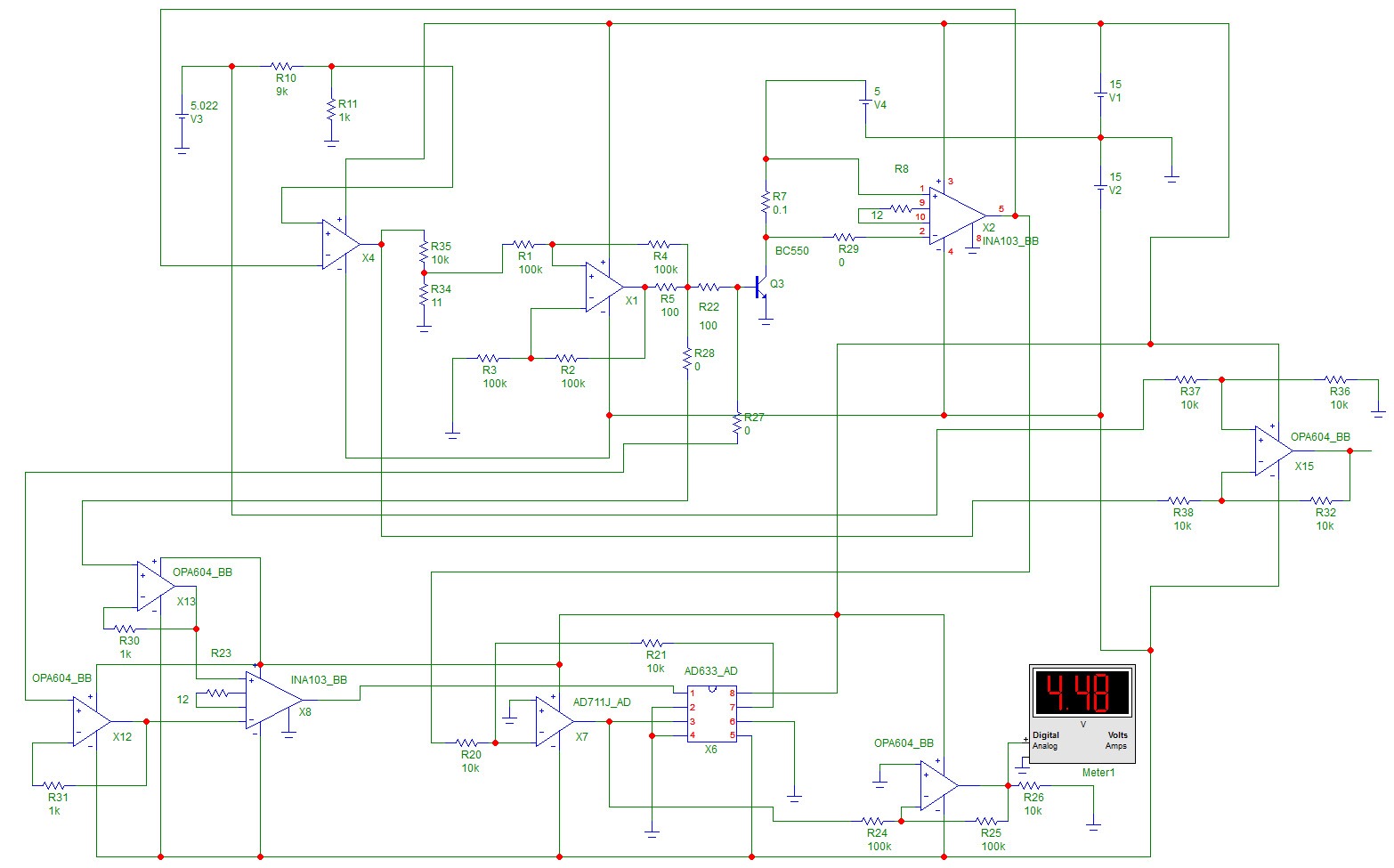

For a random point of the triangle wave (V3) your circuit keeps Ic constant for transistors with different betas. So the output of INA is constant. Also ramp voltage is constant.
To achieve this, for low beta transistors U3D raises its output voltage, because more base current and thus higher input voltage for the current source is needed.
So that voltage is some kind of inverse function of beta. It means, it is not possible to retrieve beta from U3D output voltage.
The upper part of your circuit resembles mine, but the lower half is puzzling me. You're measuring Ib and put that in a multiplier with the output triangle from the IC INA, its output folding back to the current node of your X7. I've no idea what's going on there. The led displays a beta... a static value?
Not Ic constant as a static DC value, but forcing to correspond with the original (AC) triangle from U2D (your X4).
Exactly, U3D compensataes until the output of the INA U1 (your X2) matches the output of U2D (the triangle).
But not for 'low beta bjt's' only, but for any value of beta during the transition of the applied waveform (triangle/sawtooth).
The output of U3D looks like the indicated 'adjusted sawtooth' waveform (the double medieval soldier helmets: "wilhelms").
At low currents, the beta is low so the wilhelm raises sharp until the mid-beta area, where the waveform flattens out, to raise again at higher currents (wilhelms peak). The triangle descends and the mirroring waveform appears. As two triangles are shown as an example, two peaked helmets appear.
Yes!
No!
The output of U3D is the original triangle PLUS the 'beta-compensation.
Subtract the original triangle from it to yield that beta-compensation (U3A).
Invert (U3C), output is the Y-signal.
It is not needed to measure the Ib also, as this already incorporated in the compensation signal.
Output of the INA (U1) is the X-signal, X and Y are always synchronous.
X and Y to connect to an X-Y configured oscilloscope (not a dc or ac meter).
TINA TI simulator has this available, but I'm currently exploring its capabilities.
I don't know if your simulator has this option.

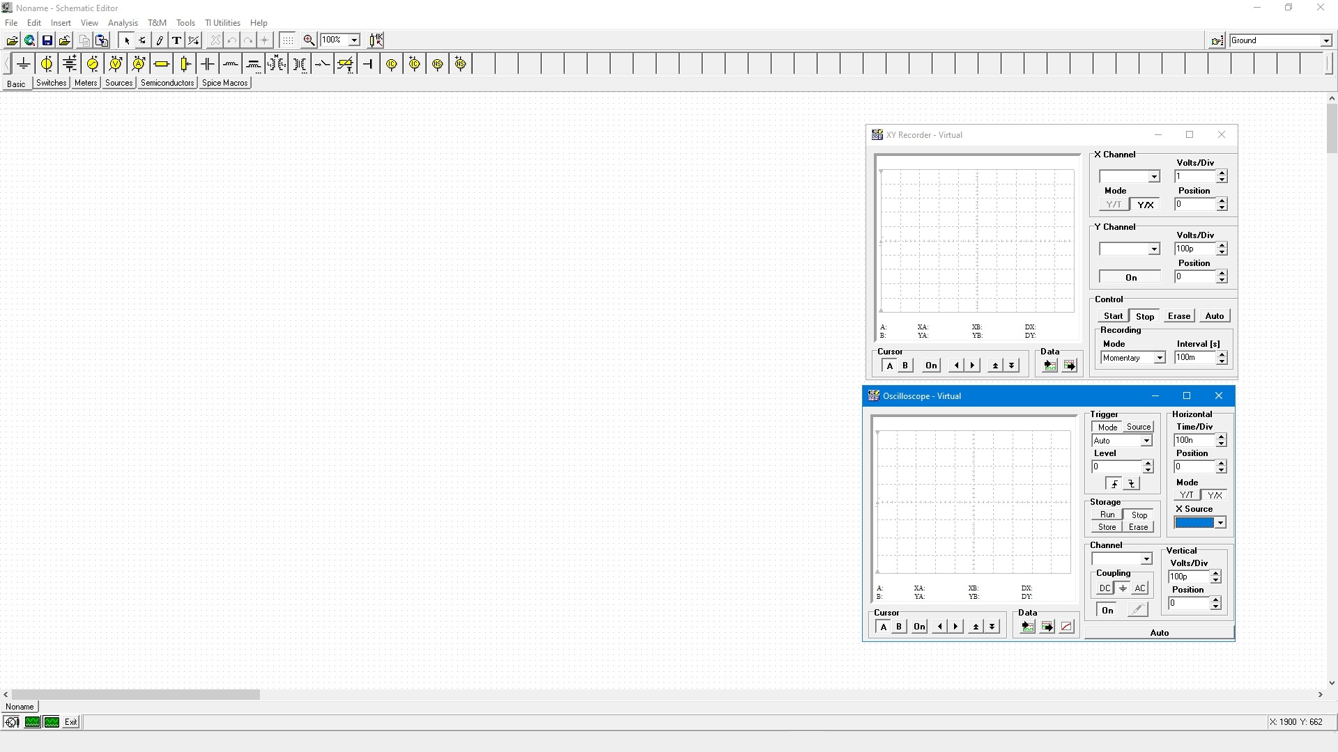

Mark's point (#39) is the have a (>) 4 decades logarithmic (10^x) sweep, so the triangel should be 'deformed' to a exponential 4-dec' (10^x) sweep, which makes it rather difficult for this betatracer circuit, as I expect for now.
Yes, sense Ic and sense Ib, do the division to get beta by definition. V(Ic)/V(Ib) = Vbeta. Circuit is adjusted so that 1V Vbeta = beta 100.
AD633 is a multiplier in the feedback loop of the opamp, that forms a divider. I borrowed that from the datasheet.
AD633 pin3 is -4,48V, inverted gives readout 4,48 = beta 448. Ignore the decimal point.
The LED is a voltmeter that directly displays beta at the sampling point of the curve where Ic is 10mA.
A 3 1/2 digit voltmeter could display beta up to 1999. Then 100mV = beta 100.
In the real world, with a sample/hold, it can display beta for any Ic point on the curve in conjunction with a cursor, as I mentioned before.

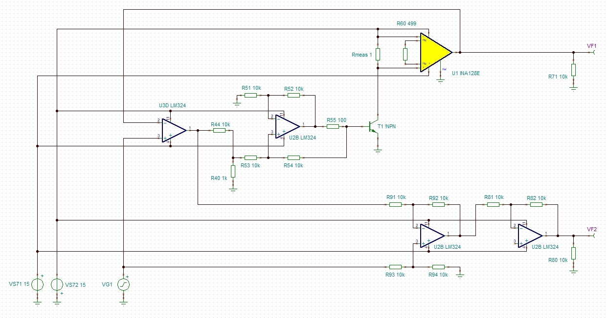

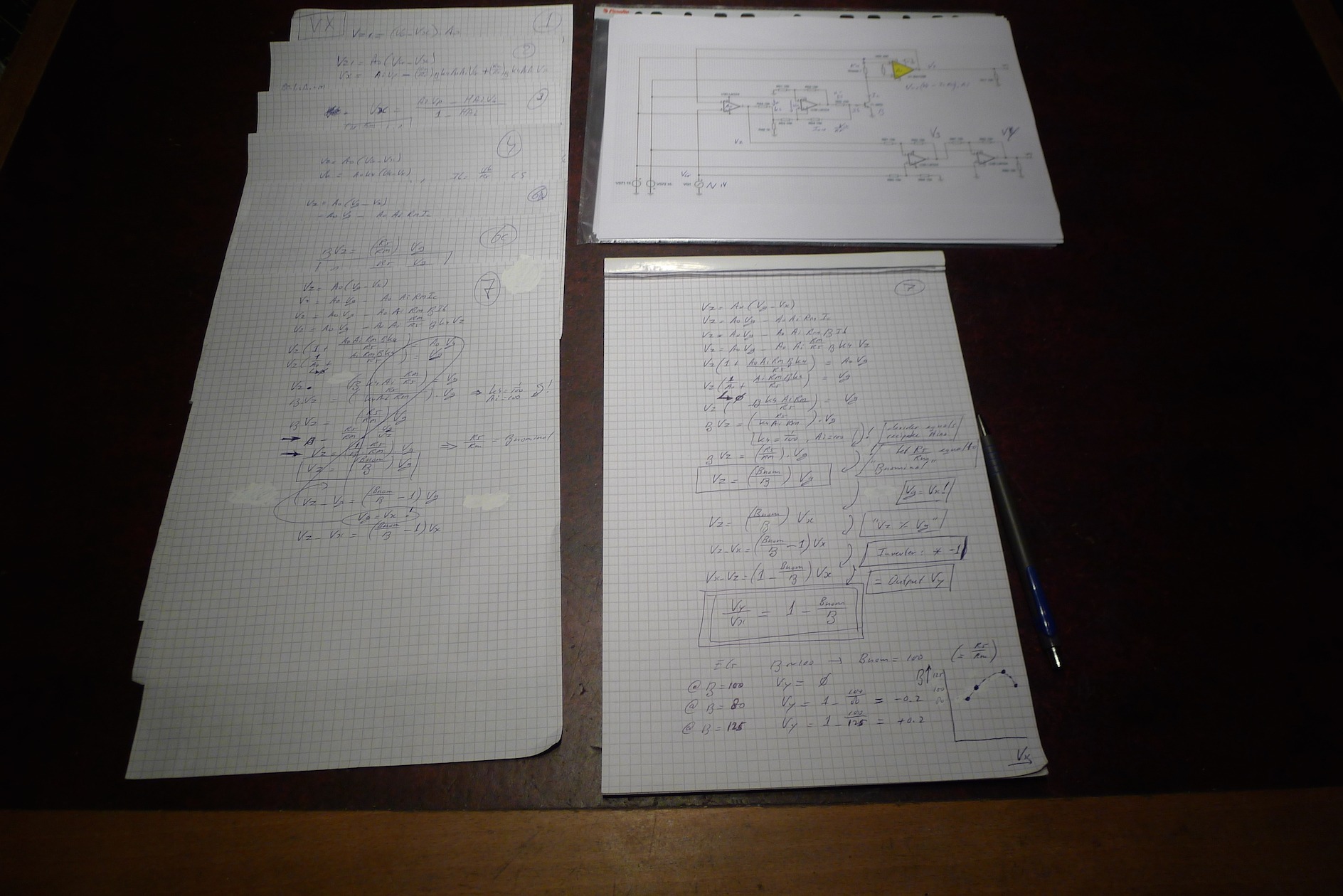

In two parts, first the easiest one Vx:
Vu3d = Ao*(Vg - Vx)
Vr40 = k4*Ao*(Vg - Vx)
Ib = Vr40/R5 (Acs=1)
Ib = k4*Ao*(Vg-Vx)/R5
Ic = ßk4*Ao(Vg-Vx)/R5
INA:
Vx = Aina*(Vps - Rm*I)
Vx = Aina*(Vps = Rm*ßk4*Ao(Vg-Vx)/R5)
Vx = Aina*Vps - (Rm/R5 * ß*k4*Ao*Aina)*Vg + (Rm/R5 * ß*k4*Ao*Aina)*Vx
assume H = Rm/R5 * ß*k4*Ao
Vx = Ai*Vps - H*Aina*Vg + H*Aina*Vx
Vx = { Aina*Vps - H*Aina**Vg } / { 1 - H*Aina }
H*Aina >> 1 (~ 100...)
Vx = Ai/(-HAina) * Vps - H*Aina/(-H*Aina) * Vg
Vx = Vps/-H + Vg [ H = Rm/R5 * ß * k4 * Ao = 1/100 * ß * 1/100 * 10^5 = 10 * ß = [100 <> 1000] )
thus: Vx = ... Vg
I need some more time for the beta equation.
INA:
One of my grandious errors!
Actually, it is Vx = Aina * ( Vps - (Vps - Rm*Ic) ), thus the more simple Vx = Aina * Rm * Ic.
Anyhow, the result is the same: (1 + Ao) * Vx= (Ao) * Vg (Ao is the open loop gain of U3D).
So, Vx = Vg (The output of the INA is the same as the source waveform.)
For the Y-channel:
Vz = (Bnom / ß) * Vg (Vz is the output of U3D, 'Bnom' is the nominal beta (say "100"), ß is the actual beta)
Restrictions and revelations:
R55/Rmeas equals Bnom, Aina equals ( 1 / k4 ) (k4 = R40 / (R40 + R44) ) and equals Bnom also.
This brings the relation between Ib and Ic to an optimum.
The Y-output related to the X-output:
Vy / Vx = ( 1 - Bnom / ß )
If ß differs from Bnom, the curved beta is traced on the scope.
