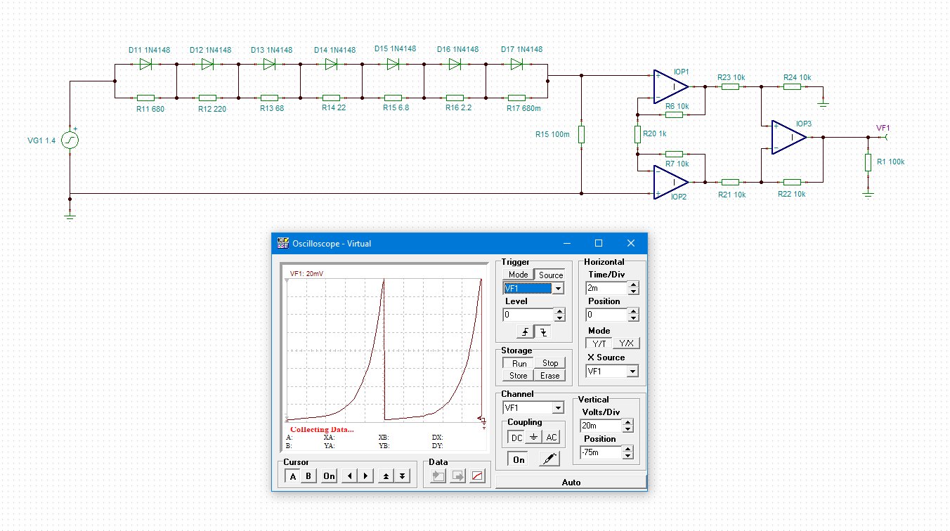

It might be amusing or frightening to plot the output current of "VG1" in post #164. That current might be uncomfortably large at the end of the swing, where the driven load is only (0.1R + (7 * diode_slope_dv_di))

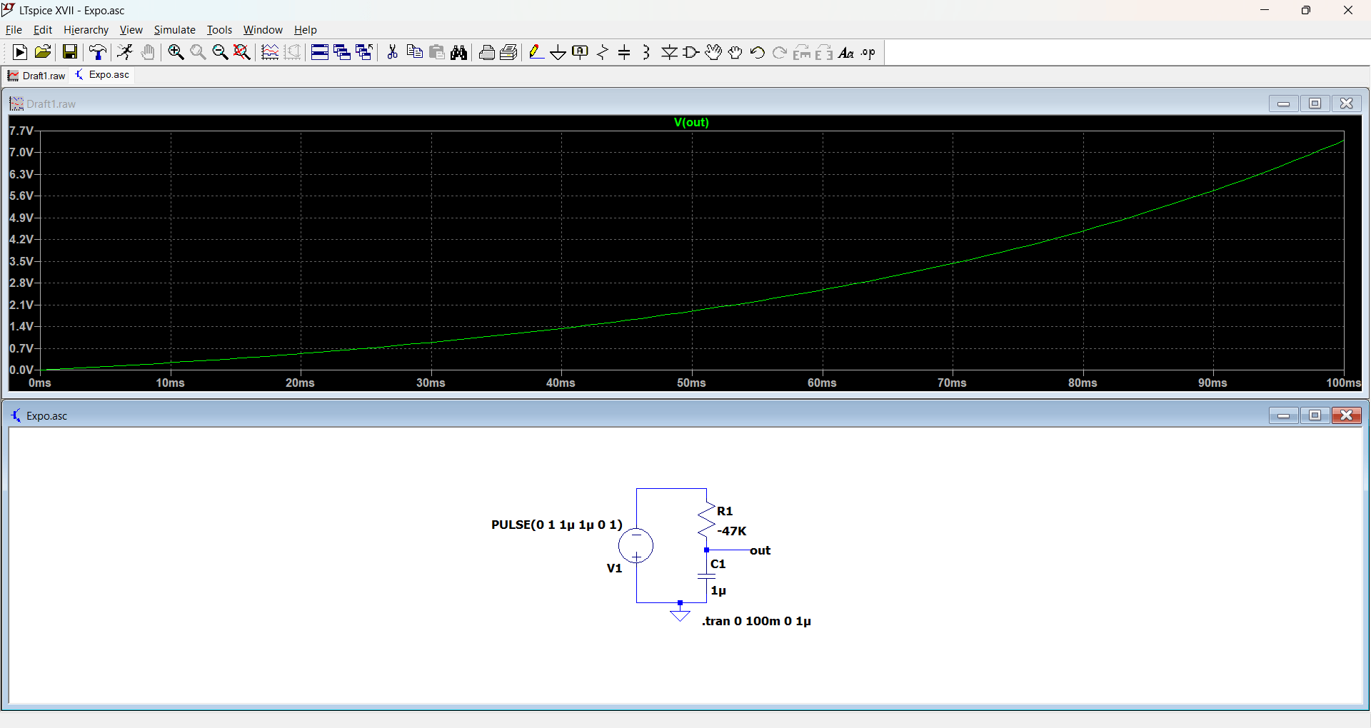

A possibly simpler, and extremely accurate method of generating an exponential is to use a negative resistor:
Of course, you are not going to find a -47K resistor in Mouser's inventory, but they can be synthesized quite easily. I have probably given some examples on this forum, but the Master, Stephen Woodward has published many examples in EDN and/or Electronic Design
You're right, but gladly it's a simu only.It might be amusing or frightening to plot the output current of "VG1" in post #164. That current might be uncomfortably large at the end of the swing, where the driven load is only (0.1R + (7 * diode_slope_dv_di))
Now we can multiply all resistor values (R11 - R17) with 100 to reduce the current.
... I notice I haven't update the annotation of the measure resistor (also R15), but it depends on various factors if this one has to change too.
And, by changing the waveform of VG1, I forgot to adjust the dc offset level from 1.4Vdc (4 diodes) to 2.5Vdc (7 diodes).
Being familiar with Aimspice, and consequently being extreme accurate, Tina as with a graphical interface makes me somewhat lazy.
Post #164 was from my new job laptop ("You need a reliable laptop, here, take this." "Is it expensive?" "Four digit's." {continental}), so an update follows this weekend. (This post is done with an very old osx10.10.5, the keys are not that much reliable anymore: typo's possible! - Also, that Aimspice is running on W2k in vmware on that mbookpro.)
It would be very much appreciated if you can dig up some references, as this is a very nice (and maybe more simple) approach and alternative to build a solid 'expo-gen'....but the Master, Stephen Woodward has published many examples in EDN and/or Electronic Design.
As I said, S. Woodward made abundant use of the concept; references might not be instantly accessible directly, but if you are persistent enough, you will find them. Example here:It would be very much appreciated if you can dig up some references, as this is a very nice (and maybe more simple) approach and alternative to build a solid 'expo-gen'.
https://www.edn.com/dpga-conditions-signals-with-negative-time-constant/

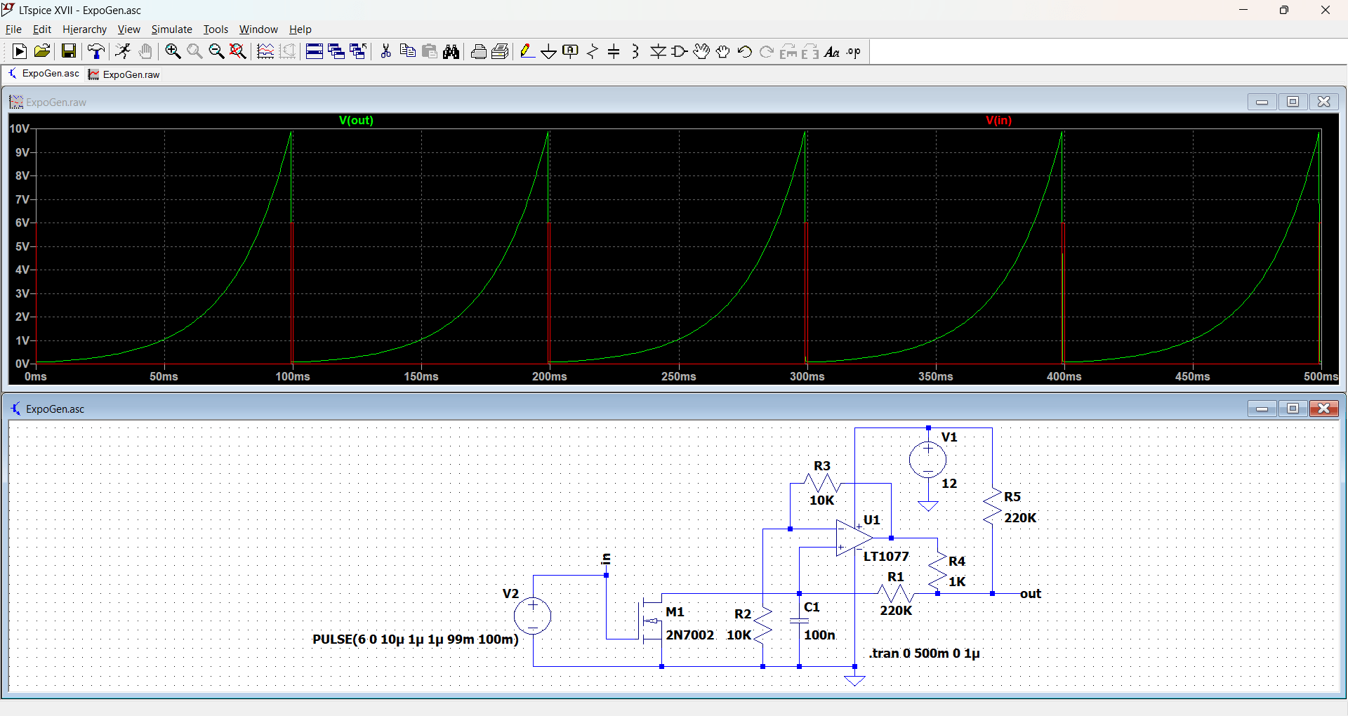

However, a small picture (or sim) is worth a thousand words:
Seems to contradict with the pictures in #116, or what reasons are implied?Ic over several decades combined with beta range of transistors is problematic for several reasons.
If M1 is the discharge switch, I wonder if a exp-gen could be made with a 555!However, a small picture (or sim) is worth a thousand words...

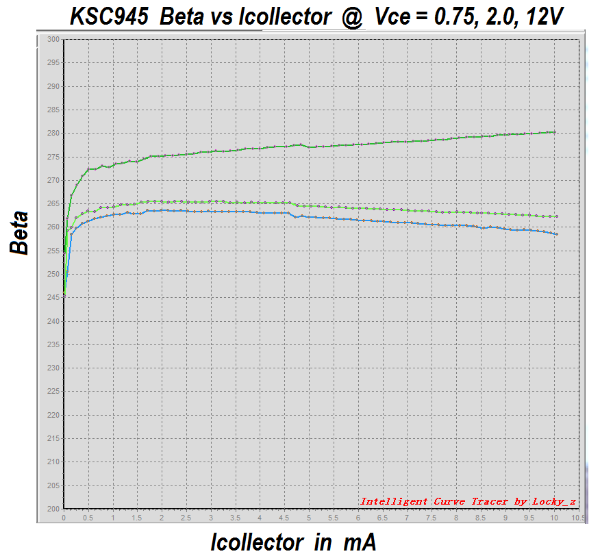

Locky-Z curve tracer goes up to 1000 mA and down to sub-100uA. I haven't done a lot of work with it at super low currents so I don't have observations and experience about the level at which measured current values become untrustworthy. The unit includes range switching relays that make audible clicks during sweep operations.
See...The unit includes range switching relays that make audible clicks during sweep operations.
