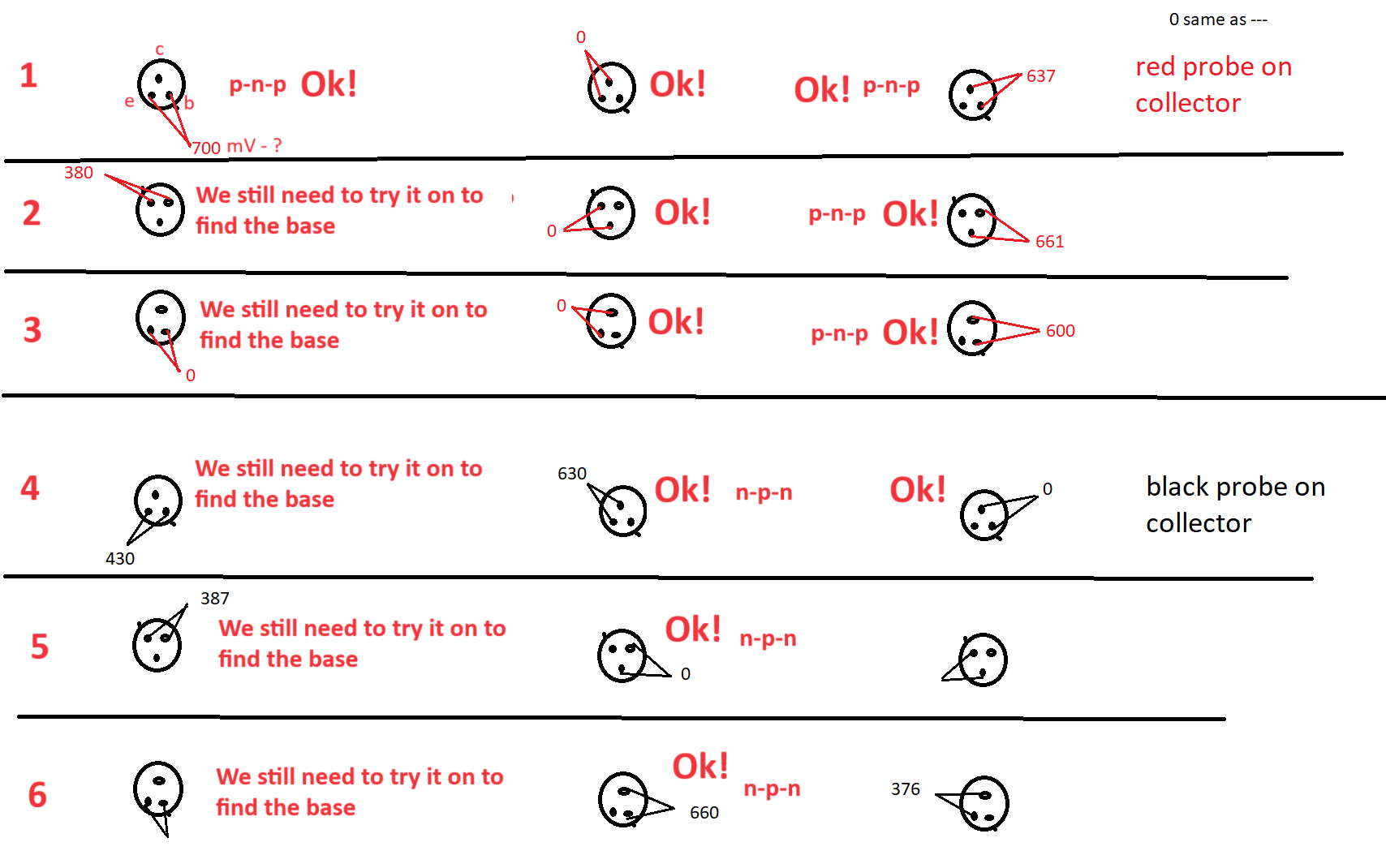

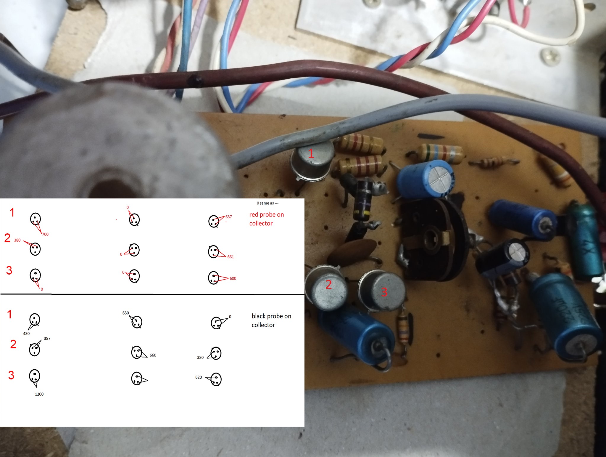

Все 6 транзисторов нужно проверить.

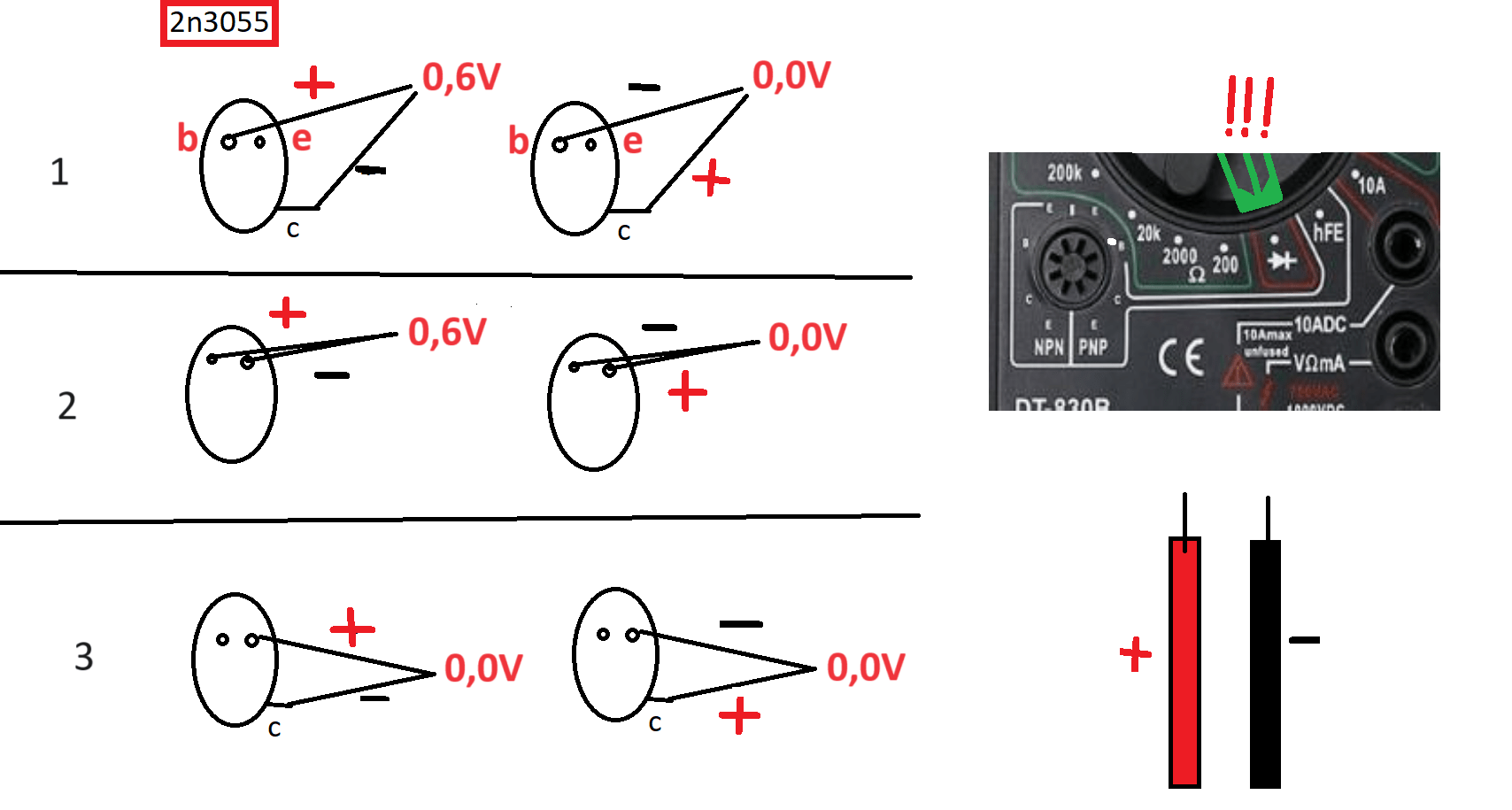

На 2Н3055 должно быть как на рисунке.
На остальных транзисторах вы узнаете, где находится база и тип транзистора p-n-p или n-p-n.
Для металлических транзисторов корпусом обычно является коллектор.

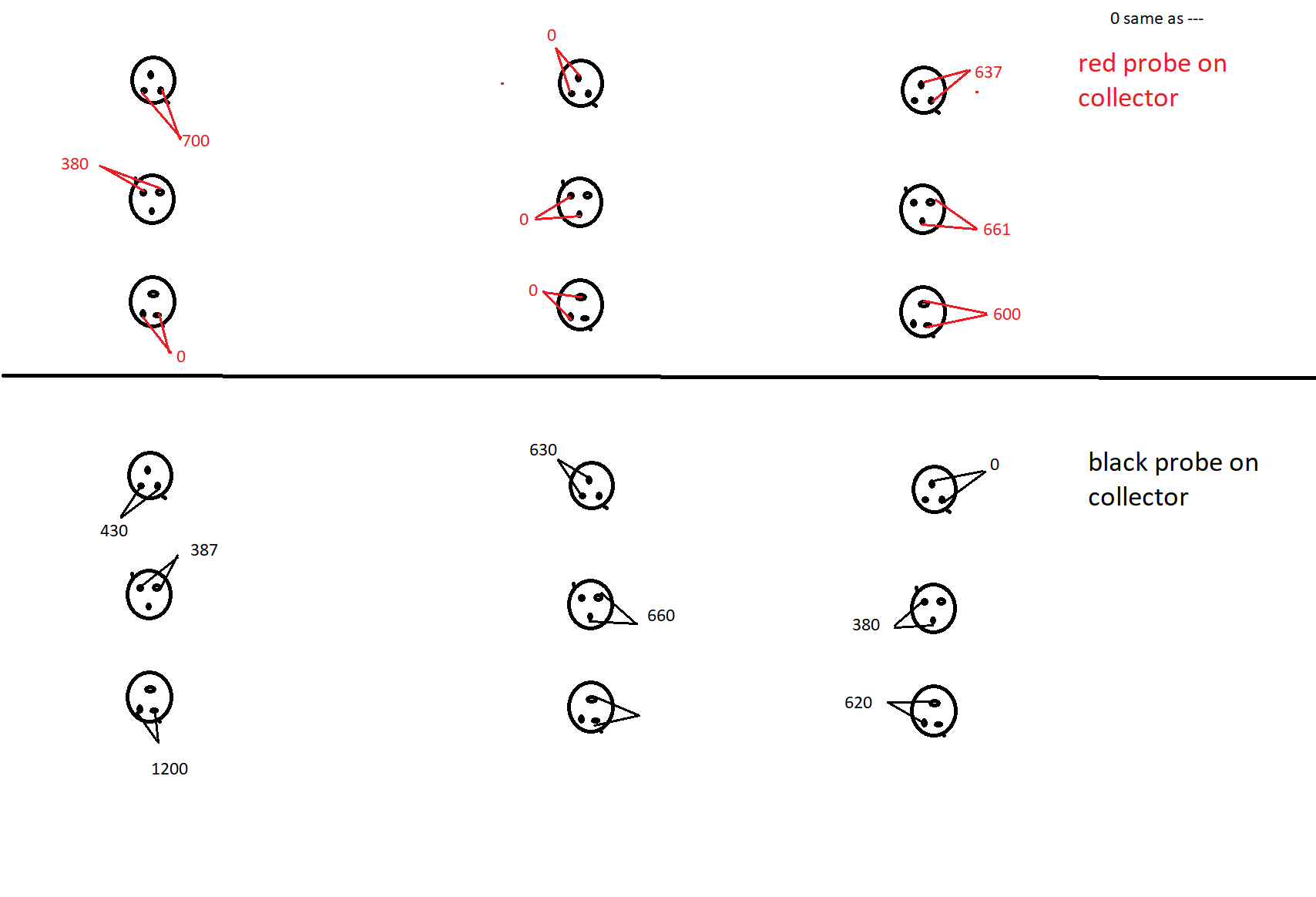

picture of the meter is from internet i have same one but its not mine that i took a pic xddAll 6 transistors need to be checked.
On 2N055 it should be as in the figure.
On the remaining transistors, you will find out where the base is and the type of transistor p-n-p or n-p-n.
For metal transistors, the housing is usually the collector.

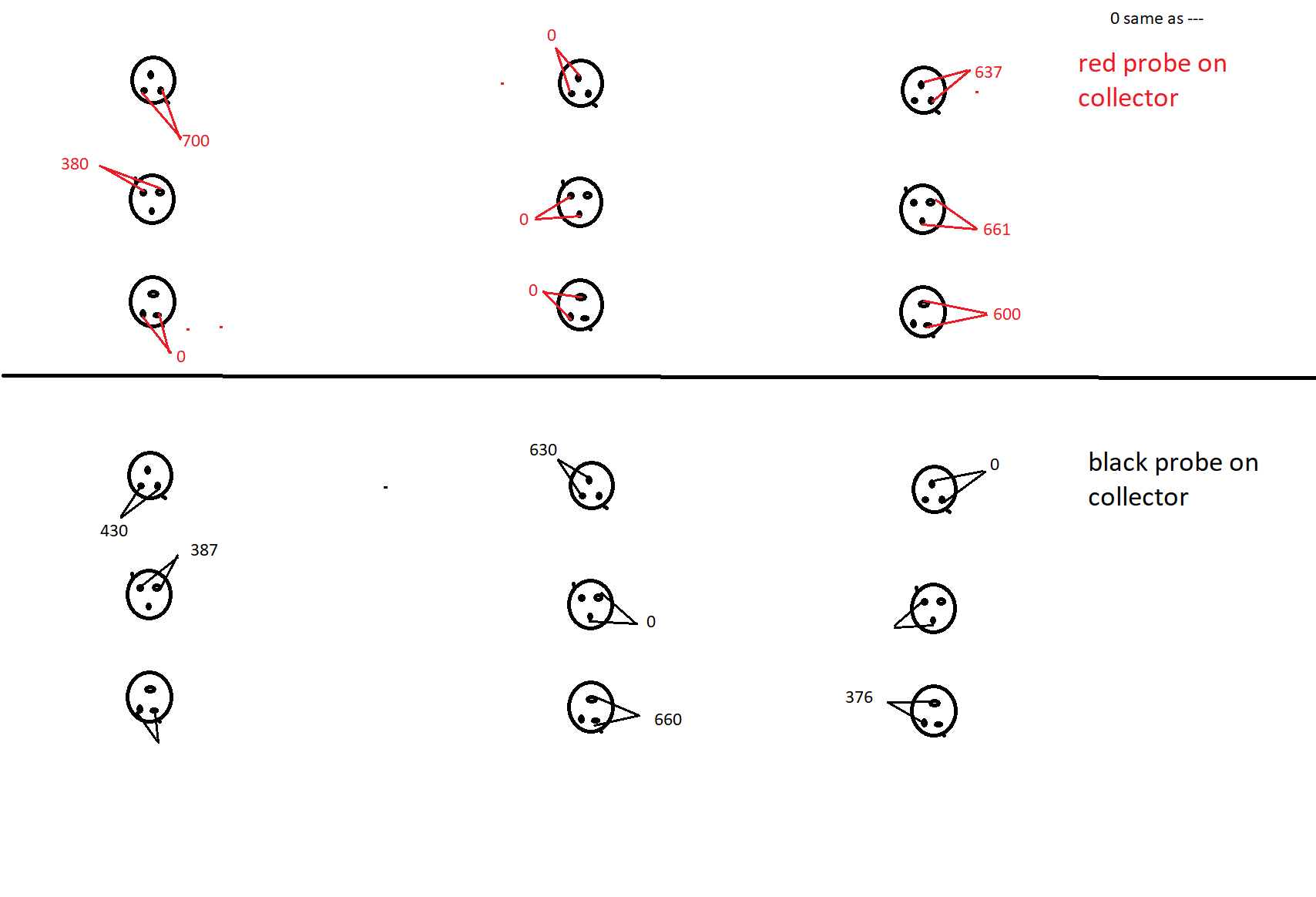

those are measurements i did, so main thing is i dont know what are usual values. so if someone knows then this should be good indicator
i did all the measurements so if someone can cleary say what should i replace that would be cool. because i am not sure.
so you suggest that 2 and 3 should be replaced ? btw i dont know how to find base i only know what metal cap is collector thats all
btw i did not draw 6 transistor only 3 xdd same 3 two times ones with red probe on collector and same but reversed with black on the collector.

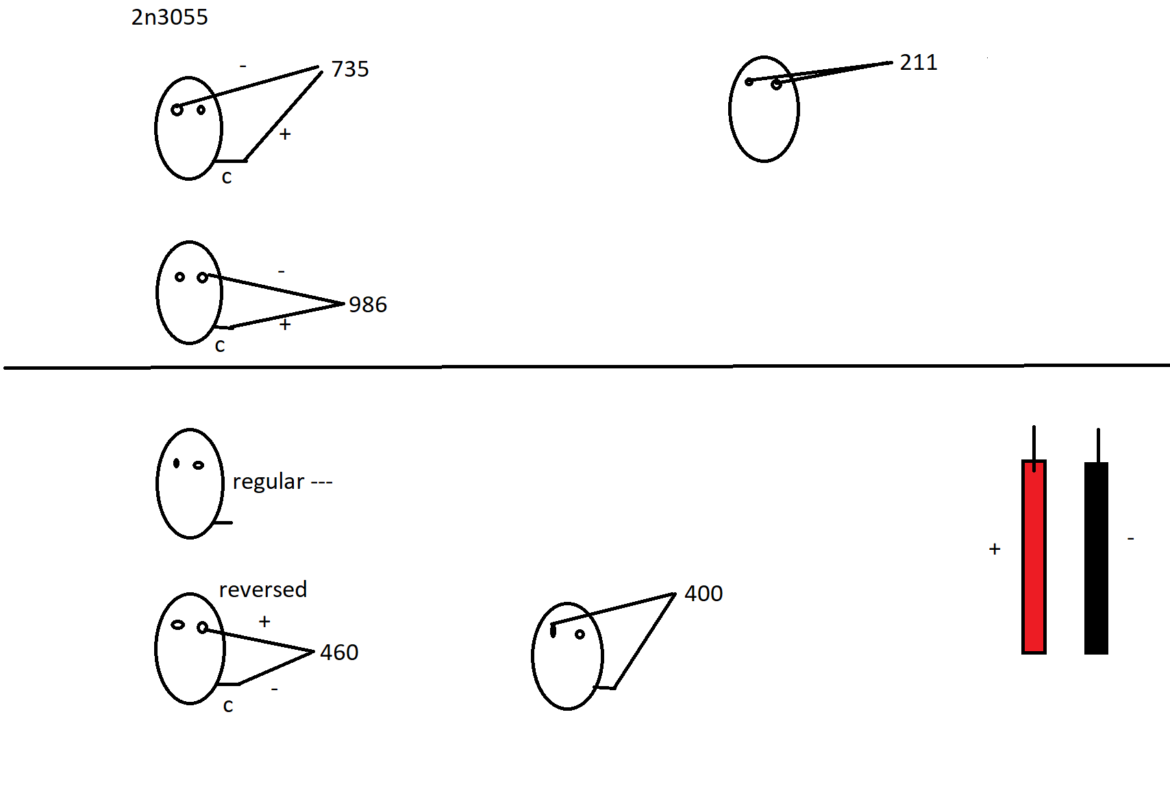

In post 142, measurements from the right pin (emitter) looking from the long end to case C is not interesting unless zero. You did not measure from left pin (base) to case (c) on the lower measurement. In niether upper or lower 2n3055 measurement did you show the number backwards, minus to base + to collector, minus to base + to emitter.
