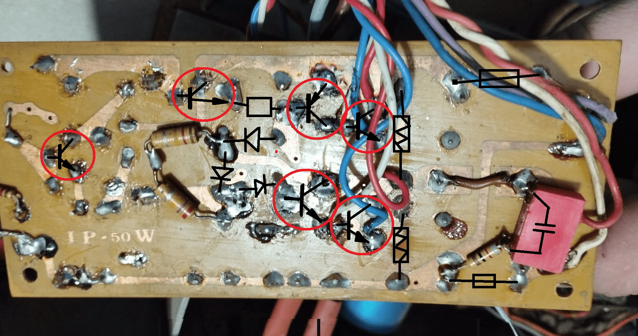

transistor amp not working after shorting output

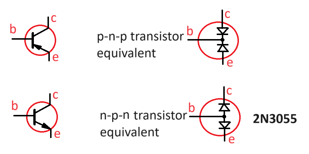

You can test the theory of the first picture in post 121 with a working diode scale of the DVM. The diode symbols, you should get 500-700 forwards (black probe to line), 9999 or ---- backwards. The line of the transistor symbols is the base. The leg with the arrow on it is the emitter. If your meter reads 400, the battery is bad or the DVM is bad.

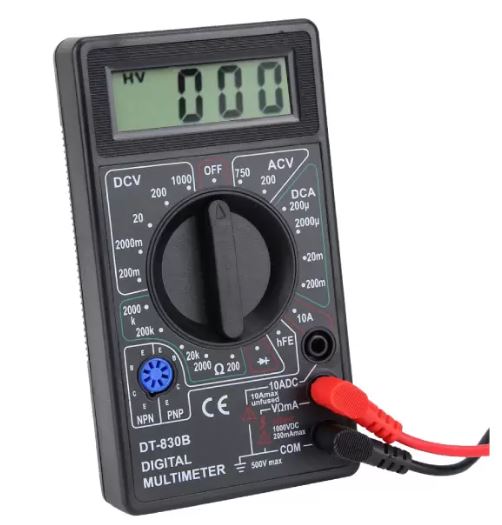

my meter is new and battery is new its cheap one but i think it works . here is picture of it. i dont really want to spend money on pro multimeter here its no so cheap. and i just need it sometimes as i said before i dont do electronics as my job xdd i am music producer actually xd this is something i like to do for fun mostly.

transformer has one or two i think but i don't see rectifier maybe is attached to transformer i am not sure. but i dont know why that is important
You need to measure a diode that is not blown up to prove your meter is a decoration or a test insrument. 500-700 forwards, 9999 or ----- backwards are the right answer. A rectifier is a diode for substantial current, usually over 1.5 amp. Wrong answer, throw the meter away and replace it.

i have soem diodes i will check it and will let you know if it shows good reading

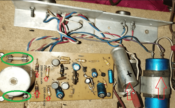

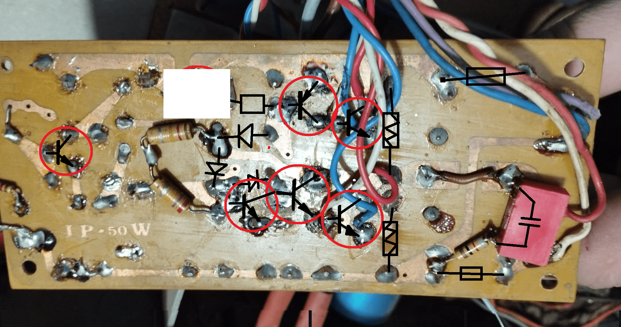

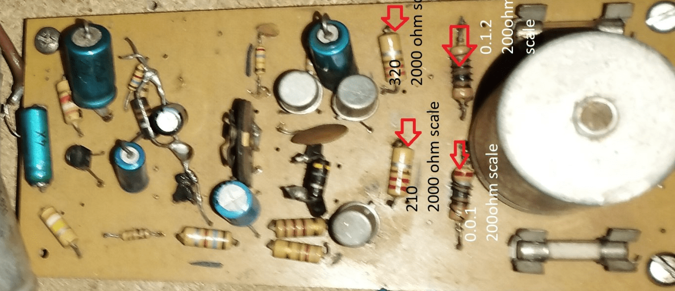

You need to label the transistors and diodes and make a table of readings. Q1 is obviously the little black transistor near one end. The base of that goes to the input capacitor. Next to the right is Q2. Of the 4 to the right, some are connected to the lower black rail (black? look at the big blue capacitor labels for minus), make those even #, some are connected more to the plus rail (white) make those odd numbers. Of the two output transistors, make the one closer to minus Q6. Label the board with a permanent marker, ours are branded "sharpie". Make up a table with the transistor numbers in order, E B & C for each, take diode scale readings forwards & backwards and write them down. Please report. On 1 cm diameter transistors emitter is the lead closest to the tab. The two diodes are probably between the bases of the drivers (that connect to the output transistors, the TO3 ones 2.5 cm long on the aluminum angle.
All transistors showing opens ---- or shorts 0001 should be replaced. I found TO39 transistors at digikey. You need Vce of 50 to 100 v for a 50 w amp with 2n3055 outputs. Probably your rail voltage is 40 to 75. Suitable ones in stock at digikey minnesota are npn 2n3019 2n2102 2n5320 2n2405 and pnp 2n4033 and 2n5322.
Not all transistors showing b-e and c-e of 500-700 are good, some can collapse to zero volts with rail voltage on them. These you will have to detect with a voltage test after you build the light bulb box to power up the amp.
