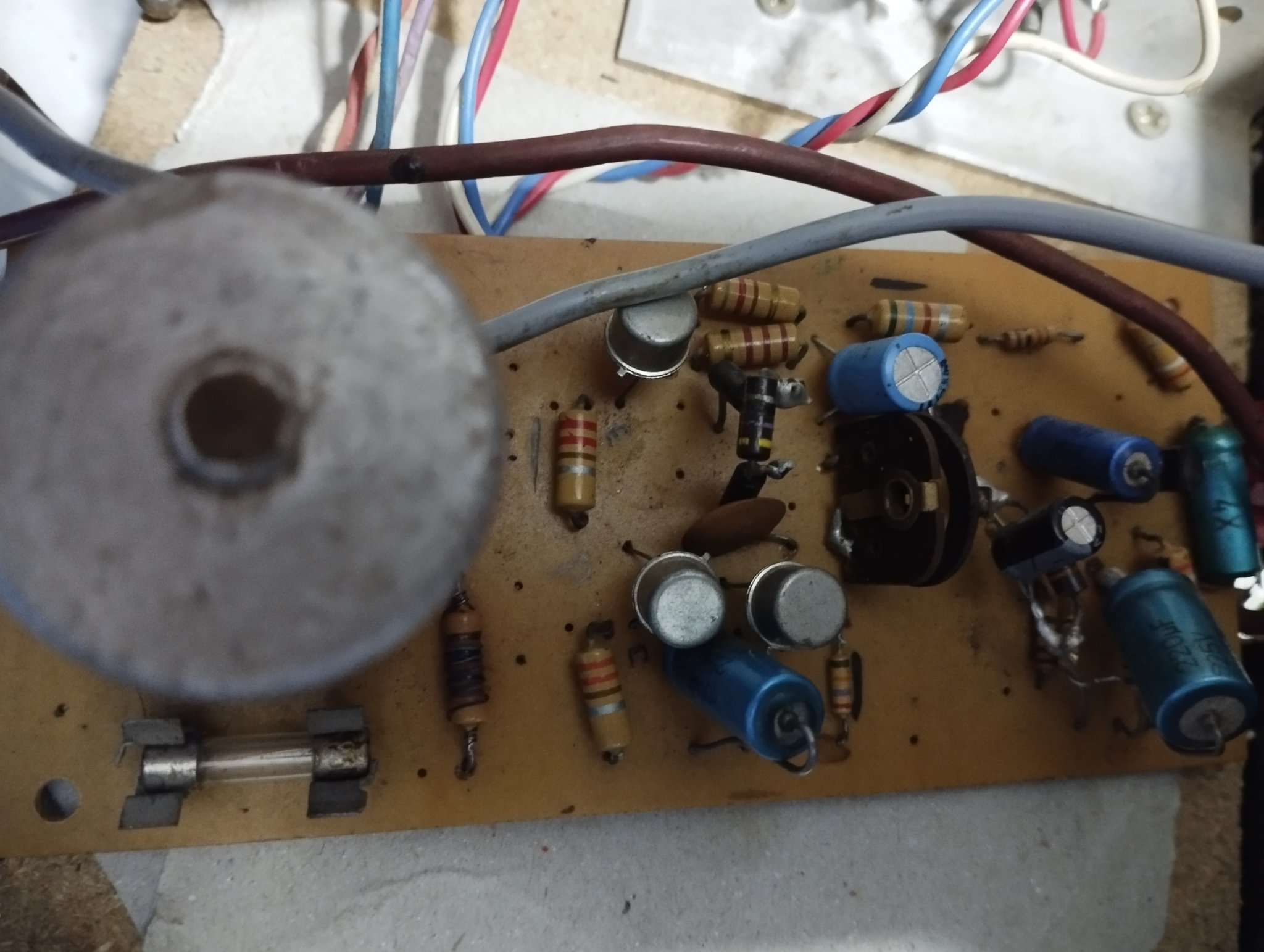

good idea but i will buy all new transistors so i can be sure its none of them and i will mess around with old ones
i can find transistors but i dont know what are those 3 small ones here
Yes, they are stamped, but you must have a good magnifier to even see them clearly. Sometimes it is white ink, but many times it is more like a branded part number.
Bend one of them back a little, and you will see it on the flat side.
removal by newbies causes more damage than leaving them alone. You don't need markings to buy the small round ones. There is only one kind of mid sized EBC silicon transistor sold pnp & npn, usually at most sources zero. TO5 package as you have is extinct. I can sometimes find an EBC TO39 package in stock at farnell. If huggygood wants to give you anything, 2n5320/22 are what my ST120 had. Mooly provided some old European part numbers in post 14 & 19. 2n2907 as post 117 is wattage limited only suitable for the input transistor. Plastic pack transistors are BCE and require twisting the leads around to install for EBC parts. I damaged my circuit board doing that. Lifted the lands up ( which can happen any time you remove any part from a pcb).
