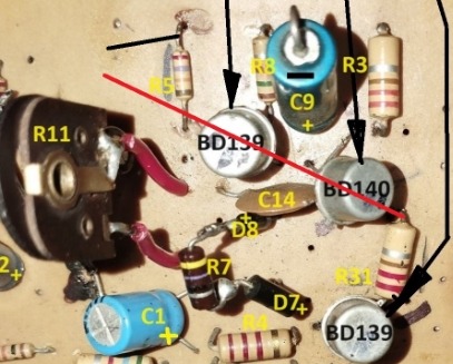

Diode is OK.
Now, we will power the amp without the big output transistors.
With the bulb in place.
Then measure the DC voltage between those two resistors and see if you can change it with the potmeter R11.
It should be around 27V.

it is 27v i can change it iwth the pot i did not go all full left and right on pot just in case i dont brake something but i did small adjustmets both ways and it increases and reduces

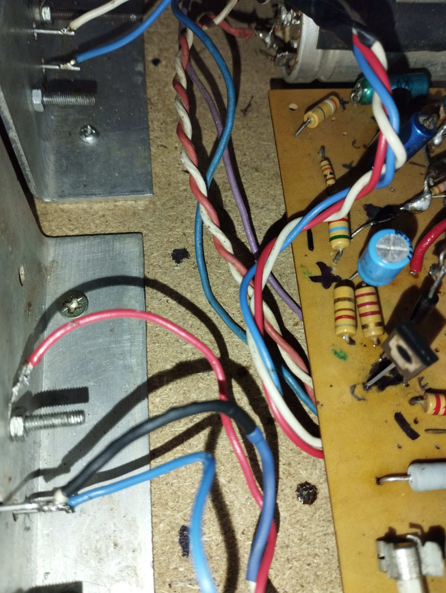

OK, connect both big transistors and try again with low volume.
Watch that no parts get hot. A bit warm is OK.
i will put shrink tubes over transistor pins if all works out in the end for now they are like this
