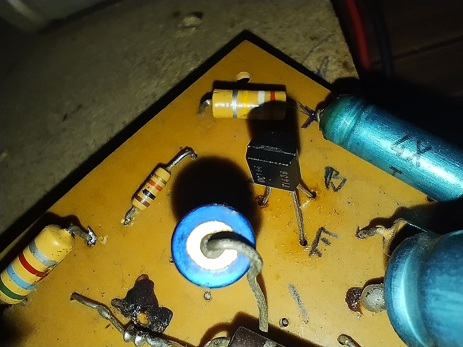

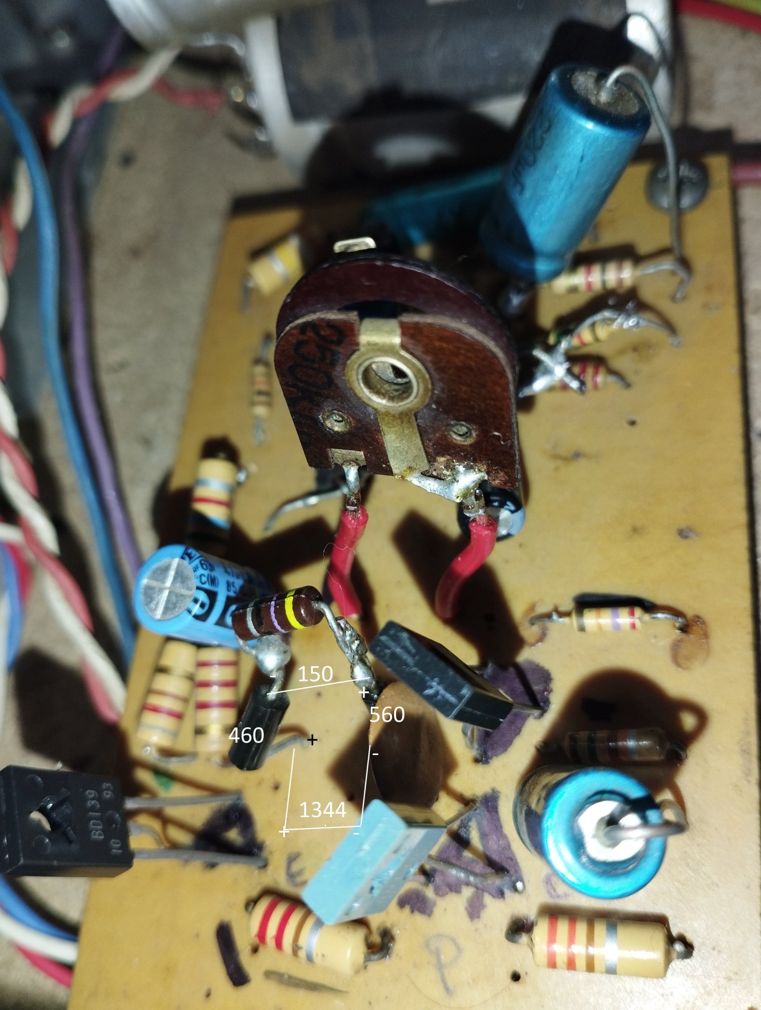

Now with your meter on diode tester, what do you measure on this diode?
Both forward and reversed measuring.
And also compare with the other diode.
So, we need four values.

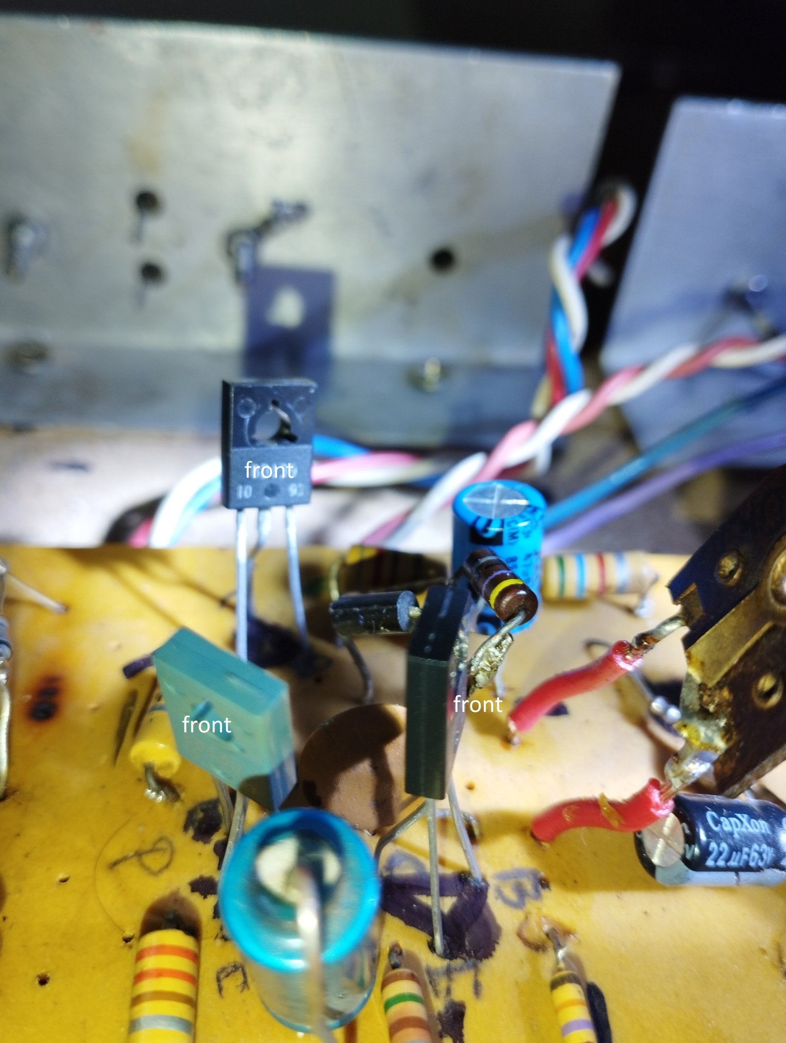

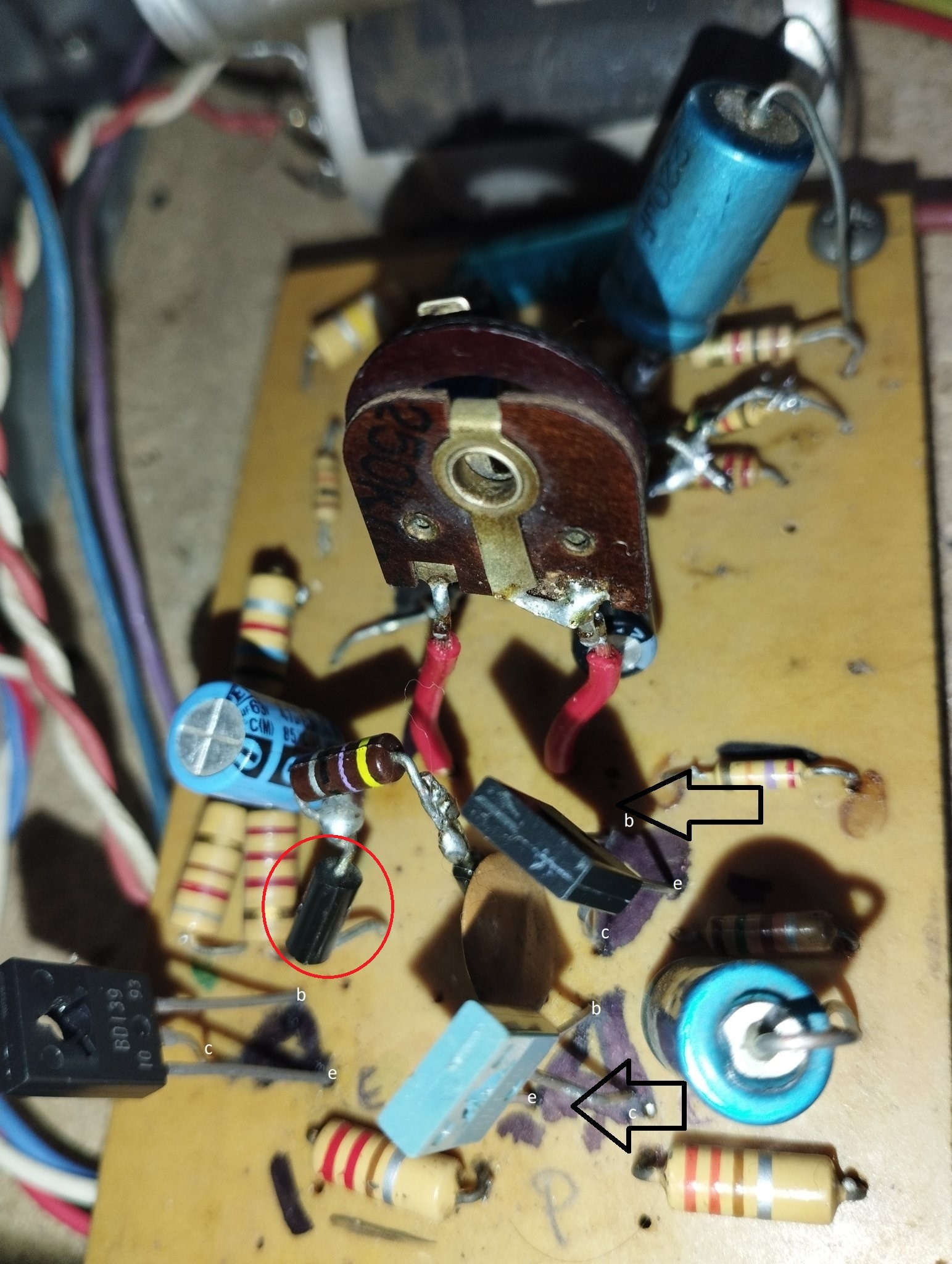

btw yout put the arrows on transistors e and b i did not put them in place yet so i cant measure it

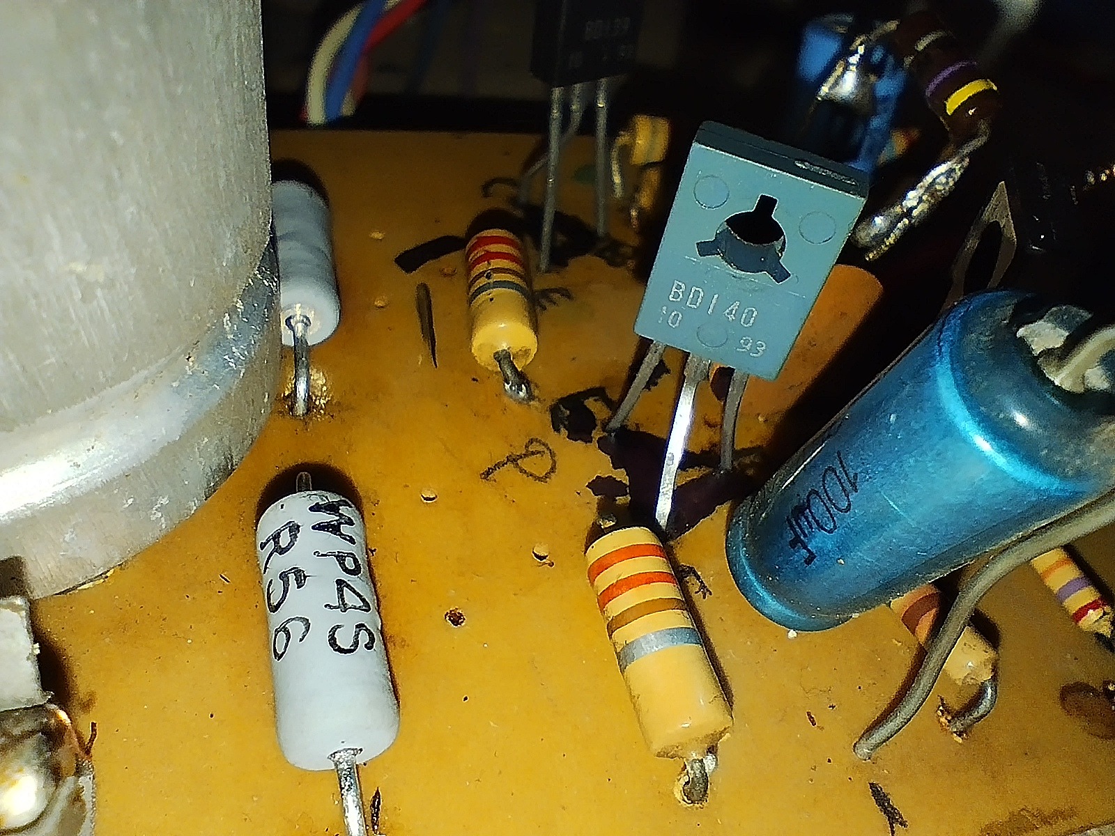

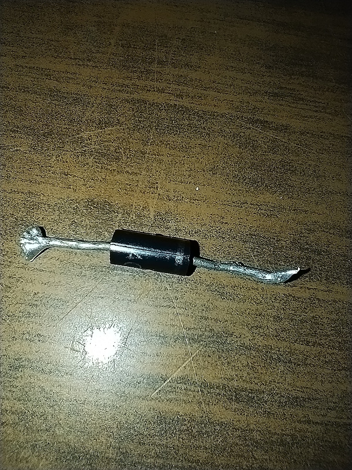

The 460 is probably good but I would rather see both 560 or so.
Do you have another diode at hand that measures +/- 560?

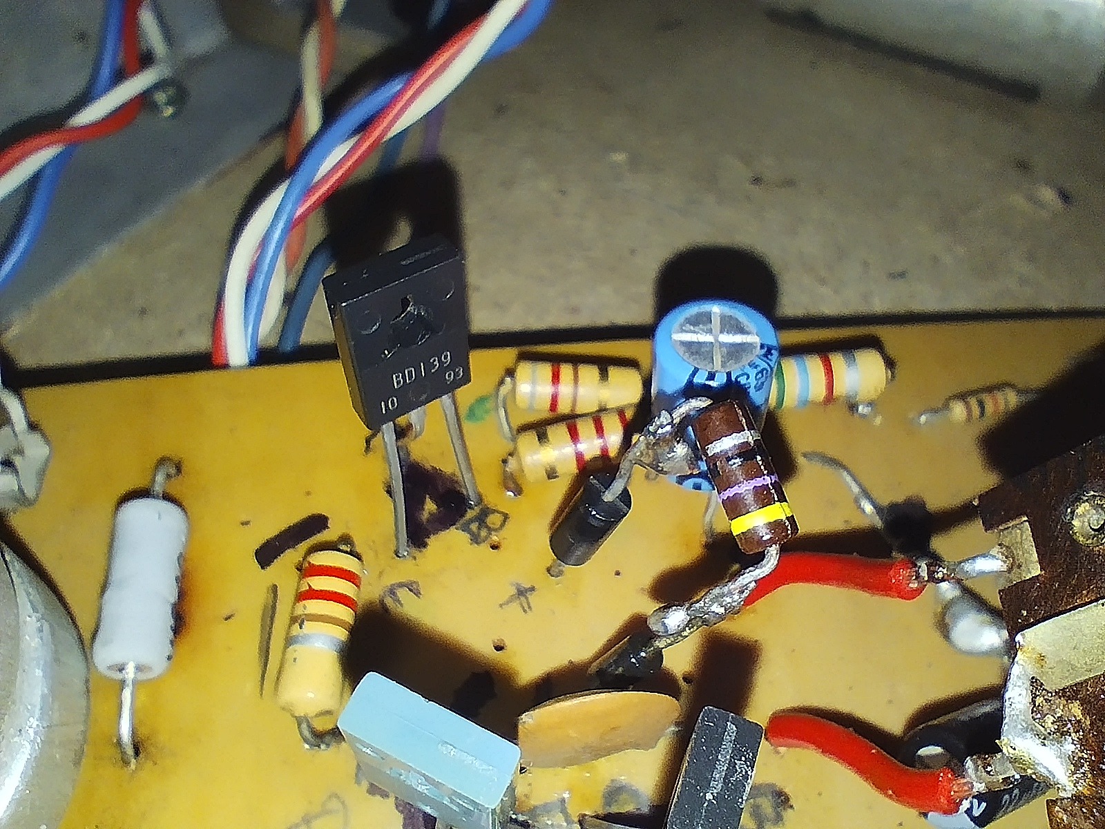

i have few i will check it. btw should i install transistors and resistors in place now ? i will not power it up

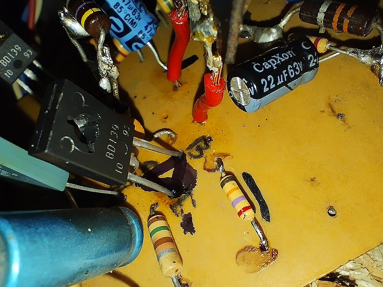

Good. Replace the 460 with it and now you can solder all transistors as well as the two R56 resistors.
alright i will do it 😀 btw i will replace all caps in next few days btw what should i do with ceramic cap ? ones thats says ub 270p do i have to replace that too ?

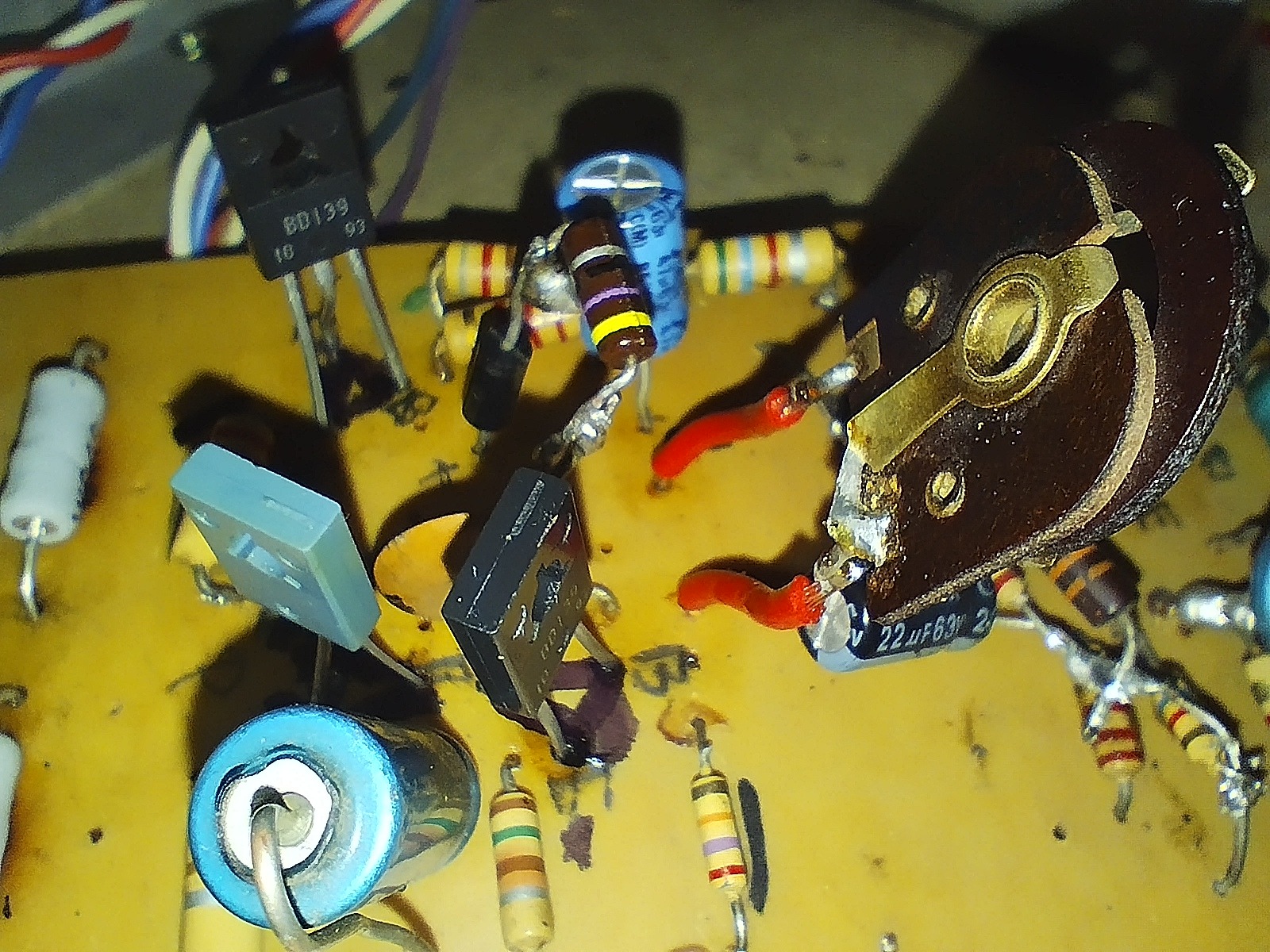

here is everything i soldered i think that i did everything right
