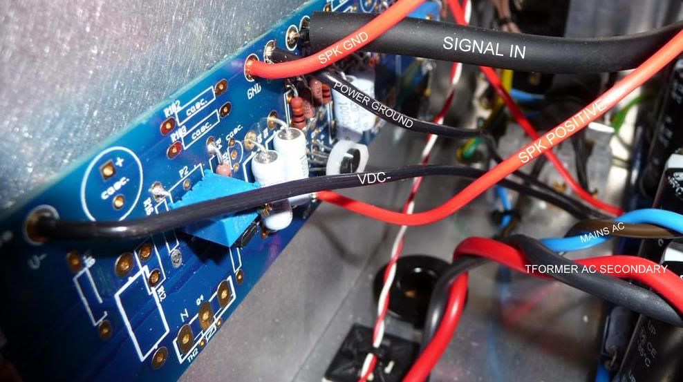

What are those input caps for? I would remove them before trying more fancy solutions. Also the speaker wires could benefit from being twisted. Just make sure you don't have power conducting wires in the loop - right now you have one of the supplies in the speaker loop on the left channel.
Hi Christian
If you are referring to my picture, the input caps were added whilst trying to solve the hum problem. I'll remove them for now.
I'm not sure I follow this comment...
'- right now you have one of the supplies in the speaker loop on the left channel'
I've just checked and it appears the right channel is wired the same as the left 😕

Yes, here you have the vdc- running through the open loop of your speaker cables - it is probably not the root cause, but it is worth fixing.

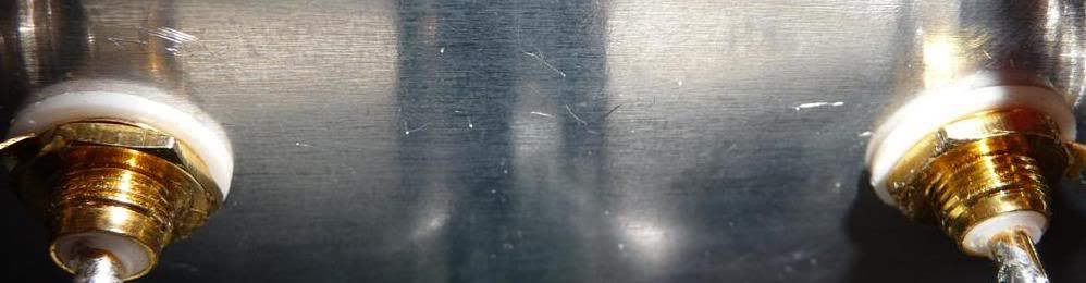

Are the holes for the RCAs big enough to avoid metal contact? Do you have insulation on the other side as well?
If you look at the left side of the picture, the V- supply is running through the loop of gnd and out.
Could you take some pictures of the rca plugs? Sometimes I have used tape to make sure that they are not touching the chassis.
Here you are...
Yes the holes are much larger than the RCAs and they are also insulated on the other side.

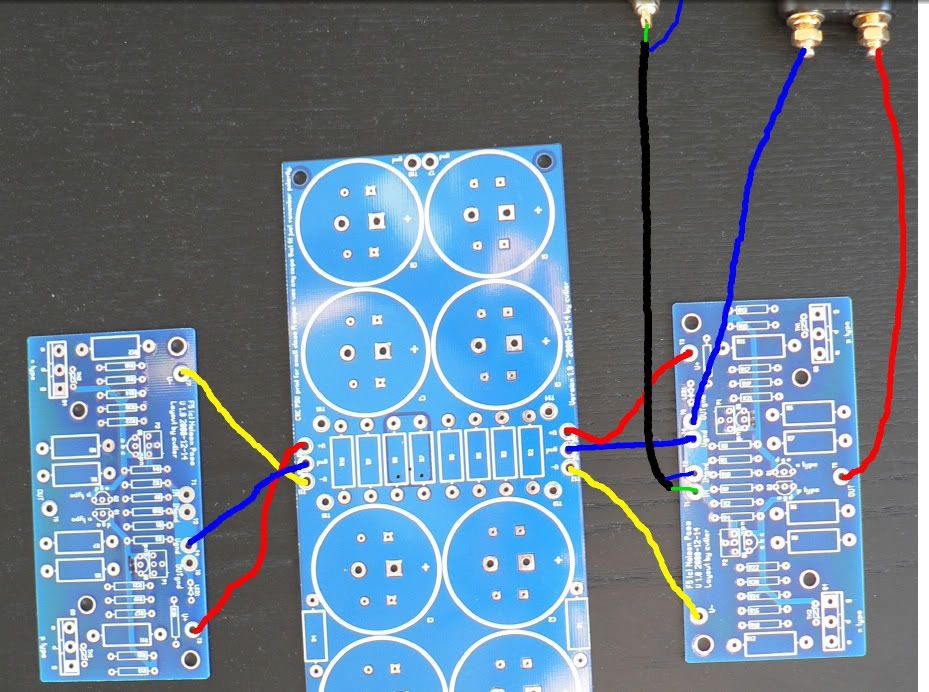

Are you recommending I de-solder the current spk ground and the power ground, swap the cables around and re-solder?
Here is the diagram I followed.
You can just unscrew the v- and run it around the speaker loop. But as I said, this is probably not what fixes your hum issue.

the blue and red running to the speaker terminals look like one channel Flow and Return.
These should be twisted together as a pair.
At the chassis terminals maintain the minimum area of loop to reach the terminal soldering points.
At the PCB keep the wires twisted right up to the Flow connection at speaker OUT. Keep the Return wire crossing over or under the PCB and take it to meet up with the power ground. Twist it with the power ground to continue it's route to reach the Main Audio Star Ground.
The PCB has spaced apart supply rails terminations. This is bad layout, but you are stuck with it in this PCB. These must be brought together and twisted with the Power Ground back to the Main Audio Ground Star and then continue past the star as a twisted triplet to the PSU output. Again maintaining the minimum loop area at every termination.
You will have a twisted triplet from PSU to Main Audio Star Ground.
A twisted quad from MASG to amp.
Three single wires at the PCB.
A twisted pair from PCB to speaker Terminals.
This is the best way I can see to minimise the loop areas of the high current cables.
I do not know if it will help, but it is certainly worth trying.
