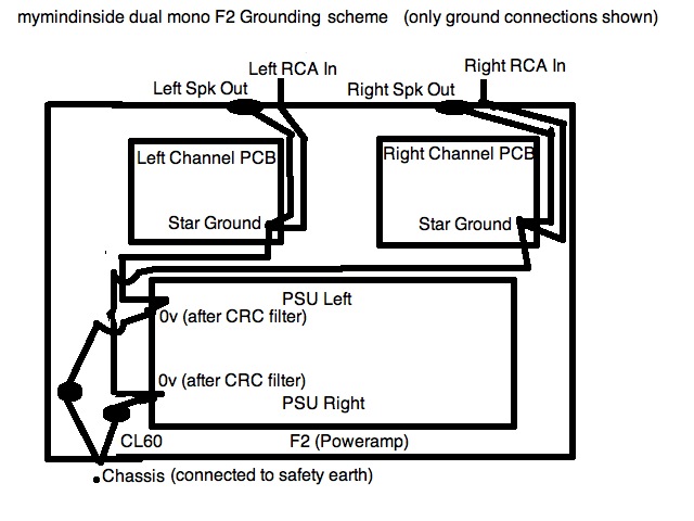

Before i try the 100 ohm resistor i just wanted to confirm that having the signal grounds of both channels connected together at one star is the correct way to ground a dual mono amp (that is how my amp is presently wired). Would i benefit from keeping the grounds of the two channels seperate?

Puffin, where is GO on the board? i am connecting my power supply ground to the hole marked GND right next to the one marked SG. SG has my rca gnd and the speaker return connected to it. ditto on the other channel. i have just finished rewiring to this setup and now have a loud hum when both channels are connected. would you mind explaining how the grounds of your two channels were connected.
Andrew, i understand the need to connect all exposed conductive parts to earth. If i am not mistaken, In the Firstwatt F2 this is done by connecting the 0v rail to the chassis through a thermistor, and connecting the chassis to earth. the 0v rail is connected to the RCA ground and the Speaker return.
In the photos of the Firstwatt F2 it looks like each channel has its own signal star and a trace leading from this star to the 0v rail. this exactly what i have done now but i have a loud hum, much louder than my previous wiring setup where i had connected the signal grounds of both channels together at one star.
Please tell me what i'm doing wrong....

does my wiring setup match yours? can you think of anything i have done done wrong which is giving me a loud hum (disappears with any one input rca disconnected)

Ok, let me ask a specific question.
what resistance reading should i get when i measure between the 0v rails of the two channels. if i measure without any inputs connected i get 18 ohms. this is the series resistance of two cold CL60's which connect the two 0v rails together, with the chassis connected in between the thermistors. if i measure with rca inputs connected then i read less than 1 ohm. i suppose this is because the 0v rail is connected to the pcb ground which is connected to the rca input ground and the left and right rca input grounds are connected at the preamp.
is this low reading with inputs connected normal or am i missing something?

My amps measure infinity between grounds without inputs connected, and 0 ohms with the plugs inserted. Such is dual mono 🙂 and no chassis. Which basically means there is no other shared connection to ground apart from the input RCAs.
Can you try drawing a diagram of how your grounds tie together? Just putting it on paper will give you a few ideas.
In the F1 manual Nelson says that the Chassis is tied to Earth at the IEC Receptacle as well as by the 4 standoffs on the PSU PCB. Strictly though, regiregi22 is right, and the connection should be made with a dedicated bolt.

Am attaching the ground wiring scheme. my grounds meet only at the input rca's, if this is the correct way to do it why am i getting the loud hum?
