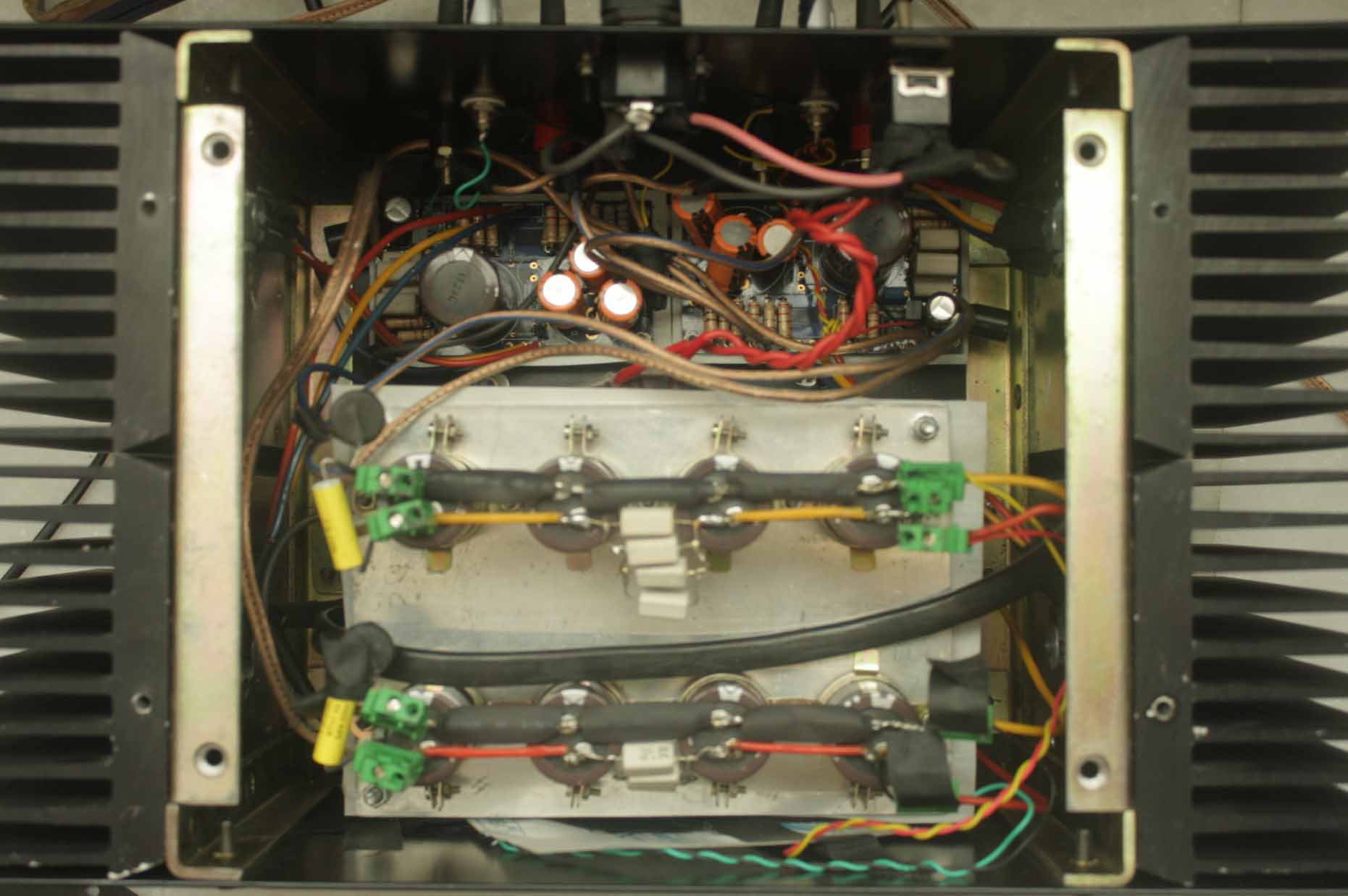

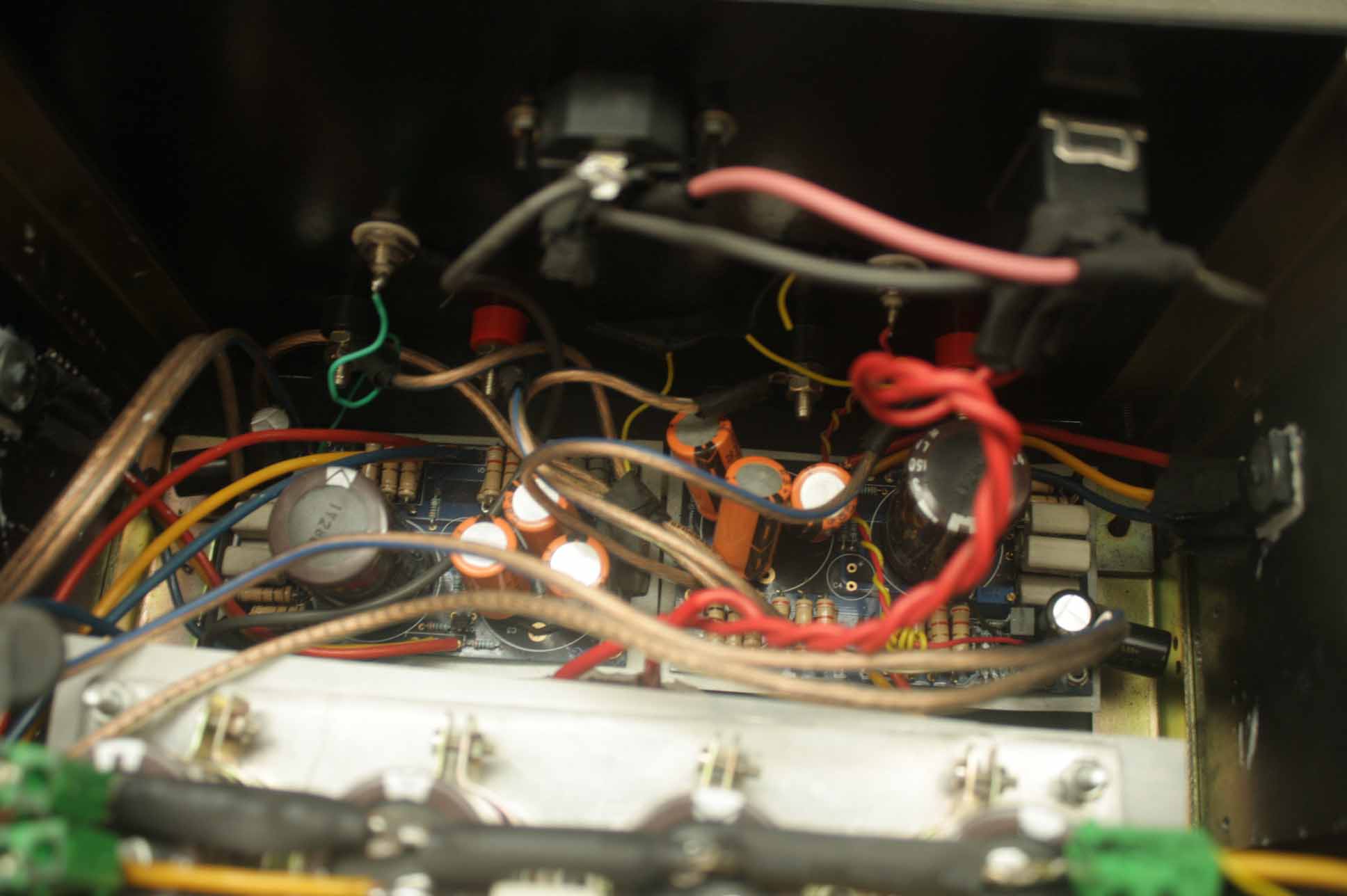

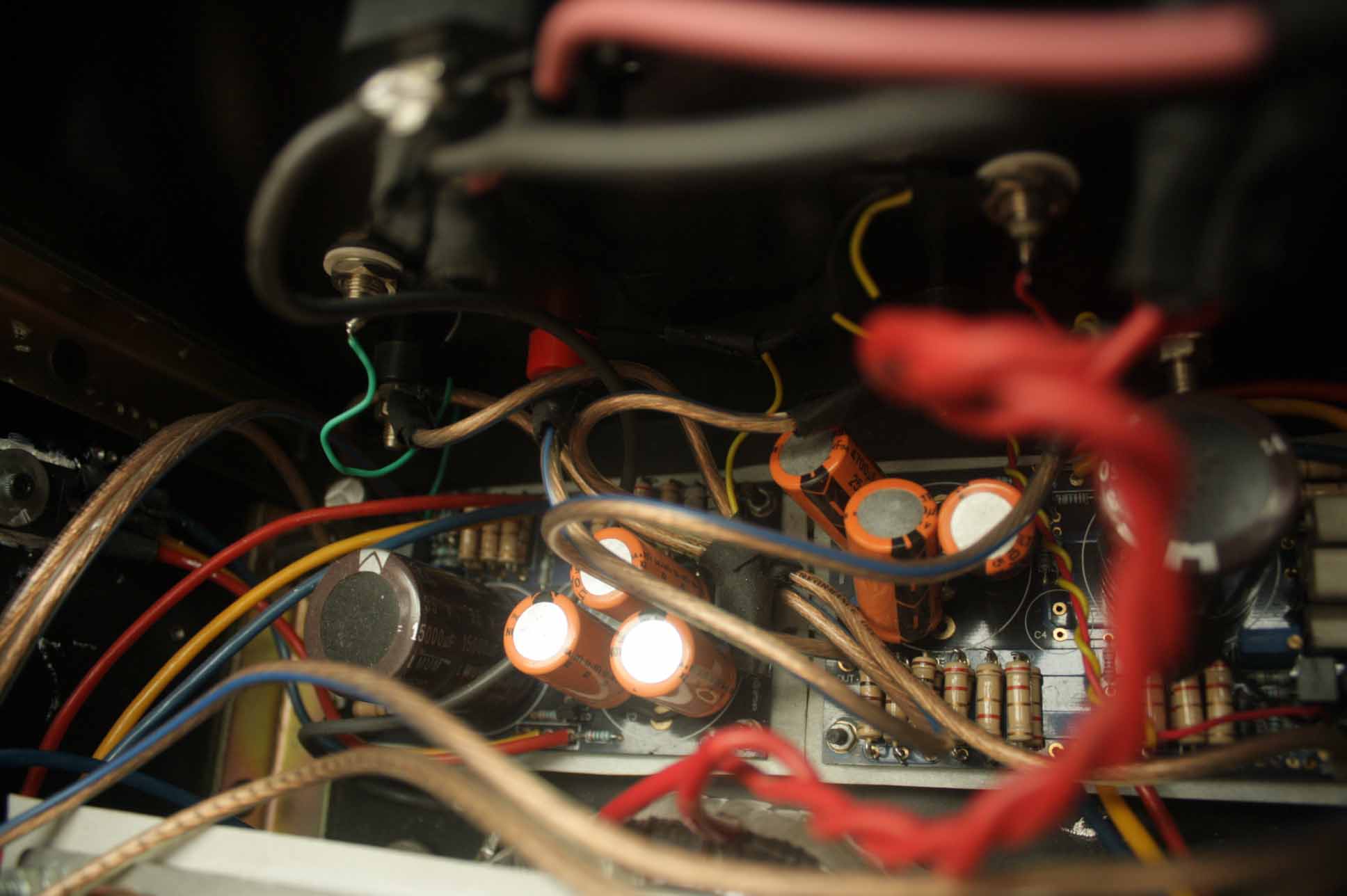

I am attaching some photos of the internals of my F2. i know it isn't neatly wired but it became messier each time i changed something to try and get rid of the hum. initially the signal grounds (input and speaker return) went to their respective pcb's where they were connected (on the pcb) to the 0v wire. the two channels were not interconnected in any way. this resulted in a very loud hum and i guessed that it was because the grounds were meeting at miniplug of the input cable (i was using an ipod source - no pre.the cable was an rca to 3.5mm miniplug which has a common ground). with this setup if i jumpered the Left and Right speaker return terminals together the hum reduced, same with the rca grounds. So i rewired it to the arrangement i described in my earlier post with a single star where the signal grounds of both channels were connected. this has reduced the hum to about 20% of what it was but it bothers me during critical listening and on quiet passages.
Is it correct to use a single star with a dual mono type amp where the channels have their independent power supplies? the 0v rails do not connect to this star but go to their respective pcb's. the star one wire connecting to each of the pcb's.
Any help will be greatly appreciated, and once again, apologies for the messy wiring.

Is the power transformer a toroid and is it sitting underneath the PCB shown at the top of the left hand photo?
If so, I agree with Nelson. Get that thing out of there or stand it on edge and place a heavy (0.060 thick) steel plate between it and the circuitry. And DO NOT run a bolt through the center hole to secure it, unless the bolt is Nylon.
If the power transformer is somewhere else, have you twisted all AC bearing wires? Do you have a full ground plane on the PCB? Are you certain that there is only one connection made to ground with all of your power and signal circuits? Have you placed a 100 ohm resistor between signal circuit ground and power circuit ground? Are you grounding to the chassis at the IEC connection to power ground?
Hi Nelson,
will move the transformer tomorrow morning and hopefully it will go away.
Budp, the transformer is below the metal plate holding the PSU caps, so will try and move it further away. it is secured by a metal bolt through the center but there is insulation(and space) between the top of the bolt and the bottom of the metal plate. Did you warn against the metal bolt because of the danger of creating a shorted turn. This is one of the things that worries me about this layout and i have ordered a nylon bolt. In the meantime do you see any danger if the insulation holds and the bolt doesnt touch the bottom of the metal plate.
The Ac bearing wires are twisted (the primaries are the twisted red wires on the right of the 1st photo). The The two power grounds (0v rails) connect to the chassis through a CL60 thermistor each. I havent put a 100 Ohm resistor between my signal and power grounds. if i want to do this can i put this resistor between the signal star and the pcb (to which the 0v rail connects)?
Thanks for the suggestions, and good job spotting the transformer Nelson. i had to look at the photos a few times before i saw a little edge peekng out in the third photo 🙂
