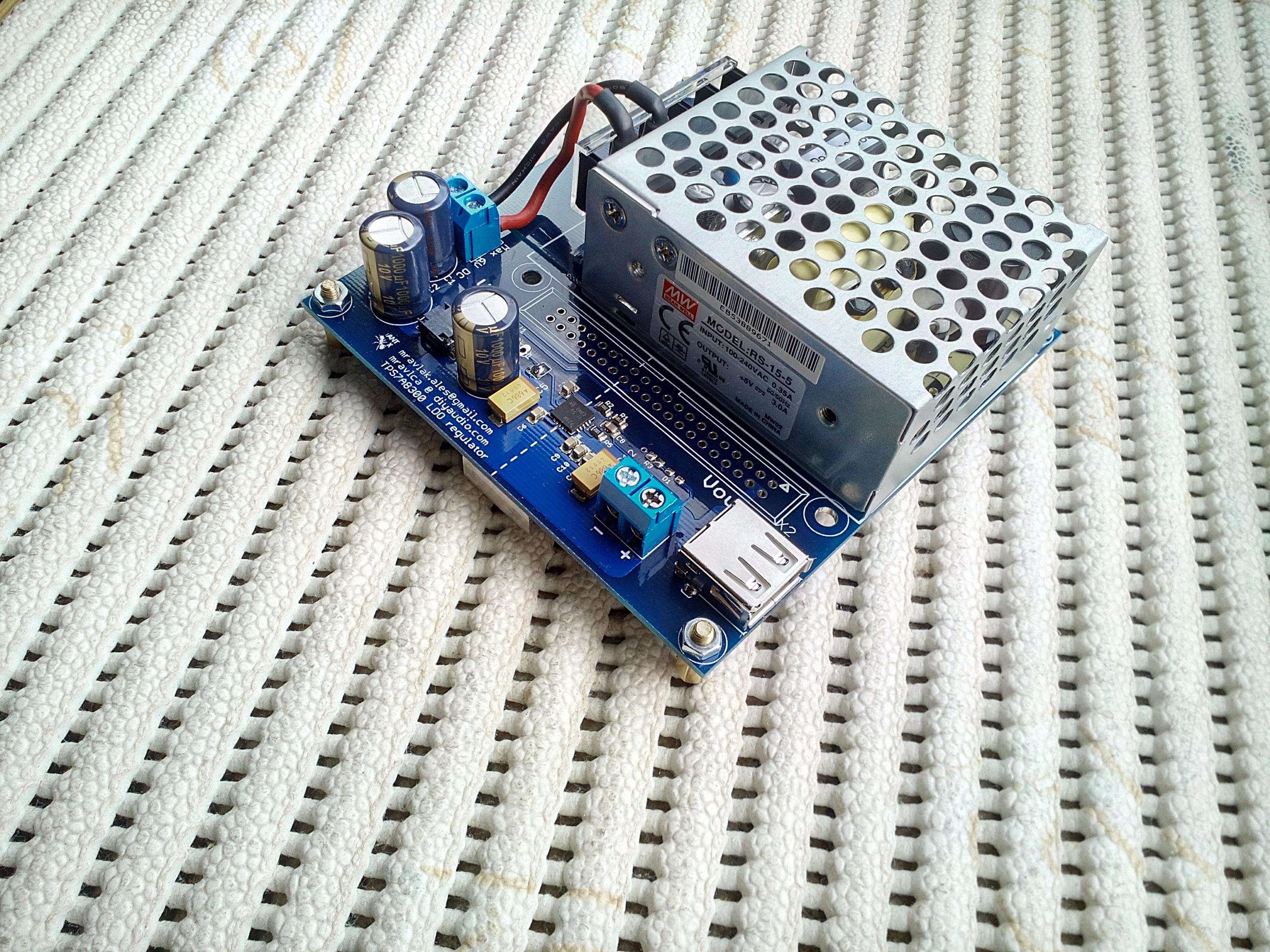

I finished the 5V version and here are the results (50ohm load gives 100mA).

Just 1 question, as there is an output for the cable, isn't that the problem if a one use a long cable ?
It seems to me that Ales said that the cable for the DC output should be as short as possible.
PS
2nd question : How long (max.) can be a cable between this Regulator's DC output and the device to be supplied ?

If you are using longer cable to the powered device, sensing wires are recommended to be used. Sensing wires and power wires must be connected together on the connector that goes into the device. Of course you will not be reaching same noise levels as with short cable.

Hello Ales,
I see your measurements and if i'm correct you measure at DC but you should measure at AC to measure only ripple.
Best regards,
K
Eric, I noticed this when I uploaded the picture. Though AC measurement doesn't look much different.

I am confused by your power transformer sizing advice.
If this was used to size for a 5 VDC output I come up with a result of approx 4.5 VAC instead of the approx 5.2 VAC the manual states.
What am I getting wrong?
Please let me know.

4,5Vac or also 5,2Vac is very low for 5Vdc output, or you should use a very big capacitor for low ripple voltage, otherwise the ripple will getting below the working voltage of the regulator, but a very big capacitor will give you other problems with very big ripple currents on power on.I am confused by your power transformer sizing advice.
I use a 6Vac transformer, after rectifying and smoothing with a 4700uF it will give you around 8 to 8,5Vdc for input, this will give you around 2V headroom.
Calculation at 4,5V
Transformer: 4,5V
Load: 50 ohm
Ampere: 1A max
Rectifier Voltage: 1,1V
Usec = secundairy voltage transformer (1,41 x Utransformer)
Uc1 = Voltage across smoothing capacitor = 1,4(load) x Usec, this is your input voltage for the regulator.
Formula:
Uinput-regulator minimal = 5 + 1 = 6V
Uc1: ((1,41 x Utransformer) - 1,1) x 1,4 = 6,34V
Your max ripple voltage = 6,34 - 6 = 0,34V
That's not gonna work.
Calculation at 5,2V
Transformer: 5,2V
Load: 50 ohm
Ampere: 1A max
Formula:
Uc1: ((1,41 x Utransformer) - 1,1) x 1,4 = 7,56V
Your max ripple voltage = 7,56 - 6 = 1,56V
If you choose a ripple voltage of 1V you need at least a smoothing capacitor of 10.000uF
Ripple current at switch on will be very high and 1V ripple is very tight if you consider that you mains power of 230V will fluctuate 10%.
