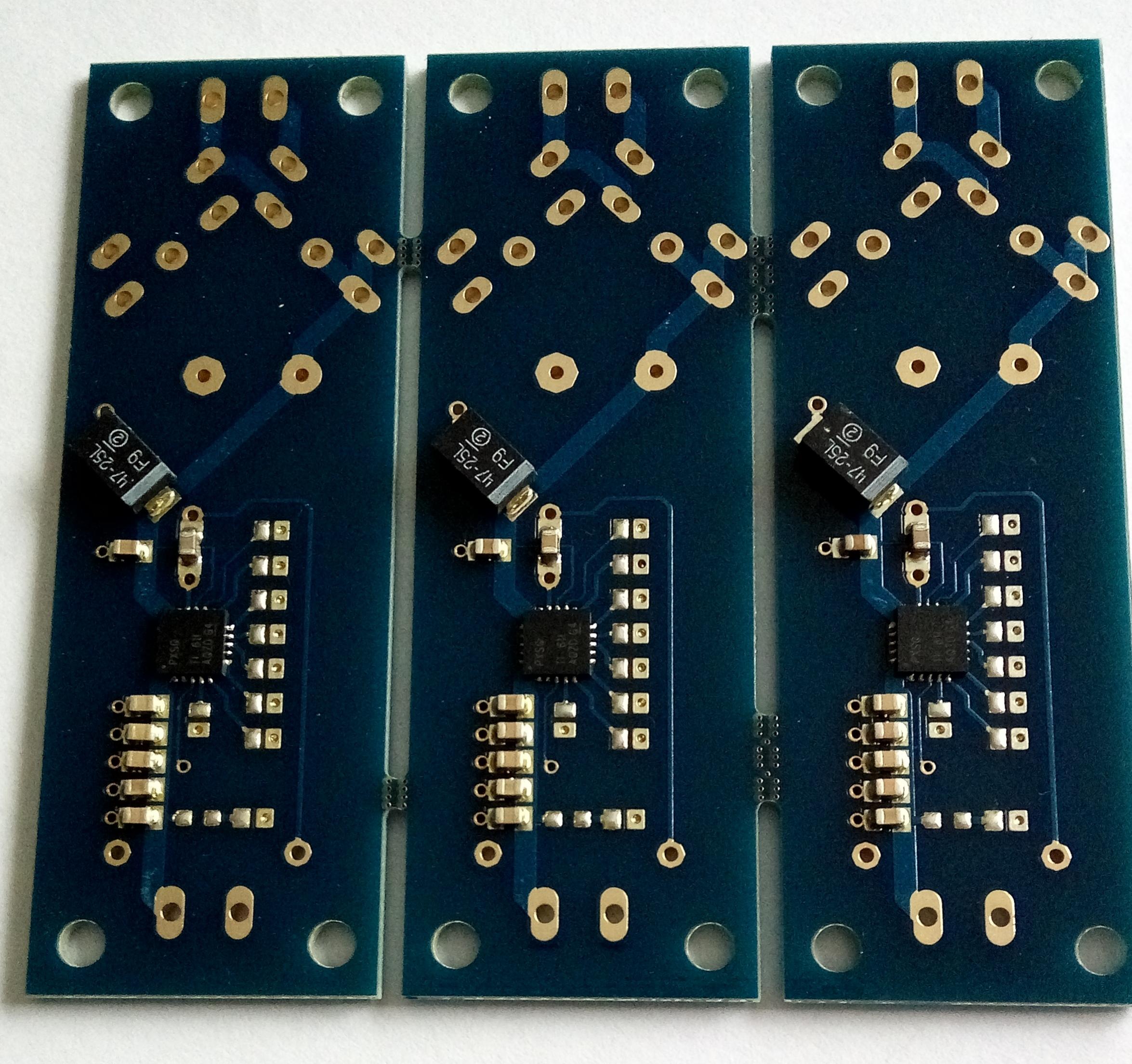

CLEARANCE SALE
Hi guys,
so I have a bunch of PCBs that are without silkscreen. These are sold without any other parts and in batch of 3pcs. Price for one batch is 50€. This price also includes priority shipping with tracking and paypal fee. If you're interested drop me your paypal email.

New price: 40€ per batch/shipping and fees included in price (one batch can be split into three individual regulators)!

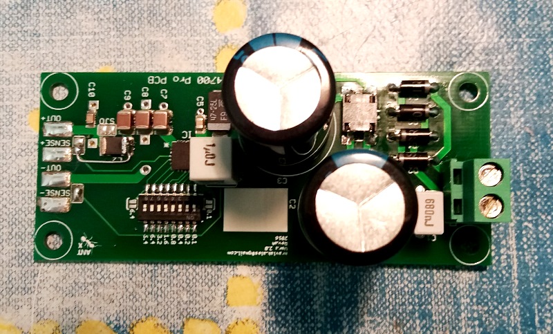

Today i tried new TPS7A4700 PRO regulator from Aleš.
Works excellent...Some more pre and postfiltering is done. My scope couldn*t measure noise level. Will try with my friend 60mhz Hameg if there can be measured.
And selectable switching voltage selector is aded, for easy perfect matching output voltage.
It will be used with V DACII (12V-1A)...sound impressions in future.

You need a spectrum analyzer to measure ripple/noise at this level.
I see Ales has a 'pro' board. What's the difference between the 'standard' version?
You are right. But if you don* t have it ... i measure noise trought different frequency ranges. For me is quite ok. Similar is with spectrum analyzer. It shows noise trought selected range at once. Then follows ear test on different positions...on my table are salas, teddy, belleson clone, trident clone, amb sigma ... and this reg. is in top range. More info. from Aleš.

Hi Eric,
PCB that androa76 has is an early version of new TPS7A4700 I am planing to launch.
Differences from standard are:
-on the AC side there will be premounted schottky diodes (have lower voltage drop), holes for other diode types are also placed on PCB
-CLC filtering, where L is common mode choke filter from TDK
-For voltage settings there are solder jumpers as before or DIP switch which can be mounted on the PCB, when testing regulator in different deviced voltage can be more easily set up
-on the output are three 22uF capacitors for better stability and performance,
after these regulators is also ferrite bead to further reduce noise from regulator and to "relax" the end result in sound, though short wires are must if using ferrite bead, if not used it can be easily shorted through solder jumper
When new version will be released I will explain these options even further.

Good Job Ales🙂
CLC...wow, even better than CRC, 😎
the little c18 aera is for tweaking ? 🙂 possibiity to had a vias also on the center of the plain cap aera (to try 2.5 mm pitch mkt cap, styren... possibility without breaking the design too to make this 2 caps pas a little widther (but with the same small gap as you did) : egg to test PPS caps which has no piezo effect but not the same result than a COG
PS : 1210 smd size pads with a via in a midlle of each but with same inductance gap (pitch) between pads as the current photograph if not compromising the perf.
