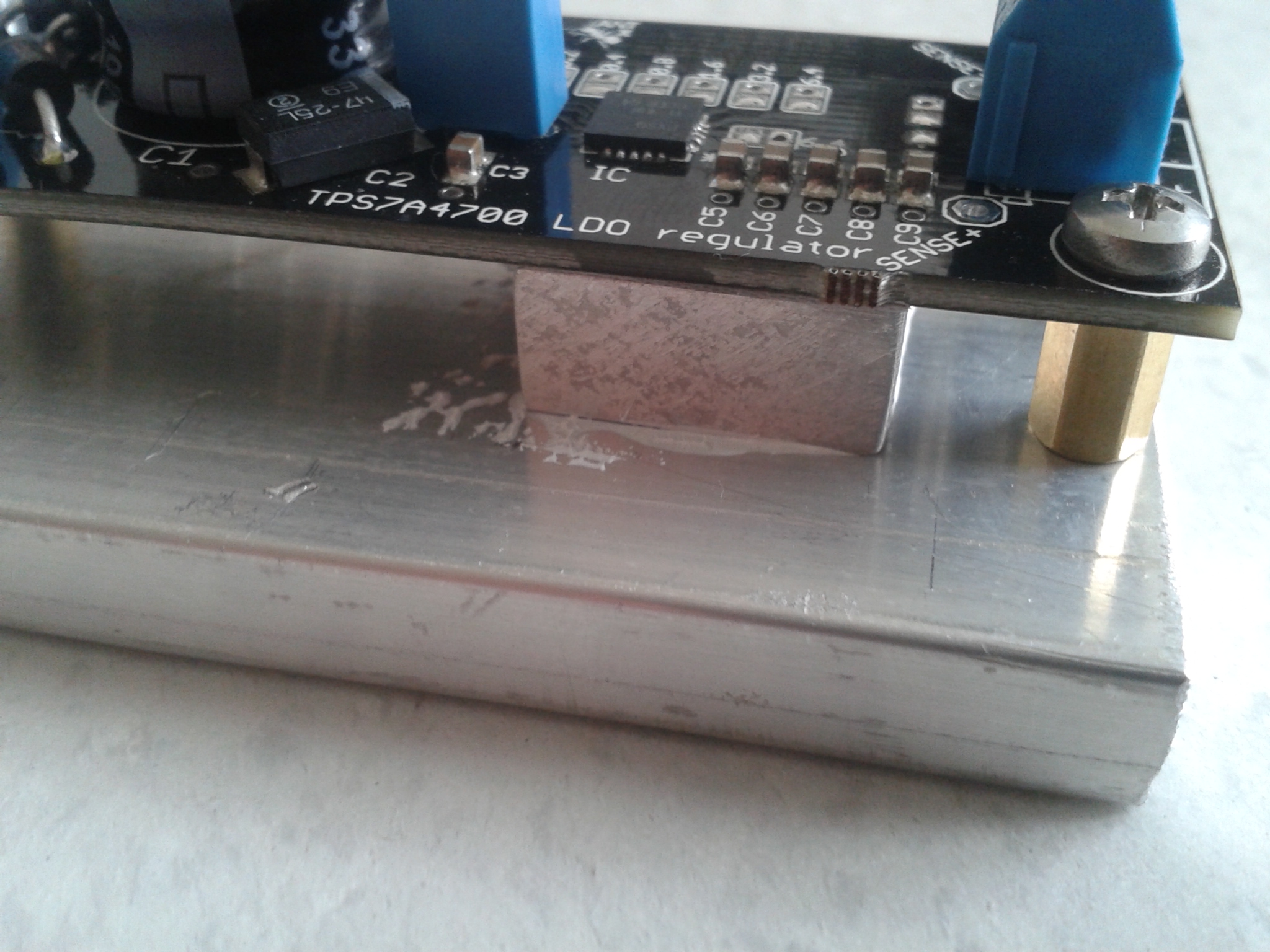

These two transformers are also ok. If you'll be facing higher temperature try to implement PCB like in the attched picture. That's why you also receive 8mm standoff which equals the thickness of aluminum block so you can create heatbridge between PCB and larger cooling surface. Bear in mind not to thighten screws too much as there might be a little difference in thickness, because of doublesided thermal adhesive tape.
I have it like this with 9VAC transformer for 5V output. I'd tested it with loads up to 400mA and it got barely warm after 2~3 hours.

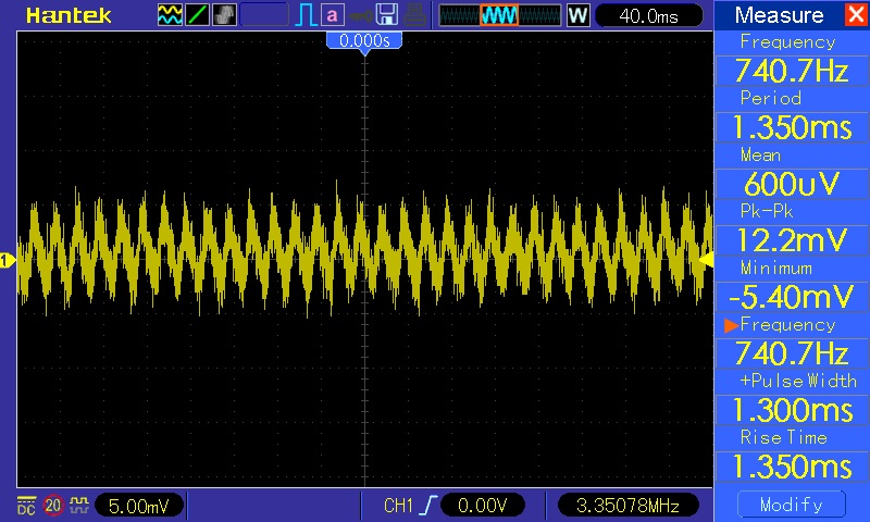

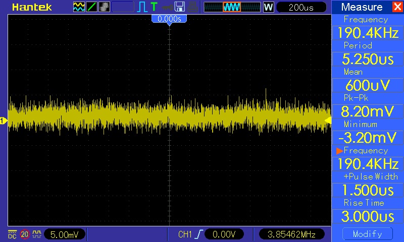

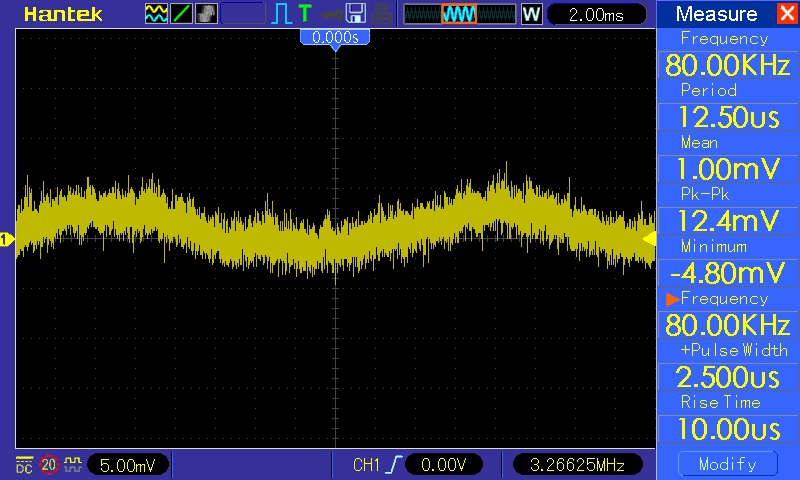

As it turns out I won't be able to easily compare regulator with datasheet as the results are not as accurate as I would like them to be. Upon all there is no difference when the probe is shorted to ground or connected to the output capacitor of TPS7A4700 PCB. I can conclude that only real measurements are from Kingpin who has smaller voltage range on his HP analyzer.
My setup is: Hantek DSO5102P <- LNMP (60dB gain) <- TPS7A4700 5V <- 10ohm resistive load.
20Mhz BW limit is on! Pk-Pk is shown is mV but you are really looking at uV.

I see your measurements and if i'm correct you measure at DC but you should measure at AC to measure only ripple.
