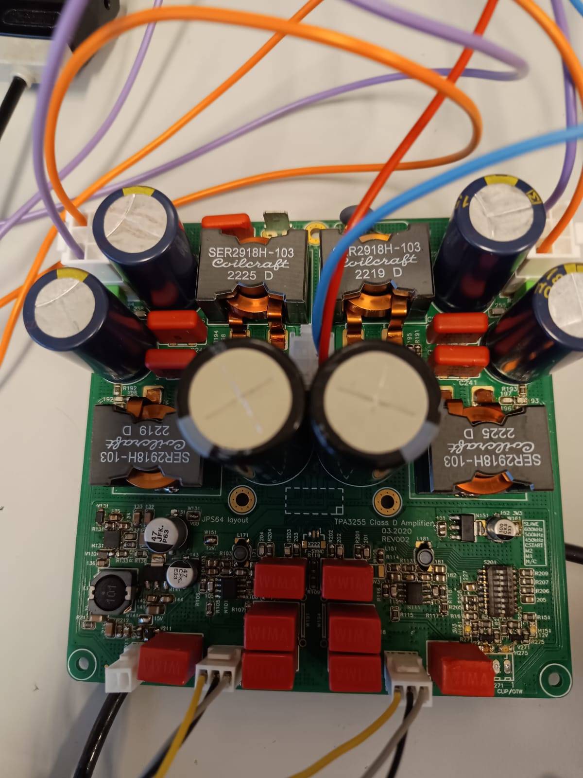

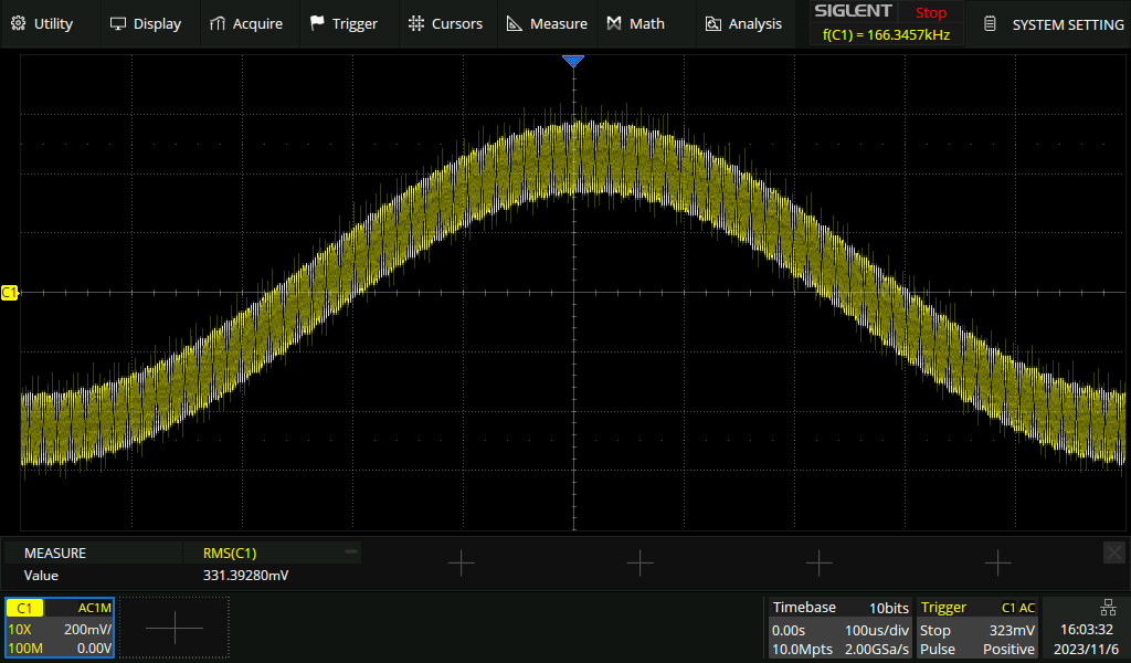

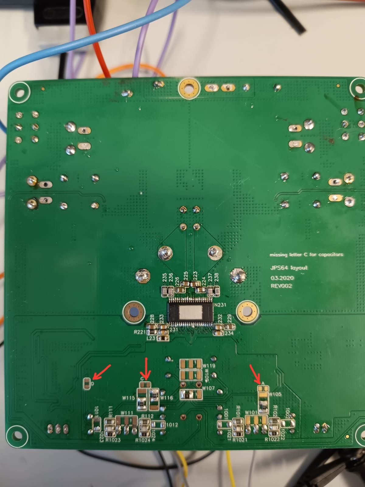

I think I don't understand the jumper settings. I attached 4 resistors of 4 ohm between each output a,b,c,d and GND. On each input I put a 500mvp-p 1khz signal. Only over the resistor of output b I get ~2 times the input + 450khz switching. Both NE5532's have my input at pin 1 and 7. All voltages 15v, 12v, 3.3v are present.
Hi Boris,
Excellent job of soldering! Looks very clean and neat.

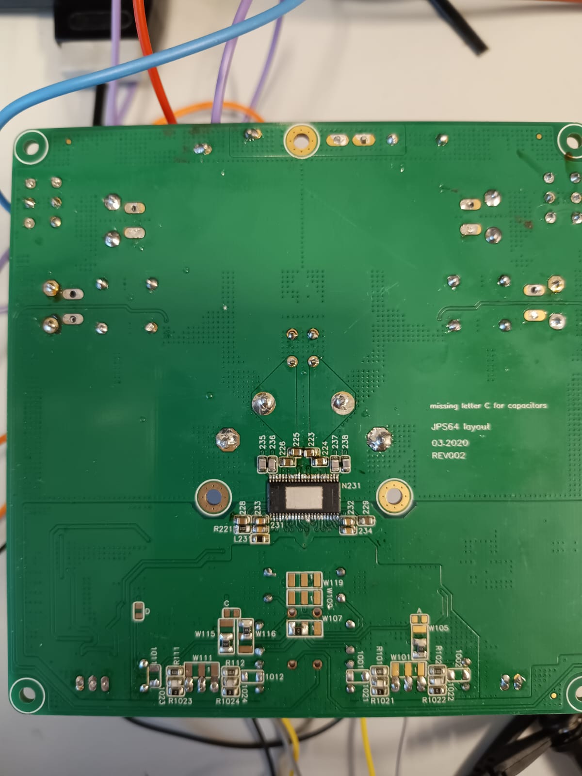

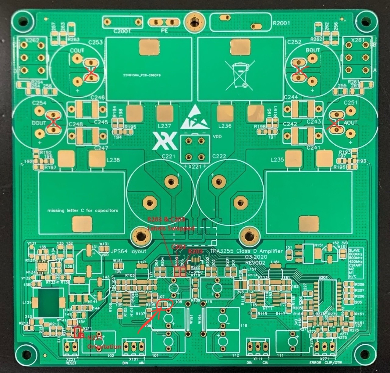

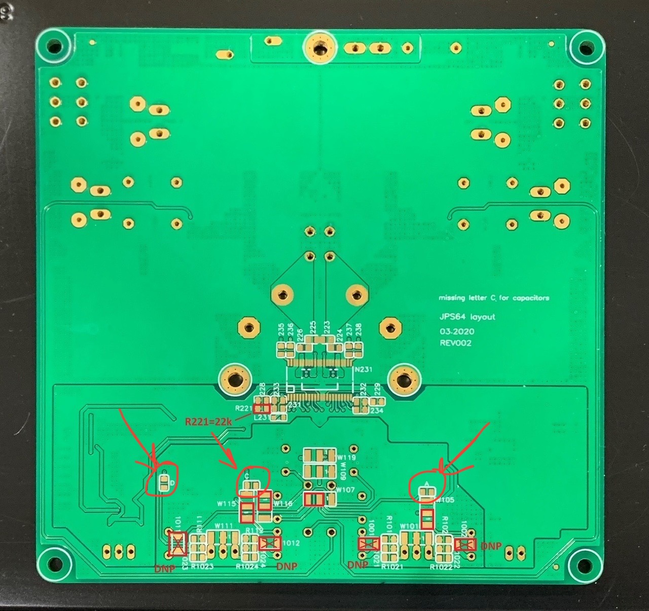

You did the W jumpers correctly. You are missing the input resistors A, B, C, D. Without these installed there is no audio signal going to the amp.
If you want PFFB enabled, use high quality metal thin film 0805 3.7kohm resistors here. If you do not want PFFB then use 0ohm jumpers.
With PFFB enabled you have 15dB gain only and amp maxes out at 75W into 8ohms. Without PFFB (0ohm jumper) you get 22dB gain and 150W max into 8ohms. But I would never use it above 125W for best sound quality.
The feedback resistors go where I concur led in red below.

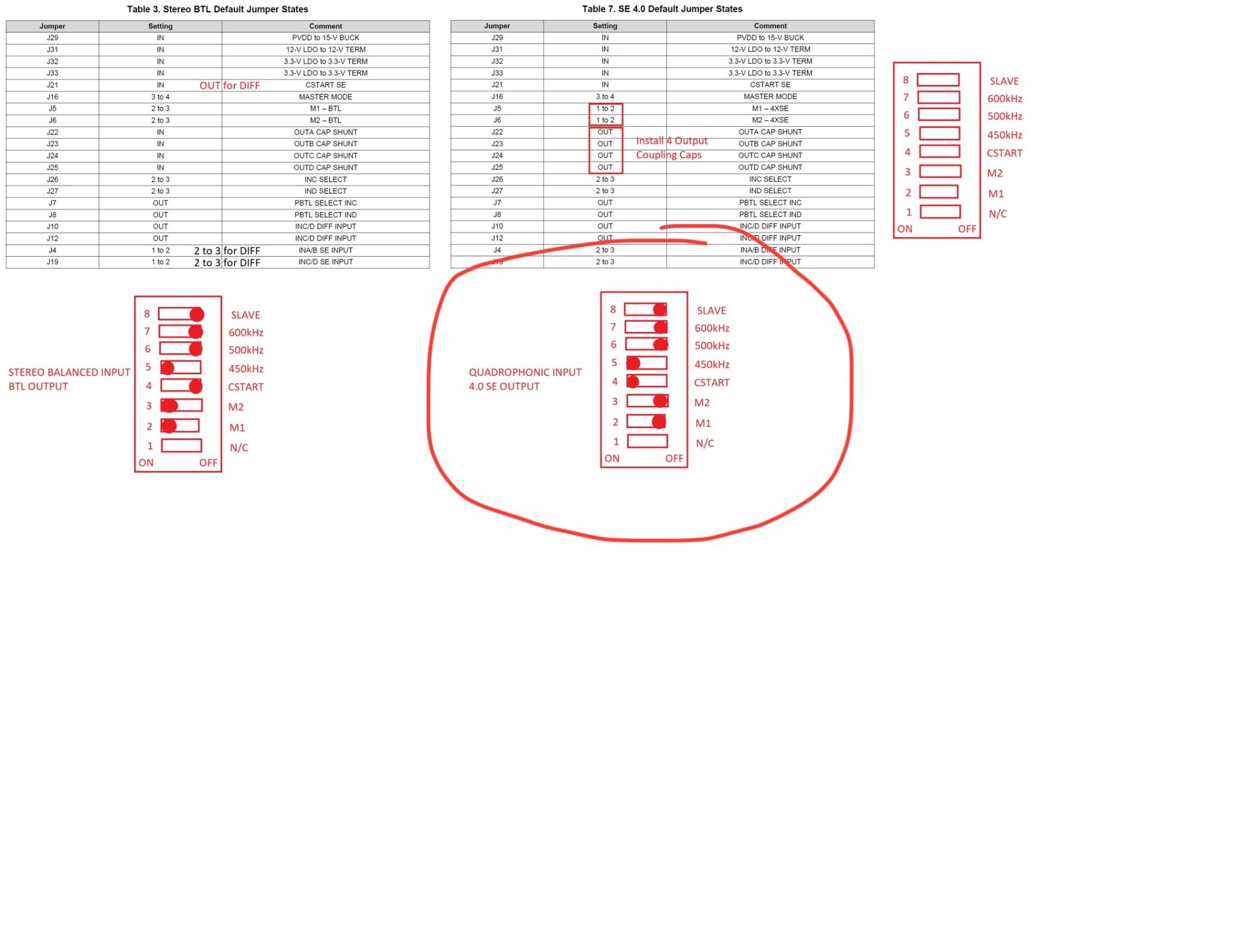

For quadriphonic (4 ch SE out) you want the dip switches set like this:
This should work now if all your ancillary voltages are present.
Thanks a lot, I missed out on that. R261-R264 are 3.3ohm, and c261-c264 are 10nF, right? I put 63v foil capacitors instead of the ceramic ones.

Could I work around this by altering R105, R107, R115, R117 to 2k (for ~14db)? I would like to feed the amp directly from a DSP with an output of 2.8v-pp/1vrms.With PFFB enabled you have 15dB gain only and amp maxes out at 75W into 8ohms
With 2.83vpp or 1Vrms and 14 dB (5.0x) gain you have 5.0Vrms max output. Power is V^2/R or 25/8 or 3.13Wrms into 8ohms? Is that Ok for you? I don't think so since this is a 75W to 150W capable amp.
I have not checked what you mean to do by changing R115/117/105/107 but assume you are asking to change feedback values on input opamp? You will be deviating from Texas Instruments PFFB recommended network values, so the amp, may or may not work proerply with stability and correct behavior. But this is DIY, so yuo can always try.
Thanks, I read in this PFFB document of TI the gain of the chip itself should be 15.93. As far as I know the opamp pre stage has no influence on the PFFB and thus can be adjusted (a bit). But I'd love to see someone confirm this as I cannot measure the results accurately. I'll give it a try.

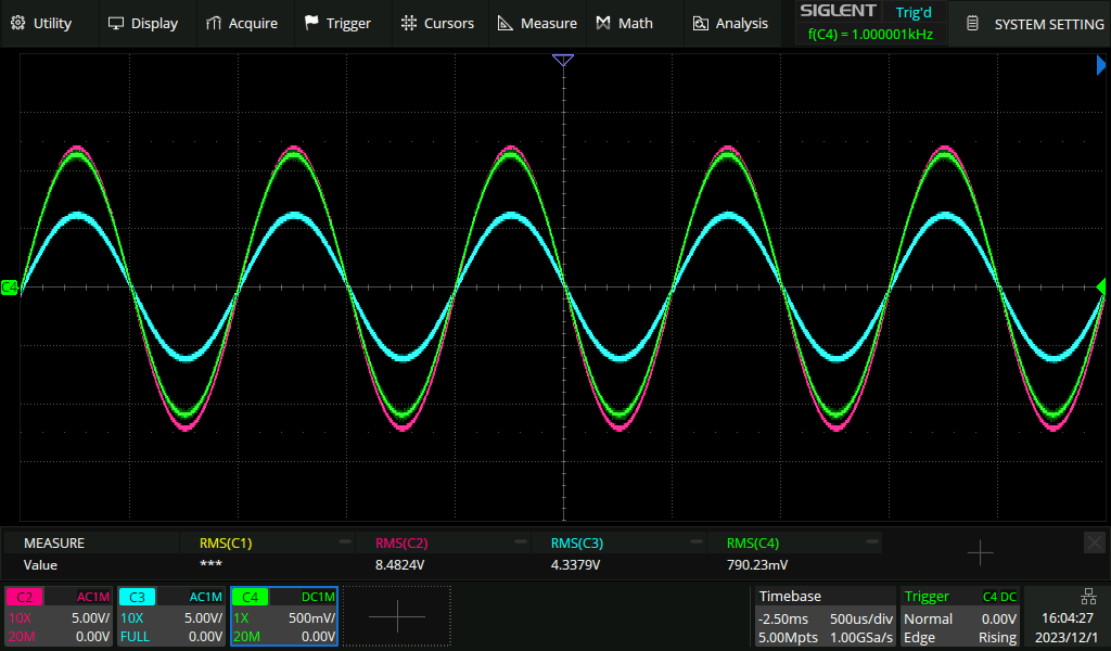

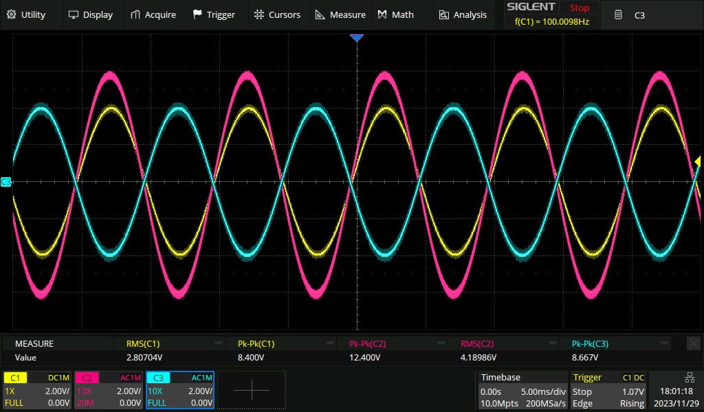

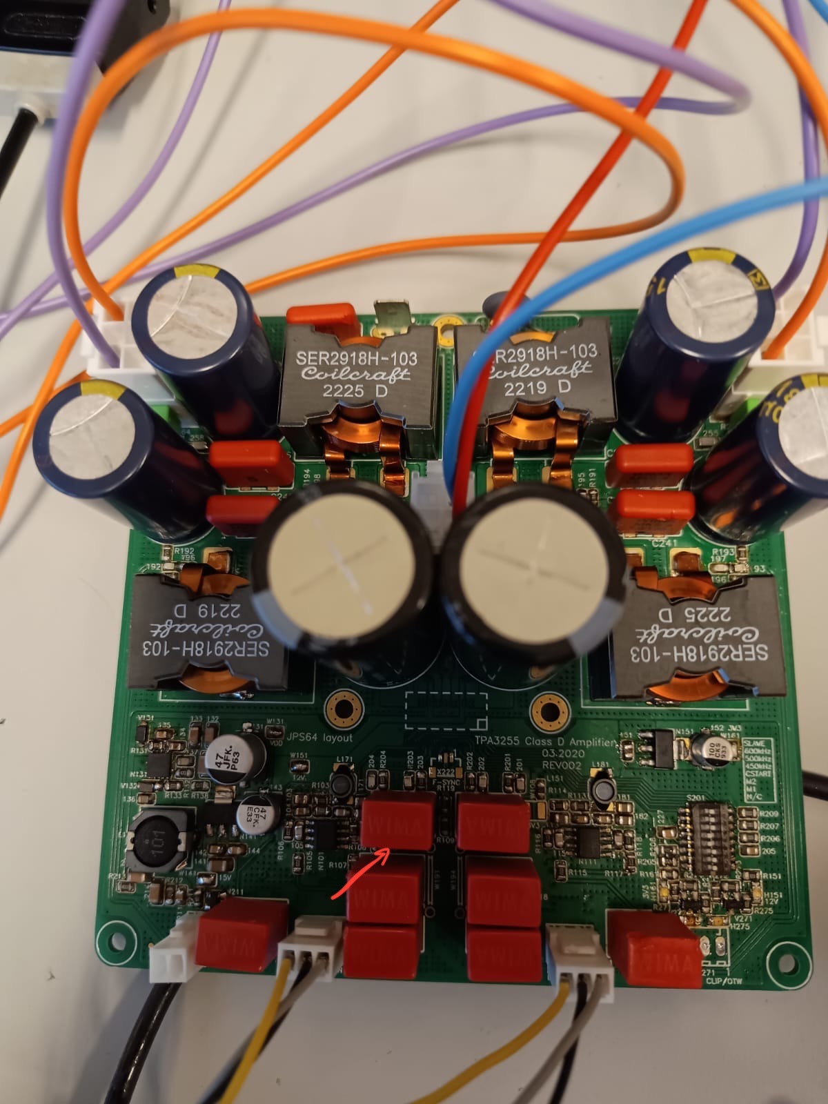

I did not alter the board yet, but I don't really get why the amplification is only 1.6dB. Blue is measured at the output of NE5532, red is measured at SE output A, yellow is input.
The intrinsic gain of TPA3255 is 22dB without PFFB. Rin is 2.7k and Rfb=33k. If you follow the math, this makes the overall gain about 15dB.
Your Oscope shows 12.4v out and 8.4v in.
This is 20x@log(12.4/8.4)=3.4dB. Far from 15dB. I suspect you may have a solder bridge or missing some input or feedback resistors. I see some solder balls/blobs near R193 that could be shorting out. Please check board for shorts or other solder joint anomalies.
Did you assemble the board herself or buy it pre-assembled from me? This looks like your own self-assembled board because mine use Silmic II caps instead of red Wima box caps. Plus, you are missing the 2.7k resistors for all the 4 feedback resistors A/B/C/D.
Without those, the amp will not have 15dB gain per the PFFB document.
Use high quality metal thin film 0805 2.7k ohm resistors here.
I believe here is something happening.Use high quality metal thin film 0805 2.7k ohm resistors here.
I think the first is a typo. It should be 2.7kohm. Sorry about that. If you used 3.7k instead of 2.7k, the overall gain would be about 1dB less.
I changed A B C D to 2.7, checked R191 R192 R193 R194 and they are already 33k. Vin = 2.8v rms, Vout = 5.5v rms.
Oops installed 100K instead of 100R at 201-202-203-204. Such an amateur.
I was going to ask you to double check those values next. 100k there would give you a gain of about 1.3x according to equations if you add 100k to 2.7k. But seems in practice gain is closer to 2x.

I still have a problem, I checked all resister values in the path, but I get a difference in gain, that is not frequency dependent.
Channel B and C are 10dB,
Channel A and D are ~7.3dB.
The voltage drops after resistor A and after resistor D (~50%), but not after resistor B and C (only ~5%) so that would imply something is drawing current, but I cannot find out what.
Green is input, blue is channel B, red channel A.
Red channel C, blue channel D. (1khz)
