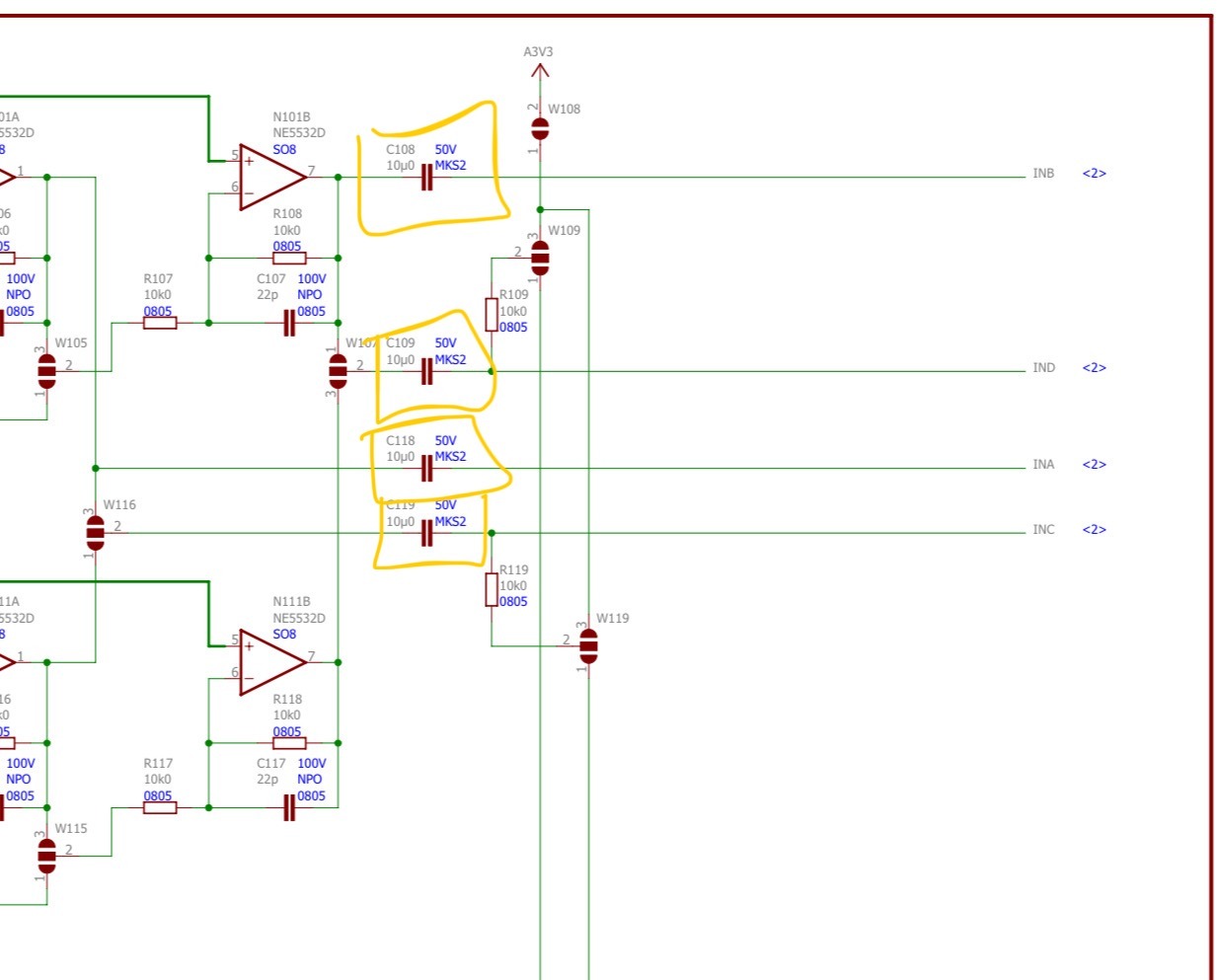

Sorry if I'm bothering you, but I just would like to better understand ways to connect the input signal to the TPA3255.Hi Folks,
I am re-releasing the non-PFFB version of this amp (Rev001) as a bare PCB. Note that the commercial Warp-1 amp does not employ PFFB either. The sound of no-PFFB amp is superb and distortion is already low enough that I don’t really think it sounds better with PFFB. The DCDC buck converter that was out of stock for a long time is now back in stock, so that makes building this version much more attractive. There are some tricks that this PCB has compared to other TPA3255 implementations out there that still won’t sound as nice. Thick 2oz copper double stitched ultra-low impedance current paths where it matters, unique extra filtering on outputs, a layout that emphasizes low ground loop area, low impedance, and great symmetry.
For example, the version without PFFB that you will re-release, configured in stereo BTL mode, could not eliminate the buffer circuit (opamps + resistors + capacitor), allowing the balanced signal from the previous source to be connected directly to the TPA3255 through of the 10uF input capacitors, eliminating as many components as possible in the signal path??
Do you also sell the assembled boards? In this case, how much should cost a fully assembled non-PFFB board?
Thank you for your kindness to this newbie!
Nilton
Hi SoundBrazil,
I have not tested this but suspect one can do this by not populating any of the opamp circuits and associated components upstream of the 10uF coupling caps. Connect jumper wires from the input A/B/C/D Molex 3 pin connectors at the front to the upstream connection point of the 10uF caps. You could eliminate the caps if you can ensure that your own balanced drive circuit does not have any residual DC. Although that is not recommended.
So don’t populate any component upstream of the yellow boxes. It will be up to you to properly drive the balanced signals to achieve a BTL stereo input or mono parallel BTL input or SE quad input and select appropriate DIP switch settings to achieve this.

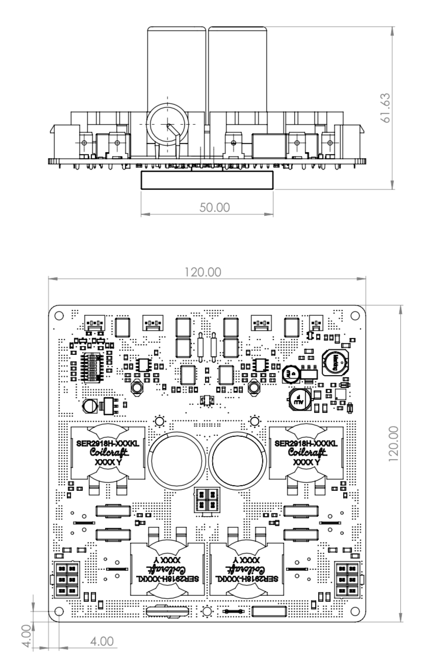

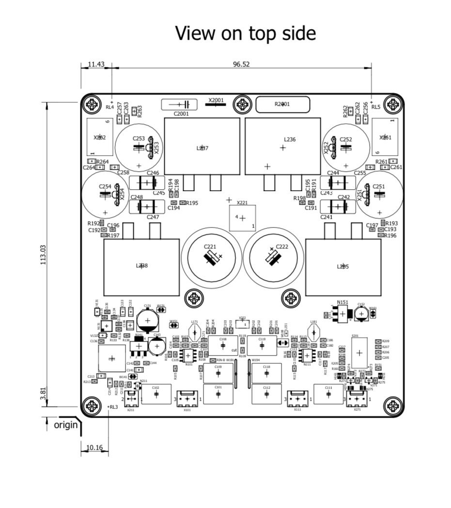

What will be the physical dimensions of the finished board? I'll need to machine a dedicated alloy spreader plate.
I have the machined heatsink spreader in my shop. Then all you need to do is drill the 4 holes for the stand-off.

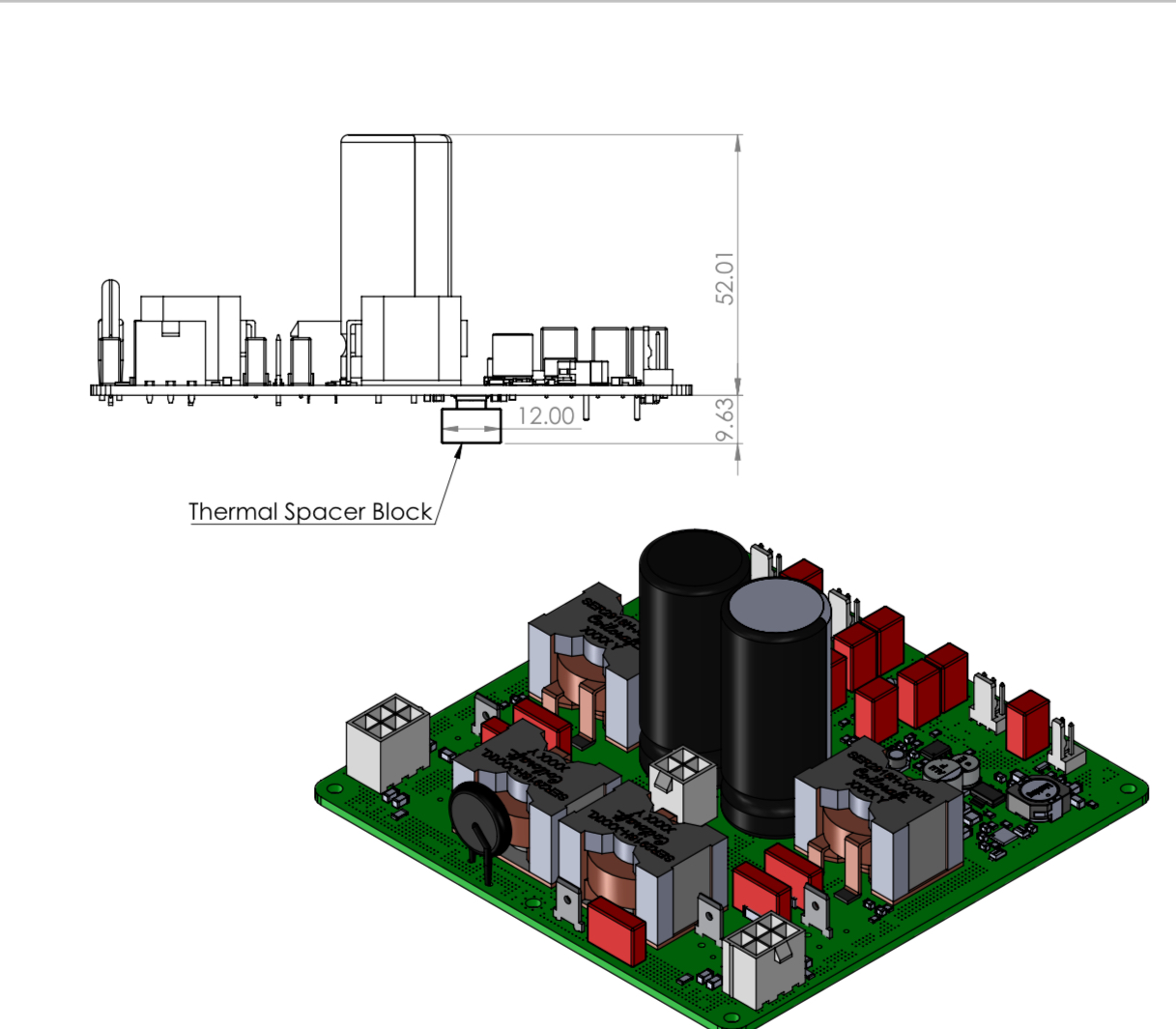

Boards are 120mm x 120mm. Corner M3 screw holes are 113mm x113mm spacing. Use 10mm brass M3 standoffs. To get the correct stickup height for the thermal block with silicone insulator sheet.
Thanks for those dimensions. So your 4 mounting screw bosses are electrically isolated from all circuits on the board itself?
Yes. There is a 5th boss near GND Faston that is electrically conductive. That is optional. It is better practice to use a real ground wire to the Faston tab vs relying on contact for the boss. Note that the thermal spacer block is electrically contacted to the “power pad” thermal pad of the chip and this will be connected to local PCB analog ground. But should not contact chassis dirty ground. Hence, use a thermally conductive but electrically insulated spacer like silicone sheet.
