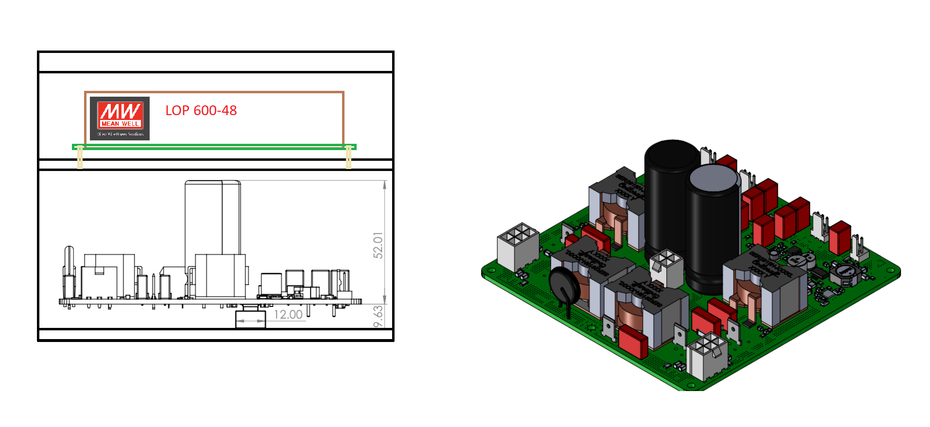

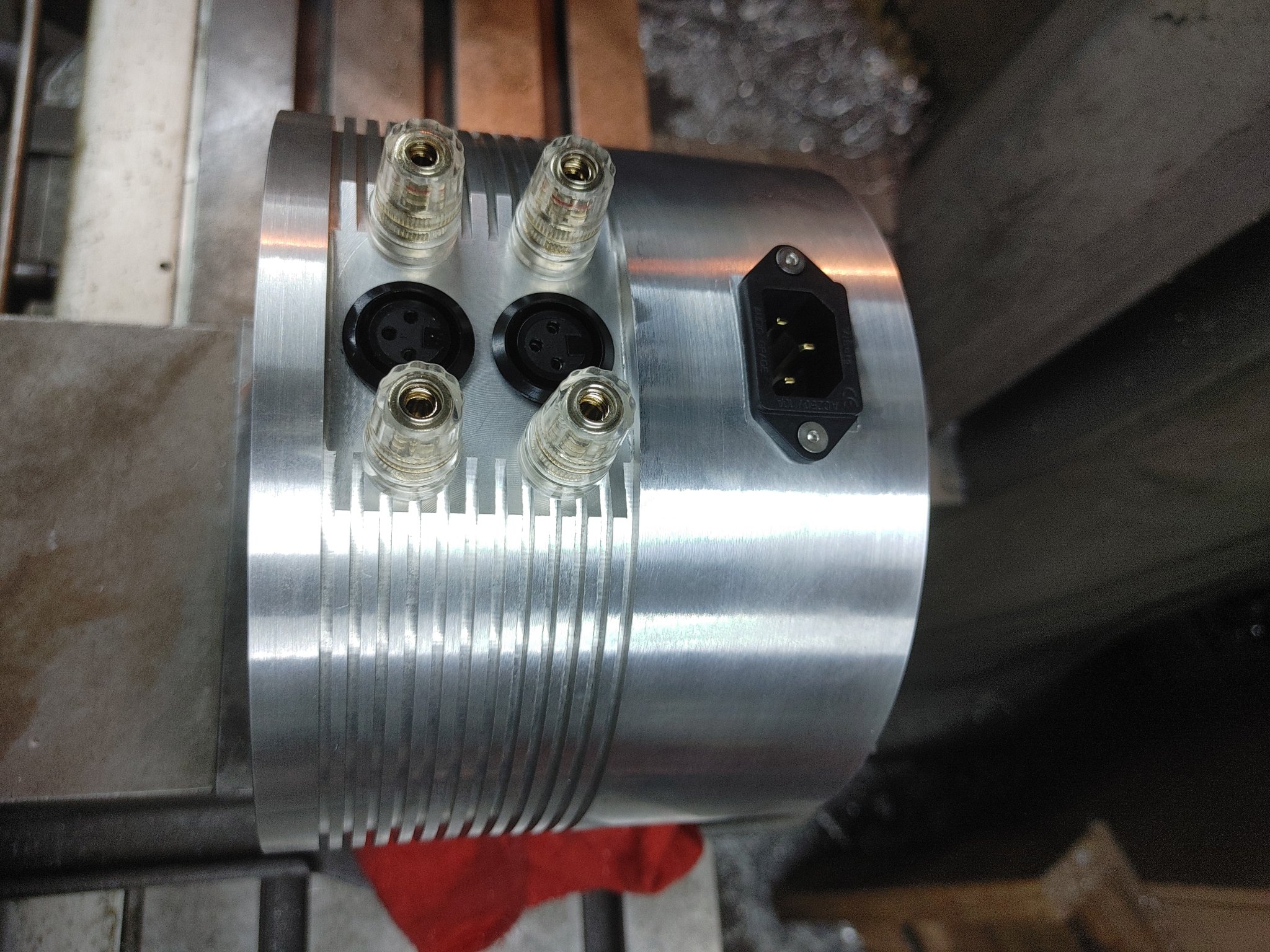

I'll have to go with the Meanwell PS, as the Micro Audio PS will not physically fit. I've thoroughly tested it on 3E's board and it sounds wonderful. I'll clearance the inner alloy plate for cooling ducts.

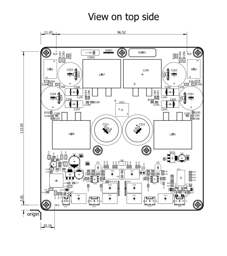

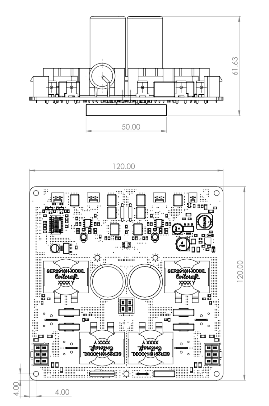

Sorry if I missed the info, but what do RL3,4, and 5 represent on the bottom diagram?I have the machined heatsink spreader in my shop. Then all you need to do is drill the 4 holes for the stand-off.

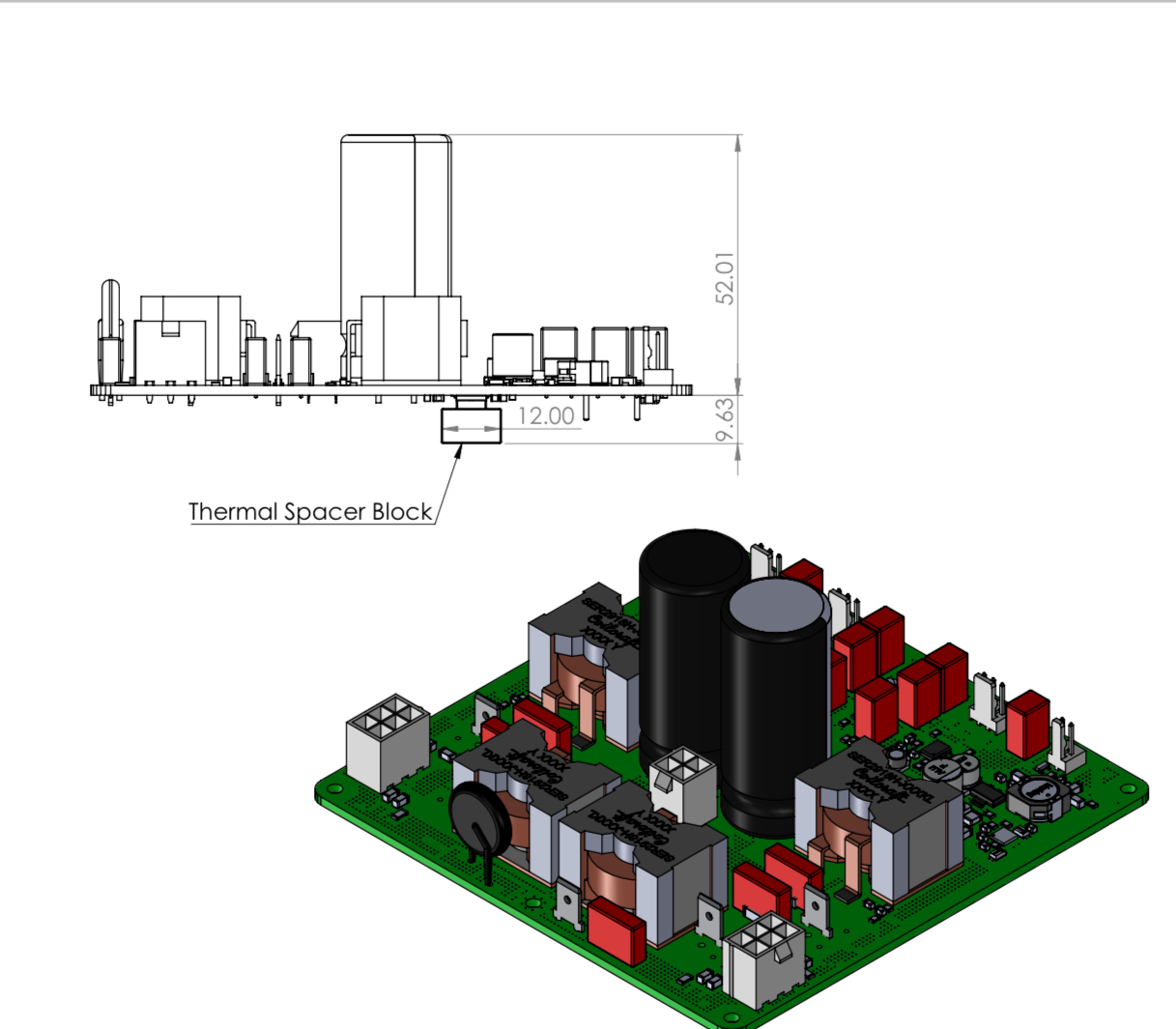

Boards are 120mm x 120mm. Corner M3 screw holes are 113mm x113mm spacing. Use 10mm brass M3 standoffs. To get the correct stickup height for the thermal block with silicone insulator sheet.

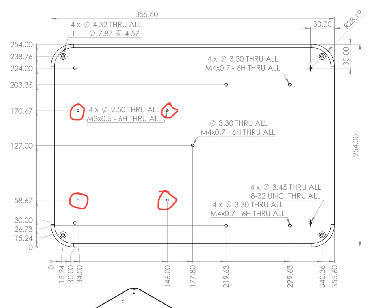

I'll be doing base plate programming and machining today. Dont want to miss anything.

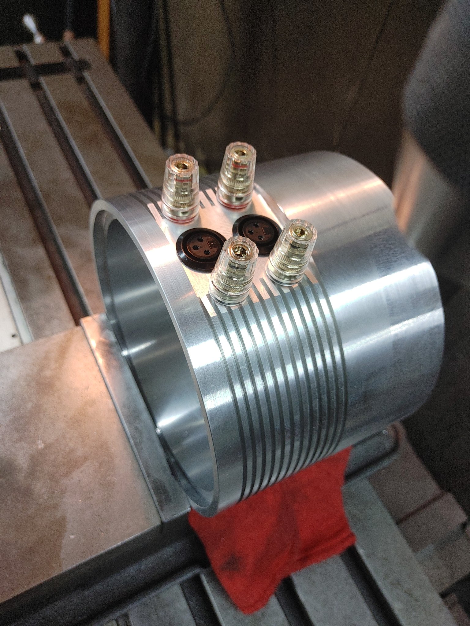

Got my IEC socket and power button in also and will machine case to make that scenario meld.

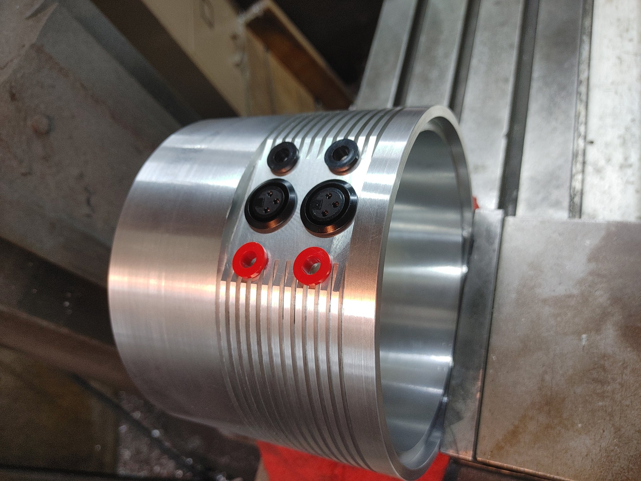

Had to re-drill the thru holes for bigger insulated binding posts inserts on this case...
You didn’t miss anything - I am not quite sure what RLx stands for either. That was from the PCB layout software. I think it might be distance from edge of metal traces. I’ll ask. But if all you need is distance for the screw holes. They are positively 112.0mm x 120.0mm CTC corners on a square. Thread for M3 brass standoffs.Sorry if I missed the info, but what do RL3,4, and 5 represent on the bottom diagram?

Here is a drawing from a production amplifier baseplate so I know that the 112mm is correct. The board itself is 120mm square with rounded corners.
10-4. Had to be sure as the base plate will accommodate either your PCB or 3E's. Finalizing this design with the smps mounted in seperate upper chamber as well..

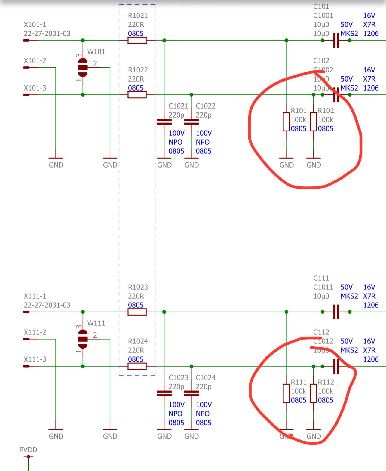

The input goes to a 100k resistor load to ground. This is for each input A, B, C, and D. You can change this value to 47k etc if you want.
