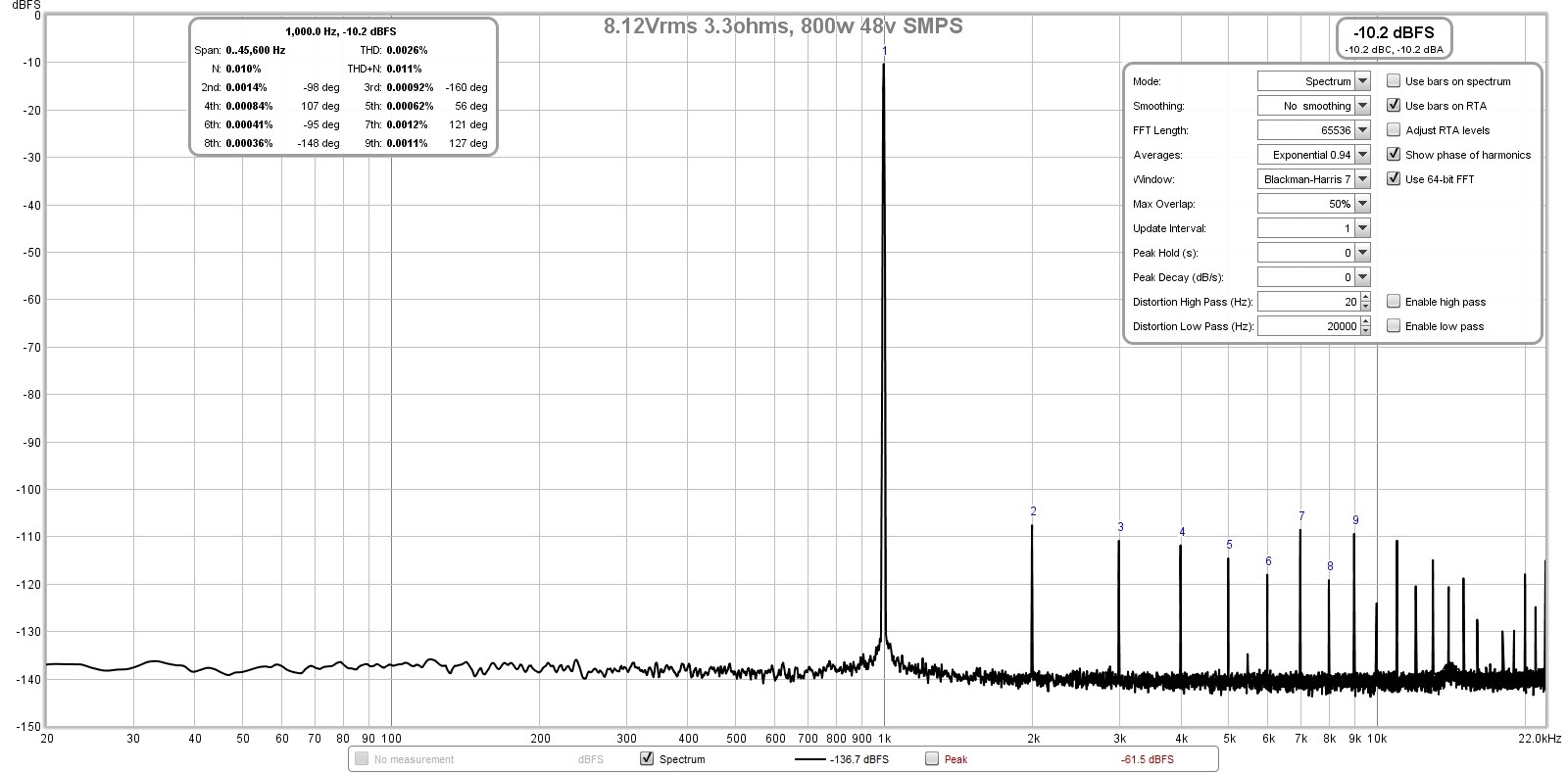

Here is an FFT from my amp powered by a low cost Chinese LED lighting SMPS set to 48v and the amp is putting out 20w into 3.3ohm load. Note the absence of any mains hum at 60Hz/120Hz/180Hz. The noise floor is about 1uV rms. Inaudible with no music playing and ear pressed to the speaker cone.
I have not been able to achieve this low of a noise floor with a linear supply, even with a shunt regulator or cap multiplier. If we think about it, it’s very hard to quash a 0dB 120vac signal at 60Hz by -120dB with any filtering.

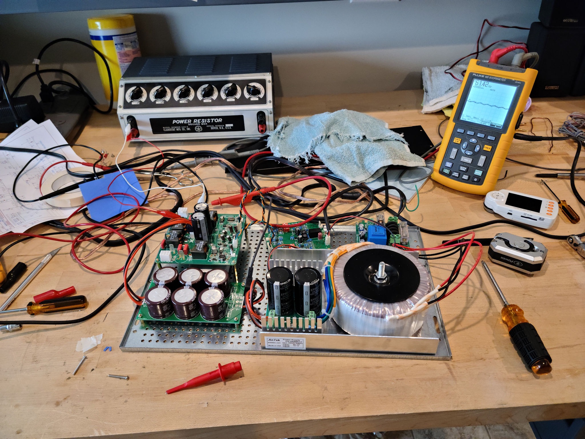

After buying a TPA3255 board back on January 2020... then getting unexpectedly laid off, selling my house and moving I am FINALLY building my amp. I did my first attempted power up today and all is working well with the exception of OUTB. It just sits at +20 V (Vcc = 45 V) no matter what the input does. I'm driving it with a BTSB board driven by a function generator on the unbalanced input, and I have checked that the input signal is getting onto INB. I swapped the input cables, both work fine on OUTC and OUTD, and OUTA works with both of them, but OUTB is always a straight DC. Anybody got any insights? Thanks in advance.
Hi Tommost,
Sorry for your job and stuff. You issues are odd - I have not heard of this behavior ever with all the amps out there over 170 amps in the wild thus far so that’s a strange one. So you are driving with balanced output from BTSB and A, C, D show responsive outputs but B just sits at 20v?
Check the output pin of 5532 opamp driving Ch B to see if it is output correct waveform.
Lack of output on a single channel of the TPA3255 is a new one. I can only think that maybe there is a bad solder joint, a bad or broken leg on the 10uF Silmic coupling caps, or a bad bootstrap cap, or worst case, a bad TPA3255 chip. Those usually fail all channels and not just 1.
If you don’t have luck debugging it, contact me via Etsy messaging on my shop or a PM and I’ll see if we can work out a repair for you.
Thanks,
X
Thanks,
X
I hung it up for the night, time to watch Formula 1 qualifying. I'll check tomorrow.Hi Tommost,
Thanks,
X
Well I took the heat sink off, probed the traces for continuity and carefully examined all the traces and joints, both channels looked fine. So I powered the amp with no heat sink with the supply turned down to 25 V and 100 ohm load to keep the thermals manageable. I traced the signal through the op amps, all four channels were fine. So I looked at the speaker outputs and all four were working! Hmmm.... I wonder what could be going on here. So I put the heat sink back on and it still works.I hung it up for the night, time to watch Formula 1 qualifying. I'll check tomorrow.
So this bothers me a bit but I guess could have just done something dumb. Oh well time to start assembling the chassis and laying out the front and back panels.
