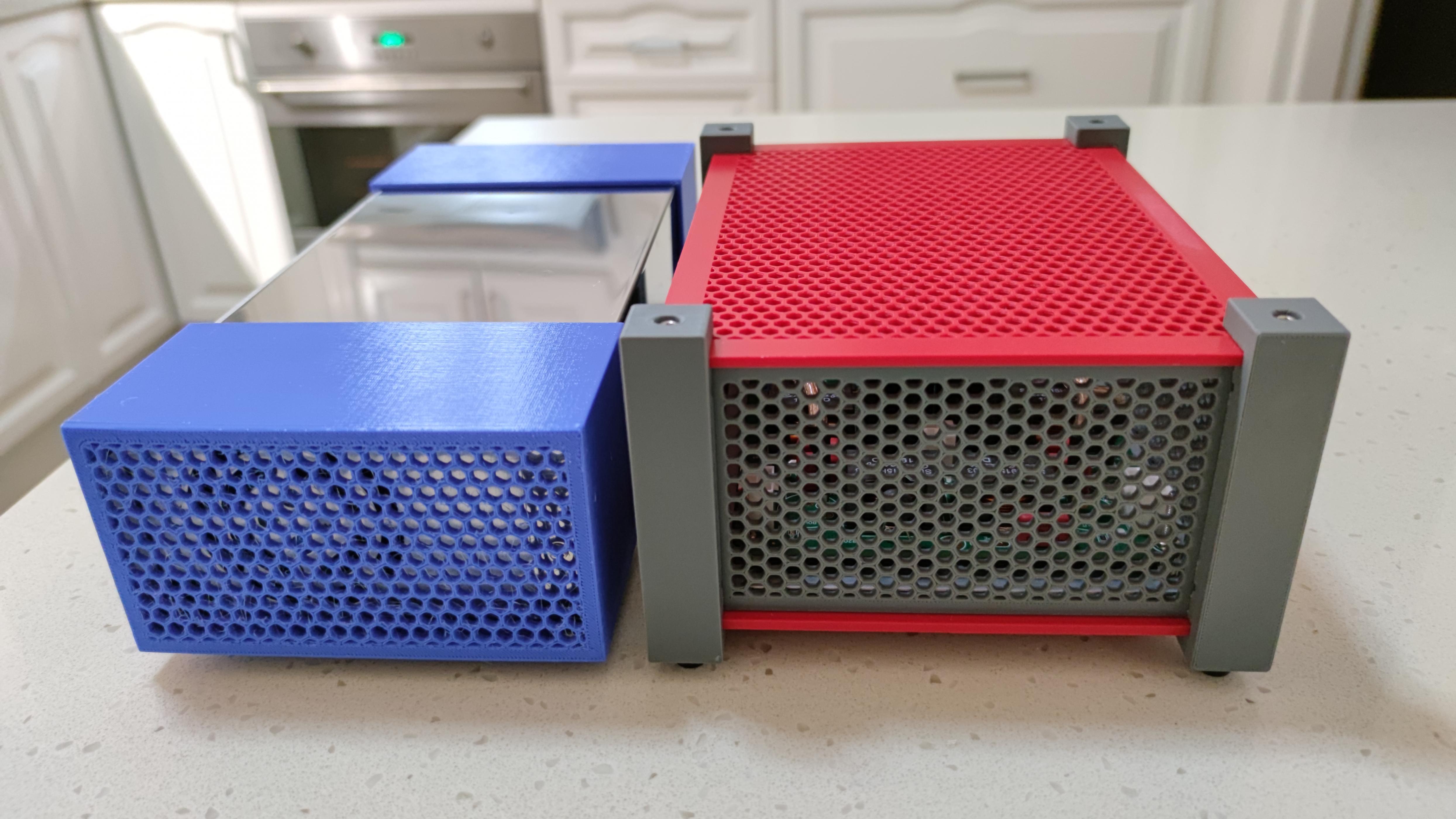

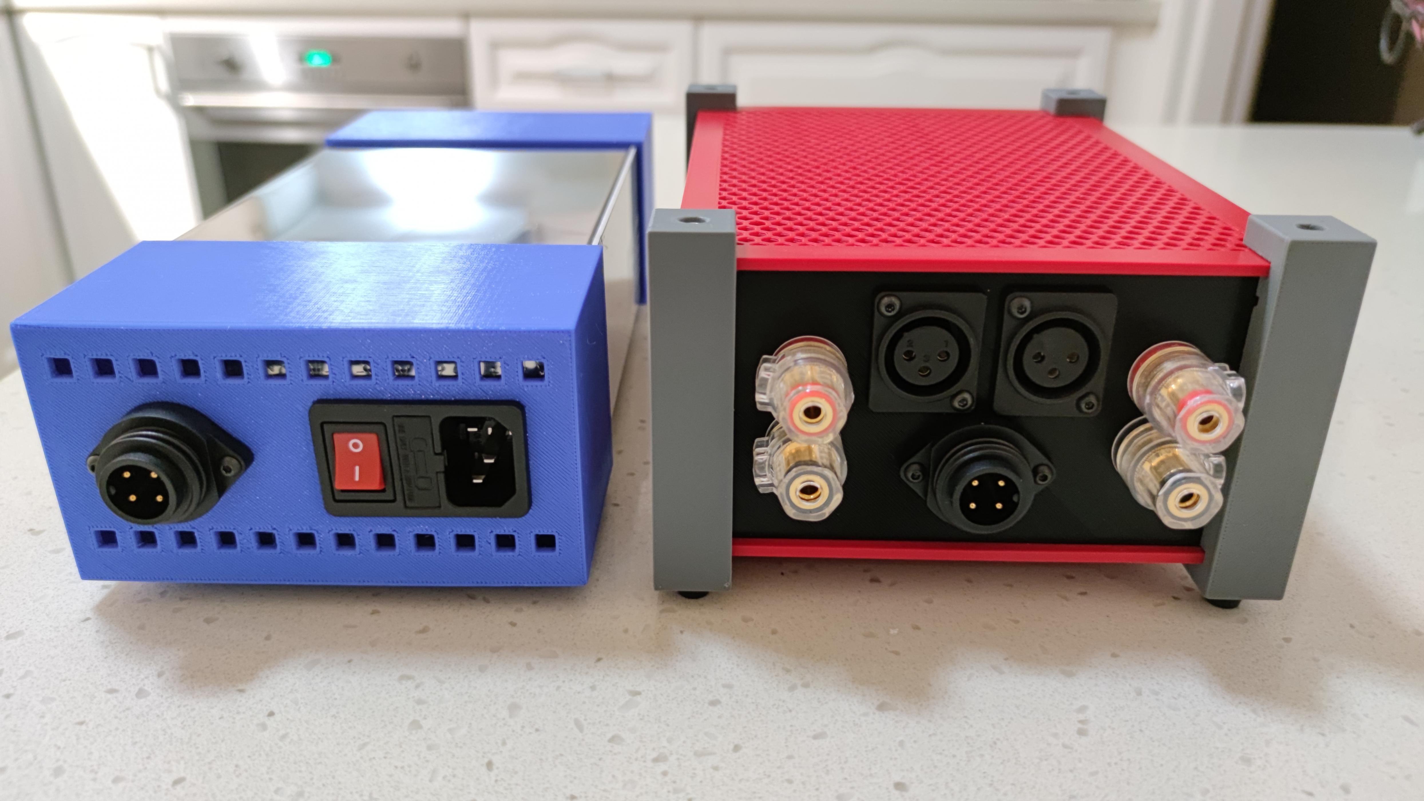

Hi Wineds,
That looks super cool! Nice job!
What type of 4 pin connector is that?

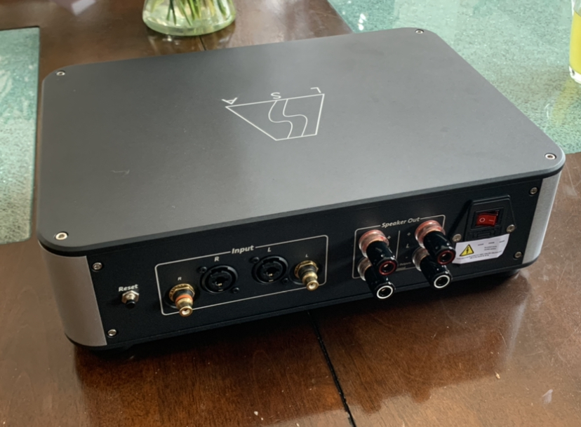

Btw, I laid have a chassis for my TPA3255!

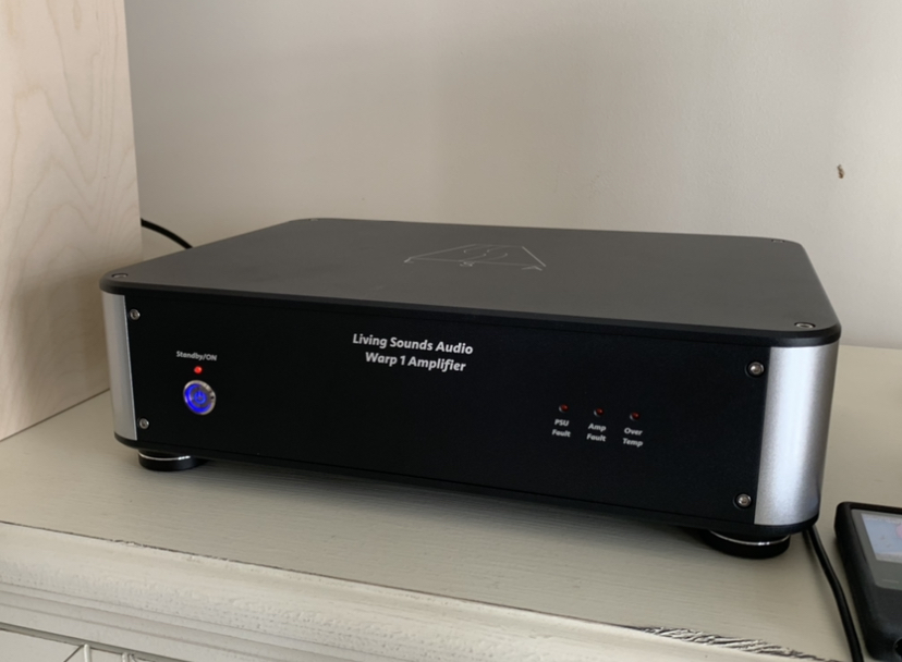

The Warp-1 amp from LSA that utilizes this amp as the OEM core is also finally here:

Beautiful case X! Here is the connector :
https://au.element14.com/webapp/wcs...HllK/qB4JgpcsqTwZWnz4b6TyaDd+mhTH0hDqWON1VA==
Thanks, guys. The Warp-1 sounds unbelievable - playing Dark Side of the Moon from a TT with a premium Sumiko Blackbird MC cartridge, and new prototype LSA Phono-01 preamp, through a prototype LSA SET tube buffer preamp with volume control, which then drives the Warp-1 and playing on my 10F/RS225 TL speakers. This is one of the best renditions of "Money" I have ever heard. A couple of audio friends came by to listen to it and they both agree that it was a "goosebumps mind blowing" type of listening experience.
@Wineds: ok, cool - Amphenol PWF glass filled nylon series (12A) capable. I am used to seeing this is olive drab finished aluminum for aerospace connectors.

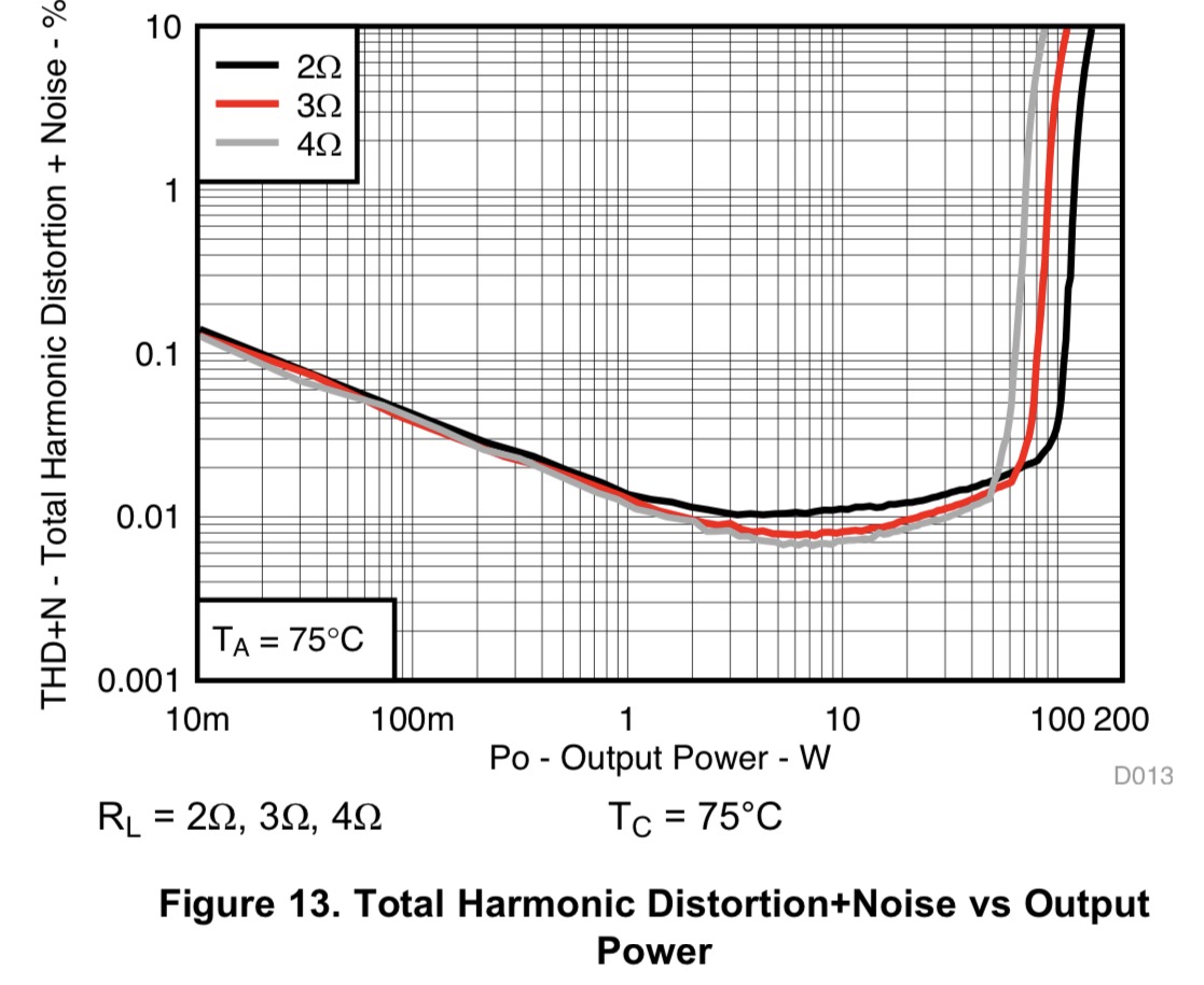

In single ended mode, where I use four separate channels, what is the max clean power output I can get with 48V supply? (I'm looking for 0.01% or lower THD.)
You can find all that in datasheet for non PFFB performance. Good rule of thumb is to take rail voltage and double it for BTL mode. But for SE mode, there is no doubling. Then subtract about 4v for mosfet dropout before clip. So 44vpp is the max swing. Divide that by 2.83 for max rms voltage. Square that and divide by load (8ohms I assume). This gives about 30w clean output. By clean, I mean well below 0.01% distortion.
Here is datasheet plot of distortion vs power for 51v rail in SE mode at 4ohms (grey line). There is no PFFB here so expect added 6dB improvement with PFFB and of 8ohms, curve will be below the 4ohm.
You can see grey is about 0.01% at 30w. With PFFB probably will be ~0.007% at 48v for 30w into 8ohms.
