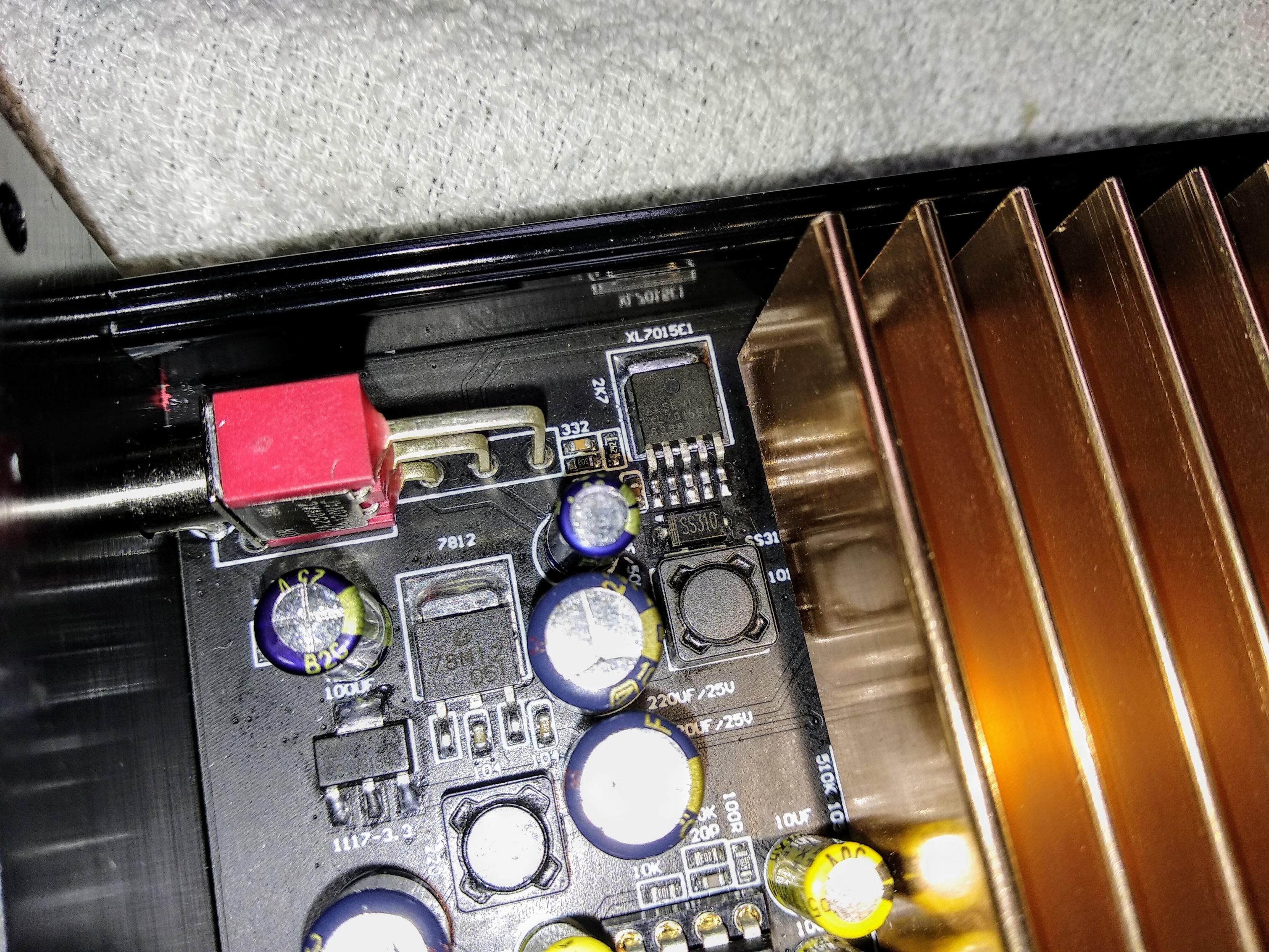

Just some updates for this tpa3255
Main capacitor is nichicon 1000uf 50v 105 celcius
Regulator is XL7015 ( max 80v)
The inductor have no marking but board have 101 labeled
Opamp is NE5532P
Hope you guys find it helpful

An "101" inductor means 100uH. The smps chip is XL7015 operating at 150Khz. These two components are used for the same purpose as in the Zero-Zone board but with (52/150)x(10/100) = one thirties of the ripple current designed for in the Zero-Zone board. Seems reasonable.

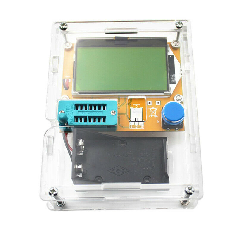

The truth is only 10$ away, for such little money you can buy a universal electronic parts tester, that will give a good idea about the real values of caps and other parts. Even if the results are no way "lab precise", you can fairly good compare parts.
I tested all kind of caps and found even used ones dating from 1984 better than, for example, "Elna for Audio".
So, don´t worry to much, a decent 50V capacitor will stand 49.9 volt for a very long time. Some will always fail, just as any man made part. Better a cap than a 737.
