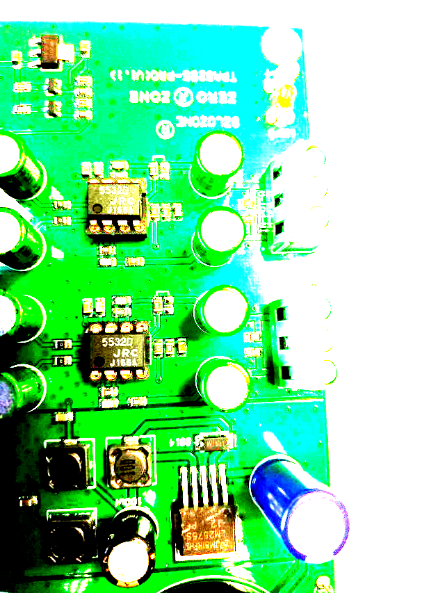

Note: This 28V are DC not AC, may not be enough for 3255 board.
Your board need AC power, or you must skip input bridge.
The input bridge can stay even if you use DC at the input.
I managed to manipulate one of the photos Dani posted when he received the board. It shows it is an LM2575S chip, thus for an absolute maximum of 40V at the input.
NB: You can use this photo in front of the seller and demand a new board or money returned.
Dani, it is not that we say the 28Vac is wrong to use with the board. We have before seen TPA3255 boards specified for up to 50Vdc supply while the board uses a voltage regulator that can as absolute maximum handle 40V. Your voltage chip is seriously burned and it is only to find out what to replace it with.

A likely scenario: An engineer designed the amplifier circuit you have and specified the use of an LM2575HV (60V rating). The company produces for a start such boards with the correct components. After some time, the engineer is busy elsewhere or has left the company.
The company purchasing staff can get LM2575S (40V rating) at a much better price and they are not really aware of the difference. It seems to work. The company produces batches with LM2575S instead and you buy one of these boards. Your amplifier is running with a supply voltage around 40Vdc (27Vac) which is the ABSOLUTE LIMIT for LM2575S. No voltage margin as should be used. One day your LM2575S gives in and burns.
Not at all your fault because you could only rely on their recommendation of 28Vac. The company committed a severe production flaw and must either return your money or give you a new board for free.
Many of us have one of the cheapest TPA3255 boards sold. It was exactly the same mistake with the LM2575. As I recall, it was Chris who realized the mistake on that board. Your board is rather rare and no member knew that the same mistake was repeated here.

Another LM2575S component is no good solution. When the LM2575S is replaced, you can still not use your 27Vac transformer.
It is EITHER money back OR another new board.
When we know his choice, we can discuss how to see if the LM2575S can be replaced with an LM2575HV. The replacement itself is not difficult but the moment the LM2575S burned, it may have made damage on other components. That we do not know yet.

I agree... so the only way to know it is to test. I have now nothing to lose.
I tried to check the board... other components seem to be OK.

Please concentrate on blocking the PayPal payment. Did you buy the Zero Zone TPA3255 amplifier board on Ebay? If I'm right in my calculations, there may be another reason for the LM2575 Buck converter not to function. Worse than the LM2575S voltage rating issue. I will just check my calculations with the power supply guys first.
