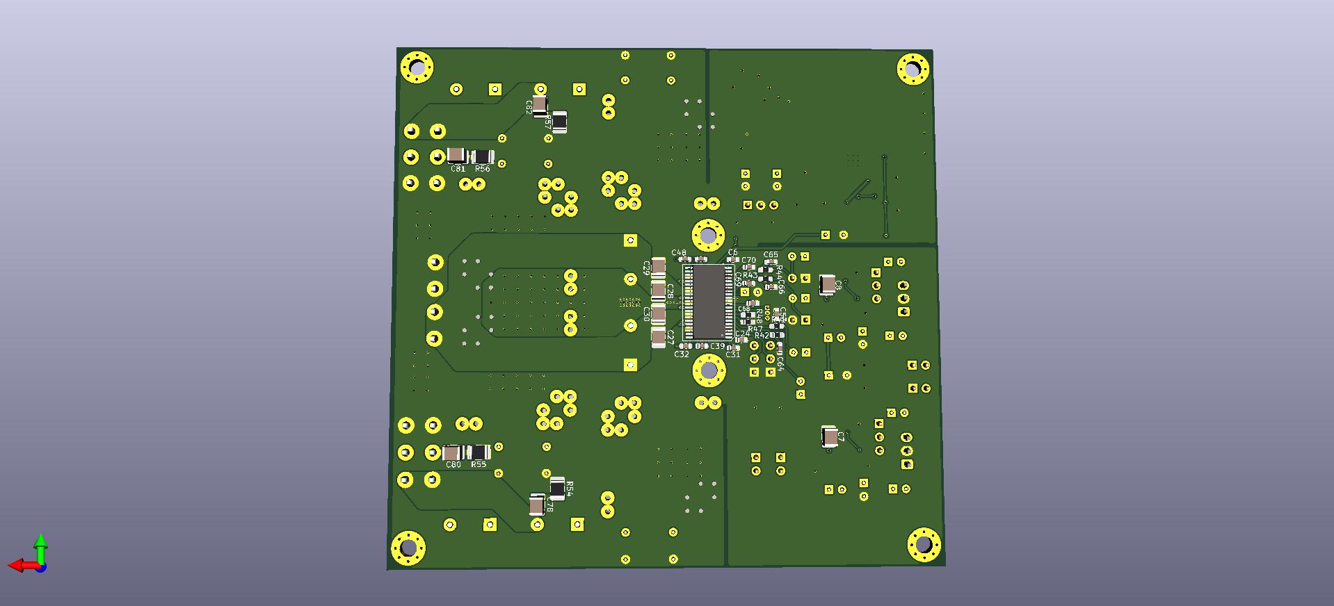

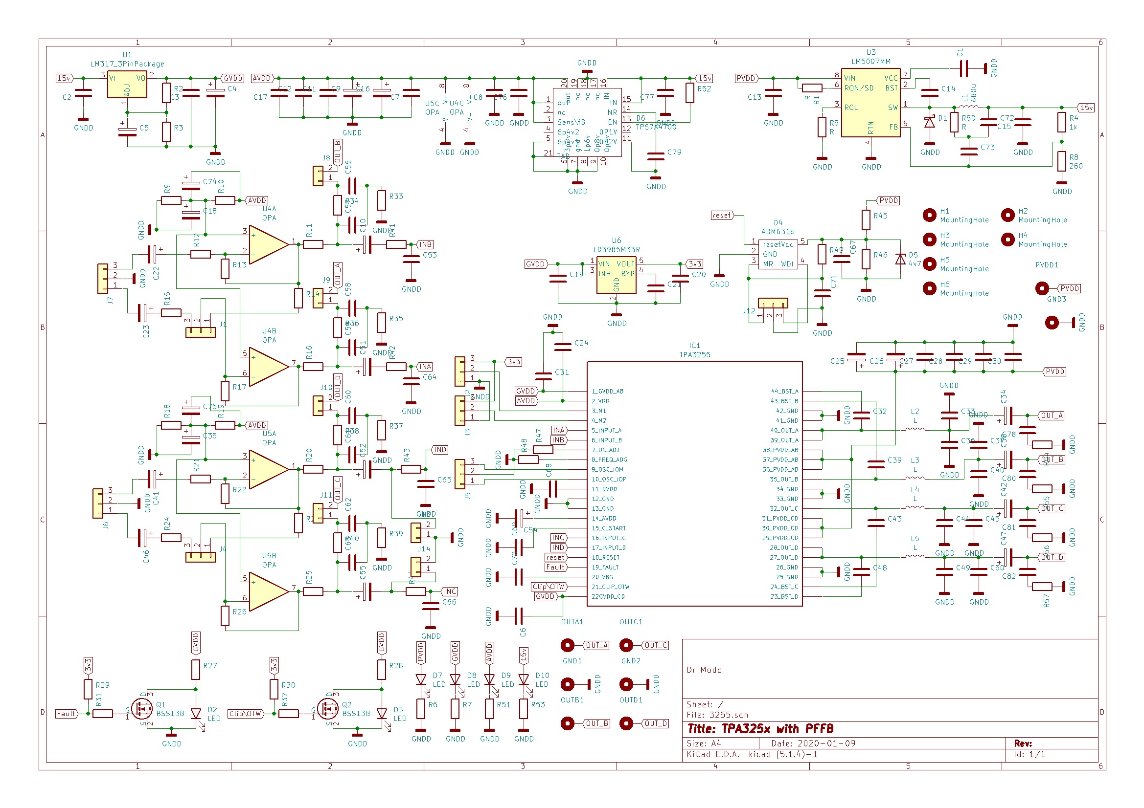

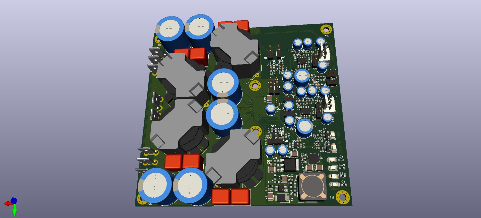

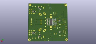

My design
I see you have the chip on the bottom side too. There is already a Dr Mord, did you intend your screen name to be so close to his or this purely accident that two people who are into Class D and TPA3255 have almost the same name? 🙂
