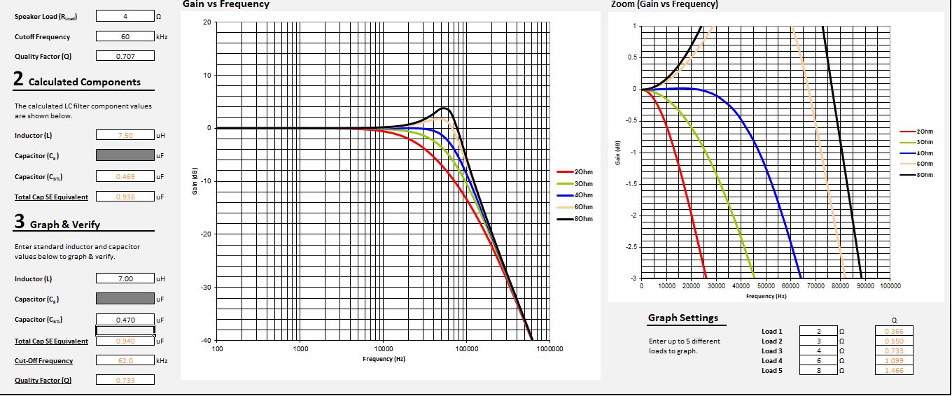

Hello, I progress on my TAS3251 design. As it belongs to the same familly as the TAS3255, and this thread is the most active on the topic, I would be happy to post my questions here when possibly applicable to the TPA3255. If you see some inconvenience, please let me know.
I have to finalize the LC output stage: values and parts. I have read the SLAA701A, and played with the TI provided excel sheet for calculations.
Bottom line, my idea is to keep the TAS3251EVM values: 7 mH and 0.68 uF.
SLAA701A states:
For the TPA32xx family of devices, a 7-μH inductor is a better value for performance-oriented applications due to improved linearity and generally improved distortion performance over higher inductances.
The 0.68uF copes with 4R or 6R drivers.
The Woofer of my LX-mini is 8R, but is cut at 700 Hz. At 3kHz, it is -30 dB. So it won't be affected by the bump above 10kHz. A 4R full range ensures the upper part of the spectra. So it should be OK to go to with those values.
Do you believe that this is correct ? Any mistake in my reasoning ?

As of the parts. From the sale SLAA701A, the best coils qre Wurth 7443630700. They cost about 6€ each. For just lower quality, other candidates are the coilcraft
MA5173-AE of the EVM board. A bit more than 5.80€, so no big price difference.
Alternate candidate with still acceptable quality are the coilcraft UA8013-A, which are coupled coils => 2 coils in the same box. 5€ for the combined coils. Interesting for space and cost perspective.
My intention is to go with Wurth coils, except if someone compared them to coilcraft UA8013-A and did not noticed much difference.
For the Caps, I consider MKP capacitors, as in the EVM. Any better alternative to explore ?
In parallel of those caps, I will have CERM, 1000 pF, 50 V, ±5%, C0G/NP0 (designed in but not installed in the EVM board)

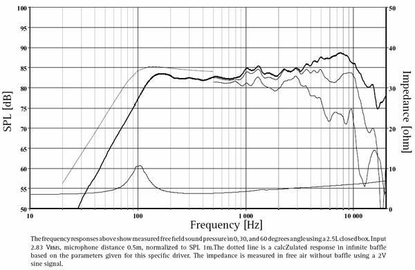

Although the nominal impedance of the full range driver is 4R, it's approaching 7R at 10kHz. I've always wondered if the LC filter should be based on the nominal impedance or the impedance at frequencies above 10KHz.
Mike
The important parameter is the resistance (rather than the impedance) as that's what's needed to provide damping. So I'd go for the latter one - the real part of the impedance >10kHz is going to have the most impact on the frequency response of the output filter.
It is not the real part of the impedance that increases with frequency but the imaginary part in series with this real, i.e. the inductive component. And this imaginary part disconnects the real part thus preventing damping at high frequnecies.
As a rule of thumb, with a real speaker you may consider the output LC-filter resonance undamped.
I believe most class d amps have a zobel circuit to flatten out the rising impedance of the speaker/driver, but I don't know how they come up with the component values. Your fr driver has a 3.3 ohm voice coil resistance and .29 mh voice coil inductance. Since you are probably using BTL, would the zobel calculation be based on half these values?
Looking at the different EVM and reference designs (TIDA) using the Akira familly, they all use 10 mH, and either 0.68uF or 1 uF. I believe that it is safe to go to those values, even if it doesn't cope with their technical paper on LC filters.

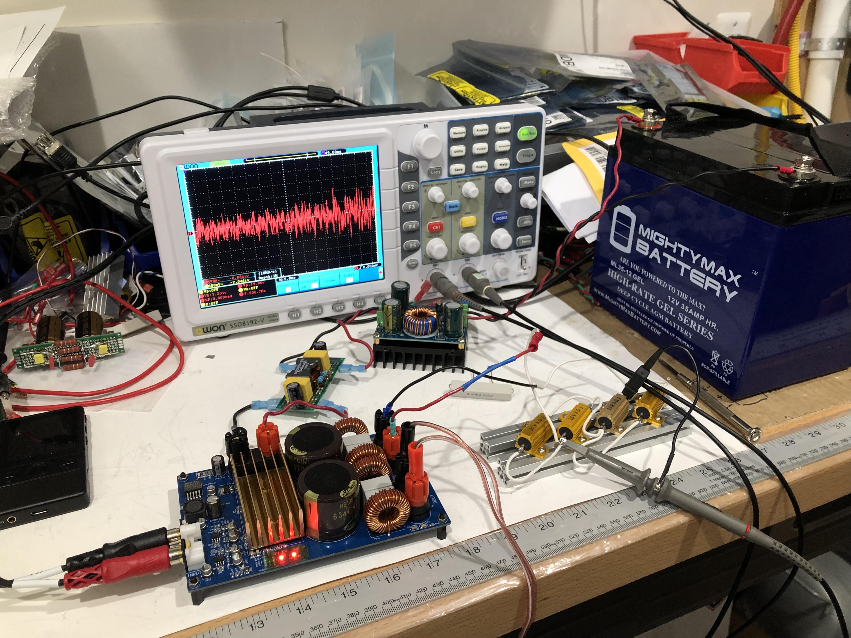

I have a question about the TPA3255’s auto protection and going to fault mode:
I’ve been testing a generic (“Nobsound”) TI reference design of the TPA3255 and noticed that it is very sensitive to input pops and clicks from source material. It will go into fault mode and require power cycle to reset. That’s a problem for me - is it simply the reference design or inherent in the TPA3255 chip itself? I realize it is there to protect speakers - but there has to be a better way to reset (maybe automatically?). The pops were small and came from my DAC switching tracks or changing but rate etc. not ideal but no other amp I have locks me out.
Testing it here with a 12v (13.8v nominal) lead acid gel cell powering a 600w DC-DC step up, followed by a high current CLC with flat wire CoilCraft.
