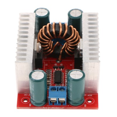

An update for my evm board and voltage booster disaster:
The shorted voltage booster, rated 400W 8A cont and 15A peak, max 60V, has a shorted IRFB3607 mosfet which is rated for 144W max...... 🙁 Expensive POS......
So what probably happened is that the mosfet died, stayed open, voltage rose till I got the spark to the heatsink which melted the 6 power pins.
Still the mosfet should not have died as max I have seen going into the board was a bit less then 1A @48V
Any input still welcome..

There’s nothing wrong about the FET ratings, power loss in switched applications is I^2*Rdson + switching losses, so even at 50A input + ripple current Pd is lower than 25W. (Which of course is way to much without über cooling.) To stay below 3W Pd, max current needs to be <=18A. Taking Rdson increase into account, assuming x2, so it is 18mR then, current must be smaller than 13A.
Their might be a thermal runaway situation due to collapsing magnetic flux in the inductor which then fried the FET with over current and overheating. Keep in mind that these current limits are meant for input side. Inductor ripple current increases dramatically when flux is reduced.

IRFB3607 Data sheet https://www.infineon.com/dgdl/irfs3607pbf.pdf?fileId=5546d462533600a401535636a42b2176
Sorry my fault; the data sheet says 140W max power dissipation, (not max power) so indeed that should not be the problem as the heat sinks made good contact and were not even warm to the touch.
Btw it is this booster 8.5-50V to 10-60V 400W DC DC Boost Converter Charger Module for Car/Notebook | eBay an I have a second one which I have not used yet.
Caps are 63V 220uF and seem to be fine. Diode is the one without a heat pad in between it and it's sink.
I can't stand that I don't understand what happened and I guess I have to take my electro skills to a higher level before I do.
Is there a chance that the arcing at the chip killed the mosfet on the voltage booster?

I suspect the converter failed due to thermal runaway problem. When these toroids heat up, they'll loose their magnetic quite instantly when pushed hard. Not only that, they also shift their "breakeven point" to lower currents to.
