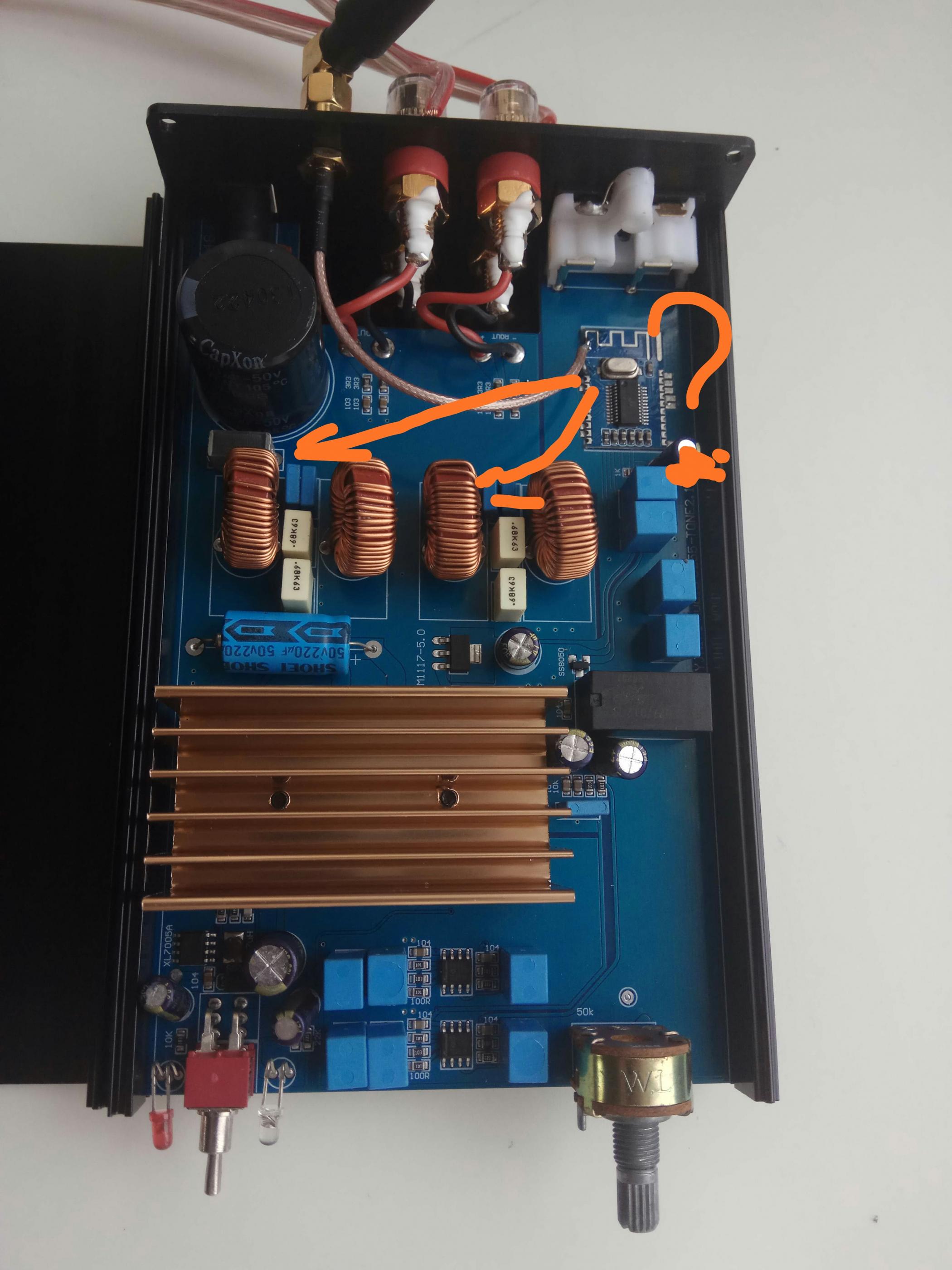

Chris, thanks for the hint. The only thing I have no idea which ones should be checked. Can you please point which ones, please? I made links on photo of the board. Are they ?

i re checked all tpa3255 2.0 amps on the net to get a pic from the buttom pcb...no chance...
so anatoliy please open the lower screws of hte back panel (where all connectors are) and move gently the back panel up. so you can slide the pcb out of the case. then its easy to make a pic of the buttom pcb.
i am not really sure how the signals goes.

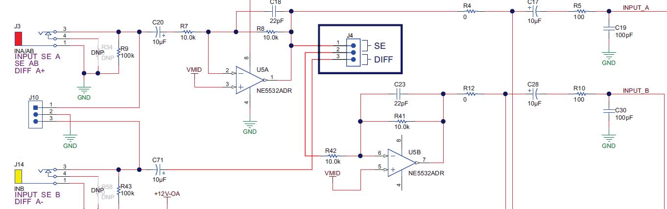

RCA- Bluetooth chip?- volume knop (50k potentiometer) and then?...-DC blocking cap (10µF) it should be to the opamp-its a dual opamp one gets the signal+the other gets the inverted signal = 2 opamps in 1 chip. this signal goes to the next DC blocking cap (10µF) to the TPA3255 chip--> pic 1
in this pic forget the connectors (j14,J4)and follow the signal. so the TPA3255 overall needs 4x 10µF caps- its recommended to push no DC into the power chip!!!
please read the TI manual and the TPA3255EVm its really goo to learn more..

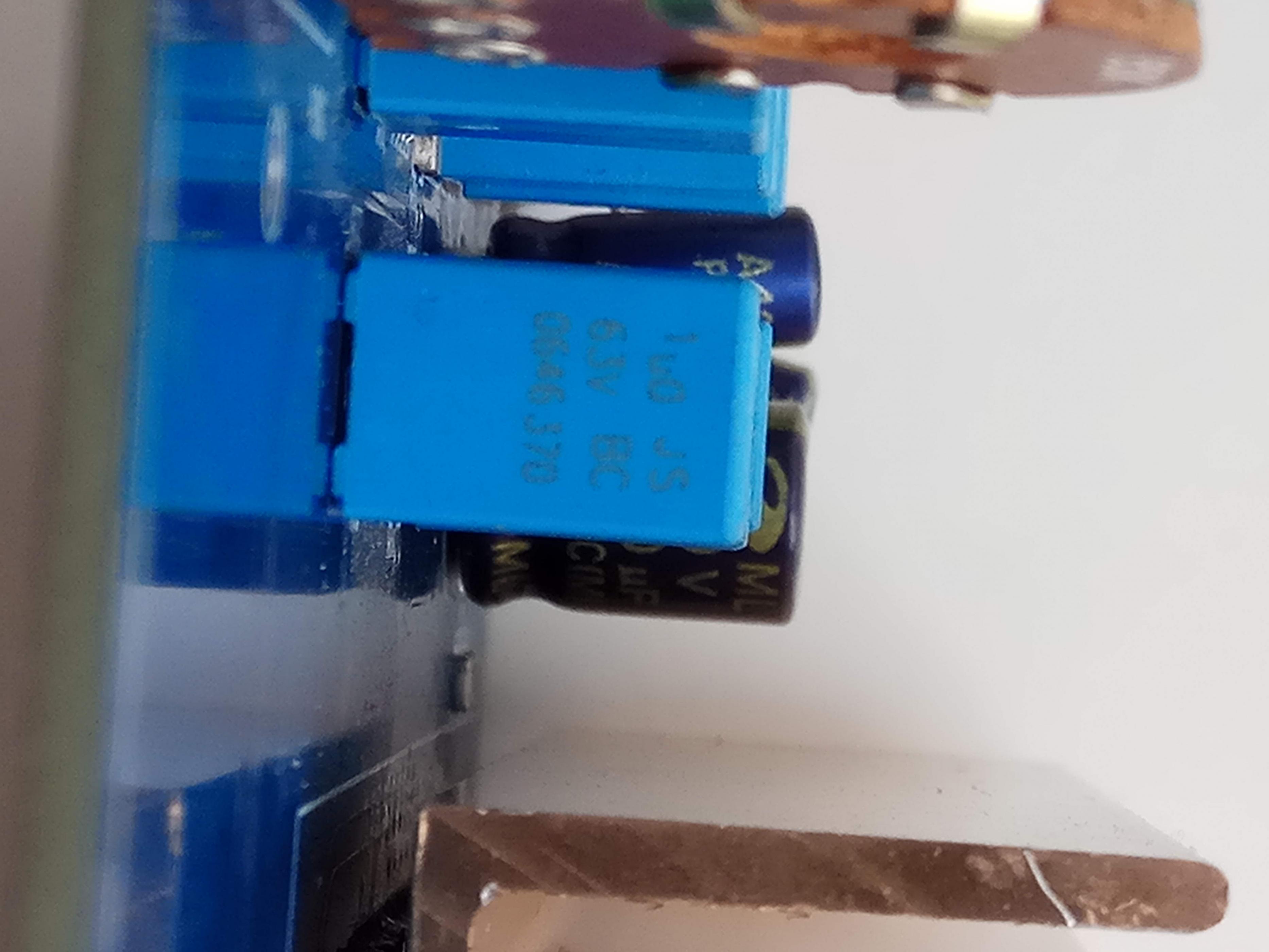

Hi, got naked board to define rca signal route. There are two couples of blue capacitors before relay switching gca/ blue tooth source. I have marked them. Have no idea of their nominals. Made close photos to enable detect them with your support.
hi anatoliy
first , please clean the pcb with a isopropyl alcohol 99% or special PCB cleaning stuff. .. the buttom side....in special the sector where the volume knob is. i see the traces and its 1µF cap so its in my opinion ok before the relay.

Did you change this single cap...the blue one? its just 220µ...as we discussed TPA3255 datasheet recommend more...
Please can you measure the coil. is it 10µH? what is you speakers impdeance?
