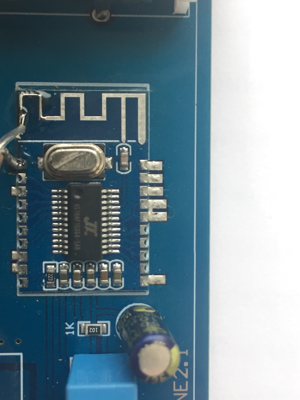

While soldering the short ends sticking out of the chip back to the board, I had to give the left side a few touches more then I liked.
Solder job looked pretty good, but when powering it with 20v the left part of the chip burned and now I had the familiar smell..... I will order a new chip.

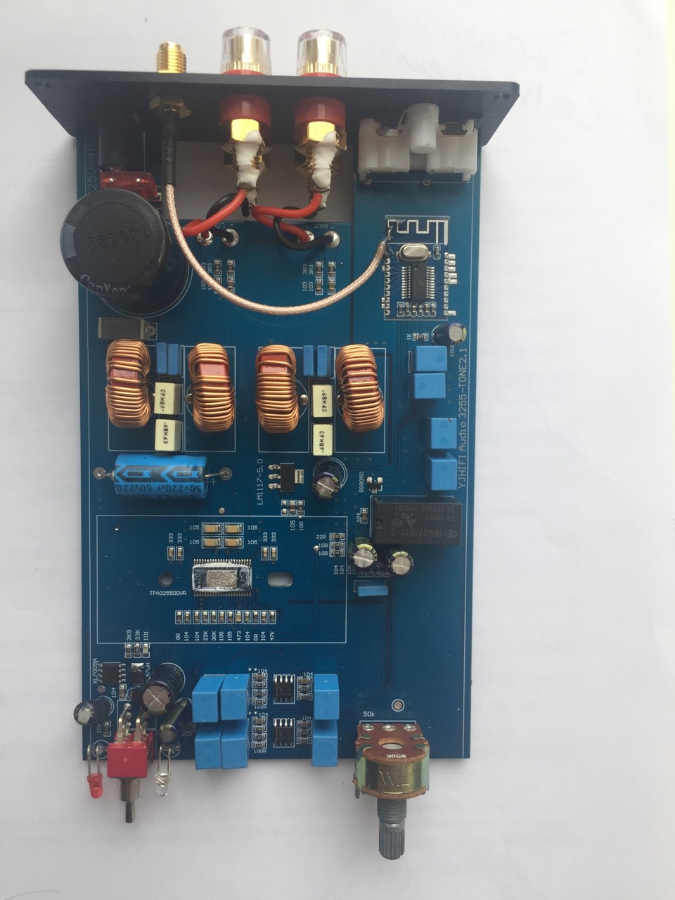

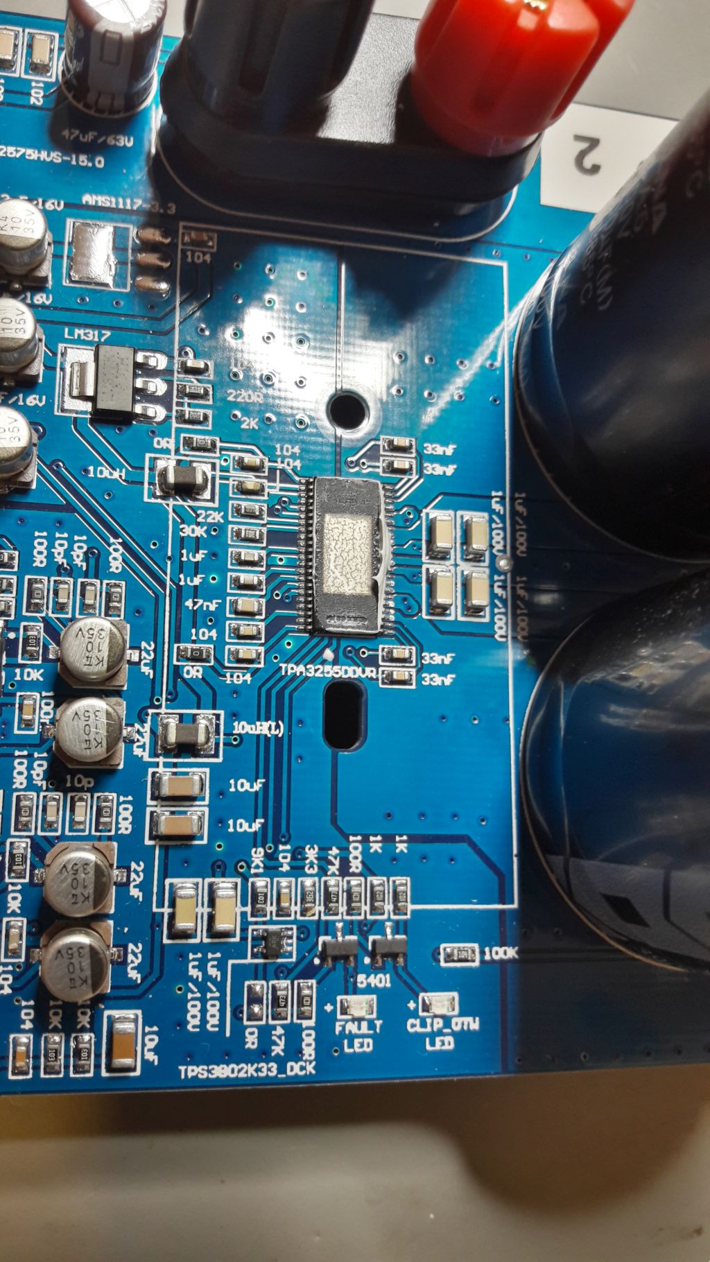

Hi, mates. Uninstalled hetasink to show the chip topology. Got questions: 1) how do comment the topology?
2) main capasitor is only 1000/50V without preventing cap.is it ok? In description seller noticed 2200/63V elna.

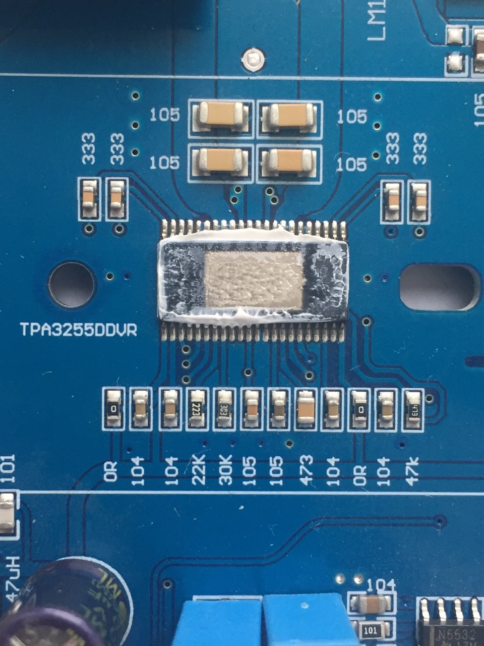

3) saw some thermopaste in-between chips legs, is it ok? Have evacuated some amount by tampon. Any suggestions are welcome!

Hi Antony
1; BTL mode
2;the caps in Class D must be with low ESR/ESL and normaly the chinese board provide a "normal" cap...lets say old version and long storage time because the buy it in 100.000 peaces..
if you use 48V you should use the next Voltage value e.g. --> 63V to have some headroom...etc..

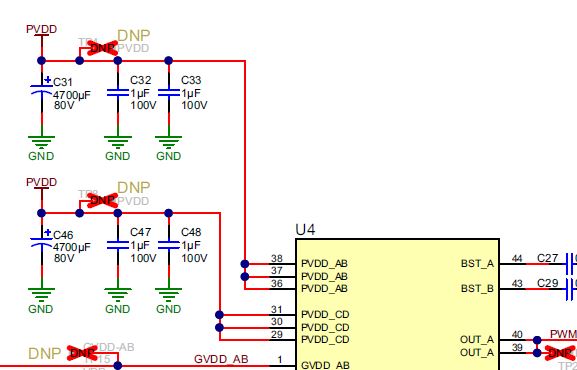

datasheet TPA3255EVM -
the Caps 4700µF/ 80V should be connect to the Rails of the Power chip .
PVDD (BTW- ind the TPA3255 chip datasheet there is wrong written=470µF)
look at the attachment
3; they use too much....., if you have an PCB cleaner you can clean it and use a newer and less past to contact here....

hi anatoliy
Doc is principal right about bass and µF on the rails.....but in your second pic(complete board) i try to check the pcb traces ....its not sharp....and it looks like that the blue cap 220µF/50V is connected to PVDD_CD pin 31,30, 29. so its not according to the datahseet!!!
and it slooks like that the trace also go from PVDD_AB pin 38,37,36 ! so its 1 cap for both rails?!!!!
maybe somebody with better eyes can confirm this
