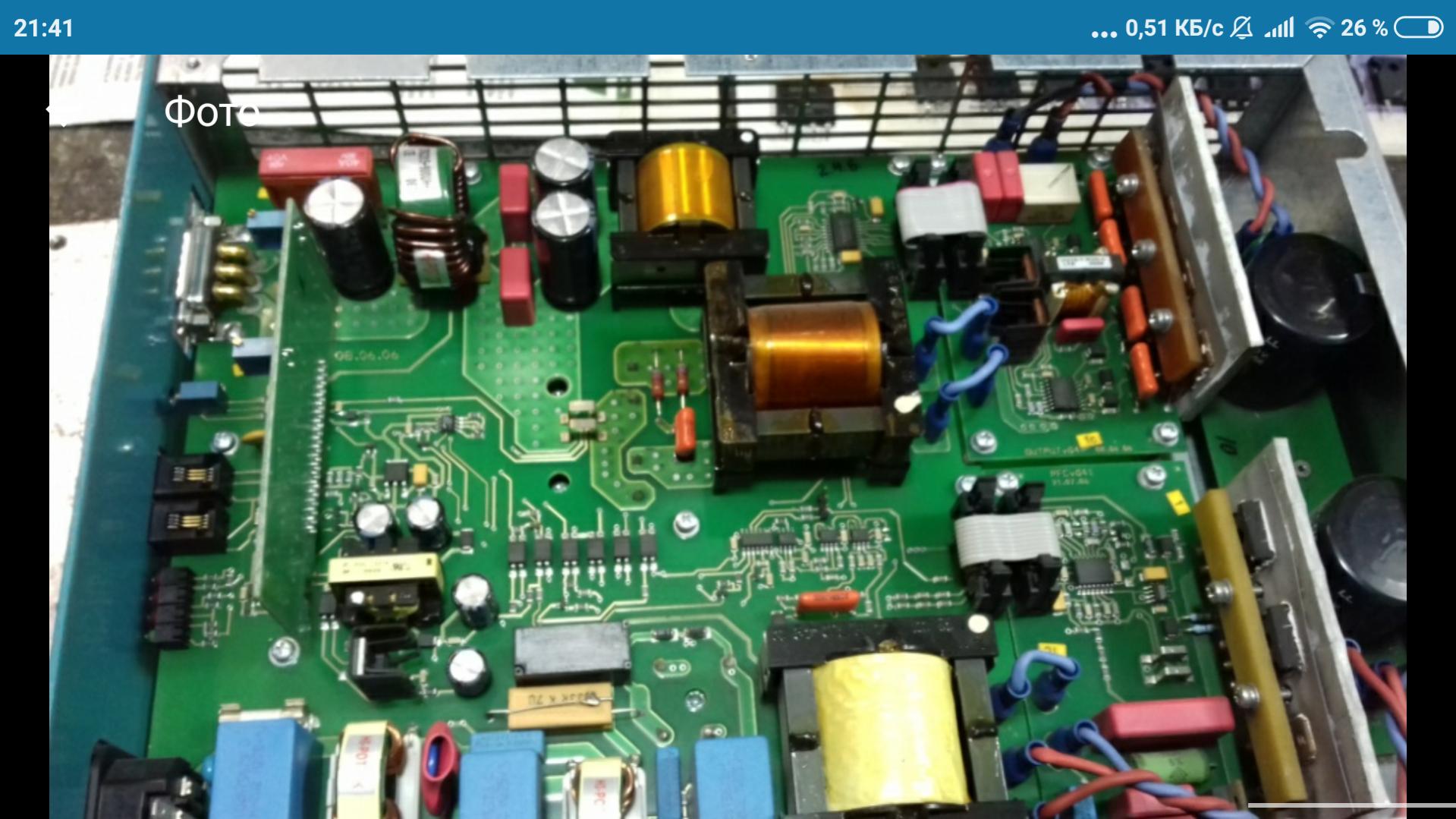

So, am I wrong with this heavy psu 1200 w? Will ask seller how to regulate current, I was informed it can be designed to be a charger for big cars accumulators for cars, there is some current regulator inside. Will open psu to enable see what is inside and then will decide how to manage current isdues. For now I do not see significant difference feeding tpa3255 via psu 50v/1200w and HP adaptor 19,8v/90 W but there should be...

In general, most of the these commodity AC->DC supplies will "fold back" (reduce) the output voltage until they can satisfy the current required. So, if you have a 50V/10A supply, and you connect to a 1 ohm load, the output of the supply will reduce to 10V @ 10A. And it will do that for a long time until it decides there's a fault or something gets too hot. And then it might go into a skipping mode. But usually they can do it for a long, long time.
This is desirable because it means you can charge large capacitances on equipment (like the TPA3255 EVM) safely.
if you add a bunch of caps to the ouput of your power supply, turn on the supply, and then connect the TPA3255 EVM, you will see sparks and nearly 1000A flow as the charge in the PS caps you added gets dumped into the caps on the EVM. That is very bad, and stresses everything.
So, determine the current you need, and buy a supply that can deliver that current all the time with a bit of margin to account for crest factor. For example, if you have a 50V system and you want to deliver 300W into 4 ohms, that would be a 35Vrms sine (approaching 50V peak). And the current would be 9A rms. The tips of the sine wave would need 1.41 * 9 = 12A. And then you have efficiency to consider.
If you try to solve the peak demands with caps, then what works for 1 KHz won't work for 20 Hz. It's a bad way to go. Supplies are cheap. A 50V 20A supply should have ample margin and keep the TPA3255 really happy if you want to get the rated power from the product.
Remember, caps are designed to act as reservoirs for microseconds, not milliseconds, especially on class D amps

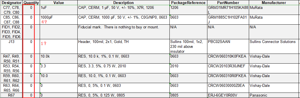

I have a question that may have been answered before (apologies if true), on the original BOM from TI there are a bunch of components with 0 qtys. which is confusing to me. Is that a revision or design evolution kinda a thing?

There are reserved pads on EVM board for mod, such as PFFB or other customizing. 0 quantities are those excluded components in default circuit.

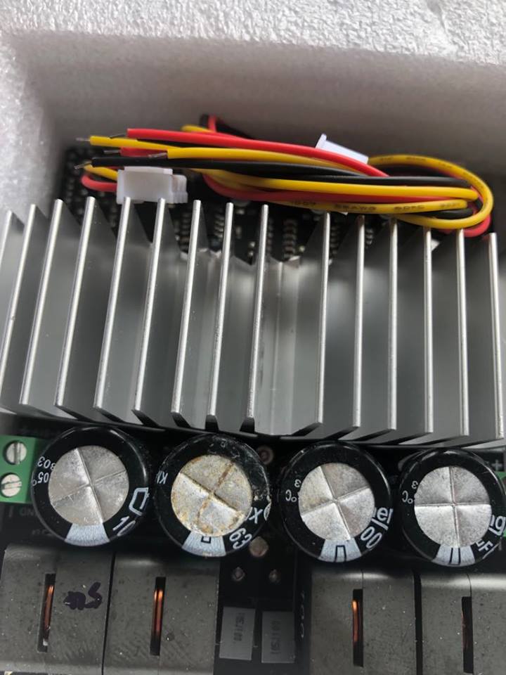

What capacitors do you reccomend for output stage? I have bought 3eaudio board recently and I am a bit worried about condition of the used capacitors (see picture). As I'd like to change them for peace of mind, what kind of decent cap to use? Should it be low ESR, some audio dedicated one?

Is that a “new” amplifier from 3eaudio? If it is, that’s unfortunate that the output filter caps appear like that. I would demand a full refund or a replacement if your amp is “new.”
The Texas Instruments TPA3255EVM amp uses Panasonic FC 1,500uF/63V Aluminum electrolytic capacitors in those positions. The Nichicon FG and KZ caps should be fine to use as well as long as they fit. With the TI TPA3255EVM amp, those caps are only used in the single-ended output configuration.

The 4 biggest ones are power filter caps, the grey blocks are the output filter caps.What capacitors do you reccomend for output stage? I have bought 3eaudio board recently and I am a bit worried about condition of the used capacitors (see picture). As I'd like to change them for peace of mind, what kind of decent cap to use? Should it be low ESR, some audio dedicated one?

Clean it first, it does not look defective to me, more like some spilled lunch...
Measure them if you can. If you can't just power up and keep an eye on it.
You can always replace it later, no extra damage if it fails.
it is the wave-soldering flux.What capacitors do you reccomend for output stage? I have bought 3eaudio board recently and I am a bit worried about condition of the used capacitors (see picture). As I'd like to change them for peace of mind, what kind of decent cap to use? Should it be low ESR, some audio dedicated one?

there are many caps like 1000uF/1500uF/2200uF/63V can be replace since the size same or closed,it up to you,diy stuff things.

change the blue 220µF to 2x low ESR 1800µ/63V panasonic

Seriously? Why it is only on one capacitor then? (Beside the fact, it's on the top, where no soldering is done)
