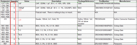

Hi Everyone
I have a question that may have been answered before (apologies if true), on the original BOM from TI there are a bunch of components with 0 qtys. which is confusing to me. Is that a revision or design evolution kinda a thing?

There are reserved pads on EVM board for mod, such as PFFB or other customizing. 0 quantities are those excluded components in default circuit.
