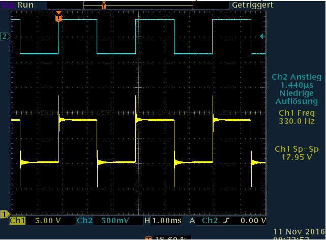

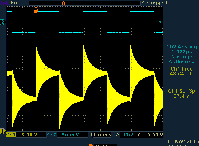

At the moment I am playing with a TPA3255 EVM Module. All in all it is a nice design and looks like really fine engineering to me - I would call it the bleeding edge of current class-D-technique.
As always, there remains some room for improvement. Personnelly I have always been skeptical about pre-filter feedback because in that case the LC output-filter may ring excessively on its resonant frequency. This does not show up in lab test environment using low-inductive dummy loads, so you won't find this in data sheets. But in reality no loudspeaker does provide a resistive impedance of 4 or 8 ohms at 50kHz but is more or less pure inductive at ultrasound frequencies. Without further provisions like an adequate snubber, every sharp transient will excite this resonant circuit with or without speaker load resulting in more or less severe overshoot and ringing. To stimulate this effect I drove the TPA3255EVM with a 330Hz square wave of less than 2us rise-time width no output load at all.
As expected there is significant ringing (1.plot).
It should be mentioned that this ringing requires a very fast transient at the input to be excited, "normal" audio-signal will not show this effect so things are not as critical as this plot might suggest.
Anyway, I fiddled around with some compensation network and discovered that one 47pF-capacitor placed between output D and inverting input U6.pin2 yields a significant improvement of square response depicted in the 2. plot.
Further increasing this capacitor to 100pF established self-oscillation thus 47pF seems to be close to optimum.

I would discuss this with TI. Surely, if one acquires a evaluation module one must have the ability to discuss it. It would be interesting to hear their opinion in your finding.
BTW - you who measure these D amps. Do you use differential probes or what?
