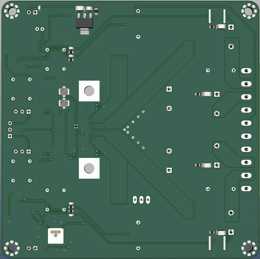

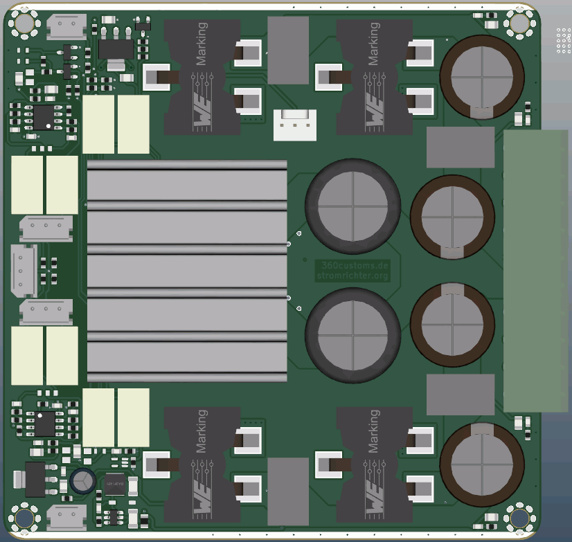

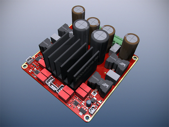

It's implemented in both the 3251 and 3255 EVM but not stuffed/equipped. Will have it on the new board as well. (Bottomside)
I rearranged the ouput/decoupling stage a bit to have better heatflow.
TPA3255 on 360customs.de

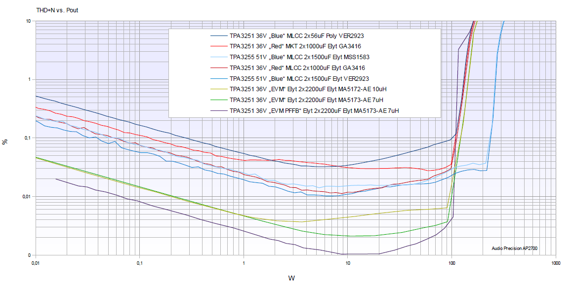

Hi Steven,
when i made the previous boards, PFFB wasn't an option, as no application note existed. The goal was to get somewhere near the THD performance of the EVM, which, to my/our surprise, isn't that easy in detail. Output inductors have the biggest influence and we tested a lot of different types/brands. While still performing nice with good results, the THD measurements where ~1/2 decade higher than on the EVM. (Still under 0.02% for up to 100W/ch)
The red board is performing a bit better then the blue one, so a pretty solid build.
From the comparison:
The red is on the same level as the blue board equipped with a 3255 and huge VER2923 inductors.
But this might be a result of a non-optimal (unconfirmed) PSRR problem of the chips. 5th element did some investigation in this direction month ago, if i remember correctly.
(As always, this is still a fun/education project, so no complete kits nor prebuild boards. But i still have 1-2 bare red boards avail if you want to stuff it on your own. There are actually 5 red amplifiers build by members of the forum, and some blue ones as well.)

The inductors used on the new board are "cheaper" than the Coilcraft, currently at ~$4/pcs when ordering 25pcs.

Well then there's a misunderstanding.
The TI EVMs (3251, 3255) have the PFFB option on board but not stuffed, my red and blue board don't have/had the PFFB option implemented, as there where no application note from TI to show how to proper use it. The new board will have the PFFB option on board, but also not stuffed by default. (As this needs proper measurements first)
To have the best possible start, i'd choosen thos beefy Wurth inductors for now.
Regards.
Regards.

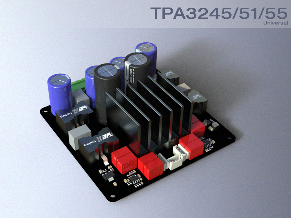

I've ordered pcbs from the fab. 🙂 When arrived here, i will stuff 1-2 boards for measurements and testing. (I.e. with the new LLC power supply a friend did developed.)
So if that worked out fine, i have some spare boards left from the first batch for anyone who will solder an amp on their own. 🙂
