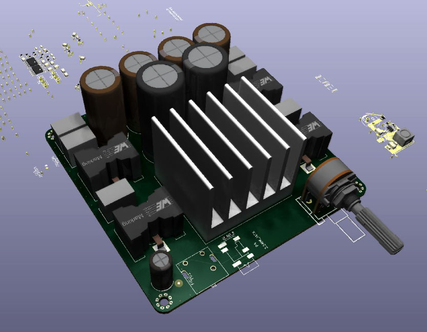

I will have one 3255 board tested for thermal performance in the next two weeks. Thermal coupling is still a bit unclear. Beside that, the 3255 is better used with 8R+ speakers, as output FETs RDSon is (way) higher than 3251.
That is good news! I would like to buy 2 boards of you 🙂 I always make my own cooling solutions so the chips in my setups are always way colder than the usuall setups.. What problems do you foresee with 6 - 4ohms speakers?
For 4-6R Speakers, you normally won't need that high voltage. Losses are higher at the 3255 due to higher RDSon and supply voltage.
For the cooling, you'll have to get heat away from the chip by ~5x2mm thermal coupling. At 600W that more than 60W.
That cooling scenario could actually be a challenge! I think you mentioned crest factor earlier and I certainly isn't going to use it at max that much so I don't think real world scenario is going to be that extreme. Have you looked into Corsair's maglev fans coming to the pc market? Very exciting technology and very quiet! I am planning to put 2 of these amps into a monster of a audio amplifer case so size isn't that important to me. Since this chip has the power to outshine a full size expensive power amplifier I think the tpa chips will stop beeing looked upon as a novelty amplifier.
Schematics are there, layout is to be discussed. (The actual layouts are under lab test and needs to be discussed, there's room for improvements)

The TPA3255 is the higher voltage version of the TPA3251, so that's why? 🙂
For lower voltages the TPA3251 is more efficient due to lower RDSon - i.e. for battery powered systems.
The new TPA3245 might also be an option for up to 30V.
I wonder what's more relevant in real world usage, test plot from figure 1 or 2. Is only the AES-17 filter missing in figure 2?
There still is this 3R3+100nF RC on the GVDD gate drive supply in the datasheet examples where all the EVMs go for 0R+100nF with additional 10uH in line with VDD - which measured better, from what i've heard. Curious...

@doctormord: Would you have to make a different design for the TPA3255? I assume this PCB is for the 3251? No?

The 3251/3250 are contenders for giving the ncore amplifiers a run for their money but only if they are configured with the post filter feedback option.
If correctly configured this lowers the noise of the amplifier and brings it more in line with the excellent noise performance of the ncore amplifiers. Distortion wise the post filter feedback lowers the overall THD+N figure at low power levels (where noise dominates) simply by lowering the noise floor. Then as the power output increases, helps to keep distortion at the extremes of the performance range lower and reduces the impact that the inductors non-linearities will have on performance.
Of course PFFB lowers the effective output impedance by linearising the frequency response across the audio range and makes the amplifiers perform consistently regardless of the loudspeakers you connect it to.
