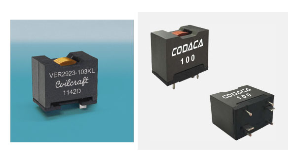

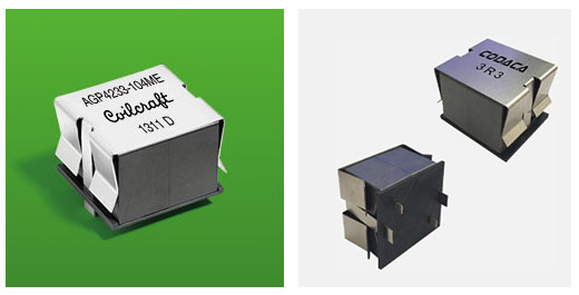

Well, i wouldn't call them any better than the usual oem stuff, as Wurth only "rebrands" - you mainly pay for their R&D + QS. You can get the same performance from "cheaper" parts, you just have to find them and deal with the tolerances. The other point with Wurth is, they sell from qty 1+. (Not i.e. 1000 min qty)I am glad that you use Wurth inductors. They are really good and as the TI application note points out, they perform well.
Ever heard of Codaca?
Production facilities locations Codaca do not match Wuerths factory locations.
Noone said so.
Where do Wurth "manufacture" their inductors?
In china they have 3 factories, in different cities than Codaca, but some of the inductors (I used) are made in thailand, those bodies look like some of Codaca inductors too.

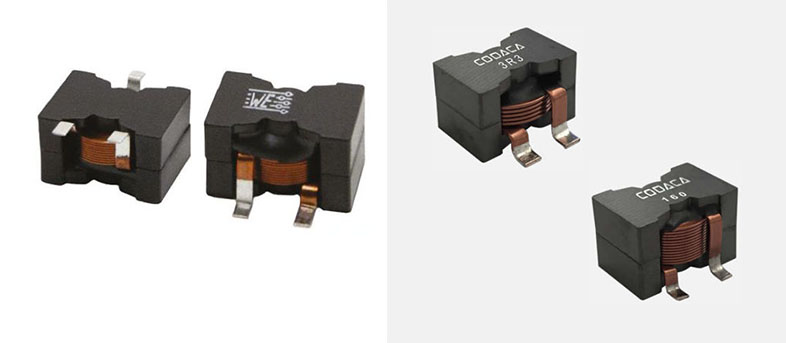

Also the big inductors in first pictures, that coilcraft also sells, the wuerths have black lacquered body, inside and outside, I don't think they take a complete inductor, take it apart and paint and reassemble it. The "rebranding" of oem parts would suggest that??
Wurth is not manufacturing anything on their own, they put their name on it and care about R&D, QC, QS and distribution channels.
Of course, they wont take inductors apart to pain them. They have their contract manufacturers to make the products. What i wanted to say is, inductor making is no "rocket science". You can buy cores, wires and the machine. If geometry, core material, flux, wire diameter etc. is the same, their wont be any difference in performance.
Regarding the Codaca indutors, i have those shown on the first picture. They are mechanically equivalent to the Wurth, inductance differs a bit (7uH vs 6u8H nominal). Also they are wound "mirrored" compared to the Wurth and without painting on the outside.
Number of turns the same for Codaca and Wuerths ? The coilcraft version has different amount of turns, so different core. And like I said bodyparts look painted on inside too.

In this case, the Codaca 6u8H is 11 turns, while the Wurth 7uH is 9 turns, BUT, i have a measurement plot for the 7uH Wurth which measured just 6u2H (Plot made by Wurth).
So there is:
Wurth: 6u2H/9 = 0.689uH/t
Codaca: 6u8H/11 = 0.619uH/t
Little bit different.

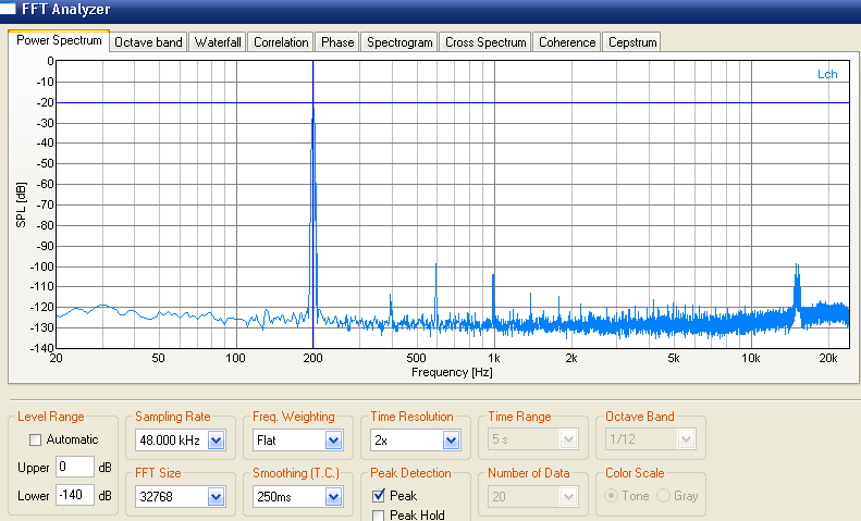

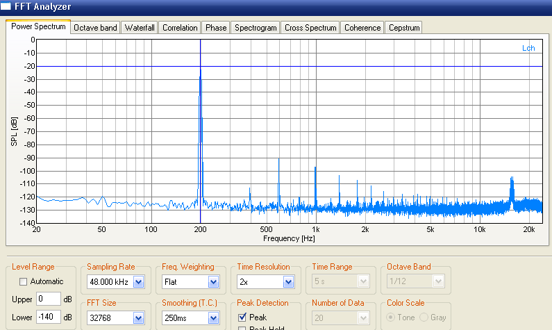

The only graphs i actually found where FFT plots for "filterless" (Ferrite+C) and 47uH+220n classic filter. (both into 8R+47uH)
"filterless":
LC-Filter:

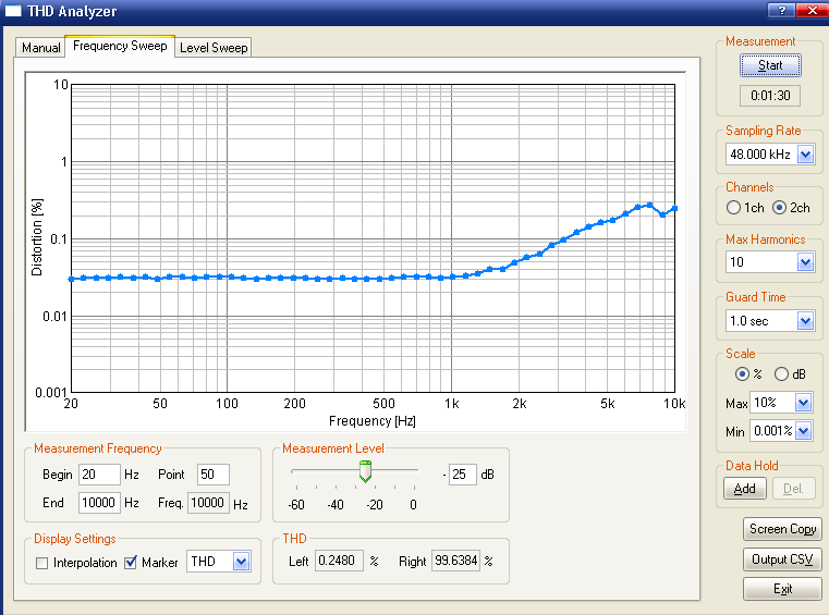

THD vs. F (no load) is pretty much like datasheet. (filterless)

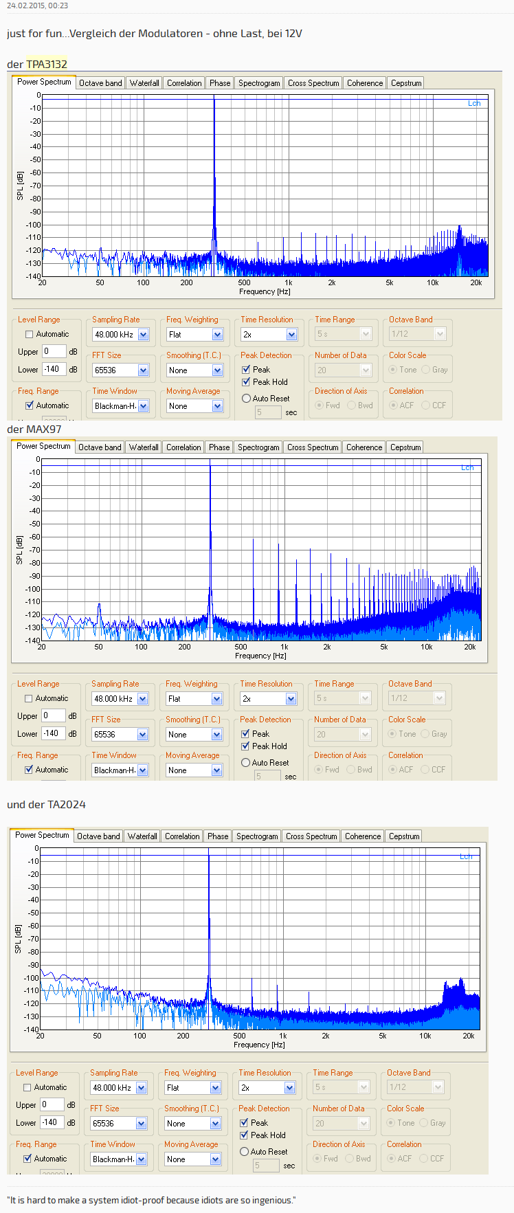

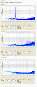

Addition:
Comparison of different modulators at 12V with no load:
(The MAX9709 is running in spread-spectrum-mode, thats why there's much more modulation. TPA3132 is Ferrite+C, MAX9709 is completely filterless, TA2024 is with standard LC-Filter.)
