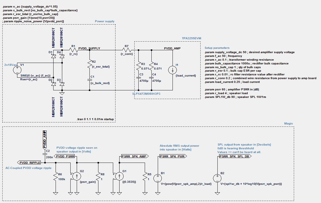

Ok thats good to know! I'm going to drive this with an diy unregulated power supply and how much capacitance do you think I need? I wan't to be able to run the amp close to clipping with the psu not causing hearable sound degradation. At which ripple voltage do you think it becomes hearable with this amp? I have 2 oil filled 63V 180 000uF caps (got them cheap) which is going into the psu. I hope this is proper overkill since the transformer is large but of poor quality so it might not deliver clean power into the cap bank. Do I need an PI filter with so much capacitance?
What I mean is that I wan't to run the amp at full volume at 4ohms whitout being able to hear 100Hz hum. How much capacitance do I need for that? Supply voltage is 48V. I'm building this amp to last many years to therefore I prefer an unregulated psu. I usally use SMPS for short term projects. The numbers doesn't have to be excact, just ball park it 🙂

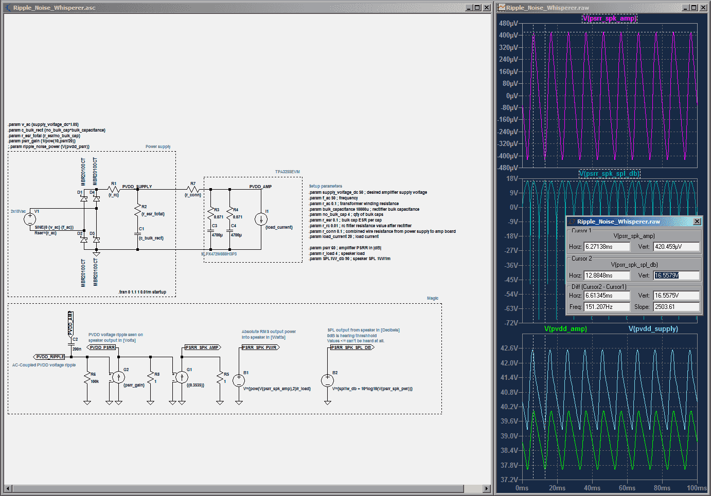

to give some kind of an answer to your question i made this quick simulation rig.
attachment.php
You put in some numbers from your supply and a desired load current and this gives out the 100hz hum in decibels. At room listening levels you wont need a cap at all due to the 2x4700uF on the EVM. At higher levels your SPL is mainly limited from the winding resistance of your transformer and the connection/wire resistance from supply to amp as the supply voltage sags. Like i.e. with 20A load current it is:
attachment.php
No more than 4x10000uF is needed here with 20A load current. 100Hz hum would be at 16dB or 420uVrms, a very calm room is at 20-30dB alone.
20A is something like 2x10A (2xBTL) -> for RMS this is 5Arms per channel or approx: 5A*5A*4R = 100Wrms per channel. Our PVDD rail is sagged to 37V due to connection resistance, winding resistance etc. Will 100W fit without clipping?
Totally simplified calculation: SQRT(4R*100W)*1.41 = 28.2V -> okay no clipping.
100W from a 90dB/W/m speaker is 110dB SPL. With 16dB 100Hz hum, the SNR calculates to 110dB - 16dB = 94dB. I guess, you wont hear any hum. 😀
