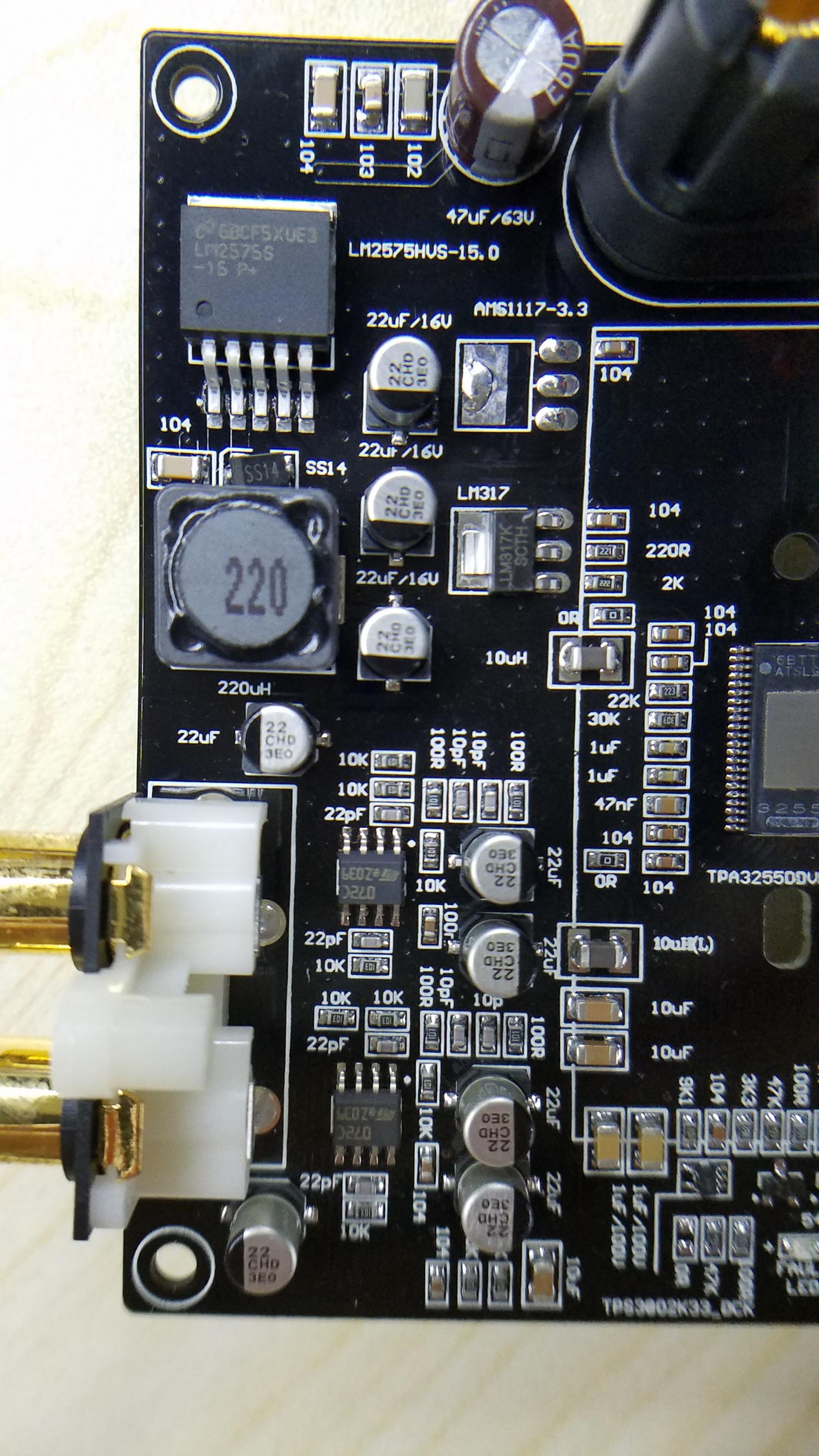

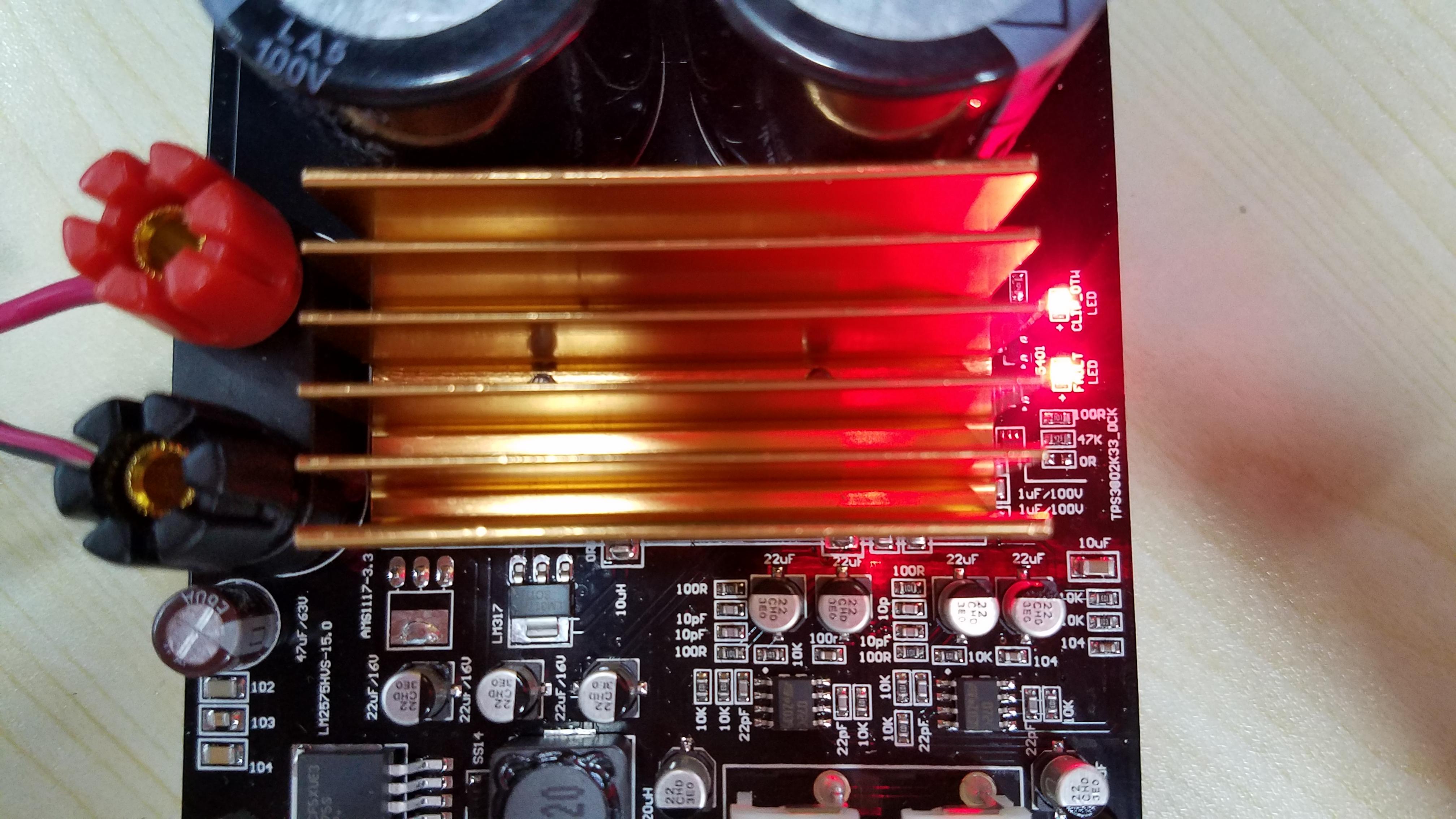

1. there is a very loud 'POP' noise when power supply drop during playing music through my phone, now i need to stop my music first before pull out the power supply......
2. the display LED always ON,i check the datasheet that it's' for clipping and fault indicate,now i don't know when it will clip or fault since it always working.(i did ask the seller but he said it's normal😕)
3. there is one IC not mounted,but the picture show on the selling page,it does has.(i did ask the seller but he said it's normal😕)

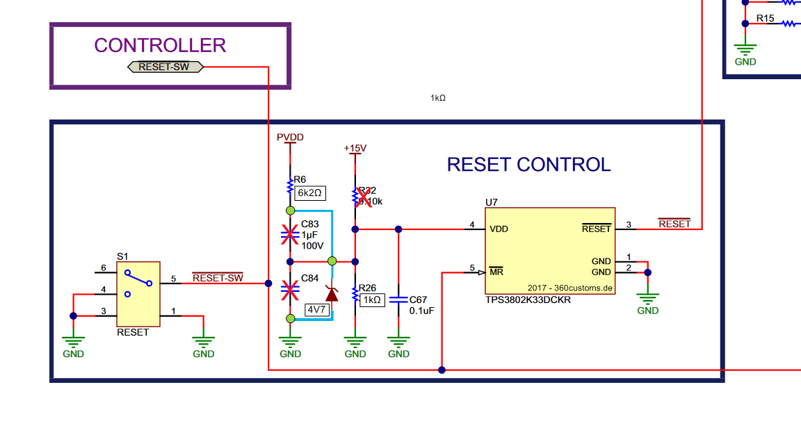

1. At what voltage you're running this board? If they used the mute circuit from the EVM their might be effects like this if capacitor values aren't like noted due to DC-bias. I tried this circuit as well, it isn't the best solution. (I use an improved one with my boards)
2. + 3. The missing 3.3V regulator isn't usually an issue as this is only used for the logic levels and indicators. I don't know their schematic but this might come from missing part. The 3251EVM where done without if i remember correctly, the LEDs where connected to 12V.
1,i running from a 48V DC,do you have a solution to share here?can easy to make it happen on this board?by hand made i mean....
2,even they missing this part,but the problem is that in some case you never know when it will clipping though it doesn't impact use,all LED turn on mean something worse happen on my experience....like the traffic light on the road....
Someone can post pictures in good quality from top/bottom side with heatsink removed?
The problem with the status indicators is from the missing the 3.3V regulator as the gate of the LED FETs aren't pulled up correctly. This normally isn't needed as long as you use FETs with logic level or really low Vgs_th like BSS138. I'd guess, the actuall stuffed FETs aren't the right ones. The TPA32XX does have weak internal pullups, so ext. pullups are needed with the correct FETs.
Someone can tell the marking code of those? They're near the leds and resistors marked 47k / 100R
Beside this, someone can measure the voltages at the AMS1117 footprint referered to GND? There should be equal/less than 15V on Pad 3 (right pad when rotated so that the heat slug pad is on top)
http://www.advanced-monolithic.com/pdf/ds1117.pdf
One way to fix:
- stuff an 1117-3.3
- stuff BSS138 in place of the actual FETs
Fixing pop, like so:
attachment.php
Zener is important to protect the IC from transients.
